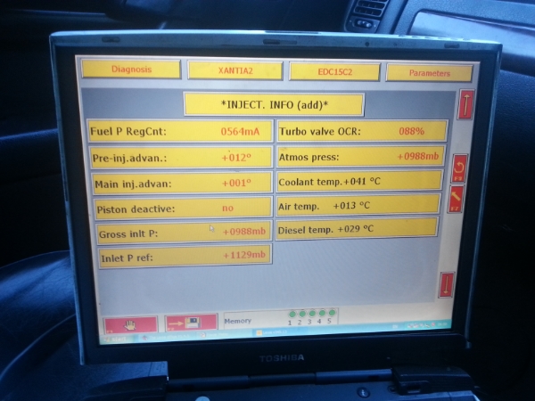

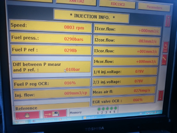

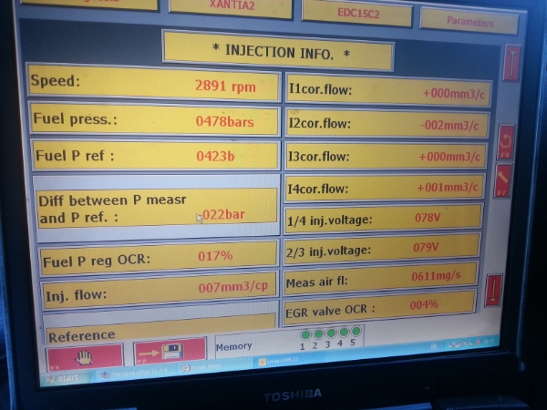

Richard,
Theres only TWO wires from the pump regulator - neither are earthed to the battery. Pin ONE on the rail pressure sensor is earthed to battery at just 1.5 OHMs, which I thought was low enough.
This first two are Videos:
