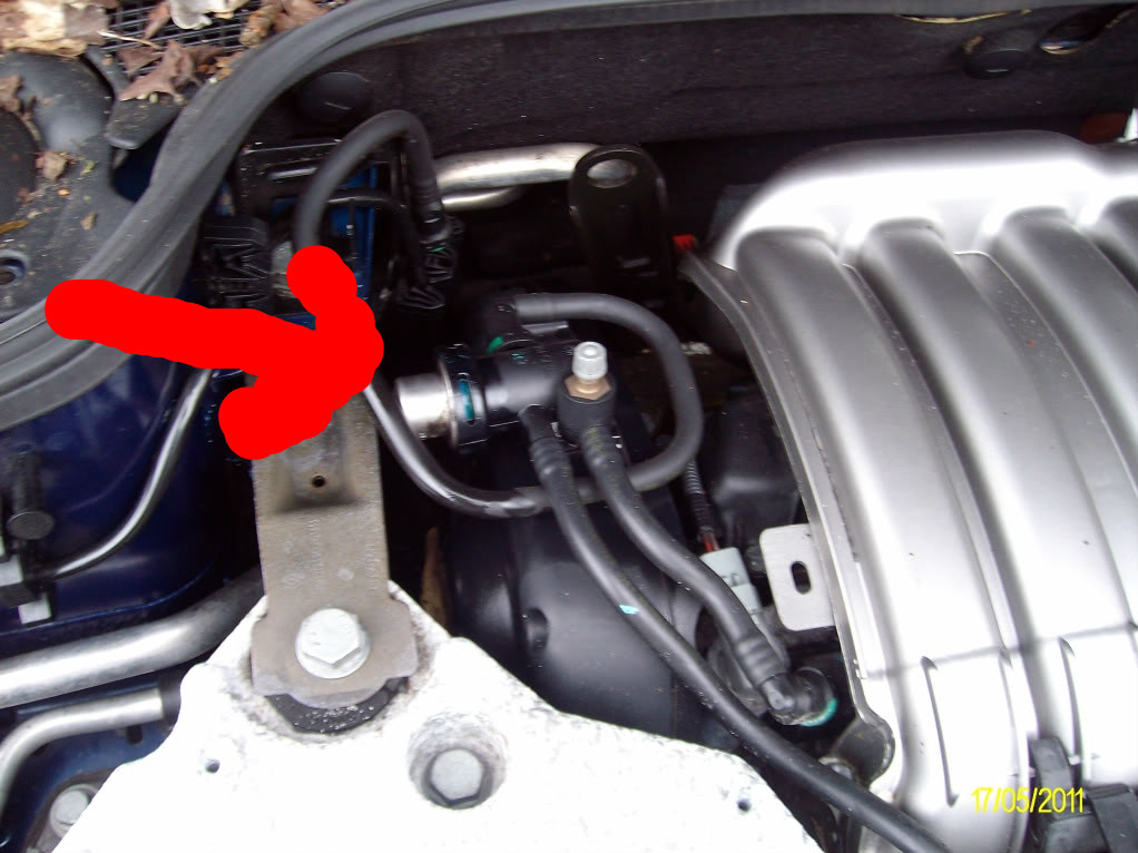

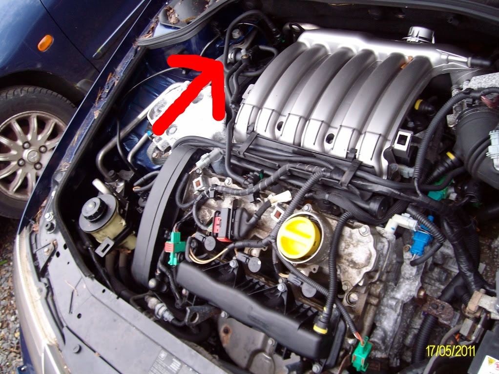

OK next Laguna issue. This time with a V6. The car that I have been after for quite a while, sitting at the back of a yard waiting for me to take it home. I went to start it up yesterday. Connected the battery pack - all good - lady's voice announced that the fuel level was low and that there's an ESP fault. But when it came to starting, it just wouldn't go. When I had a look in the engine bay, it seemed that as the car was trying to start, fresh petrol was steadily dripping from the part arrowed below. Could anyone shed any light on what this is? Or any tips on coaxing the old girl in to life?

R9UKE wrote: OK next Laguna issue. This time with a V6. [...] But when it came to starting, it just wouldn't go. When I had a look in the engine bay, it seemed that as the car was trying to start, fresh petrol was steadily dripping from the part arrowed below. Could anyone shed any light on what this is?
It looks like the fuel pressure regulator (but in a different position than on the earlier ES9J4).

I would definitely concur that's the fuel regulator...
Good to see a PSA ES9 cunning disguised as a Renault and hiding furtively in a Megane engine bay :D
