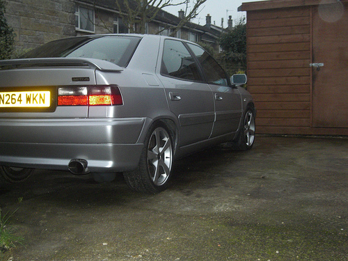

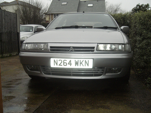

got the Activa off of its crutches today but couldnt be bothered moving it out for a photo so they are a bit close :lol: i think it looks nice now, the body kit is in the shed safe though.
CIMG3223 by Deanxm, on Flickr
CIMG3222 by Deanxm, on Flickr
Picked up some plugs for the boost pipes where the BOV was and changed the gear oil too today, not long to go now.
Does anyone know how the door cappings come off, mine are bubbly and look rather rough, the Activa in the scrap yard has very nice ones but i dont want to break them, i cant seee any bolts inside the door like there are on the xm.
D

Dean, the Activa is looking very tidy...
Good work sir :D

Deanxm wrote:Image
Typical Xantia S1 pose, O/S bonnet catch not holding the bonnet down, don't ask me why (tried adjusting loads of them "They all do it Guv") but very very common :lol:
If you're talking about the black metal plates at the rear of the front doors IIRC they are held in by pins inserted behind the window door rubber which needs to be removed to gain access. If you try to remove them without first removing the pins you will bend the metal plate, now why do I know that?

tried adjusting the Catches too Richard, there is hardly any adjustment in them thats a job for when its running i think.
Sooooo, glass out to get the trims off then........typical, thats a job for the summer too i think :lol:
