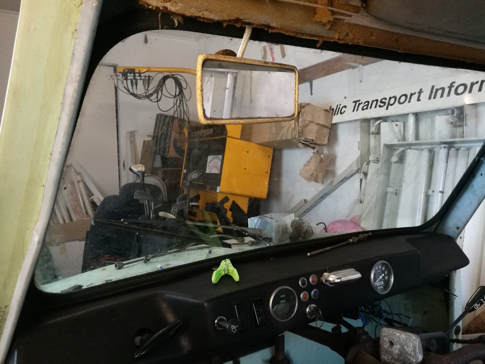

The purple wire is the supply for flashing high beam when you pull the stalk. You will need that for overtaking slow traffic.

Purple rather than brown means it's a fused supply.

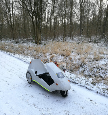

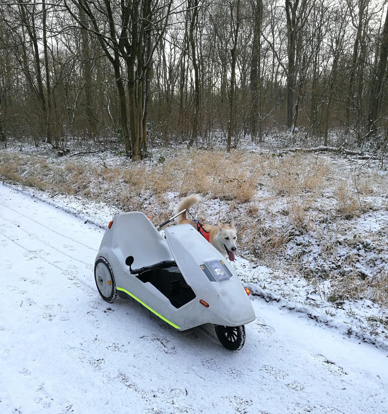

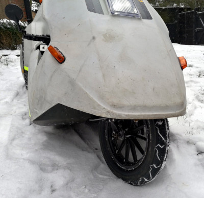

Had the C5 out with the dog again today, he's definitely enjoying the weather - and I figure I've far less chance of falling on my backside on three wheels than two feet!
The Scwalbe City Jet tyres seem surprisingly capable in the snow, didn't wind up sliding around anywhere near as much as I'd expected.

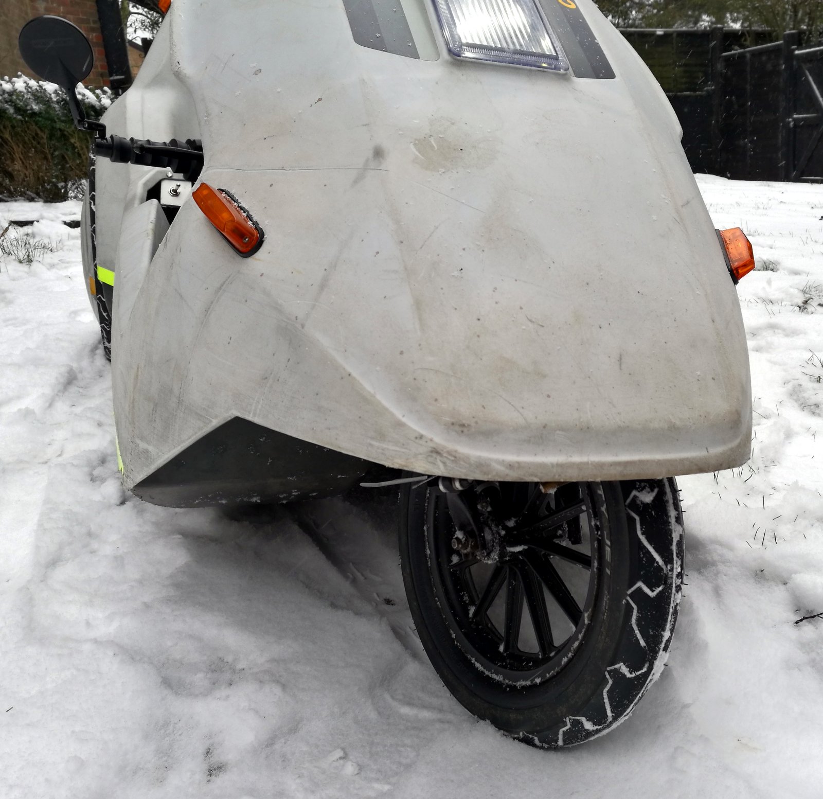

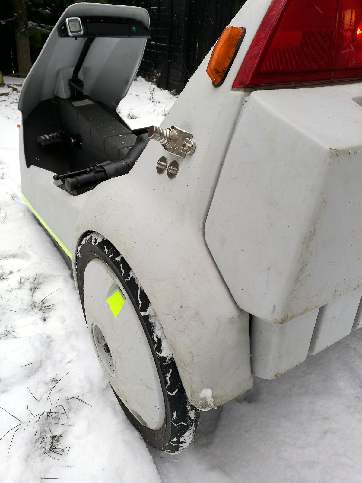

These aren't exactly what you'd expect to be decent tyres on a bike (or trike in this case) in the snow, but they surprised me earlier. I imagine virtually all of the weight being on the rear wheels helps with traction too.
Gets any deeper though it'll be back to walking on two feet as the C5 doesn't have much in the way of ground clearance.

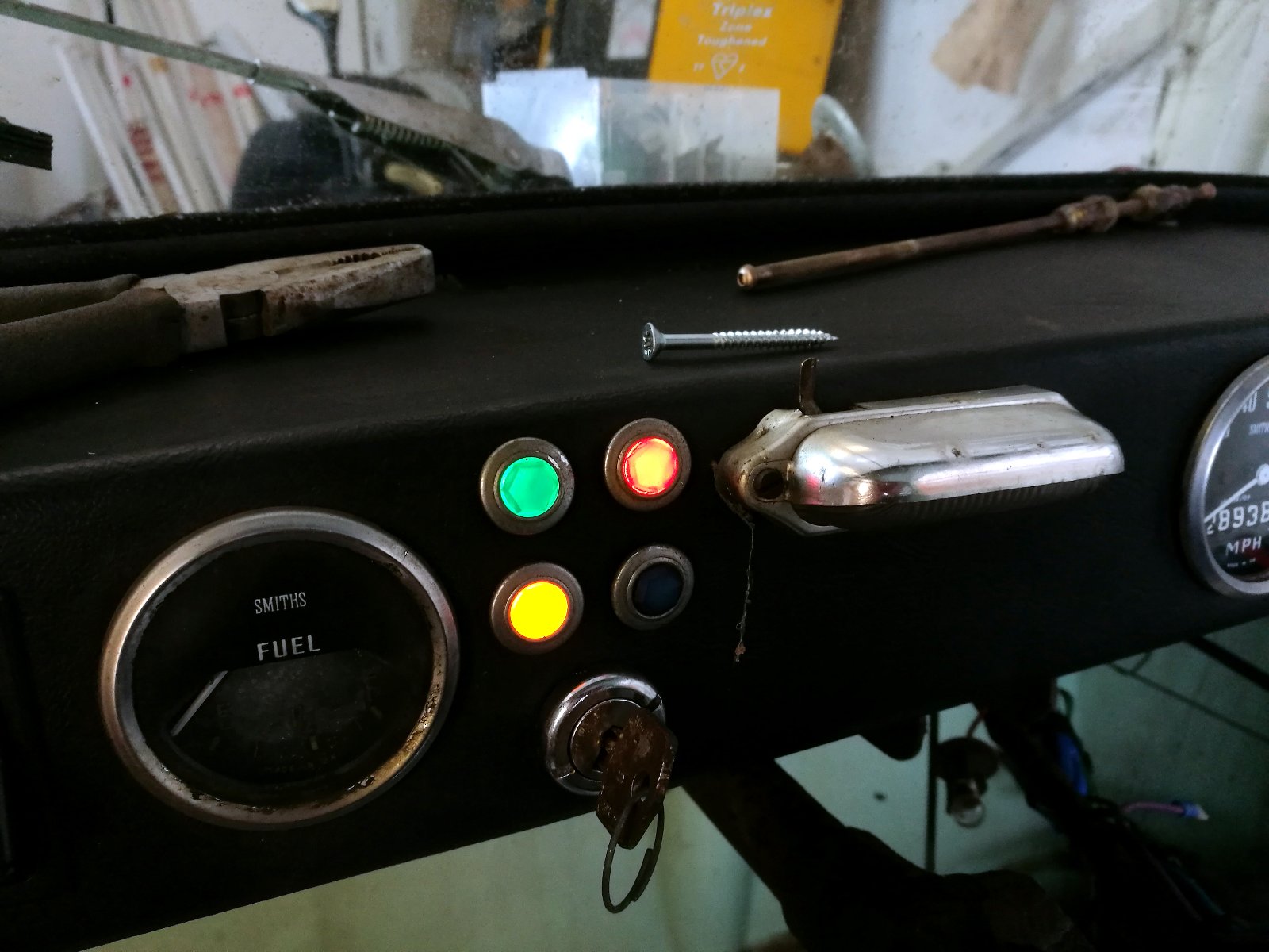

At least out post arrived as normal today, which brought the new ignition warning light for the AC. Annoyingly the bezel design was very slightly different to what was in there - so short of replacing all the warning lights (as having one obviously different would bug me), I'd have to figure something out.
I successfully was able to salvage enough of the original housing after I'd extracted the rotten lampholder using excessive amounts of brute force to get the lampholder from the new indicator to sit properly in place.
The big question though was whether it would work...
Result!
For the first time since I got it, the AC now has a full compliment of four working warning lights on the dash. Having one new, shiny not somewhat faded light there would have looked odd.
Looks like the voltage regulator might need a slight tweak though as the light stays on at idle. Does cut out properly once the revs pick up though. I do have a couple of spares though, at least one of which is far less rusty than the one that's on the car - so I may just try swapping them over at some point to see if one behaves better.

Back in the days of dynamos it was quite common for the ignition light to be on when idling so it may not be a problem. A voltmeter will soon tell...
Main thing is that you see good charging just above idle and that the cutout operates as it should to prevent back discharge...

It certainly appears to be behaving. I need to consult the manual to double-check what the cut in/out points should be relative to engine RPM/system voltage. I don't reckon it's far out to be honest.
Cutout appears to be behaving as well, though the battery is getting disconnected whenever I'm not there as I trust the electrical system about as far as I can throw it, and would rather not burn the house down. An actual isolator will be getting installed in due course once the battery tray is back in situ.
