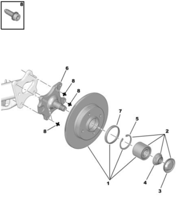

On the first vehicle, there's no 5134G4 part number listed at all Matt. Here are the 2 diagrams referring to the rear torsion bar and hub, - but note on the Torsion bar diagram there is no item (3) listed for this vehicle. Let me know the item(s) from the relevant diagram.
Rear Torion Bar
Rear Hub

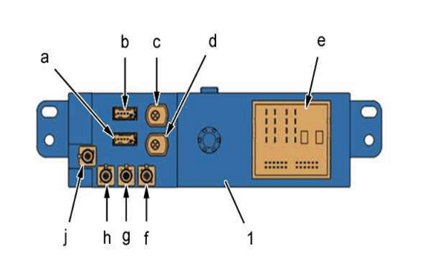

If fitted with DAB, the aerial is 'J'

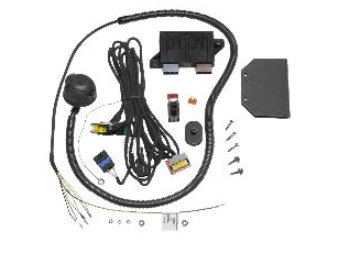

Towing
There is a specific Electrical Harness showing for this vehicle with your build date (others are not compatible), so: TOW BAR WIRING LOOM 13-TRACK, part: 1611864380, £209.23 should be correct.
Comes with a 13 way socket, and Generic Trailer Relay Unit
Features:
  • This harness is particularly suitable for providing the lighting supply to trailers or cycle-carriers on tow bars.
  • This harness has been developed to incorporate all of the vehicle special features.
  • It also provides an electrical supply to the fog lights and reversing lights.
  • Comes with a 13-way socket to correspond to the trailer socket.
  • It incorporates all the features needed for good compatibility with this vehicle and is SAFE, RELIABLE and EASY to fit.
  • In addition to deactivation of the parking aid when the vehicle is towing, this wiring loom incorporates the blown bulb detection function.
  • The functionality of the harness will be obtained by configuration of the BSI (fitting by the network is imperative).
This is the only toolbar listed for the vehicle with this wiring harness:
1608472480: SWAN’S NECK TOWING BALL, £239.38

How odd, it's definitely number 3 I need!

Towing
Aerial information: excellent thank you.
Towbar wiring and kit: excellent thank you. Surprisingly non-eye watering!

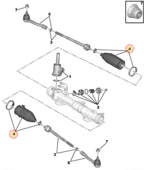

Hi Marc , Is there a part number for the steering gaitor clips 308cc my vin
VF3**************[VIN obfuscated, can be read by forum staff] im considering letting a local garage just nip the clip back up theres no way i can do it on the ground its beat me lol , thanks for the part numbers if there is any.
:-D
x 6957
(4) Steering Gaiter Kit, part: 406682, £34.49

Cheers Marc your a life saver

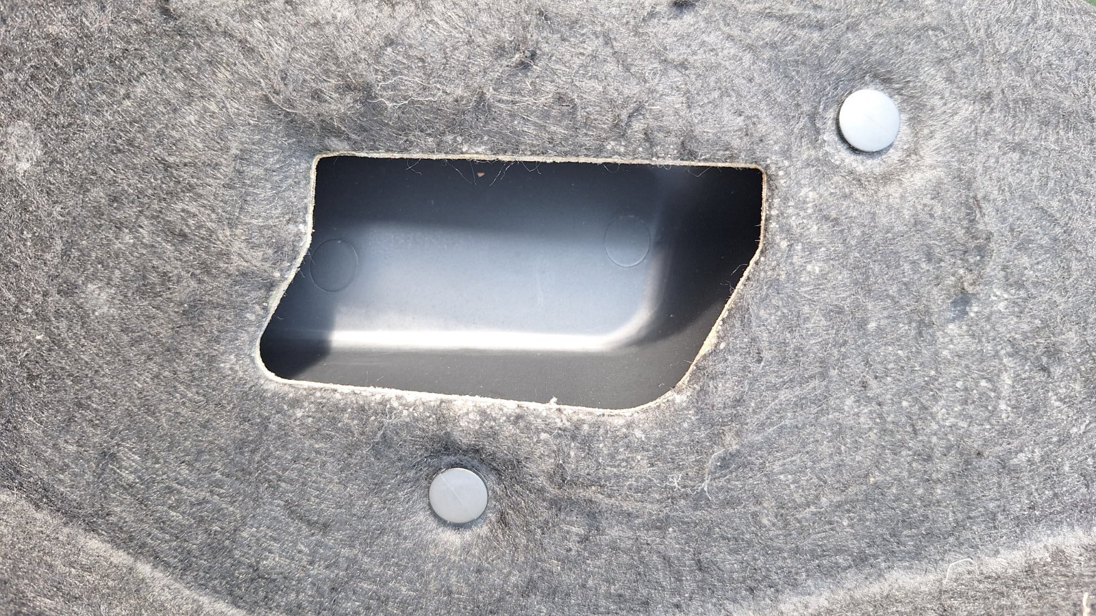

Hi :)
I noticed that the lighting is missing on this piece. Where can I find this? The part is below the glove compartment

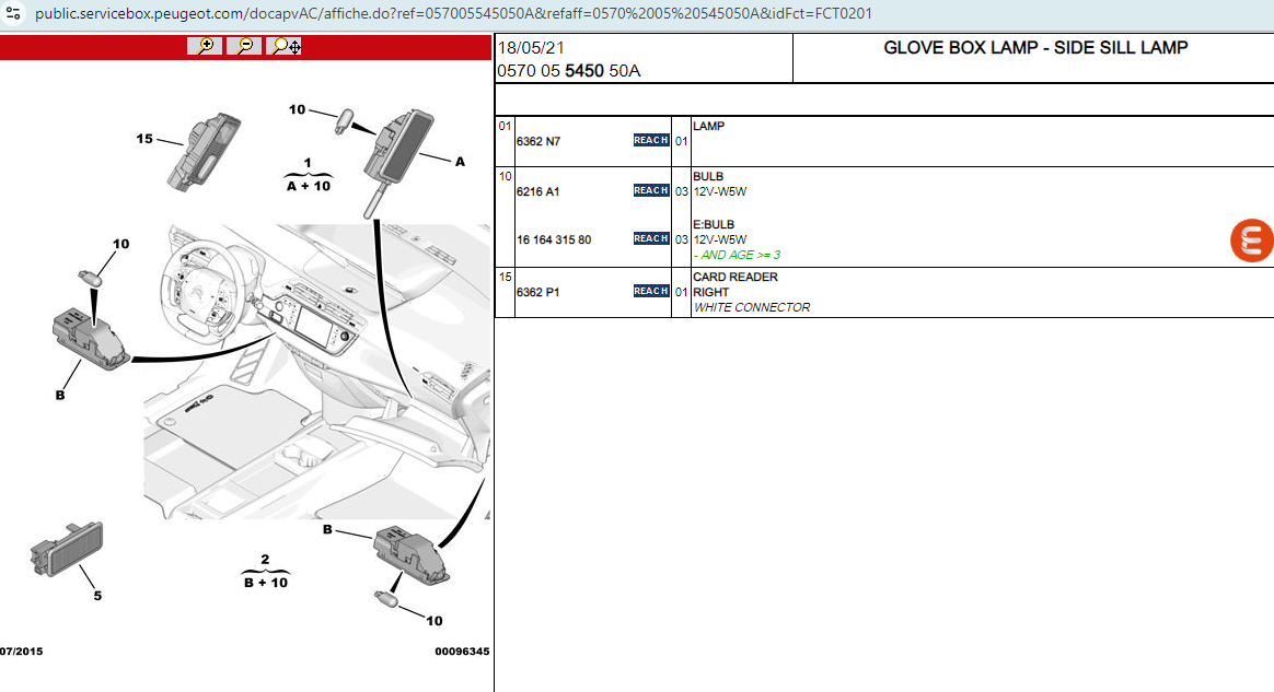

Appears it was never fitted to your car (part number not showing against your VIN):
Part number if 6362N6 - if the cable is there you could get one from a scrap car - or from the dealer - in the UK it's only £6.53

What kind of connection does it have? CAN BUS?
GOOGLE TRANSLATE
Forum Treasurer
Posts: 12578
Joined: 07 Aug 2002, 17:12
x 1487
Unread post by RichardW »
No, just a 2 wire power and earth.
