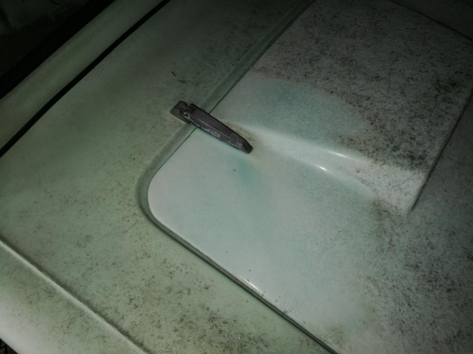

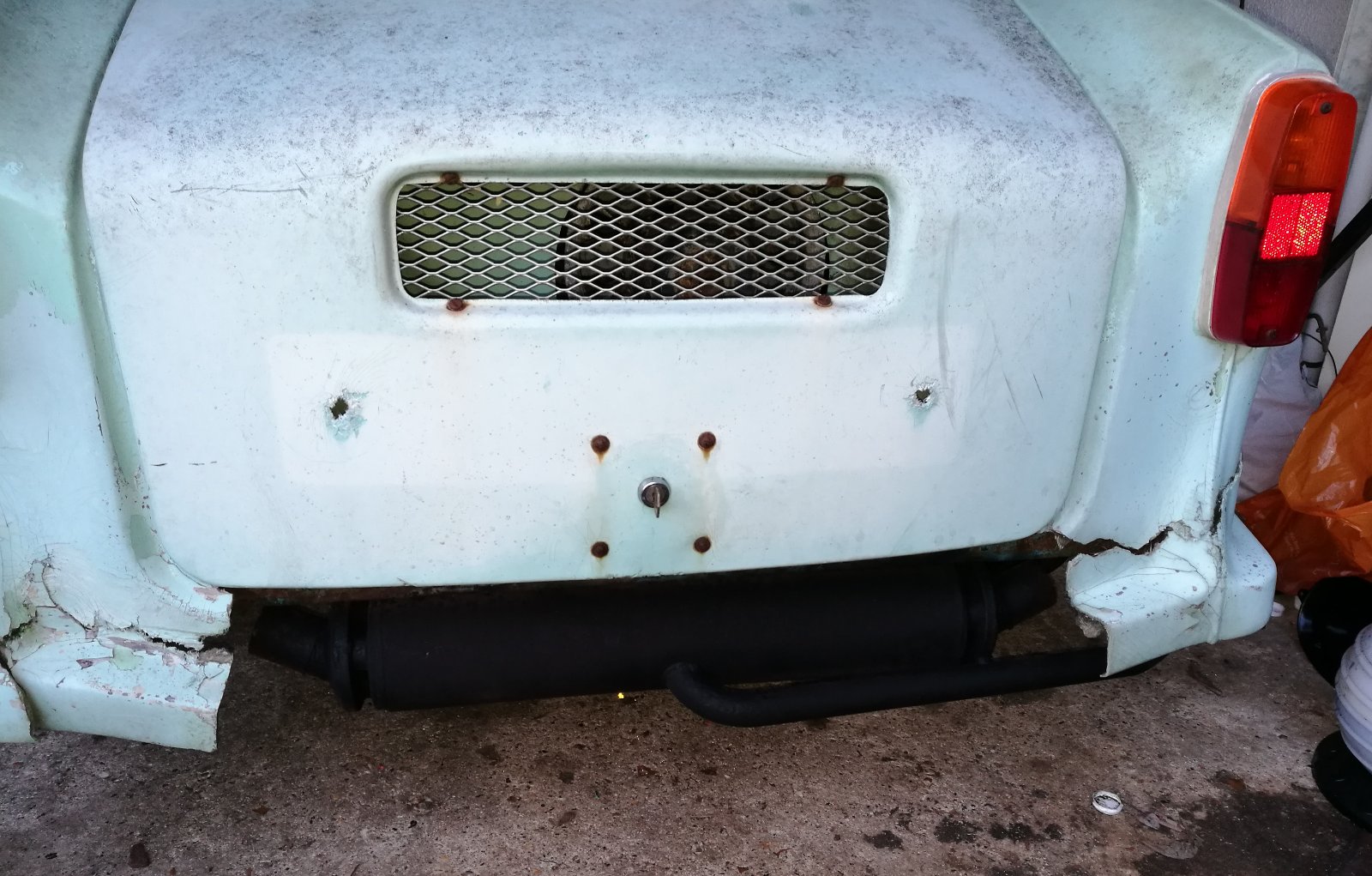

Did however get a bit done. Scrubbed a bit more of the gunk off the roof and engine cover - I really do need to get a proper rotary polishing mop and some decent cutting compound for this I think or it's going to take forever...
Didn't get any photos today, but here's a snap I took a couple of days back when I first thought to attack a corner of the engine cover with the cutting paste - there's definitely a finish of sorts left here under all the grime. Main test though was to see whether the black grime would come off though.
On the subject of cleaning, I also attacked the outside of the carb so I can now actually see it rather than it just being an unidentifiable black blob. I also established that the sticky choke flap isn't actually the fault of the carb - the cable has seized to the liner. For now I've disconnected it and a clothes peg has become a critical part of the cold start procedure to hold the choke closed (it's spring loaded). Was then an absolute sod to start due to the amount of carb cleaner that had been ingested.
Having cleaned it up though does seem to have resolved the sticky throttle problem, and it's now idling somewhere south of 1000rpm. This means there's plenty of headroom between that and where the clutch starts to engage drive, the horrible "CH-THUNK!" that was always present before on selecting drive or reverse is now gone. The carb will still need to come apart to be internally cleaned - but even just this has helped as it's helped a lot of the linkages free off.

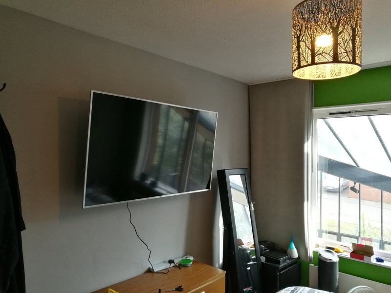

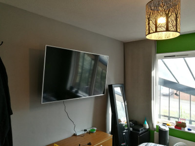

Managed to spend pretty much the entire morning attaching this thing to the bedroom wall for Abby.
What a faff!
On account of the way this place was constructed, the walls here don't have studs in for the most part in the case of the upstairs bedrooms. Instead they're double-layered plasterboard with a dense fibre backing that were installed as single prefabricated units. The backing is very dense, and the board itself is well over an inch thick at least. So had to go out and get suitable fasteners. Then discovered that thanks to Samsung recessing the attachment points way back in the set itself that the bolts that came with the wall mount weren't long enough to reach the threaded insert...Back out to get longer bolts. Then find that they're TOO long and are loose on the bracket...so back out AGAIN to get washers. I had a plethora to choose from, but the largest I could find were M6...and the bolts concerned were of course M8. Cue profanities!
That's what I get for expecting it to be a simple job.
Personally I couldn't care less whether there's a TV in there, but if it makes everyone else happy, I'll do the work. Next task will be rerouting the cabling from the satellite dish to the room - right from the far side of the house via two loft spaces. That can wait till a later date though!
Well, on the plus side I'm now well armed if we need to attach anything else heavy to the walls!

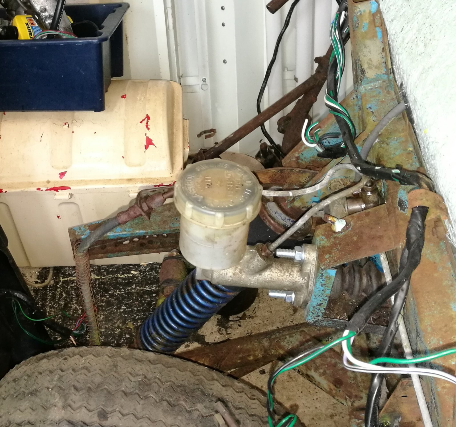

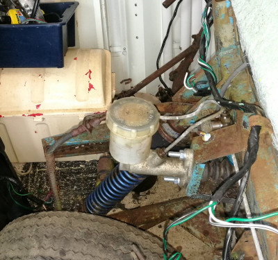

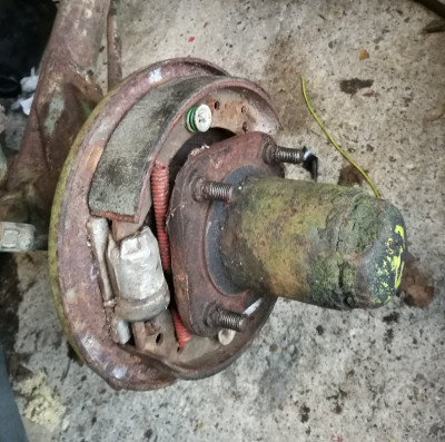

Next up was to replace the utterly knackered brake master cylinder. I didn't even bother trying to argue with the existing fittings...They'd been open to the elements for a minimum of 12 years, and were an annoying imperial size anyway. So I attacked them with the angle grinder. Much quicker and less hassle. High tensile M8 bolts replaced them.
New cylinder on, and quite happily freed off after its overnight soak.

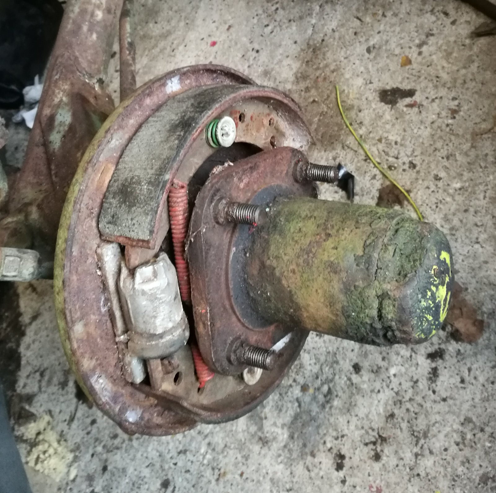

I've bled it through as far as the first union on the system, so can confirm it's pumping fluid. Given that none of the drums currently have shoes in, I've not gone any further than that. I need to spend a bit of time studying the diagram of how the logic puzzle that is the combination of springs, clips and shoes is meant to fit together under the drums. That sorted out, hopefully I'll find out tomorrow what wants to move and what doesn't.
Even if I could get brakes working on one wheel, it would make moving the thing around a lot less unnerving!
By far the most annoying part of the jobs today was getting the blasted split pin out of the link between the handlebars and the master cylinder pushrod. That must have taken me a good half an hour of swearing at it while standing on my head - the whole process made significantly more difficult by the fact that the car currently has no floor.
With a bit of luck, we might have brakes tomorrow...or at least know what in terms of braking kit works and what doesn't.

That master cylinder looks very familiar... Is it a standard 70s vintage one seen as a clutch master on such things as Morris Marinas and the like?

This morning I'd just got the first brake reassembled when Jim appeared, and I went back later today and reassembled the front one as well.
Note: I've not cleaned everything up or lubricated the sliding surfaces here - I'm fully expecting to have to take this all apart again to replace the wheel cylinders, I'm just giving the components the opportunity to surprise me and prove themselves good first.
Not actually too hard to be honest, though there's a very specific sequence that you need to do things in, and failure to follow that sequence can rapidly result in a descent into madness I suspect. The awkward part is that unlike with most drum brakes where you can stick the springs on the shoes first, then slot them into place, you can't do that here. The springs physically won't fit through the space between the adjuster/wheel cylinder and the hub. So you HAVE to attach the springs to the second shoe actually on the car. This is a bit of a three dimensional logic puzzle, but is doable.
Moving onto the third wheel however I discovered a slight problem. Notably that I only appear to have two and a third brakes worth of components. No matter how many times I went through my boxes and bag of bits, I couldn't find the upper shoe return spring or the shoe retaining clips. This is highly annoying. Not hard to source, just annoying that I somehow managed to not end up with a full set of bits...I know we picked them all up, I have to assume they escaped during transit.
I figured there was no reason I couldn't see if the two complete brakes would work though, so clamped off the flexi to the not yet built wheel. Nearside rear bled through just fine - and definitely was doing something. However as soon as I closed the bleed screw there and moved on to the front, the sound of a pipe blowing out stopped play. The metal line running to the nearside rear has burst just before the connection to the flexi. Bother.
Time to dig out the pipe flaring kit and figure out where I put that reel of brake pipe then!
This wasn't really unexpected to be honest - I'm expecting to have to replace all the under-vehicle pipework anyway, just would have been nice for it to be a case of "replacing it for the MOT and peace of mind" rather than "replacing it because it doesn't work!" if you know what I mean.
