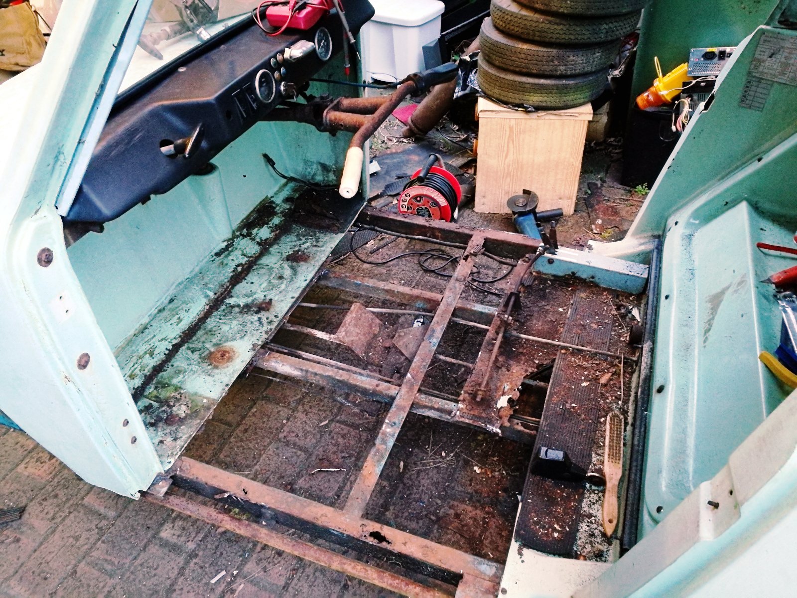

As stated earlier, I didn't have a massive amount of time for this today, but did get a bit of time.
Two tasks.
Firstly was to give it a run for a decent amount of time and see if the smoke cleared. While this was underway it occurred to me that cleaning out the crankcase breather was probably smart too. It wasn't actually too bad really, but I did make a point of ensuring the valves in it were able to move freely. Not sure if it was related, but shortly after that the smoke stopped.
A few minutes later the accelerator jet seemed to rejoin the party and the engine would rev - at which point the now not full of oil exhaust decided to shed 20 years worth of soot. This was impressive, but only happened once.
The next task was to start pulling out the knackered floor. This first required me to remove the seat (which I'd already decided was beyond saving). This turned into the predictable hour long round of swearing at stuck fasteners and rotating nuts that if the car had been built by anyone sensible would have been captive. Eventually I got it out though.
I've got about as much of the floor out now as I can before I introduce it to the angle grinder. I can definitely confirm that the actual floor isn't attached to the chassis save for rivets at key locations. I think it's actually in two parts as well.

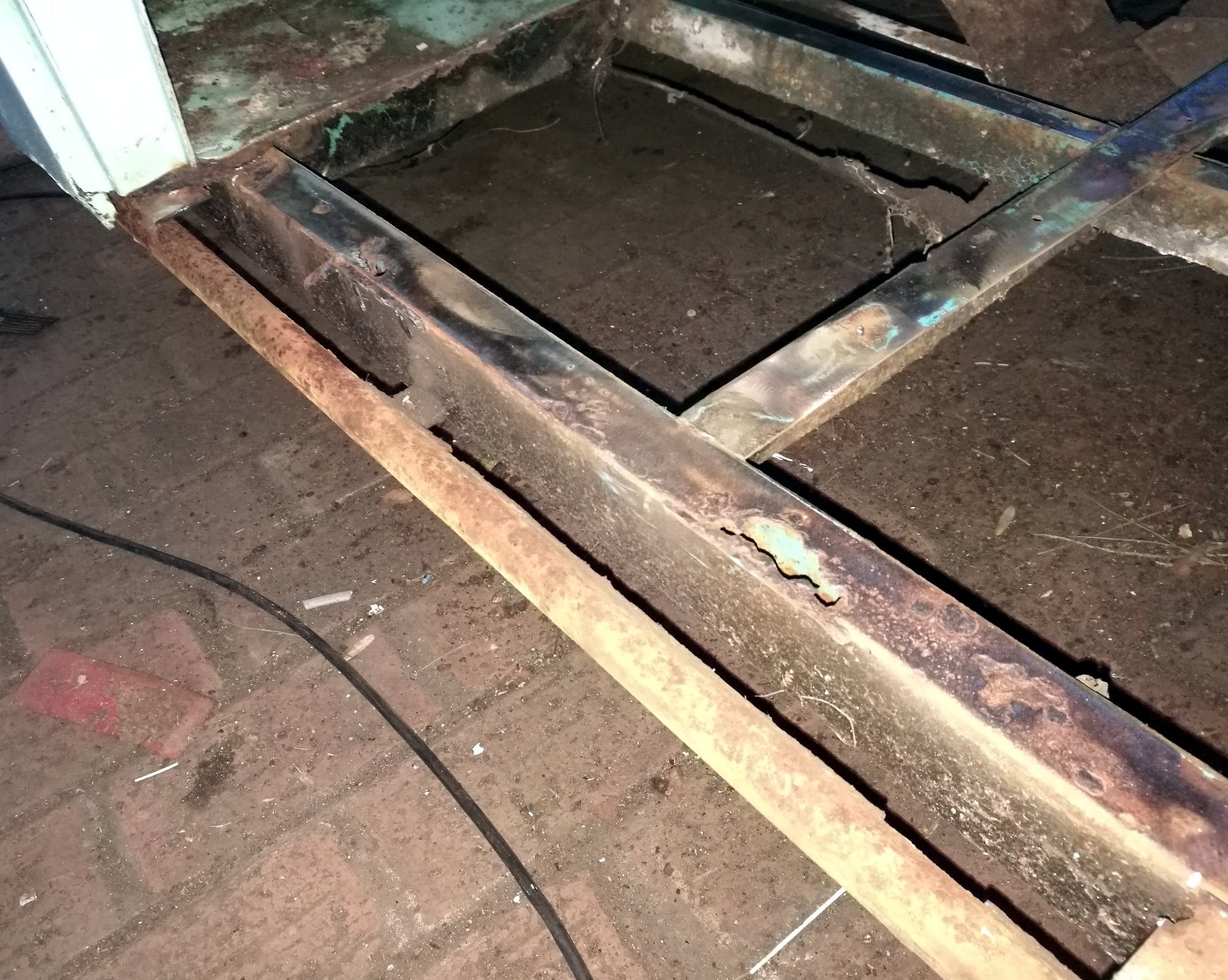

It would have been downright miraculous if the chassis hadn't needed some repairs, and sure enough a few holes have appeared. Nothing show stopping by any means though - especially with it essentially being a glorified ladder frame structure.
The annoying bit however is that it's clear that the floor was attached to the chassis and the body then plonked on top, bolted through both. So to properly fix it, the body will definitely need to come off.
I'm going to get underneath first though (or tip it over again) for a proper look through before I get too involved in that - especially given that I'm not done looking for possible body part donors yet. It would be annoying to take it off, reassemble it then have a better body turn up a week later.
I'm not going to faff about with fasteners when I do that - they're just getting attacked with the grinder and replaced with metric ones. This is the sort of proactive approach I'm taking - if it's going to save me time in the long run and make the car easier to live with and work on later - I'll sacrifice a bit of originality. There are plenty of concourse examples, and this is never going to be one of them!
Two tasks.

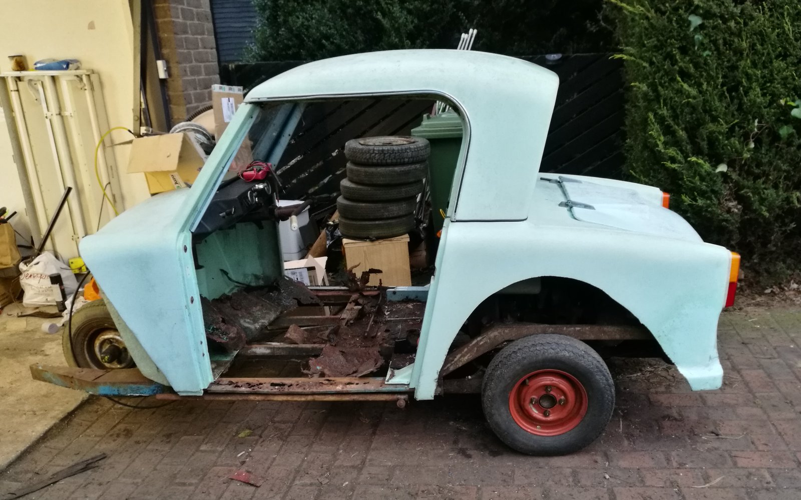

First task for today was to get rid of the stupidly oversized rear wheels. While they give it an amusingly aggressive stance, they also increase the overall width by about a foot and I'm fed up of walking into the nearside one getting stuff out the garage.
It's sitting on 10" wheels just now as none of the 12" wheels I got have currently got tyres on which will retain air. It will probably end up on 12" wheels though both as it can drop the cruising speed revs a bit, and as I understand it gives you a bit more choice in terms of tyres as well. ...Also reduces the amount of wheel arch I need to rebuild!
In case you wondered how much difference there was...here it is with one 10" and one 15" wheel on...
One thing I hadn't originally appreciated was how ridiculously heavy the 15" wheels are...Pushing the thing it feels like I've knocked about 10% off the overall mass!

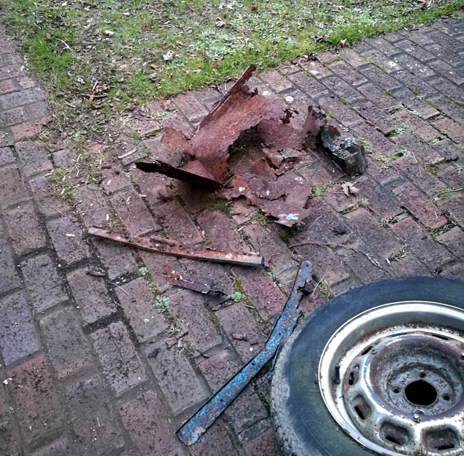

My next task for today was to introduce my little AC to my good friend Mr. Angle Grinder.
Still have to attack the offside rear corner as I can't get at that until I've managed to extract the gear selector. Currently the fasteners holding that in place are resolutely stuck. They're currently soaking in Plusgas, and if they haven't decided to play ball by this time tomorrow I'll just attack them with the grinder - I've got another gear selector in a box that is in far better condition, so I'm not precious about this one.

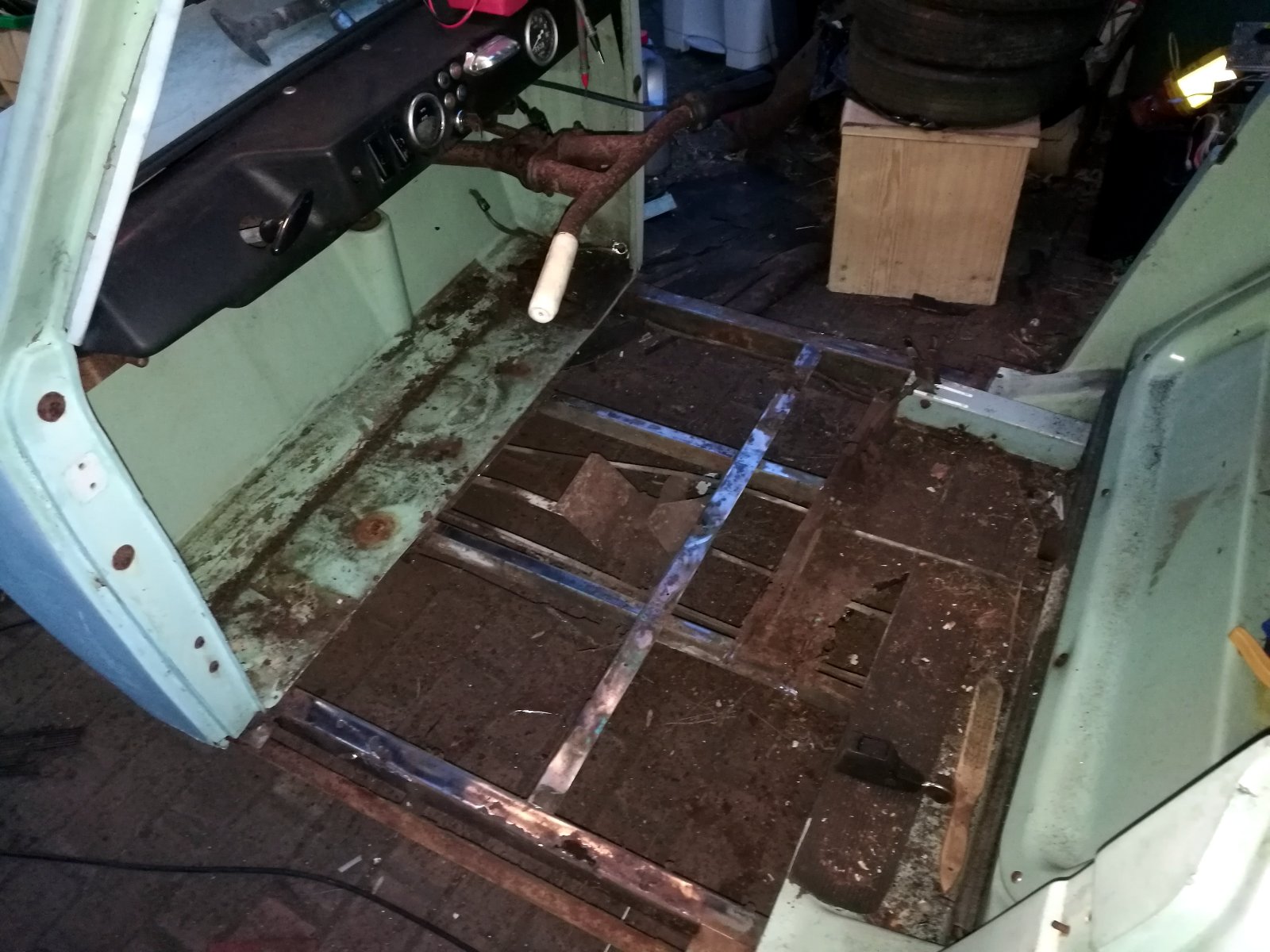

90% of the rotten floorpan out, and both rotten sill covers off. Lesson learned, Invacar rubber floor matting does in fact burn quite nicely, and STINKS when you hit it with the grinder.
Then hit the surface of the chassis with the carbide sponge polishing thing that shifts rust, paint and everything else...Gonna need a few more of them I think.
Given the state of the floorpan, it's near miraculous that there's as little repair work needed as there is.
Here's the worst bit I've found so far aside from the bit down by the seat belt buckle.
Compared to what I've found on things like your typical MG of a similar vintage, and that it's been sitting in a field since the early 1990s, that's really not much rot!
I've also had a closer look and I reckon that I actually should be able to get away without removing the body. There's actually only about an inch of overlap at the front (assuming so far that the rear is the same) - the body is bolted to the chassis, and the floor is then riveted to the body just behind the nearby crossmember. This is a major bonus as it will save a heap of time.
