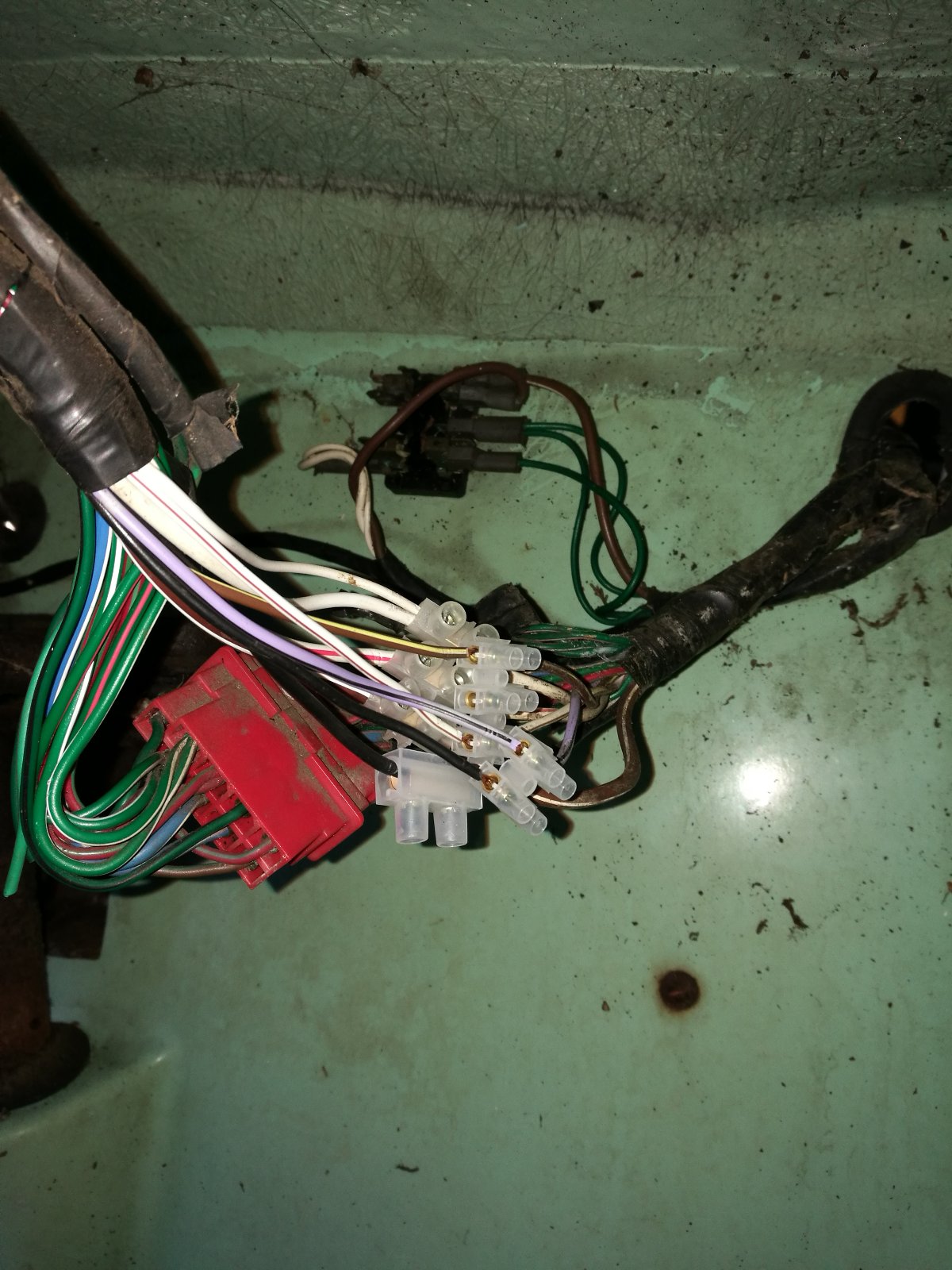

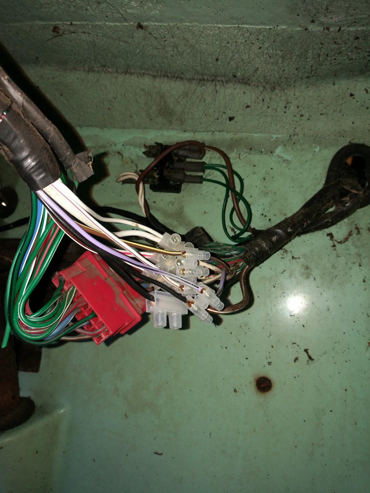

First task was reconnecting about 430594854398 chopped wires (here's just a small selection under the instrument panel).

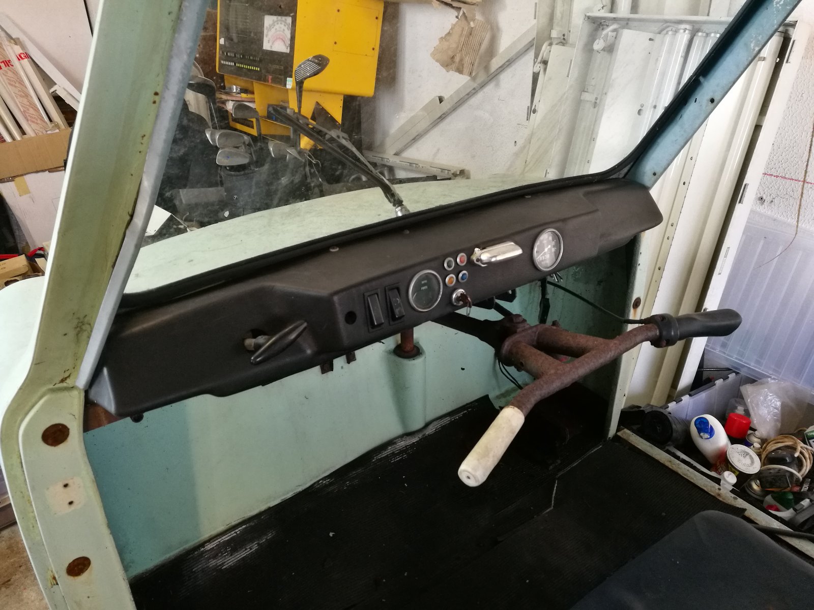

Speaking of the instrument panel...it's rather more pleasant now it's clean(er).

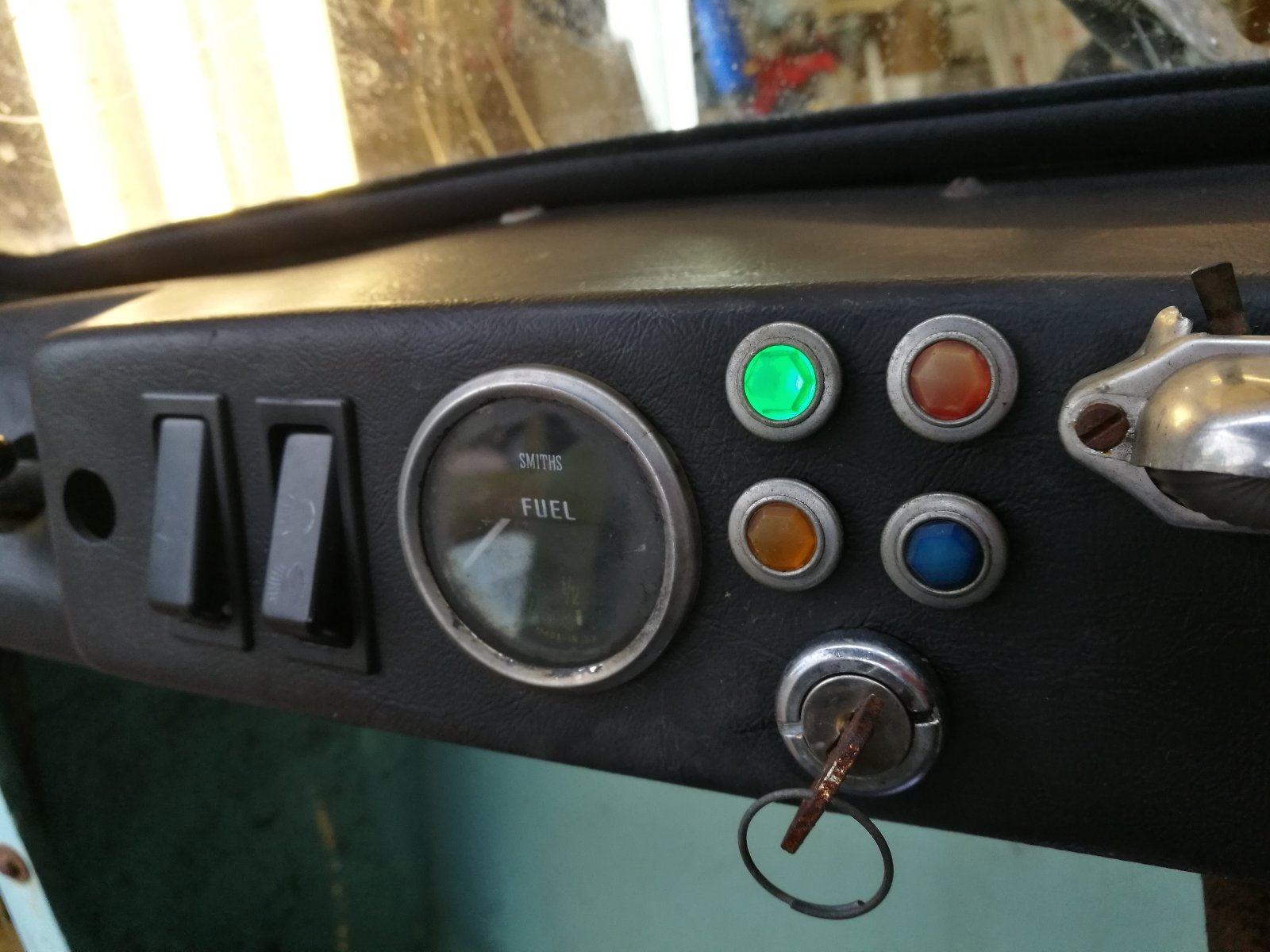

At this point "connecting" up a battery (by connecting I mean holding the negative terminal on with a pair of vice-grips and the positive terminal by hand), we had the first sign of life...

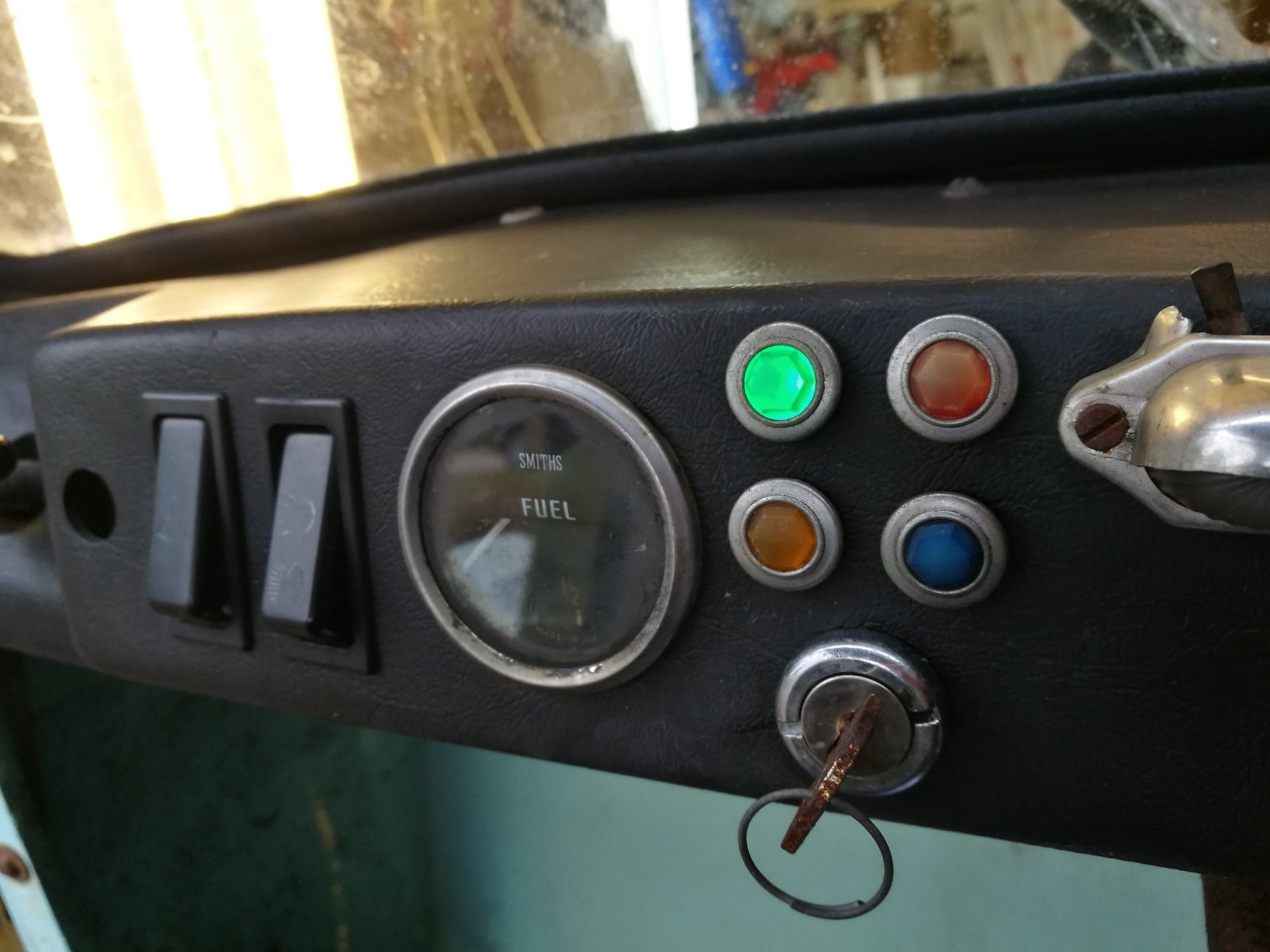

...That's a working oil pressure light for those of you who don't know a Model 70 dash layout.

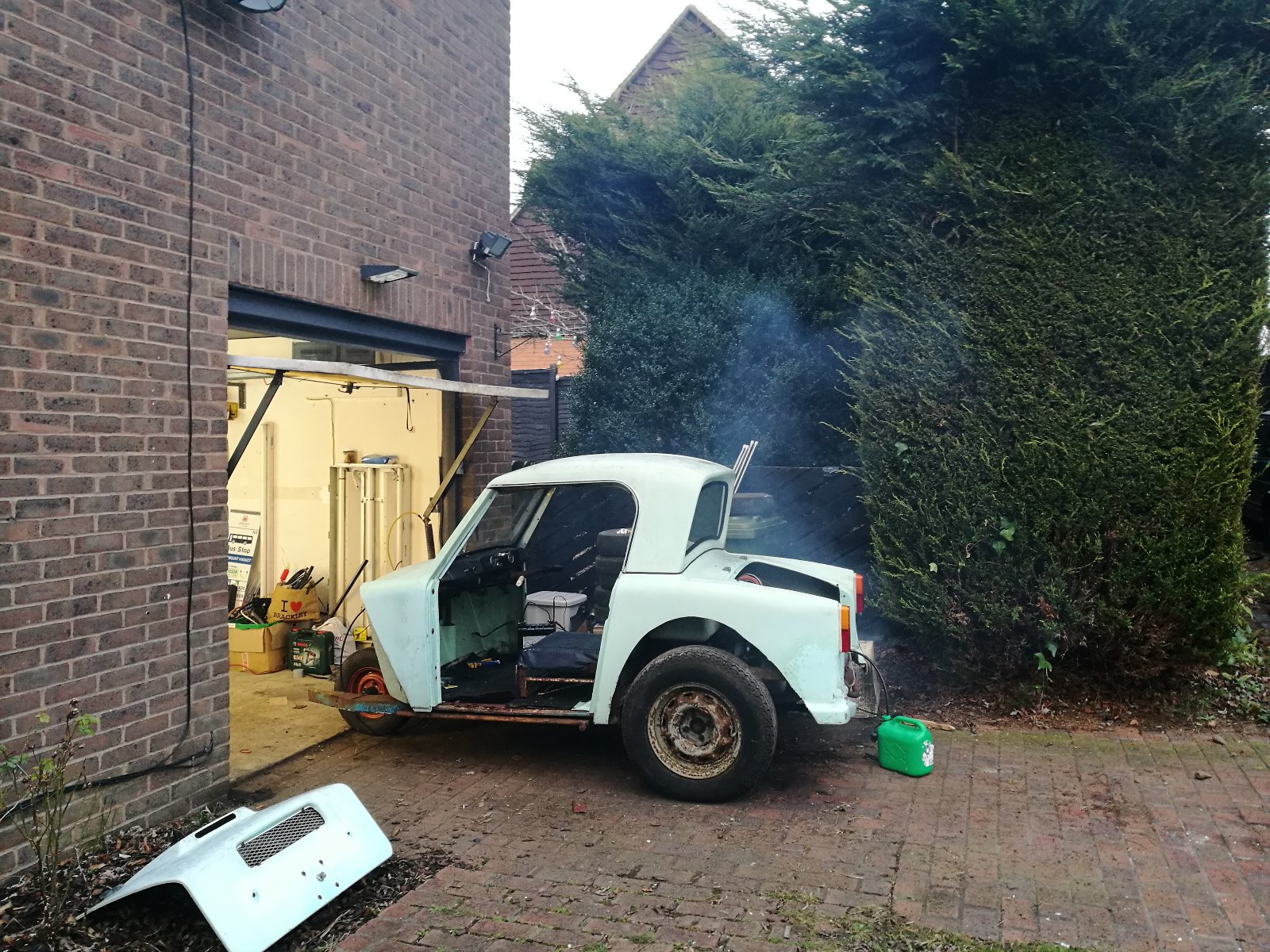

At this point I had no idea whether I had a spark or not...or whether it was timed anywhere near to where it had to be...however nothing there appeared to have been fiddled with - so I figured I'd give it a shot...and stuck some fuel down the throat of the carb and decided to see what would happen.

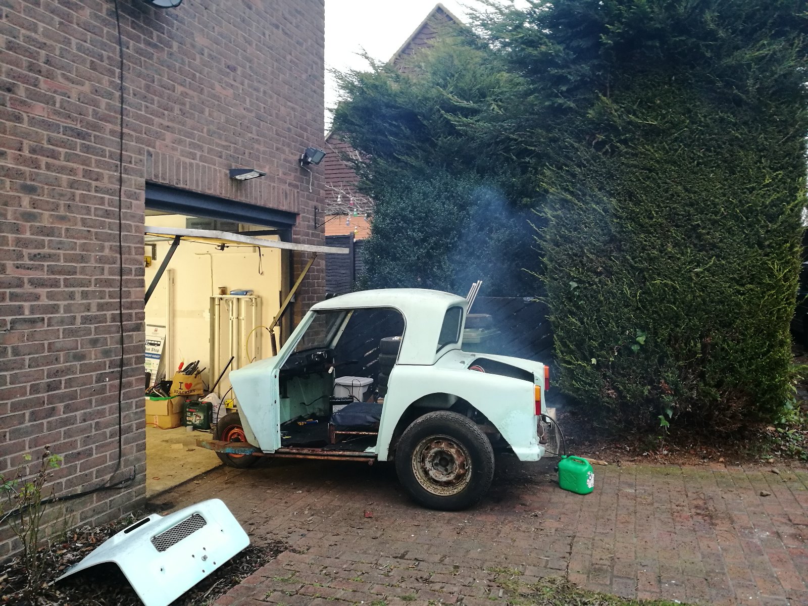

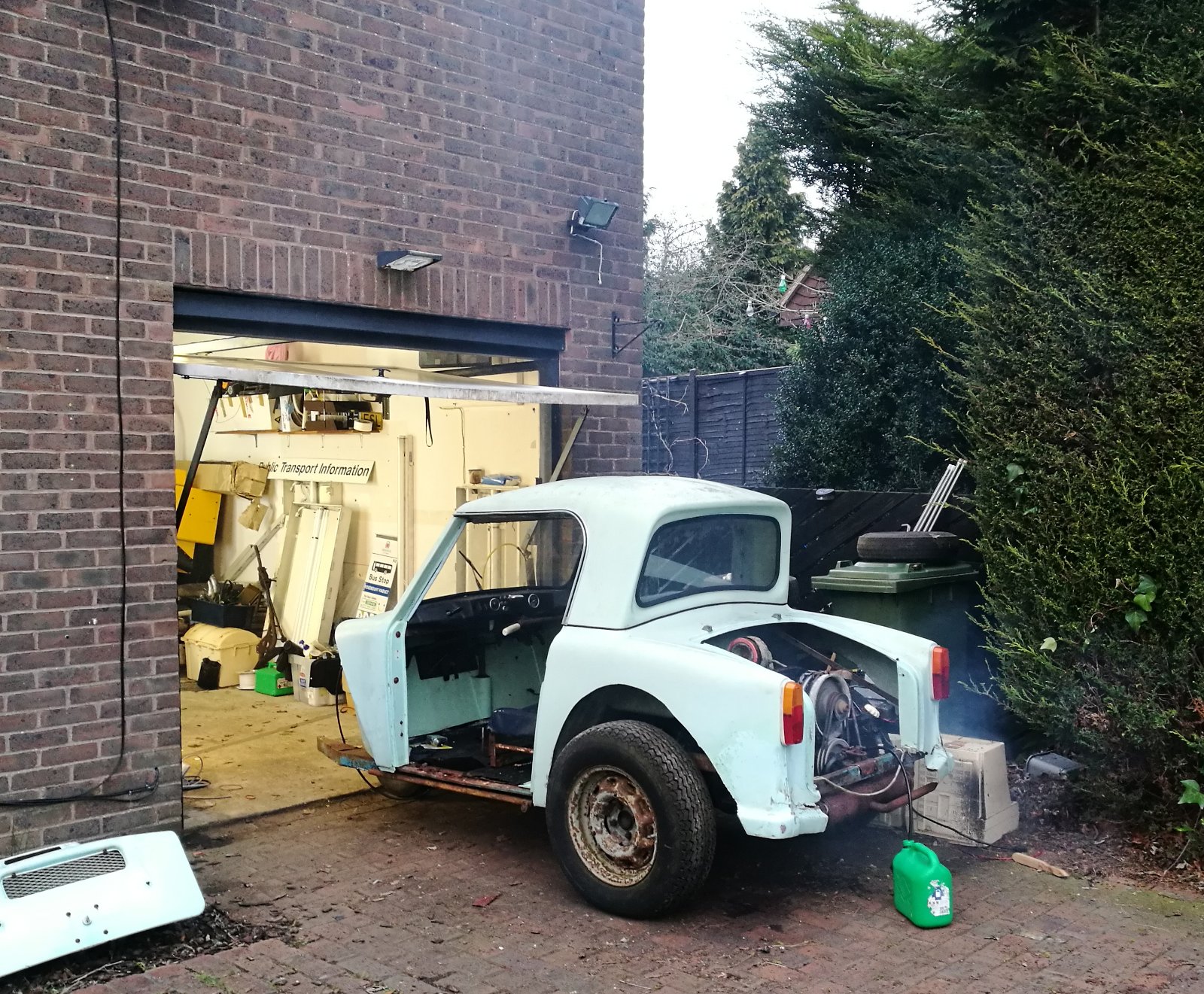

Okay, this wasn't the first start...That was actually quite anticlimatic and was a vague cough. This was after I'd fiddled with the (sticky) choke a bit, and had manually filled the float bowl, because the fuel pump currently isn't living up to the name. I'm guessing one of the valves is full of varnish as the filter gauze certainly was...Will try to pull it off tomorrow once I get a narrow ring spanner to get at it and have a look.
It was also a bit flooded as I'd accidentally scooshed a fair bit of fuel down the carb throat while filling the float bowl, but while cranking the engine didn't have a spare hand to operate the throttle with! She would have started instantly if it hadn't been for that.
To me it sounds like an extremely angry 2CV...and definitely seems to want to live.

I would check the dash light has not blown. If it has a standard alternator that bulb needs to be working for the exciter to work.

Blown lamp or dodgy connections in the lampholder are entirely possible given how long the dash has been open to the elements. It's first on my list to check. To be honest I was surprised to see the oil pressure light appear without having to attack the ignition switch with contact cleaner.
I believe that the dash lamp is an essential part of the circuit for the charging side of the Dynastart unit just as it is for a conventional alternator judging from the wiring diagram.

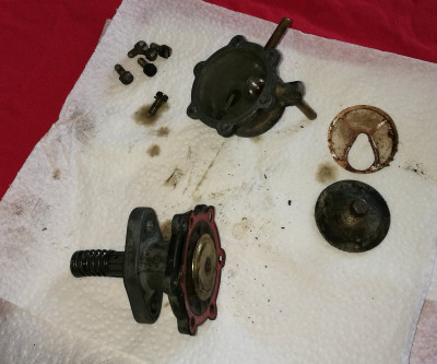

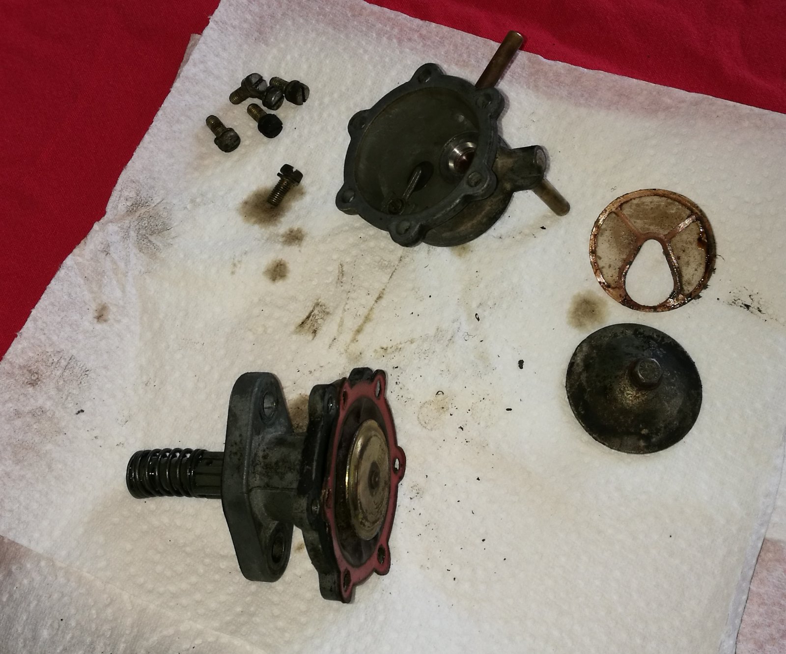

So, as mentioned earlier my fuel pump at lunch time was doing a good impression of a lawn sprinkler all over the offside exhaust downpipe...Less than ideal!
Here's a picture of it from when it was first pulled apart earlier.
Glad to report that the instant gasket, while not a long-term solution is doing the job for now. The pump is now happily doing what its designer intended once more. This was good because it meant that I could actually run the engine for more than a few seconds at a time.

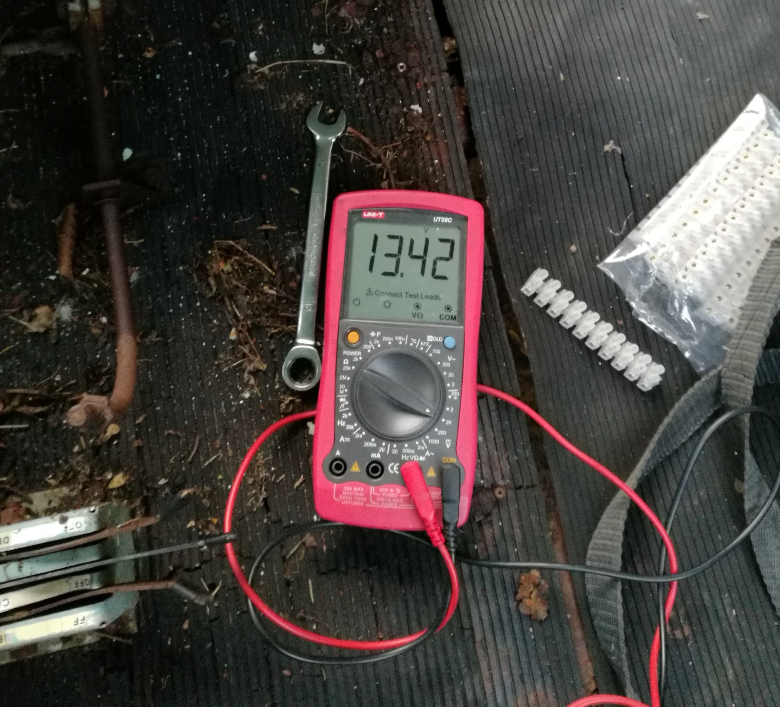

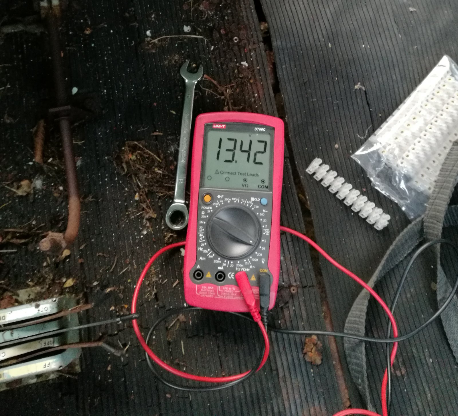

First up, charging system. I decided at this point to check properly whether it was *actually* charging, rather than assuming the system was dead based on one test in the half dark yesterday with the awful meter probes with which I couldn't get a proper connection.
Hey, would you look at that...it's charging! Still no light on the dash - though that looks like it might be a wiring fault as there's 12V on the brown wire with a yellow trace at the dash - but nothing on it at the voltage reg. So looks like there's an open circuit on that conductor somewhere. I've also figured out why the top fuse in the fuse box has been bypassed - that no amount of wiggling the fuse will get continuity across it. So the fuse box will come out shortly to be properly cleaned. I might actually just swap it out for a modern blade fuse box while I'm at it...I'm going to want to fuse more than two circuits at some point anyway, and you can't exactly get 25A and 35A glass fuses over the counter at your average motor factors these days...I'll go with a 20A and 30A blade fuse and just keep some spares in the car...

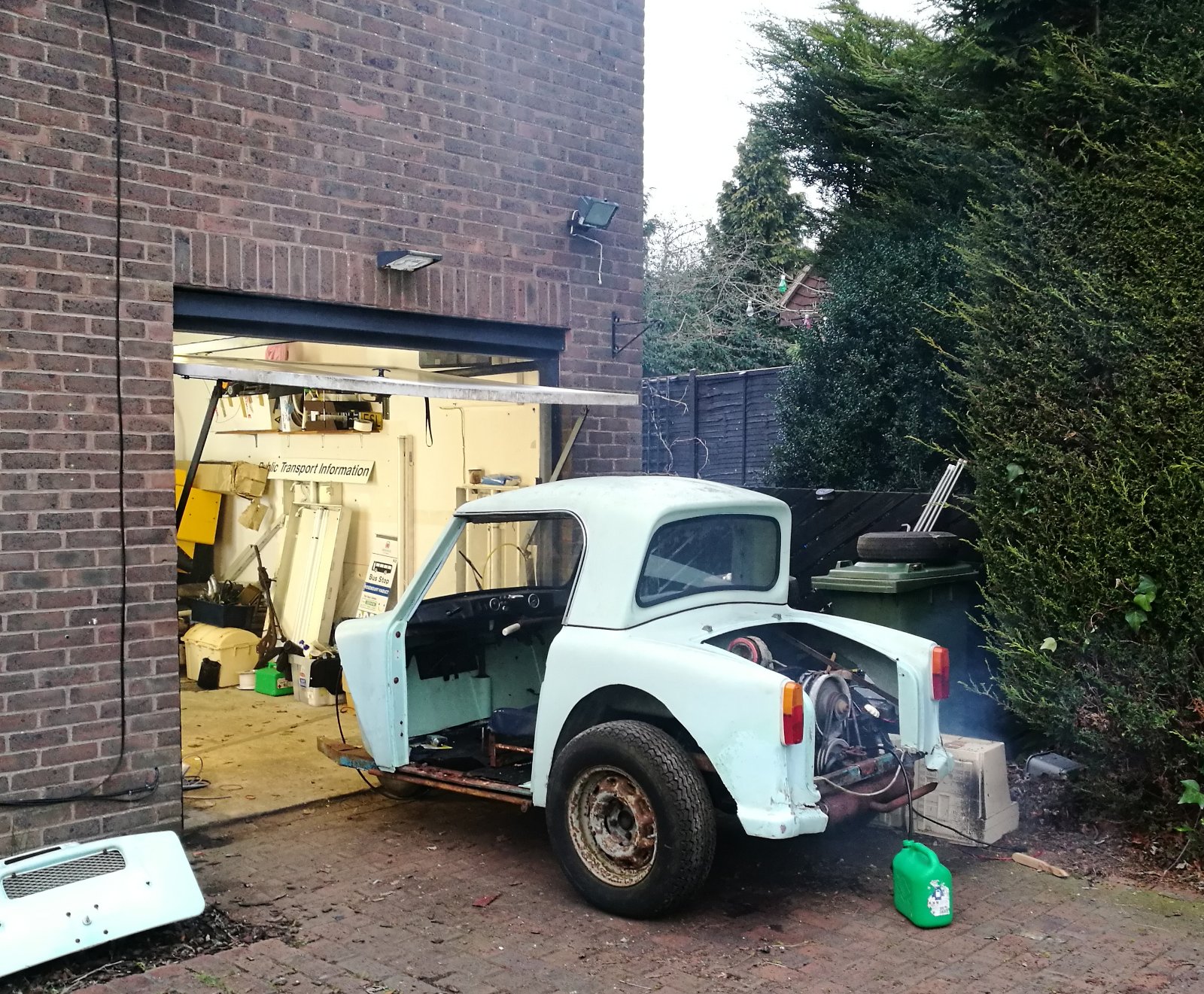

The carb is plainly not happy - any attempt to open the throttle sharply results in the mixture obviously leaning out excessively and all manner of backfiring through the carb - but given that I've literally not touched it yet that's hardly surprising. I'll pull it off shortly and give everything a good clean.
So...I knew the charging system was actually loading itself properly (and it looks like the voltage regulator is doing its job watching the meter), the fuel system was now fuel tight, and the engine sounded happy...time for another test! Does the drive system work?
Yep! It does indeed!
This test was carried out *very* carefully. This is primarily because the car currently has NO brakes whatsoever. Also as mentioned earlier, the carb is a bit sick, so the engine is currently struggling under any real load. The throttle is also sticking slightly which has resulted in a slightly high idle - hence the horrible crunchy noises at one point, as that's causing the clutch to drag a bit.
The only other issue I've discovered was that once the engine started to get a bit of heat into it, it started smoking like a cold Deltic!
Now, I reckon this exhaust silencer has been drowned in penetrating oil at some point, and the engine has sat for years with probably double the correct amount of oil in (not maybe a bad idea for it when in storage actually)...so this may well just burn off after a while. The oil that's in the engine just now is slightly too thin as well (20W-30 is recommended), so I'll change that out tomorrow and top it up correctly and set the engine to a fast idle for a while and see if it starts to clear at all.
