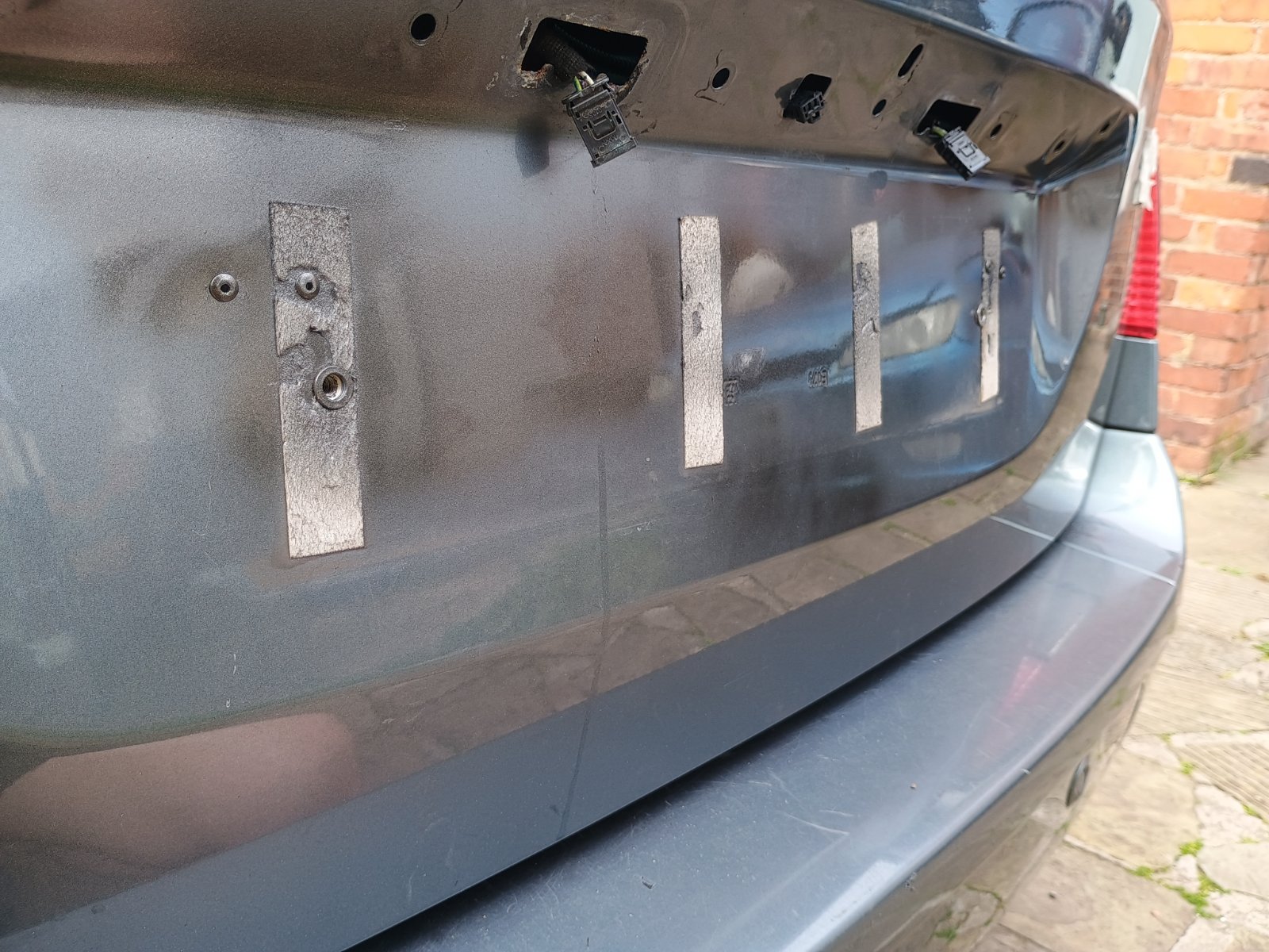

MattBLancs wrote: 28 Jun 2025, 22:26 The answer is an odd failure (and an odd fix) - unhelpfully I've painted it with a bit of the grey primer too.
So the odd fix for an odd fault is as follows:

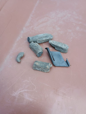

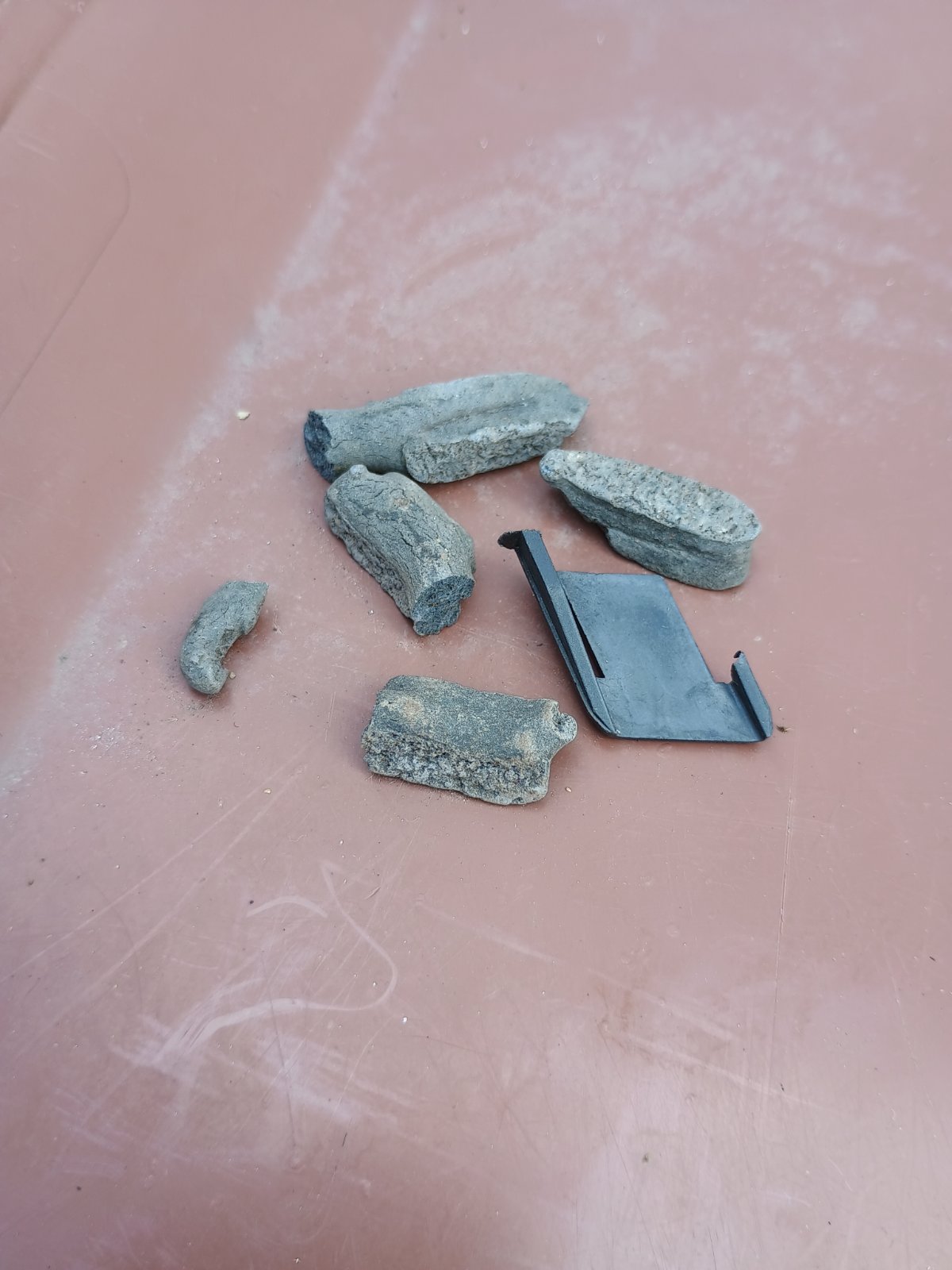

As long as we've had this car it's boot has shut with a bit of a rattle and bit of a clang.
The rattle seemingly, was this lot:
Rock hard lumps of seam sealer and a broken clip
These were floating about in the void between two layers of the boot structure.

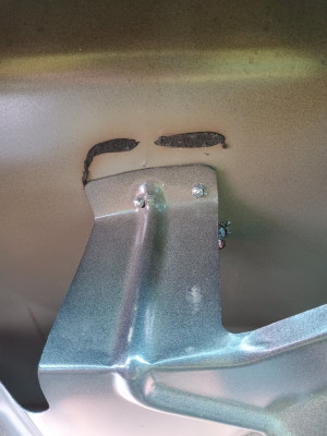

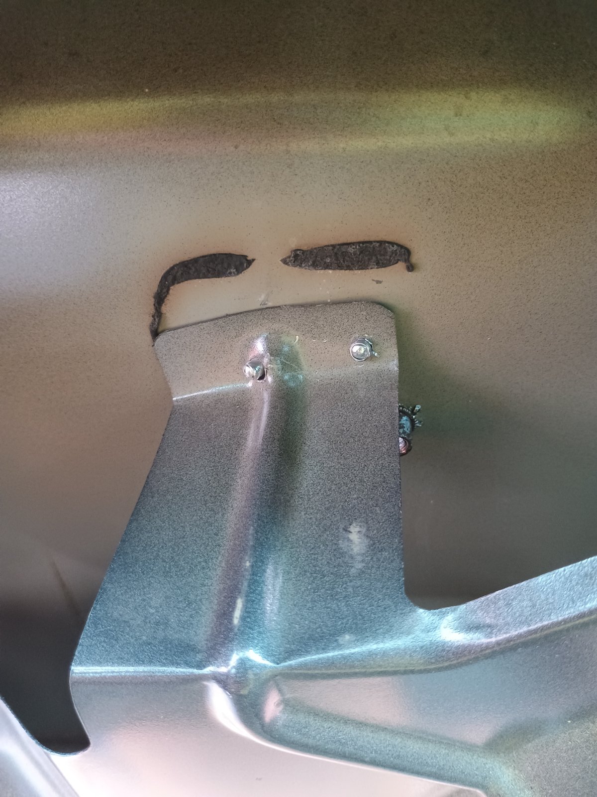

The clang was these two "links" between outer and inner, seemingly bonded together with a black sealant. In service life of that is obviously long past as neither link was actually stuck to the other surface!
Black sealant (and pop rivets - explained below)

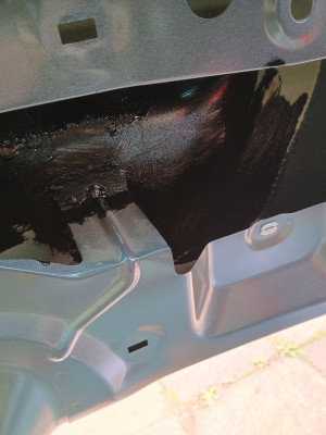

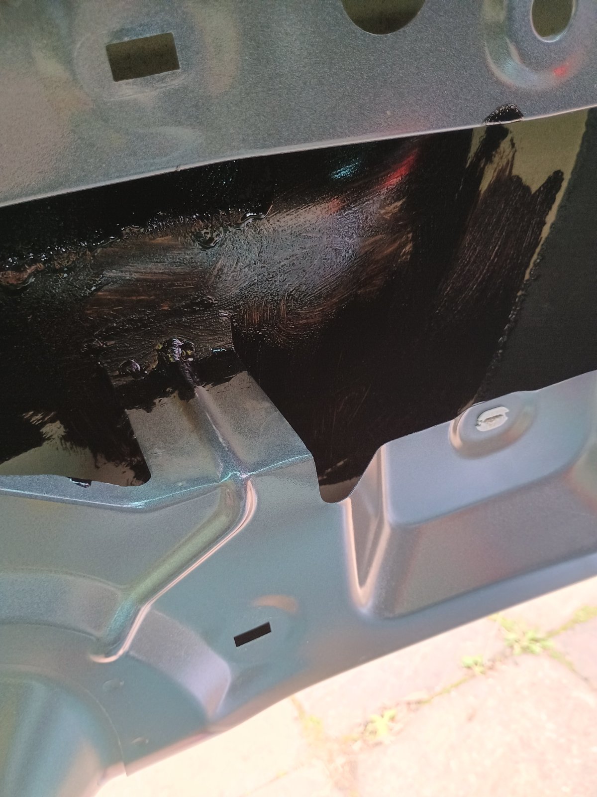

Black gunge also explained below

I worked out I could pop rivet the two struts in place and better yet that the rivet heads would sit behind the numberplate. So that's what I did!
Black gunge a bit of waterproofing, a bit of it's claimed "reduces drumming"

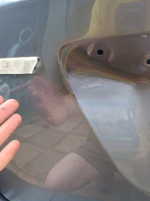

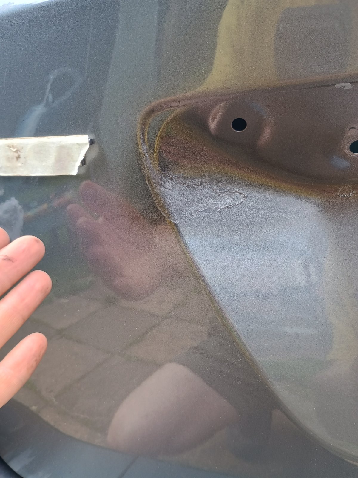

I bought some "matching" spray paint from Halfords, it's fair to say given reg number and then paint code inputted for it to come up with this choice and think it matches in terms of "grey" and "metallic" and that's about it!
Grey Thorium my arse!

Oh wow, what a colour match, even a blind man could spot the difference
Posts: 5359
Joined: 25 Apr 2022, 09:03
x 2364
Unread post by MattBLancs »
Rp0thejester wrote: 29 Jun 2025, 22:13 Oh wow, what a colour match, even a blind man could spot the difference
Yes, pretty terrible! Nevermind. I've got two tins if this stuff in the way:
https://ebay.us/m/sGiJ0S
KTH GRIS THORIUM GREY FOR PEUGEOT AEROSOL SPRAY PAINT 400ML
Hopefully a good match.

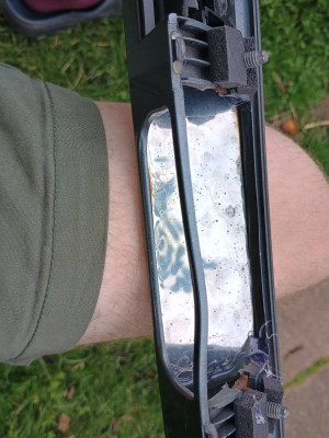

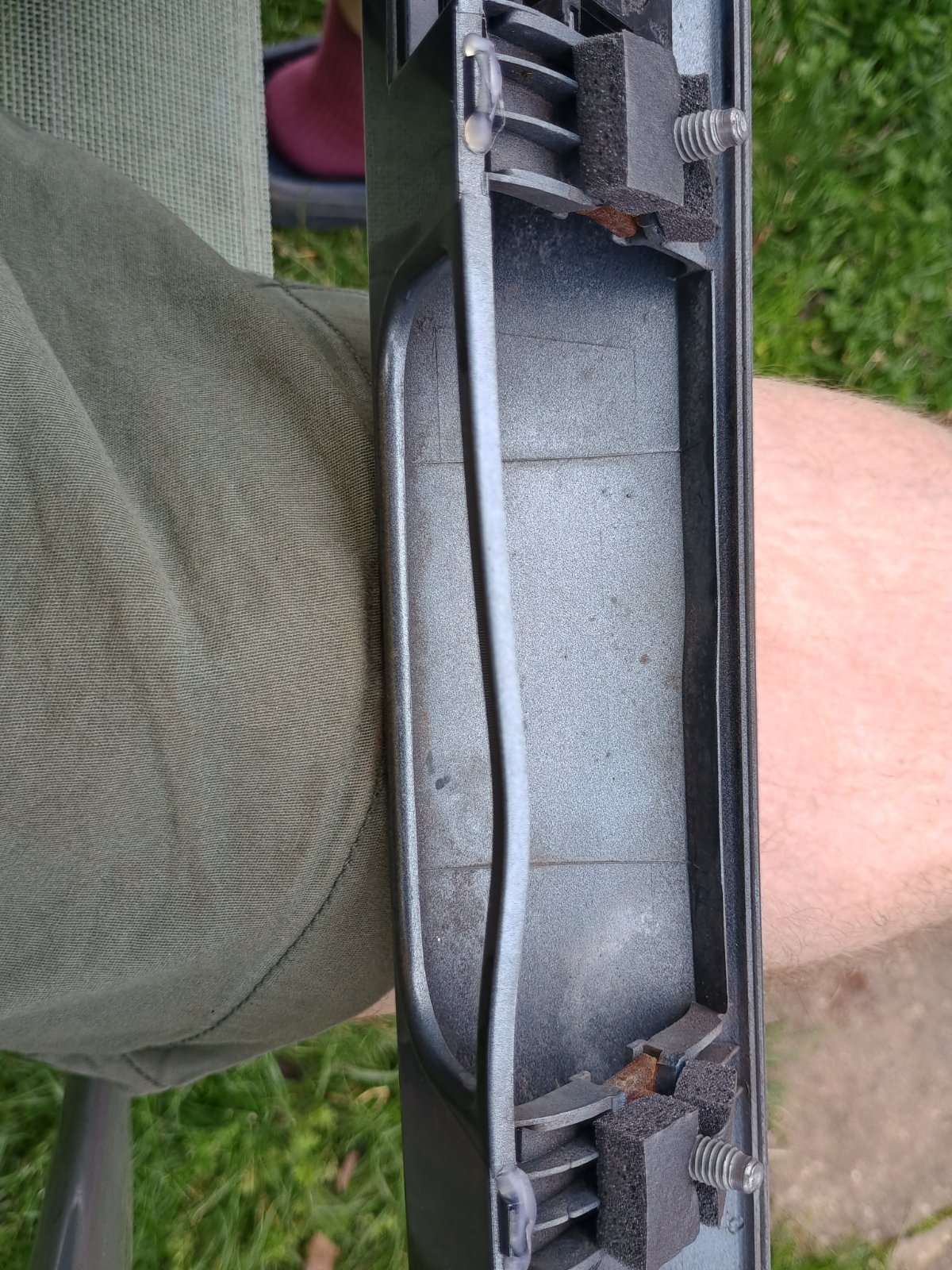

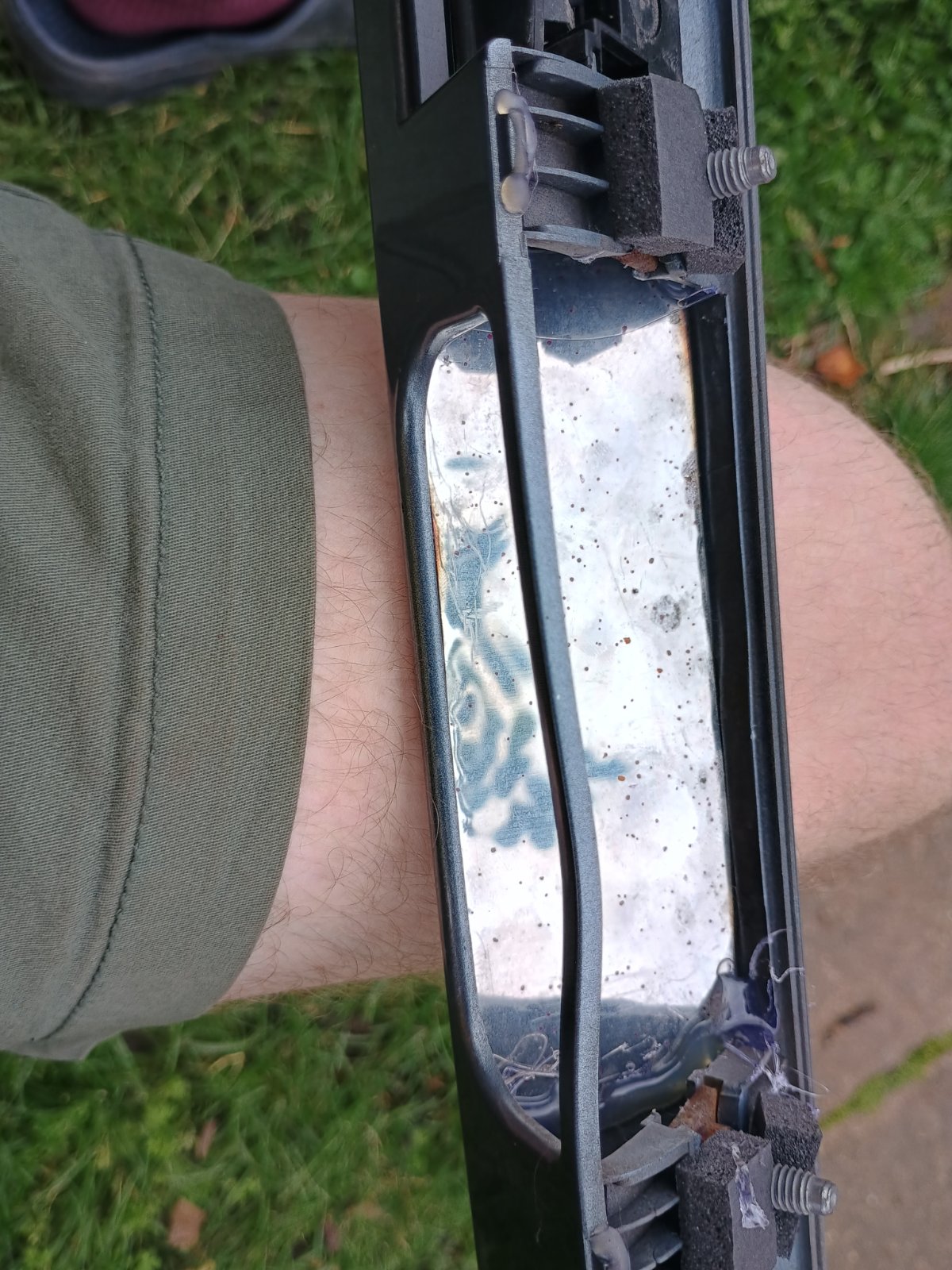

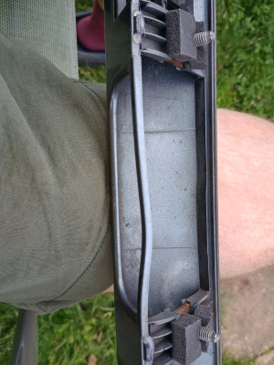

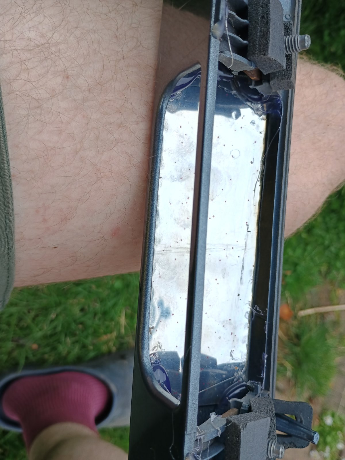

Oh, and in my usual "not really a significant problem but I'll fix it anyway" approach, the rear numberplate lamps, which seem to shine light up inside the handle/trim as much as actually at the number plate! Now have stainless steel (ex cooker hood) reflectors to bounce the light back down again:
Before
Before
And after:

Apologies for the knees, obviously
