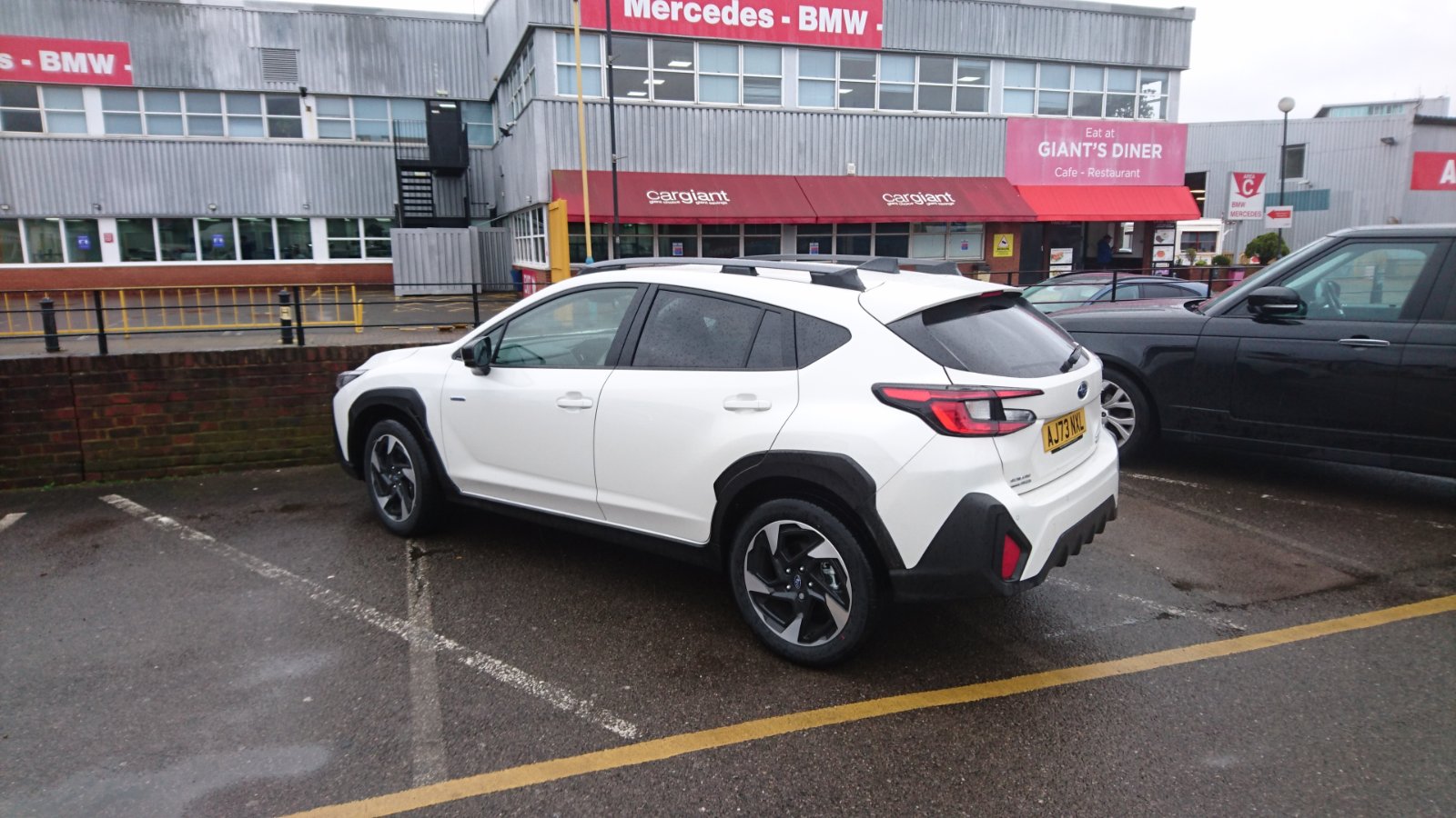

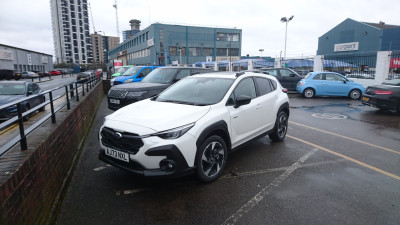

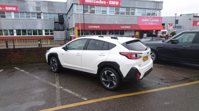

Here are the pictures which should show why I thought the build quality and general design was very good indeed, as I would expect from Subaru.

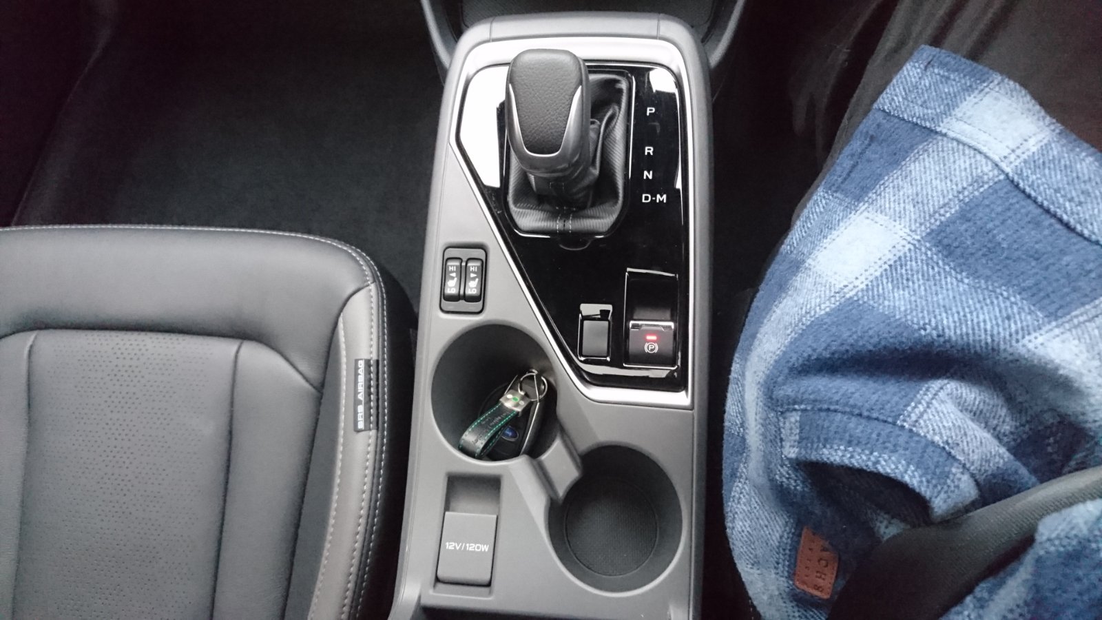

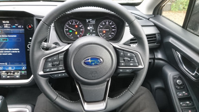

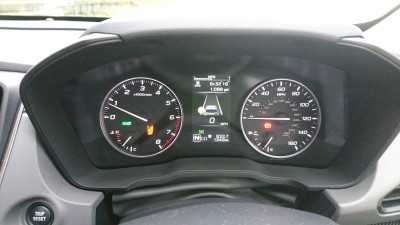

You will see the info screen and the instrument binnacle are well laid out and very clear to view and intuitive to use. My phone paired instantly and was very good voice quality in use. I could have allowed the system to read my messages and present them on the big screen but me being me I did not permit that. The centre console was also well designed and pleasant to use with ample storage.
Performance was excellent in terms of acceleration and cruising and I achieved 53 mpg over the day. which was 130 miles of return trip to Cambridge + running around in north west London to visit Car Giant at White City. Comfort was fine and the seats felt comfy and secure. The steering wheel could be slightly thicker to hold and was loaded with many buttons which I would seldom use and flappy paddles which worked very well traversing hills.
From the front
From the front
From the back
From the back
Binnacle
Binnacle
The wheel
The wheel

Centre console
Centre console

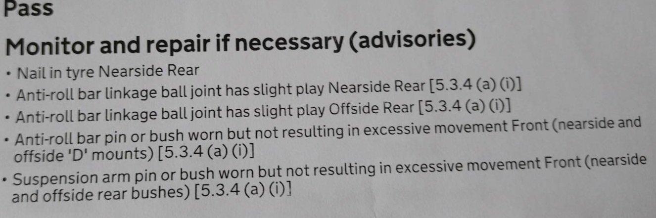

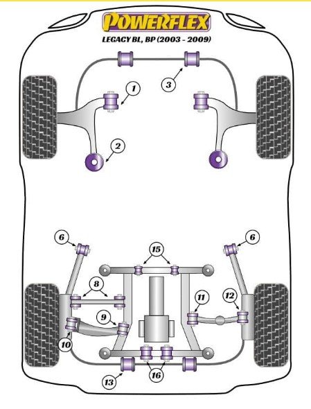

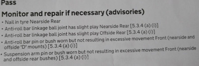

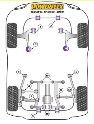

I took the Legacy for its MOT today which I'm pleased to say it passed. However I have some suspension bush advisories and I am trying to match up the MOT words with the bush diagram below to work out what parts I need. Opinions would be much appreciated!! :-D
The MOT advisories (nail sorted!)
The suspension diagram

I'd say the first two are your rear anti roll bar drop links, the next one would be number 3 both sides in your diagram, and the last one would be number 2 both sides.

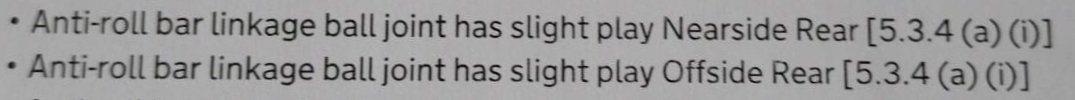

Mick's Legacy ARB - Mick's work
This refers to the ARB links....... as it says so.
Mick's ARB bush - Mick's work
This refers to the ARB mounting 'D' bushes which will look approximately something like this......
ARB bush - eBay
ARB bush - eBay
Mick's suspension bush - Mick's work
This refers to the FRONT suspension arm, and of that - the rear bush(es) of the two bushes in each arm.

Great bobins, thanks So is this the correct referencing to the diagram numbering: :)
bobins wrote: 28 Feb 2024, 20:33 Image
This refers to the ARB links....... as it says so. NUMBER 10 and NUMBER 12
This refers to the ARB mounting 'D' bushes which will look approximately something like this...... NUMBER 3s
This refers to the FRONT suspension arm, and of that - the rear bush(es) of the two bushes in each arm. NUMBER 2s

mickthemaverick wrote: 28 Feb 2024, 20:46 Great bobins, thanks So is this the correct referencing to the diagram numbering: :)
Nope, not for this one. ^^^^^

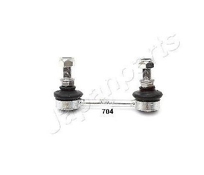

Your Powerflex diagram only shows for replacement bushes and not ARB links. The Anti Roll Bar linkage you need should look something like this....
Legacy ARB link - ebay

You might want to do a bit more research if you are actually thinking of using Powerflex bushes on your Legacy. Whilst they undoubtedly have their uses, there's an awful lot to be said for getting OEM or decent aftermarket ones from the usual reputable manufacturers. I looked at using Powerflex ones on my hairdryer and decided against it.
