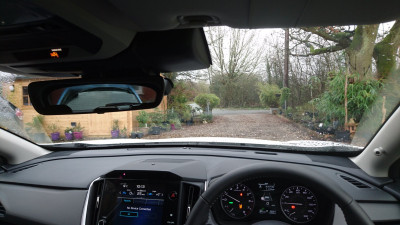

Here are the pictures which should show why I thought the build quality and general design was very good indeed, as I would expect from Subaru.

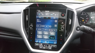

You will see the info screen and the instrument binnacle are well laid out and very clear to view and intuitive to use. My phone paired instantly and was very good voice quality in use. I could have allowed the system to read my messages and present them on the big screen but me being me I did not permit that. The centre console was also well designed and pleasant to use with ample storage.

Centre screen
Centre screen

So looking at all those you may wonder Would I buy one? Well the answer is a resounding NO, but not for any of the things that I have moaned about above, there are two reasons why I wouldn't, price and
Spoiler: show
the driving position. I found it very difficult to see to the left at tee junctions without crouching to get my eyes below the centre monstrosity that houses all the gubbins for the features I don't want!!
The reason I'd never buy one, camera on the bridge of my nose!
