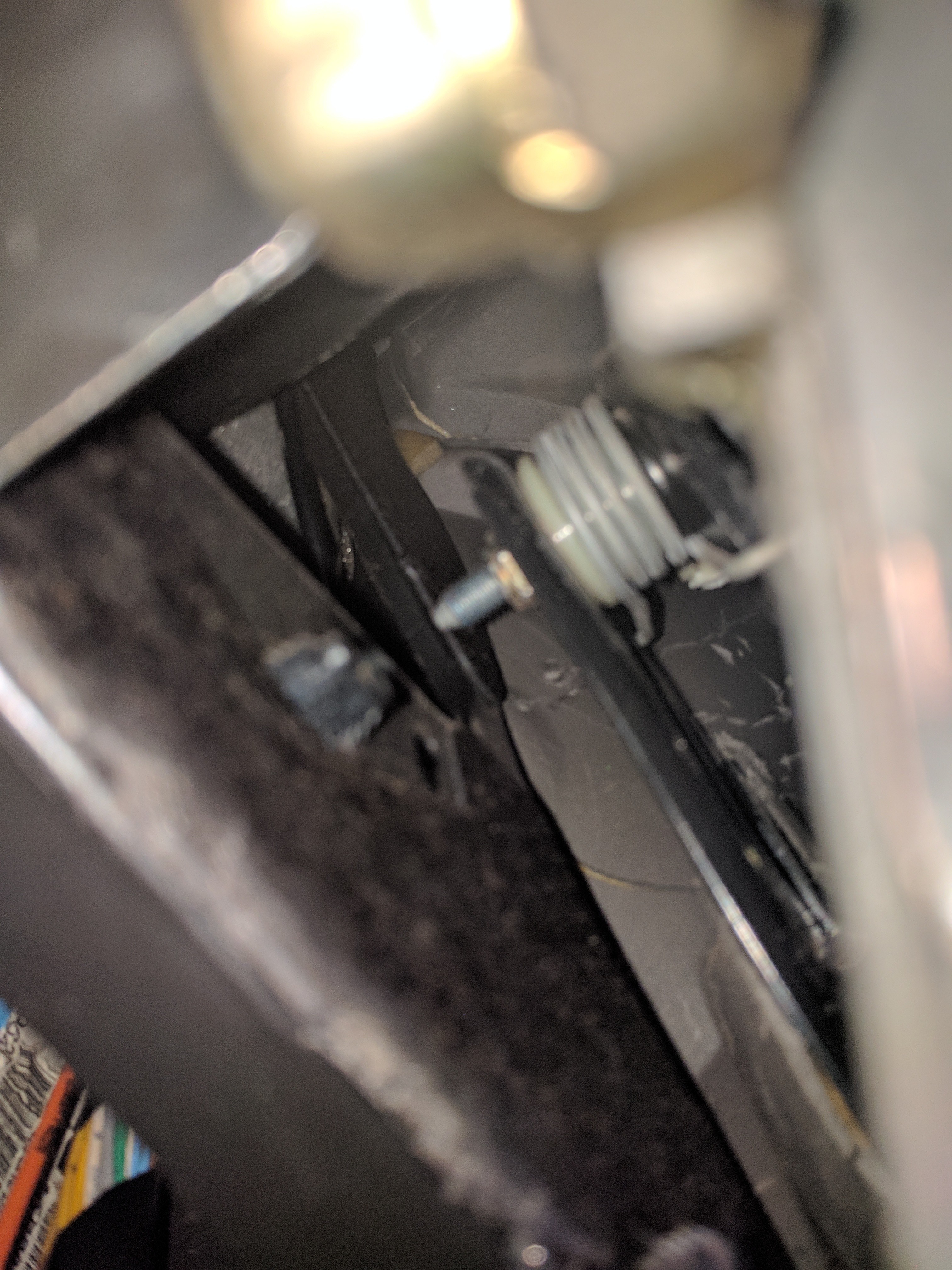

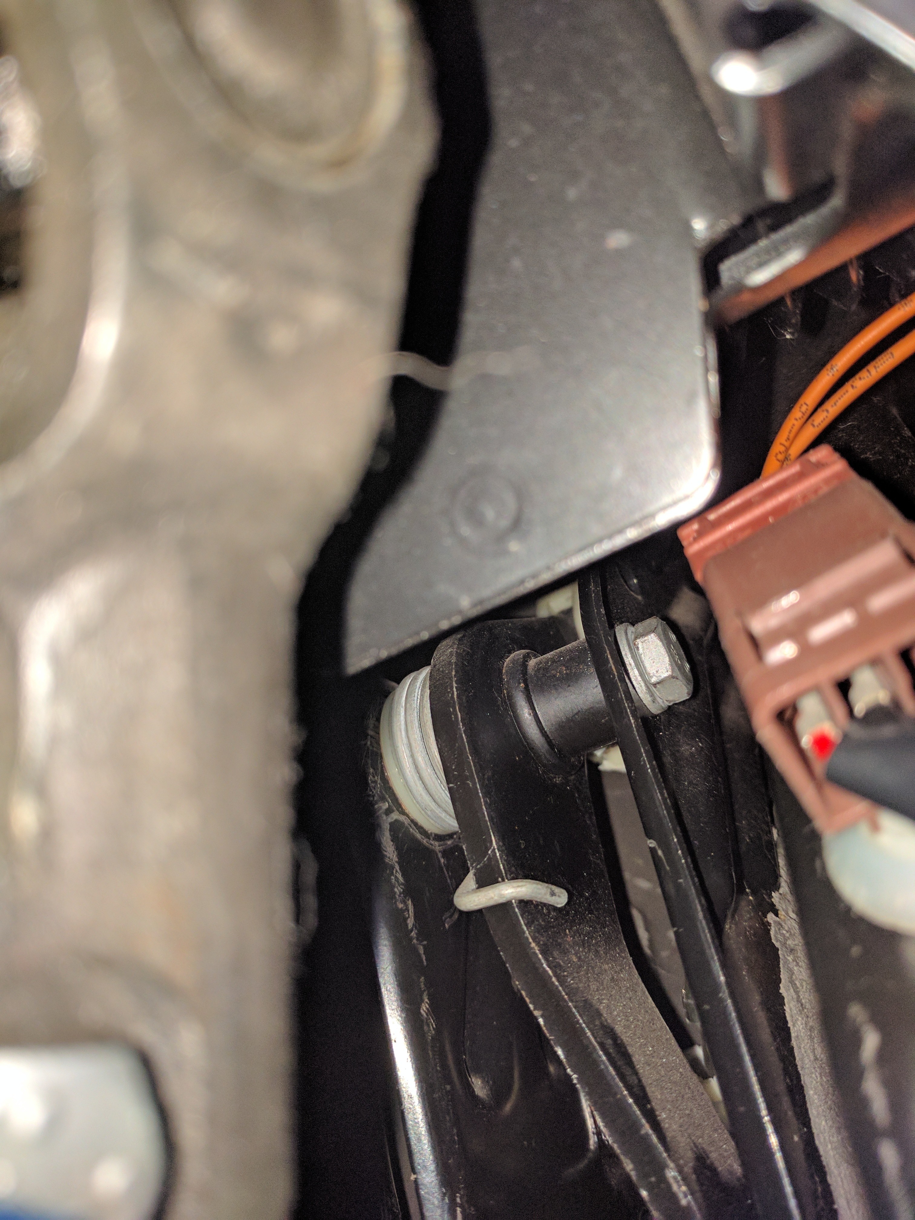

The nut is the centre console side
and the bolt is brake pedal side

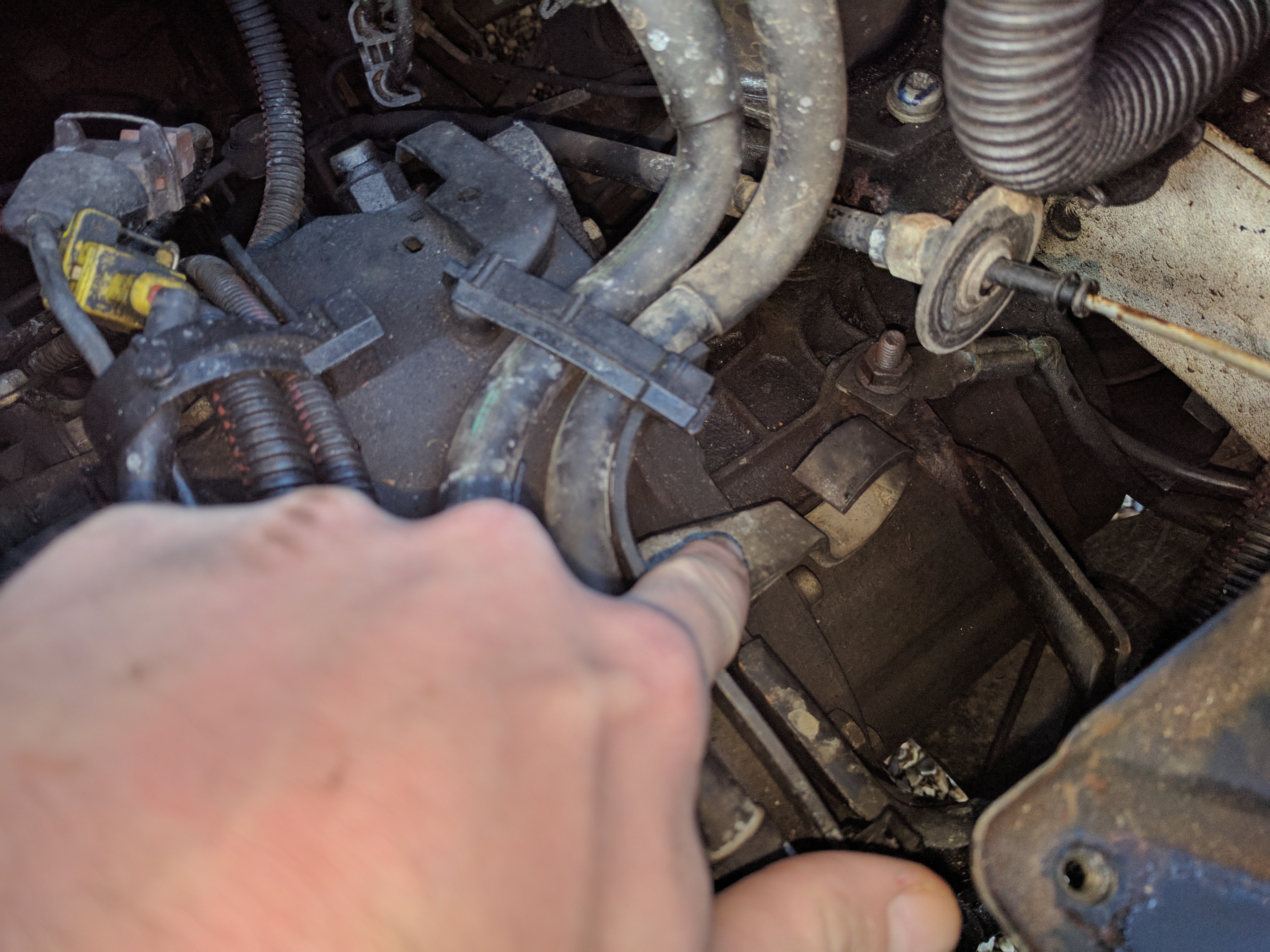

Into the engine bay, and is this the bit the cable pulls on to release the clutch? Should I be able to move it with my hand? Because I can't...

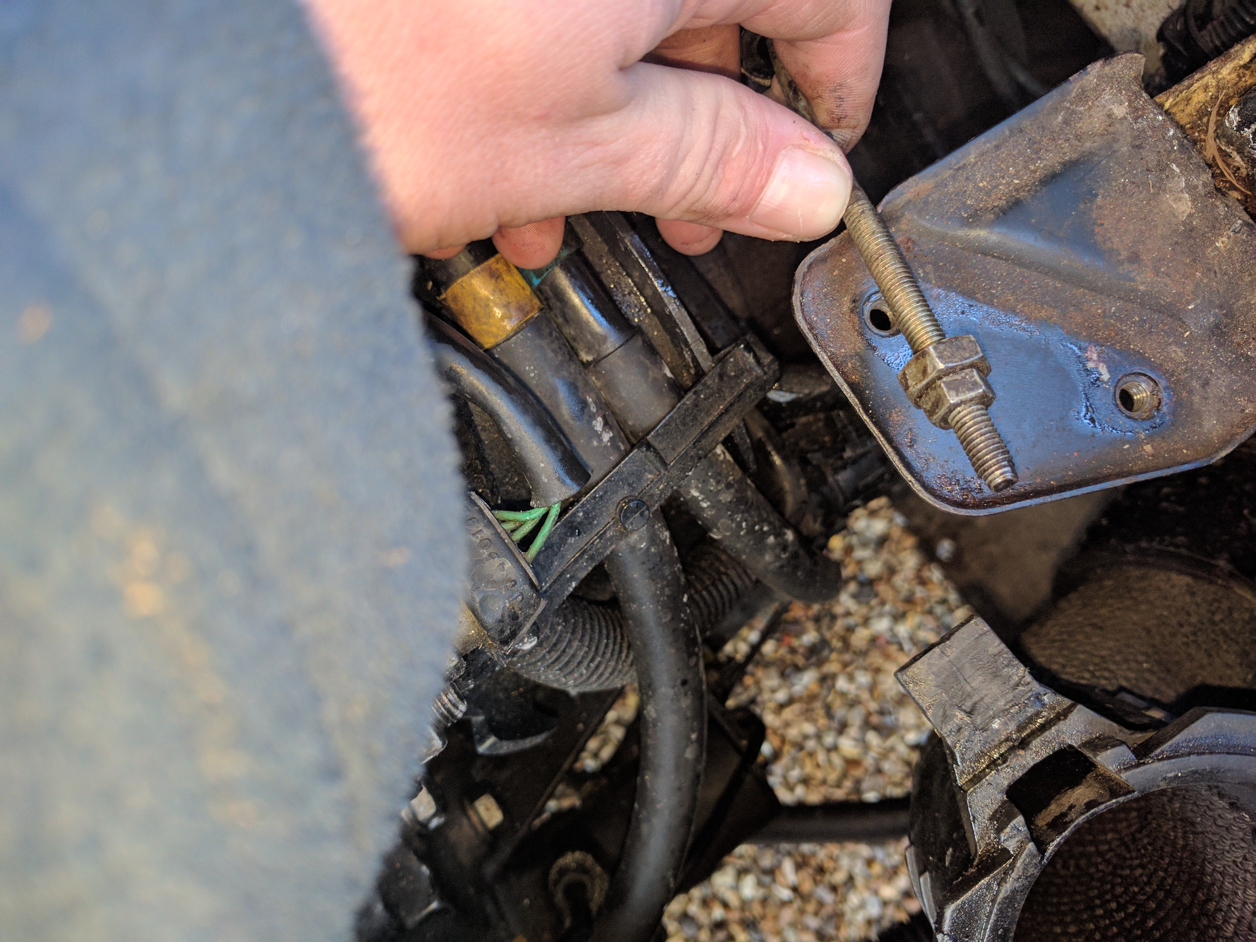

This is where the adjustment is on the cable
The cable does push and pull freely tbh, I did dribble some plusgas into the end but I dont think it did much

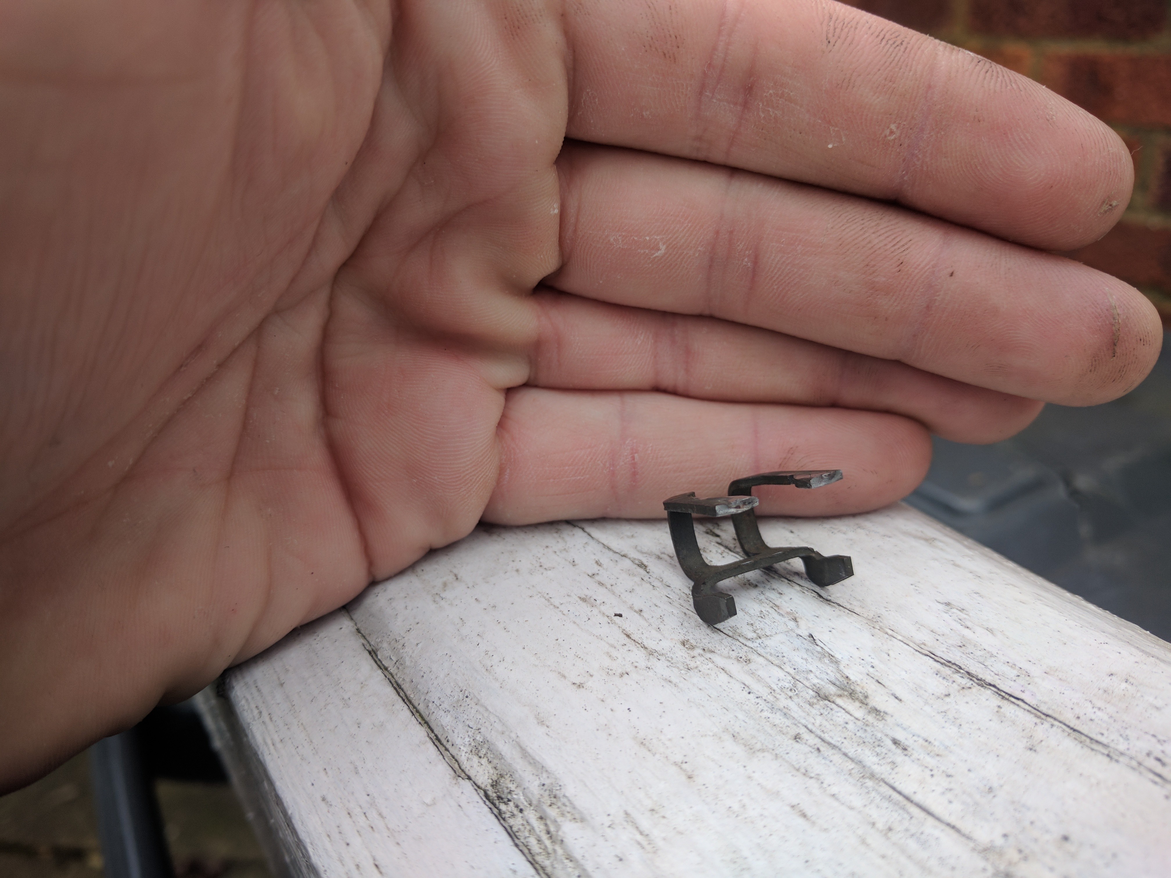

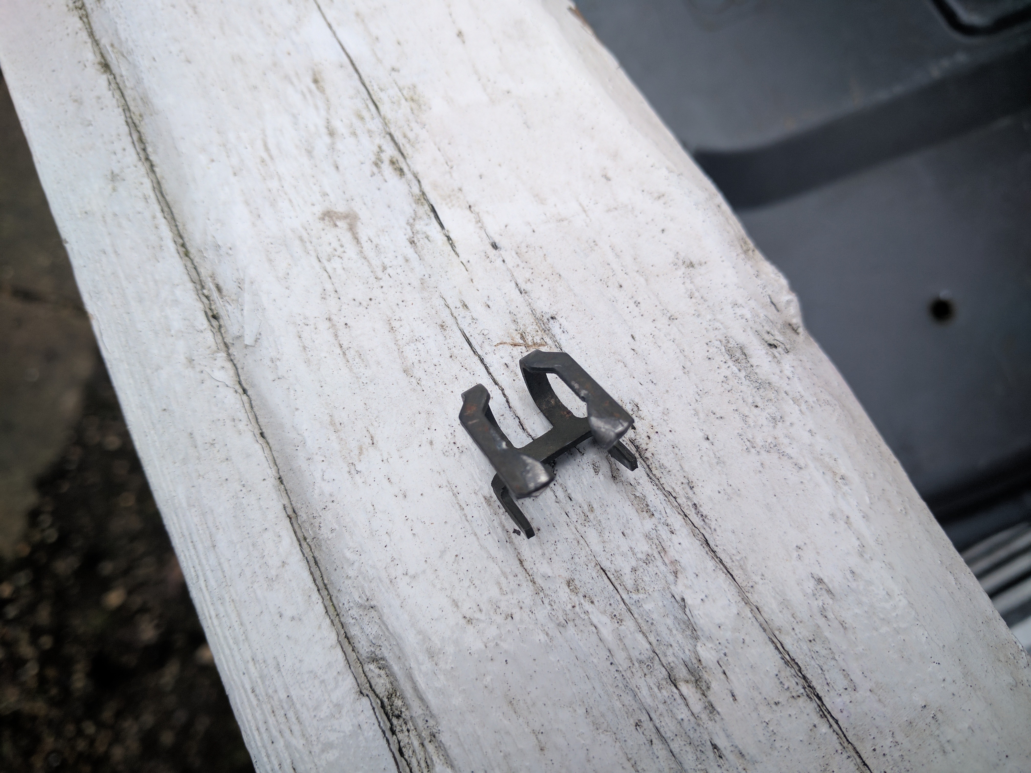

With all the pushing and pulling though, the metal clip fell out and buggar me it looks broken, is it?
If it is then thats game over as I cant find one on the internet anywhere, and the only physical place I can find is a place in Uxbridge that has it in stock but doesn't take card over the phone nor post stuff out...

Top should not be too floppy Sam... Turn the adjuster in until the pedal rubber sits at the right distance from the carpet - about 6 inches - and trim from there slightly to get a nice middleish bite...

I don't think that clip is broken, but it probably is a bit tired. It might be OK for a short while if you carefully squeeze it back together, but I would plan on replacing it.
Sadly that bolt is in the wrong way round - suggesting the clip has never been changed, so it has done well! You also have a manual adjust cable, so getting the spring back on the pedal, is, er, interesting.... Here's some info on doing it, looks like I was doing it just about 10 years ago! viewtopic.php?t=21201
