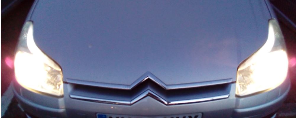

Cree LED's arrived this morning, Marc. Thanks for the recommendation.
They look very robust and well made and hopefully won't suffer the "sequencing" my current sidelights contracted.
- x 6948
Re: MikeT's C5r 1.6 hdi Estate
Good luck with them - It would be good to see a picture of them afterwards Mike.

Well just having a well earned cup of tea after replacing two sides and two dipped and there's certainly room to make this job a long winded affair even with a little experience under your belt!
The biggest time-waster is observing the correct battery removal and reift procedure, especially if you find after all that the nearside sidelight wasn't glowing!!!!
Then there's time needed for hunt and retrieve the small round black fastener you just dropped down the crevices of all the small round black parts in the engine bay.
Only to have to do it all again because you forgot to reconnect the bonnet switch and hydraulic pump connectors.... after refitting the battery and covers.
What I will say though is the headlights are a doddle, taking literally just a couple of minutes each to remove and fit. It's the sidelights that took most faffing about as their orientation is lop-sided, if you know what I mean? The slots to line up are at something like 2 and 8 o'clock.
