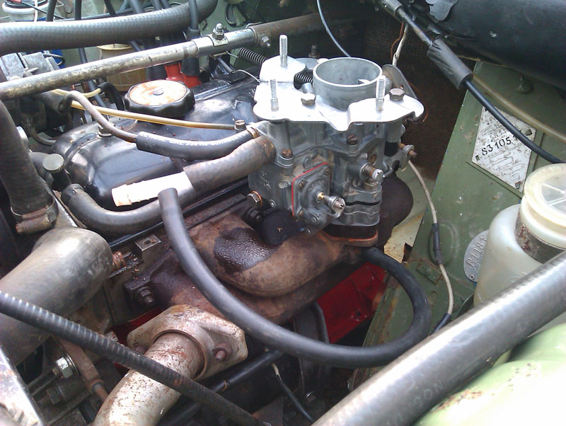

Not been able to do as much as I've wanted as I've been shot down with flu for the past week or so. Here's a little report on the carb. The replacement air jet I got turned out to be brass plated, which I had not expected at all given that I didn't go for the cheapest option, so silver soldering didn't work, it just tried to melt the end of the jet that connects to the emulsion tube. That means I couldn't get the two parts stuck together and I was pretty fed up about it, my only other option was going to be a new carburettor at £100+ until I realised after a bit of research that Chemical Metal should be suitable for glueing the emulsion tube and corrector jet together since it's tolerant to 120C and fuel resistant. I've also learned that Solex can be an absolute nightmare to get parts for, they just don't seem to have the support of things like Weber or SU. If someone hadn't pulled out the original emulsion tube and broken it (long before I got hold of the car) before jamming in the wrong kind of air corrector, then we wouldn't be having this problem.

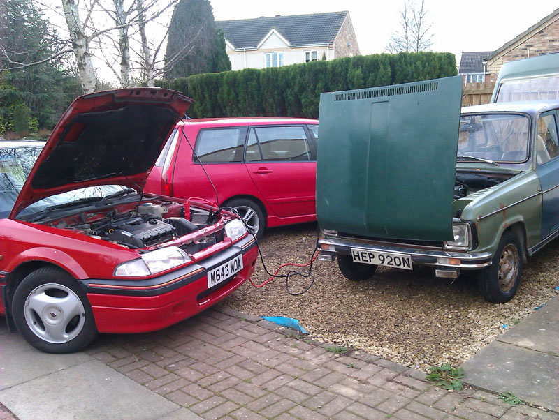

Today I did some work on the Renault and failed to tick off any jobs on my list. Oh well. I wanted to try and get it running since the new radiator arrives next week and I'd got the emulsion tube/air corrector repaired and the carburettor all rebuilt. So, plonked the carburettor on the car, reconnected the battery, stuck the key in the ignition and.... dead. Flat battery. So I had to get the big red booster pack out.
Which worked quite well. Key back in the ignition and we have life. Also, strangely, the headlights came on main beam once the jump leads were connected even though I'm sure the lights hadn't been left on, it's the sort of thing you would notice and you can't put main beam on by accident. Very odd, anyway, got the lights turned off and let the car charge up for a little bit.
Tried again. I'd rebuilt some of the vacuum/breather system, you can't get the original Renault T piece and my old one was so fragile it broke even more when repair was attempted. Therefore, I've used a modern T-piece and various lengths of pipe to mimic what was originally there. I'm missing the one that runs from the T-piece to the rocker cover because I didn't have a suitable diameter piece of pipe but since I wasn't sure that it was enough to stop the car running, I tried it anyway. You can also see here where the float drain bolt had leaked onto the manifold, I did tighten the bolt up after the photograph was taken, it just needed a quick tweak. If nothing else, it provides proof that fuel is indeed reaching the float chamber.

Just noticed in your pic is the tee piece end open? Try blanking it off.
