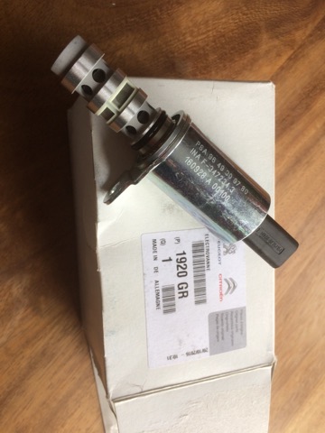

Peter, fingers crossed the new VVT solenoid cures all the issues...

CitroJim wrote: 05 Nov 2017, 04:05 Peter, fingers crossed the new VVT solenoid cures all the issues...
Well it looks like good bet so I've ordered one.

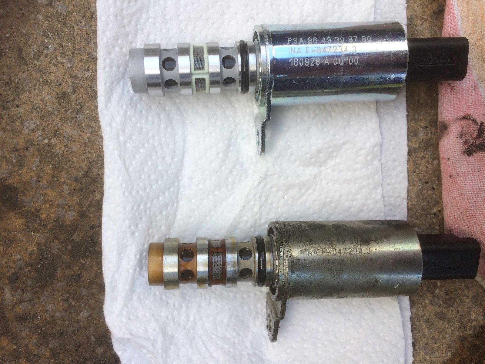

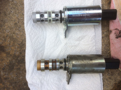

Re: FakeConcern's C4 VTS
That's an interesting looking device Peter...
I guess it's an electrovalve and oil pressure is used to activate the VVT?

CitroJim wrote: 09 Nov 2017, 17:32 That's an interesting looking device Peter...
That's it in a nutshell Jim.

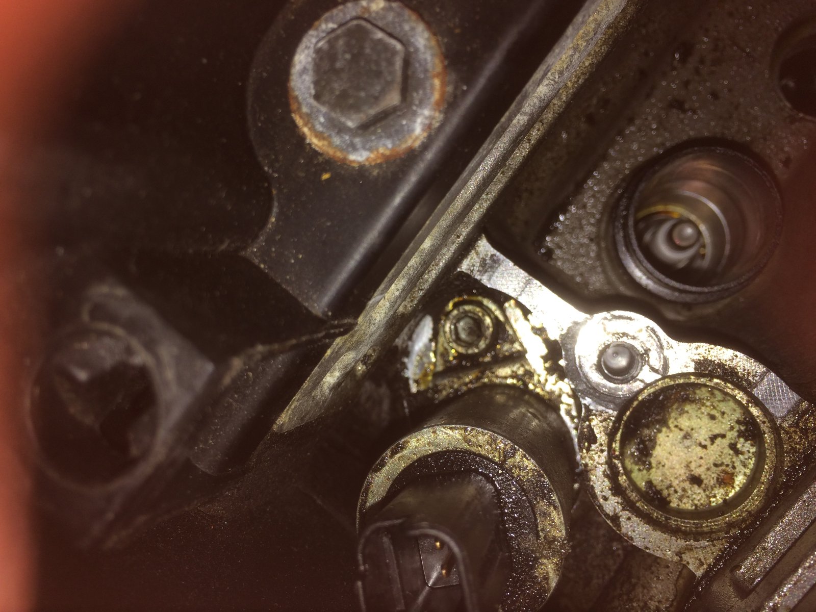

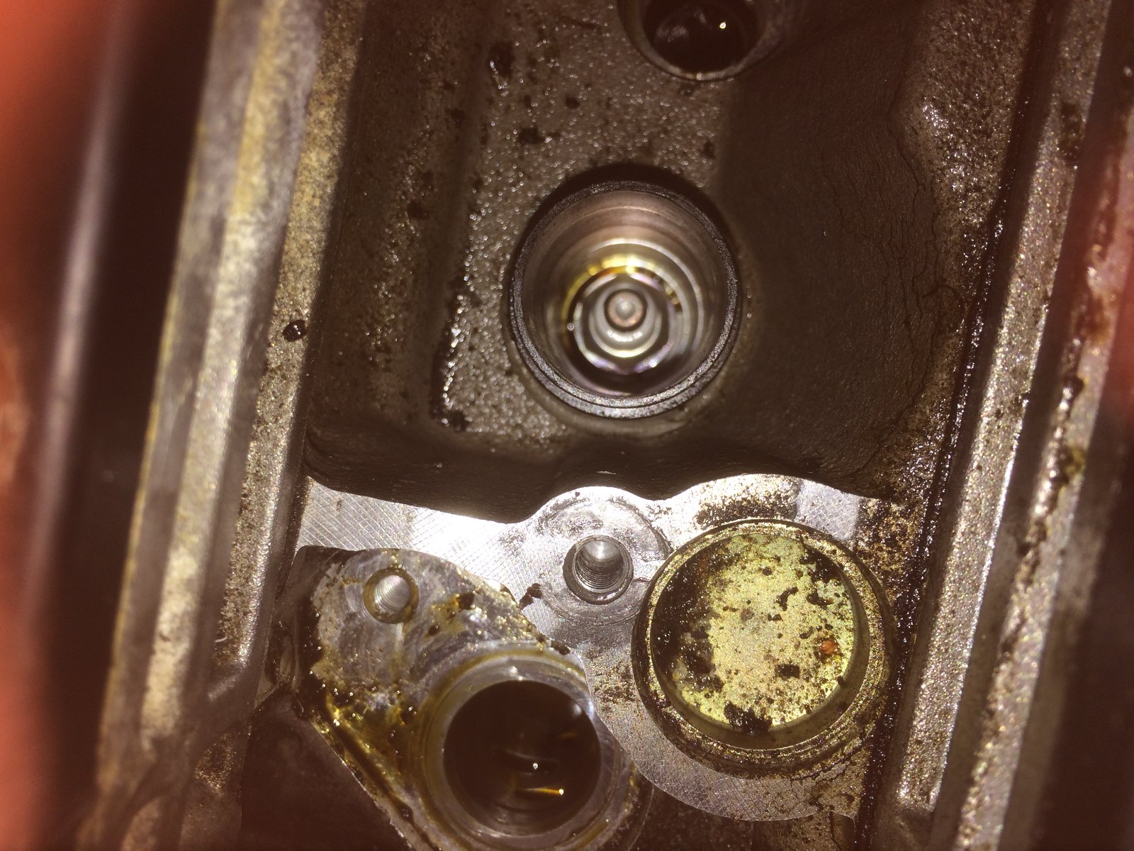

Update! I was hoping to do another video 0-60, but not had a chance. Having driven it around for a bit now I can say that it does feel like a VTS should, but it's not so much how well it goes now, more how it kept feeling flat before-if you see what I mean!
Old one was a bit of a pig to get out due to access
Came out with a bit of help from some waterpump pliers (never been used on any waterpump)
