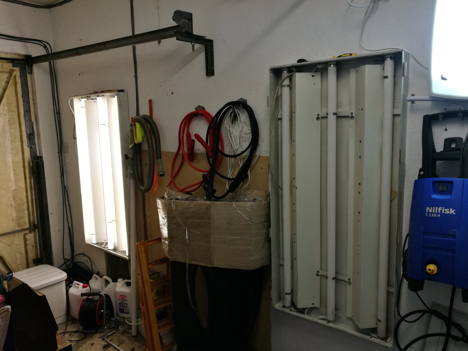

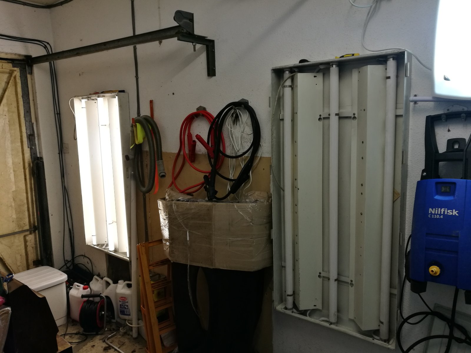

I've also been working on some improvements to the lighting in the garage. Ours like many was originally equipped with a single overhead light fitting. Albeit a decent quality one unlike you're likely to see these days. That's fine for wandering in to get stuff out the freezer, but utterly useless in a working area.
Once I'm done there will be somewhere in the region of 1.5kW of additional fluorescent lighting attached to the walls in my garage. Only one fitting fully set up so far, but getting there.
There are four more of these 3x40W beasts (circa 1967 and still going strong) and a random assortment of other fixtures I've accumulated over the last few years for this job. All magnetic gear so should be a case of fit and forget rather than having HF gear going pop after six months.
Gives me a bit of satisfaction that these five fittings are getting to live on doing what they were built to do, the rest having been skipped when my old work building was wastefully torn down for no good reason. Appropriate I think too given Thorn sponsored pretty much all the electrical kit when our house was built, and these fittings were originally made by Atlas (part of the same group).

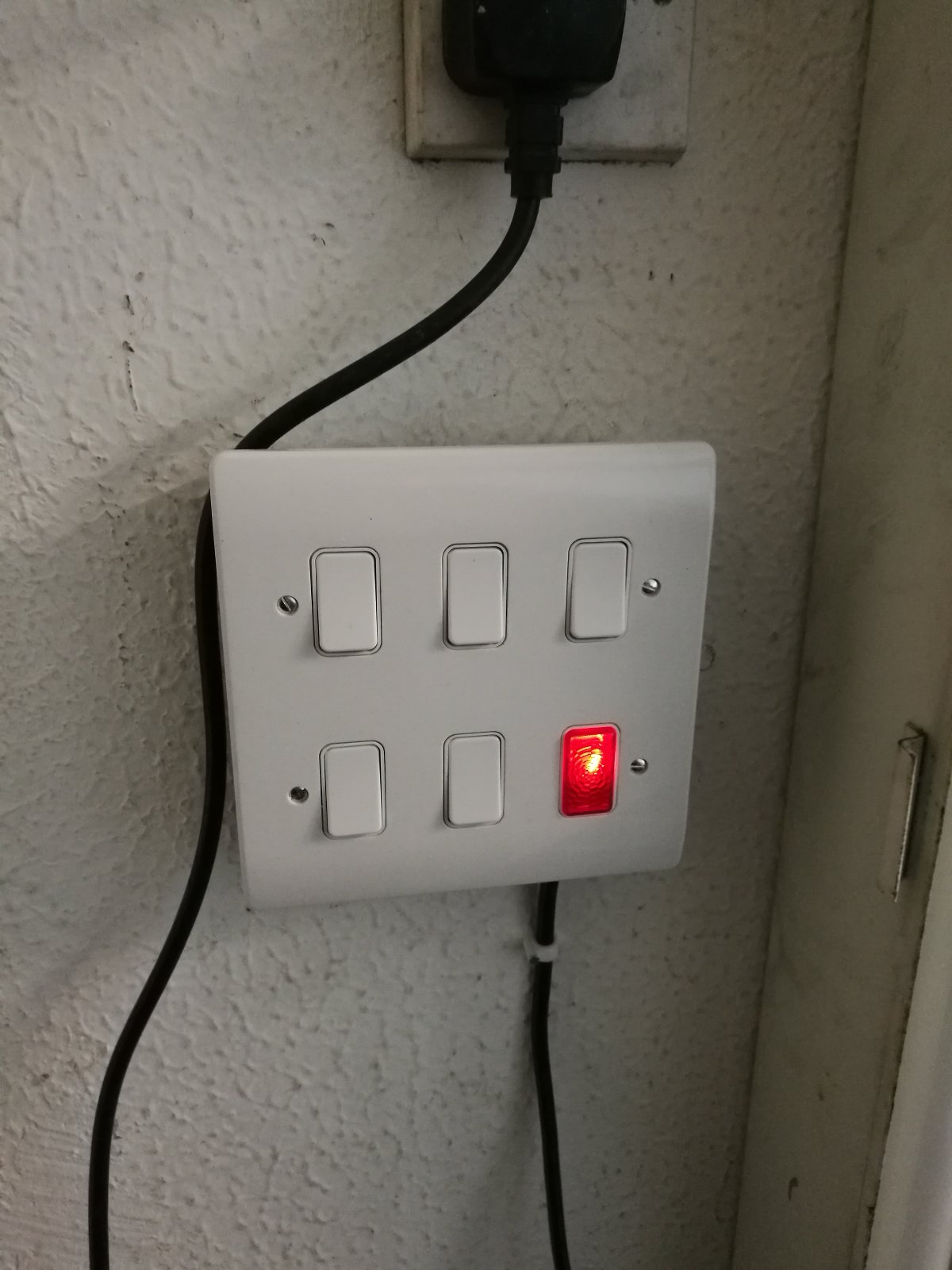

Now I know that our cantankerous RCD will not take kindly to me dumping 1.5kW of inductive load on it in one chunk (and I'm really not going to need 75,000 plus change worth of lumens all the time), so made sense to split it into groups. I went for five.
Was also really pleased to see that the MK modular switch system still exists (even if it's a bit more plasticy these days than I remember. I used to massively enjoy getting to dig about in the parts boxes in my father's workshop at work and make up these things in the early 90s. As such I enjoyed myself far more than I probably should have making this up. Five lighting zones (each corner and the end opposite the door) and a pilot light...well because I wanted a glowy red light! Seriously it's actually intended so you can find the thing in the dark.

Those lights really look the business Zel! It'll be like artificial daylight in your workshop...
You'll have all the SAD sufferers descending upon you now for a bit of light therapy :lol:

Reckon you'll be able to see this place from orbit once everything's on! I'm a great believer that there's no such thing as too much light in a space like a garage. Planning on painting the floor white at some point as well to assist further in shadow elimination.
The artificial daylight aspect should be assisted by a case of Northlight full spectrum daylight simulation tubes I've got. Sadly they're nigh on impossible to get hold of these days (in 4' 40W form anyway). Once they're done it'll be back to boring old 535 as I've got a few dozen spares, unless I come across anything more suitable anyway. I'd really rather stick to the T12 lamps if I can as the larger surface area helps eliminate glare and further diffuse any shadows. However that means that I'm stuck with NOS sources as far as new lamps are concerned.

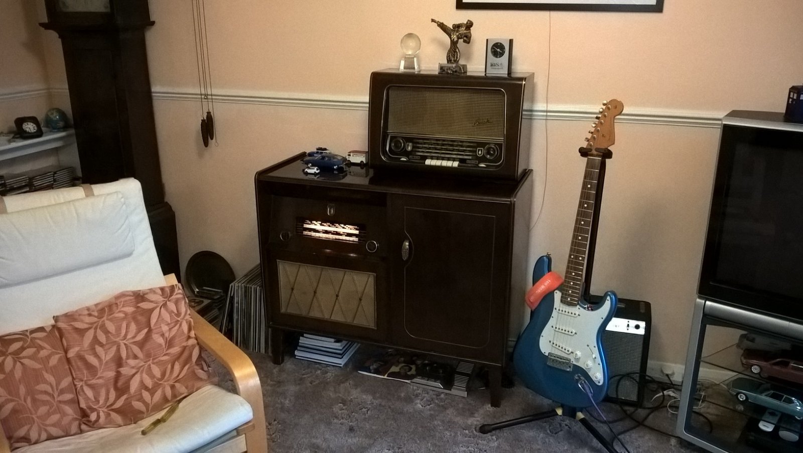

The radiogram works a treat Zel and has polished up a treat 8-)
It sounds utterly bloody awesome courtesy of those three speakers!
Here it is in pride of place :)
Own Work
Own Work
The record deck is functional but badly needs a good service... The grease - as happens - has dried out...
I am delighted with it :D

I wonder how hard it would be to take a feed from the guitar and play it through the radiogram? Valve driven amplifiers make such a nice warm noise!

Hell Razor5543 wrote: 20 Jan 2018, 16:19 I wonder how hard it would be to take a feed from the guitar and play it through the radiogram?
Easy, just plug it into the 'Gram' input - where the record deck plugs in normally...
Hell Razor5543 wrote: 20 Jan 2018, 16:19 Valve driven amplifiers make such a nice warm noise!
Look very carefully and a sharp eye will spot a Fender Champ amp behind the vintage Fender Strat... The Champ is all valves and sounds quite lovely...
You're right - solid-state amps just cannot match the sound of valves and even today valves still reign supreme in the music world and always will - All the clever modern electronics in the world just cannot replicate the sound of a good valve amp with proper spring reverb :)
