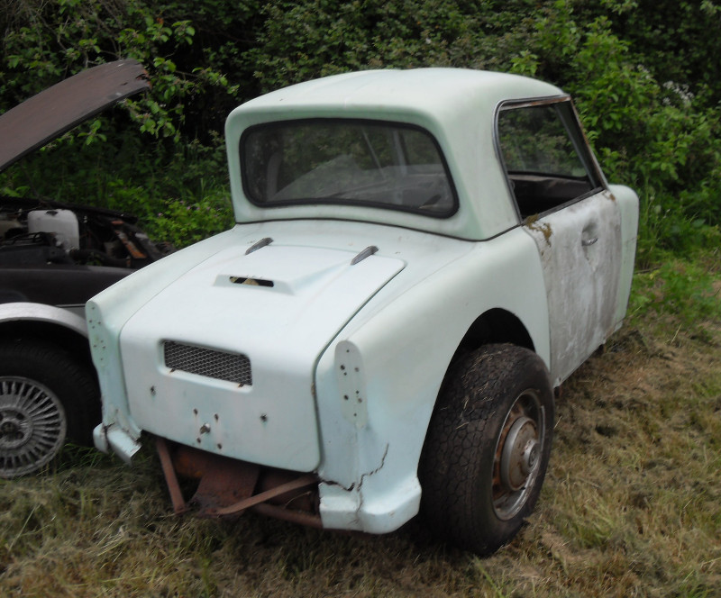

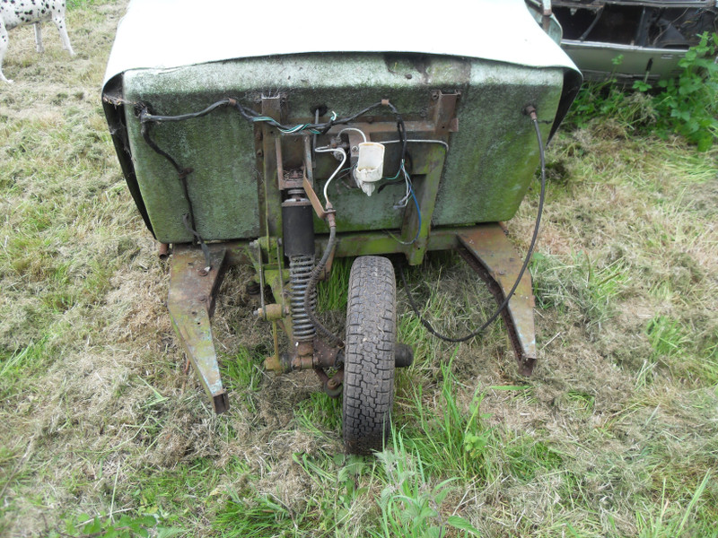

This afternoon I took a run over to see the gent with the potential Invacar project. It's...very much not what I expected.
It currently looks like a cast off Mad Max movie prop. The previous owner apparently had been using it as a tractor to shuffle things around a caravan park. As a result it's had stupidly oversize rear wheels attached, the arches cut away to accommodate them, the rear of the body cut away to allow a tow hitch to be attached to the crossmember.

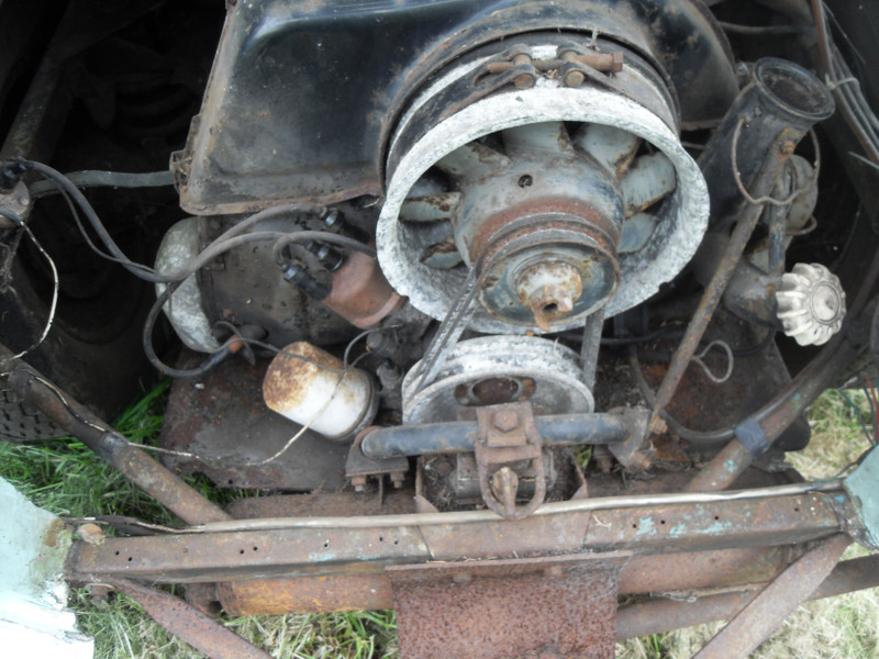

The bit under the engine cover's not a huge issue to my mind as it's a pretty simple box shape, and and shouldn't be that hard to fabricate a repair. The wheelarches are more of a pain, but it should be possible to take a mould from an existing panel to make a replacement piece up. Upgrading to 12" wheels means you only need one part of the curve rather than both.
The biggest issue by far however is that the entire nose has been cut off the bodywork for some unknown reason (our best guess is that it got damaged at some point and just cutting it away was the easiest solution).
I didn't hold out much hope for it structurally either given that there were several gaping holes visible in the floorpan (when I say floorpan, I mean completely flat metal sheet tack welded to the chassis in a few places by the look of it) and it's been sans doors for a long while obviously (they've been set to one side for safekeeping). It's also parked in the grass, which never tends to bode well for underbody metalwork.

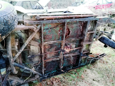

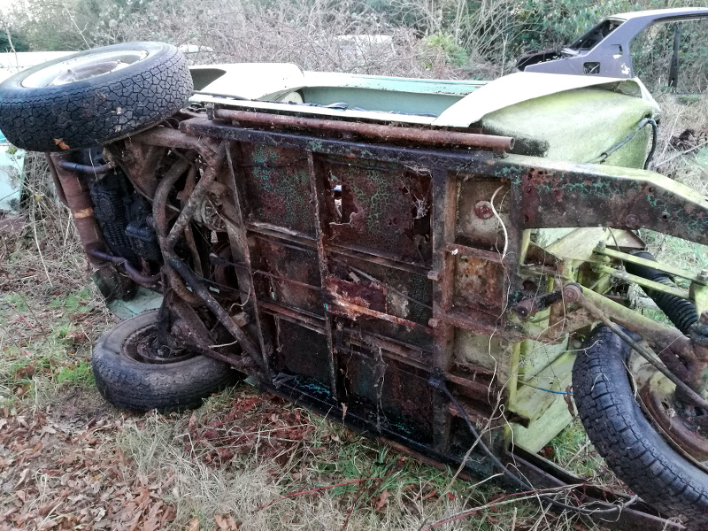

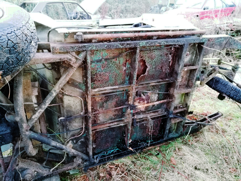

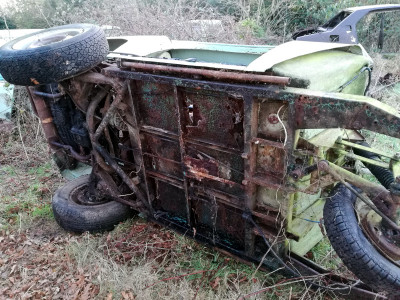

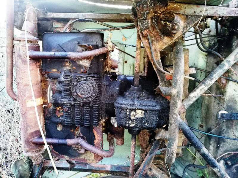

I spent about ten minutes standing on my head in the brambles attempting to get a proper look at the underside, before we realised that it would be far easier to just tip the thing on its side - because you can *do* that with these so long as you've got two people (albeit slightly easier if the handbrake works so the sod doesn't try to roll off as you're lifting it). I wasn't really holding out much hope for finding any actual metal left underneath it at this point.
This is what I was greeted with.
The chassis is only bloody perfect! The only tiny hole is in one of the "outriggers" at the front which are purely crash structure - and would be an absolute doddle (even with my welding skills!) to cut out and let in a new bit of metal for.

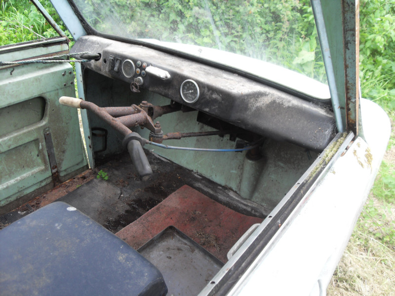

The floorpan as mentioned above has about the appearance and structural integrity of a soggy teabag. Apparently it was unpainted on the top surface, so it's just dissolved where water's got under the rubber floor mat. That really is just a really thin steel plate though (the seat is fastened to the chassis not the floor), so is utterly trivial to replace.
Hats off to the AC factory - they actually did a really good job of rust proofing the underside of this thing - hence the fact that it's still sound as a pound after 43 years.
I was absolutely gobsmacked by the condition of the underside...I mean there isn't even anything that looks "suspiciously crusty" - heck there's probably less rust on there than on the 107! The thickness and solidity of the metalwork as well is totally beyond what you'd expect for something this size/weight.
I didn't realise until afterwards that I'd totally botched the camera settings up - so apologies for the horrendous photos - the excessive contrast makes it look worse than it really is.
By the way, there are a lot of things missing in the photos (doors, side windows, lights, fuel tank, some switchgear etc - they're all present, just in boxes not on the car itself - well the tail lights actually are now). Think the only thing we're actually sure is missing is the wiper arm - and that's off a Mini so shouldn't be a problem to source.

Really does look like a tiny Beetle unit... There's a lot of GRP repair work needed...and figuring out what on earth to do about the missing "nose cone" will require some head scratching. I almost wonder if it might be easier to find some Robin/Kitten panels that I could do something of a cut 'n' shut with (it would be waaaaay too wide), as I imagine bits are easier to come by for them. Sadly Invacar Model 70 bodywork bits are basically unobtainable as there are already more rolling chassis around than there are bodies. Oh, and the wiring (what there is of it) has been seriously hacked about in a few places, though helpfully all in the middle of the cable runs it looks like, so it shouldn't be impossible to trace out and repair with a bit of patience with a wiring diagram.
