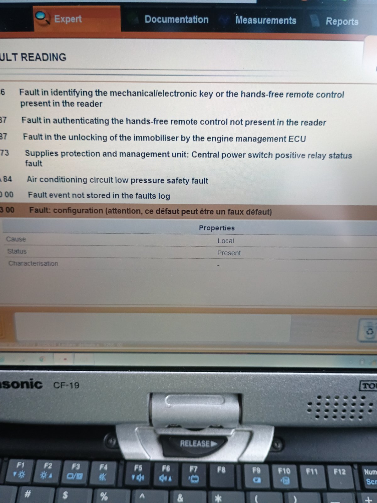

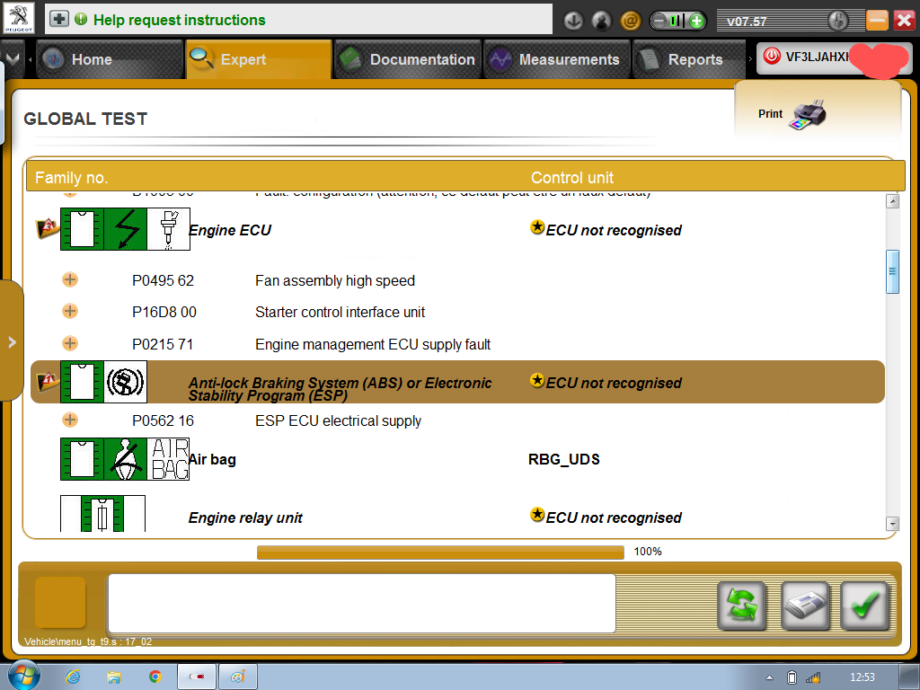

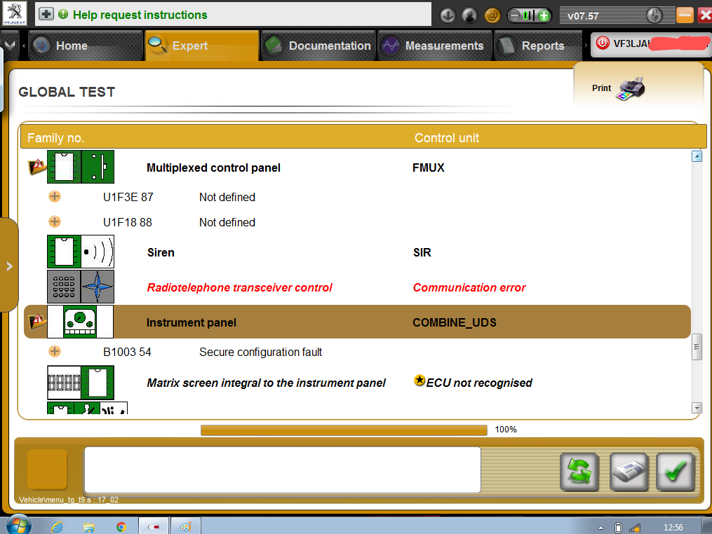

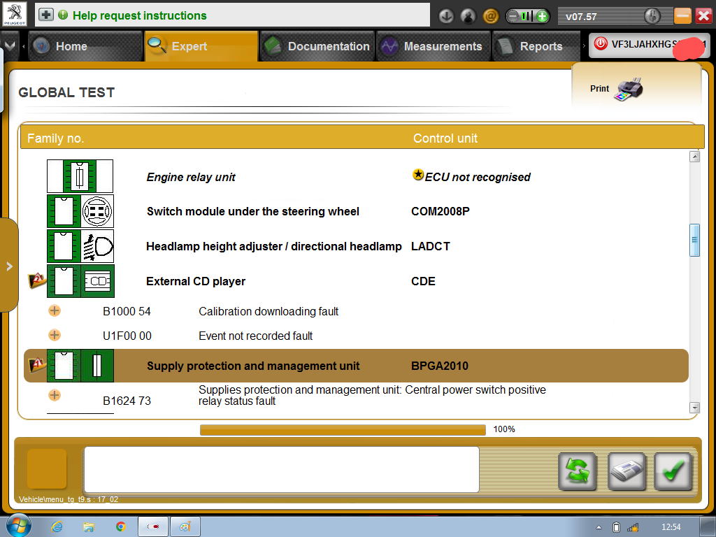

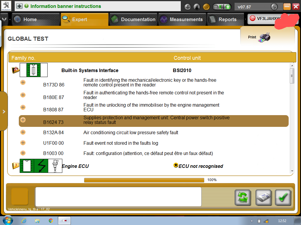

Quick scan, dump of the faults here:
- Posts: 5364
- Joined: 25 Apr 2022, 09:03
- x 2367
Thanks RichardW, I'll get a bit brave with screwdriver or multimeter whilst Start button pushed.
The above faults look like Battery Protection Module to me - any thoughts against (understanding is in advance of starter fuse check or power to starter testing)

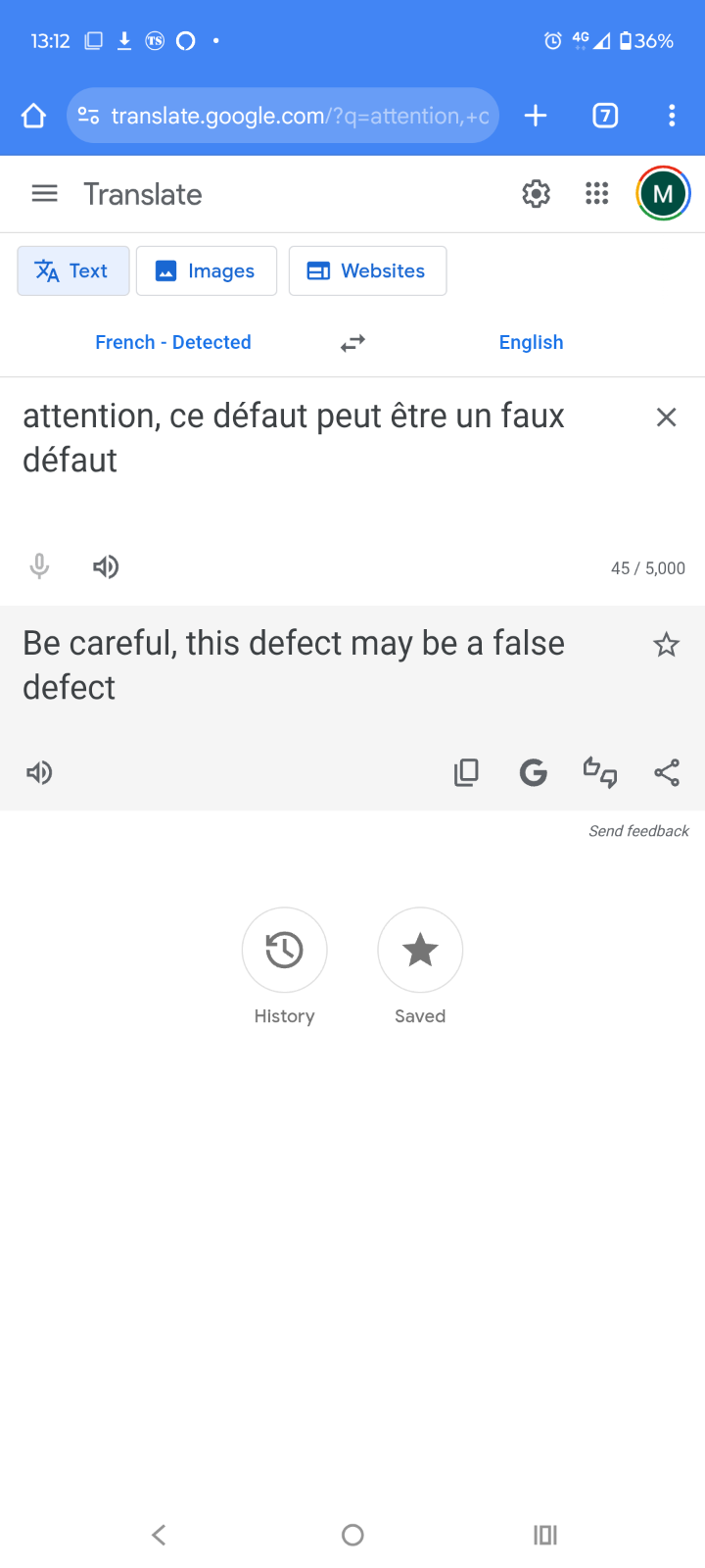

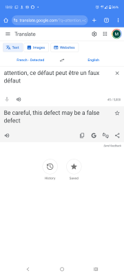

Makes me laugh at Google translate of the last one!
- Posts: 55178
- x 8440
Loving that translation Matt!

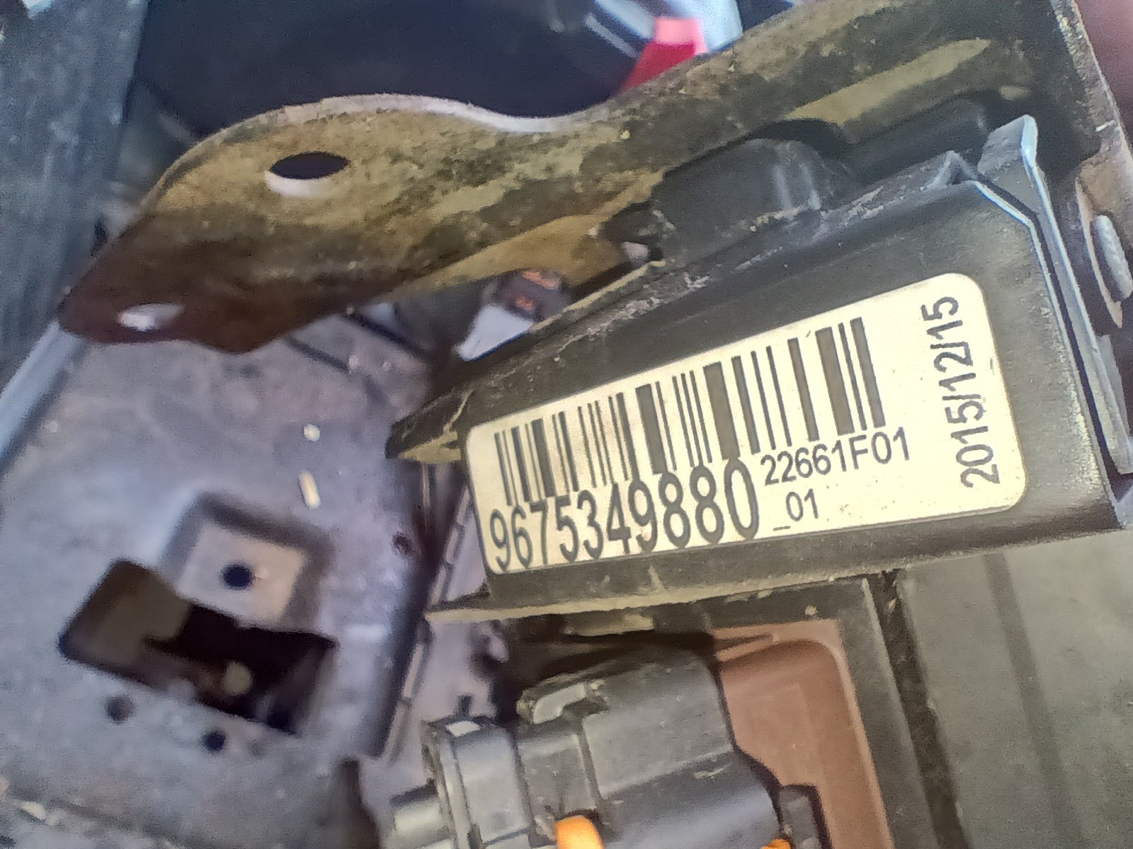

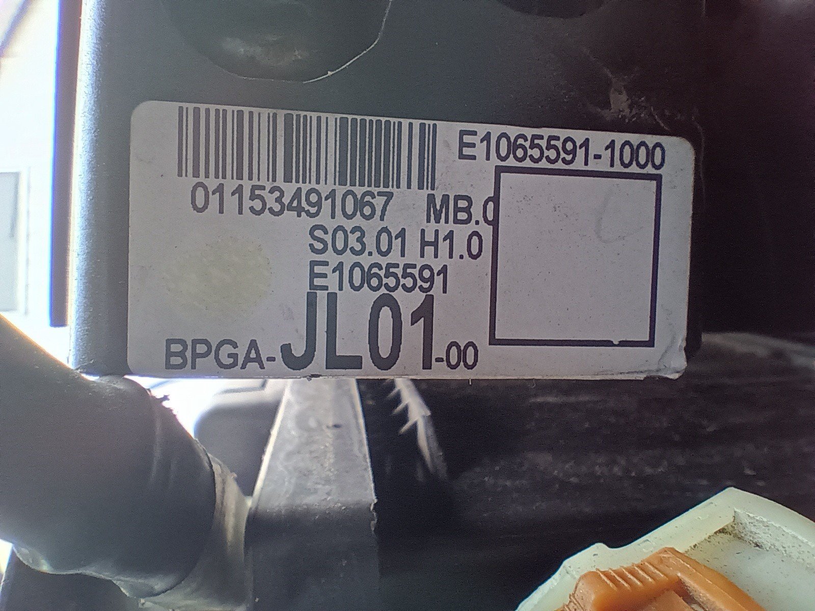

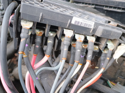

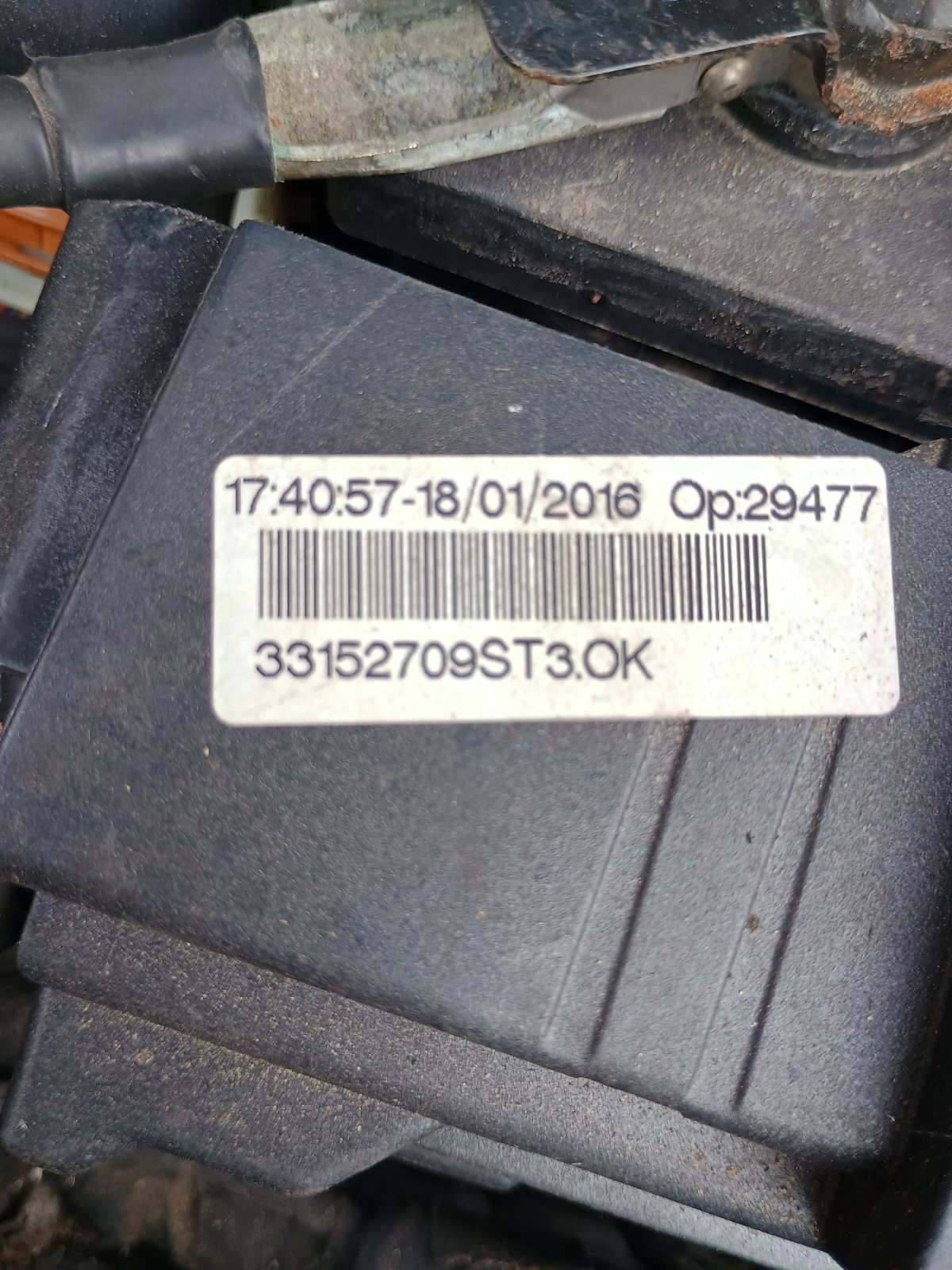

A few pictures, dug the Battery Protection Module off it's two mounting bolts for a read of the various labels:
- Posts: 5364
- x 2367

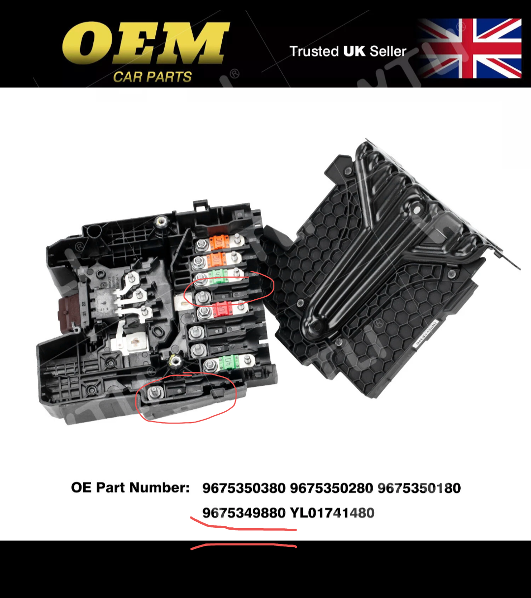

This seller:
https://ebay.us/m/8WfUFS
Lists all the part numbers together.
The two fuses identified as differences between
...280
And
...380
Are missing on the image.
...280
And
...380
