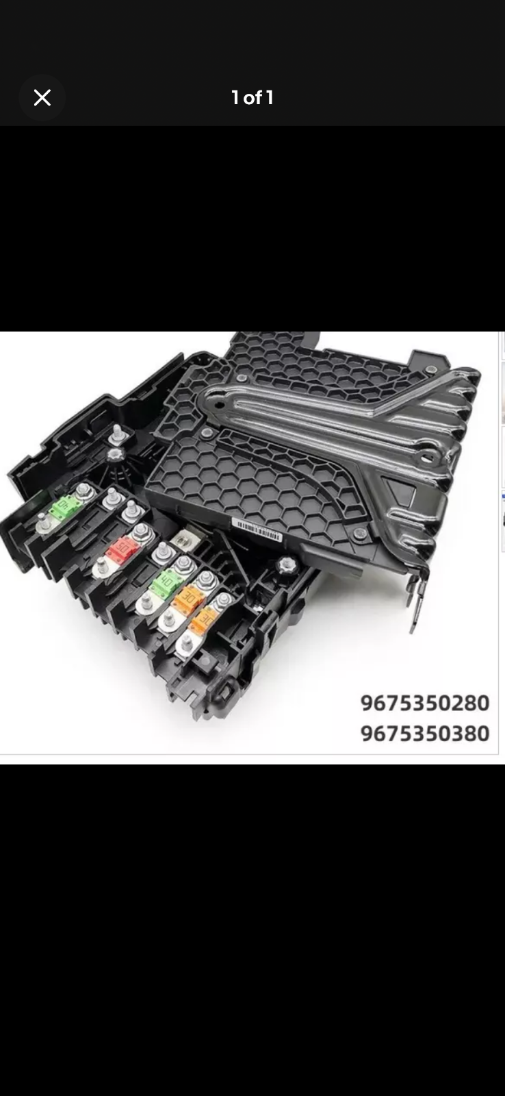

Hey everyone. I'm trying to get a replacement BPGA module. The one that came with my car has the part number 9675350280 but the one the I purchased on EBay has the part number 967535030. I've tried to fit it to my car but there is one lead that doesn't have a matching spot(it has the number 70) on it. I contacted the seller to say they sent me a wrong part but they said the one they sent works just fine. I'm worried about fitting it because I'm unsure if the dangling lead will cause any problems on the car. Has anyone else had the same issue? Did the replacement unit work correctly? Did the dangling cable affect the car? Any help/advice will be much appreciated. Cheers

First you got the number wrong. Have you seen this explanation:
Model Name: 9675350280/9675350380,Specifically designed for Peugeot and Citroen models, these ECU modules are direct replacements.
You can show which lead 70 is missing in the picture .

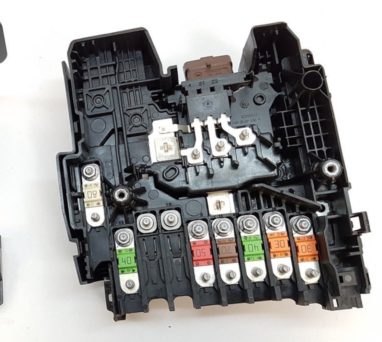

Gianni33
- Posts: 2
- Joined: 25 Oct 2024, 21:50
Re: BPGA replacement Pegout 3008 2018
This is the 280
This is the 380
This is the 380

The fuses are failing. As far as I can see, two are failing, this one from 70 A and one from 80 A. And they can be moved to a new one.
Just in case, take a picture of both BPGAs as they were before you changed.
