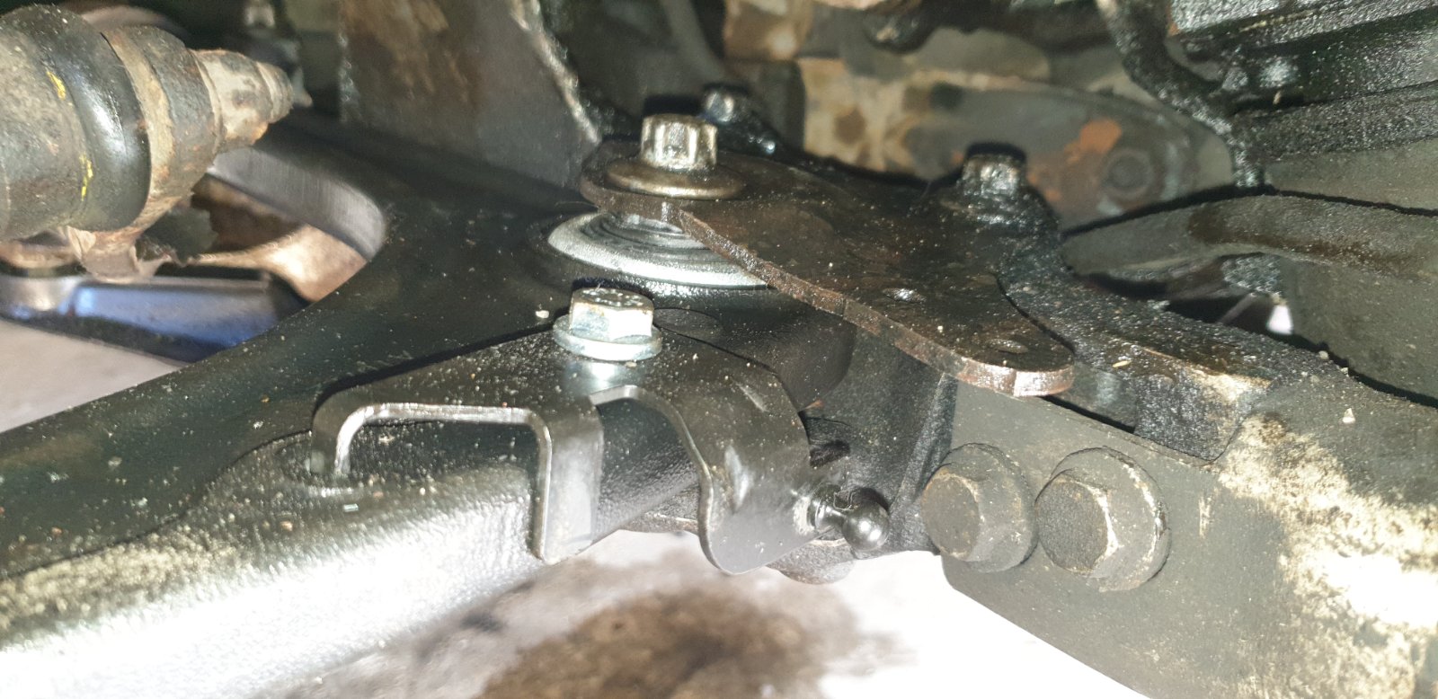

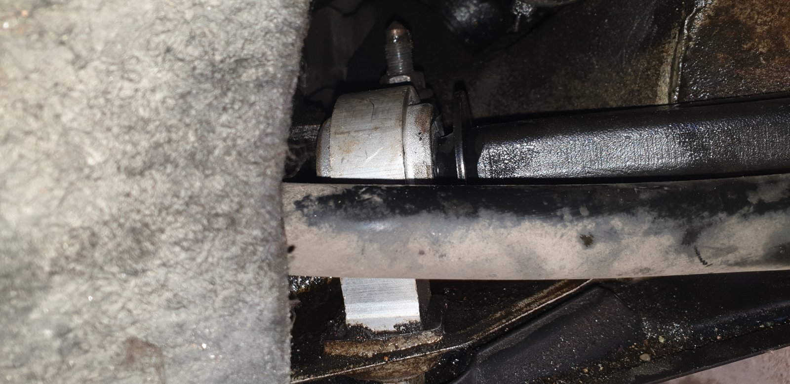

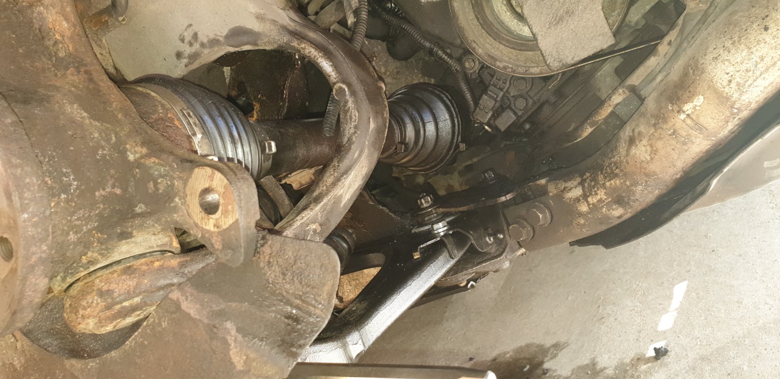

Oh finally... its going back together!
I am pleased to report that Sunday was a better day that Saturday, and we finally have what I consider progress.

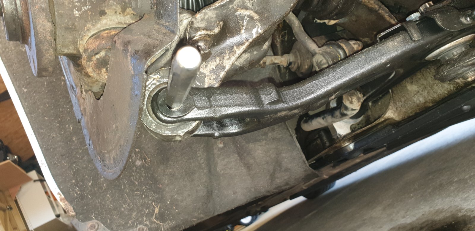

What was most puzzling was that I could not find the nut and bolt that secure the arm to the new bush anywhere... I suspect two little toads may have taken it... :lol: but we shall possibly never know!
So thanks to the parts page on this very forum, I have ordered a pair of bolts (Citroen part 9683866580), and a pair of nuts (Citroen part 693665), as it cannot hurt to renew both sides.
With the strut de-pressurised I managed to wrestle the bush in line with the new arm... and I put something in there to hold it while I waited for my new bolts!
I fastened the new arm at the base, and I am pleased to say cleaning up the thread must have worked, as it went in like a dream!
The center bolt also went in with no trouble.

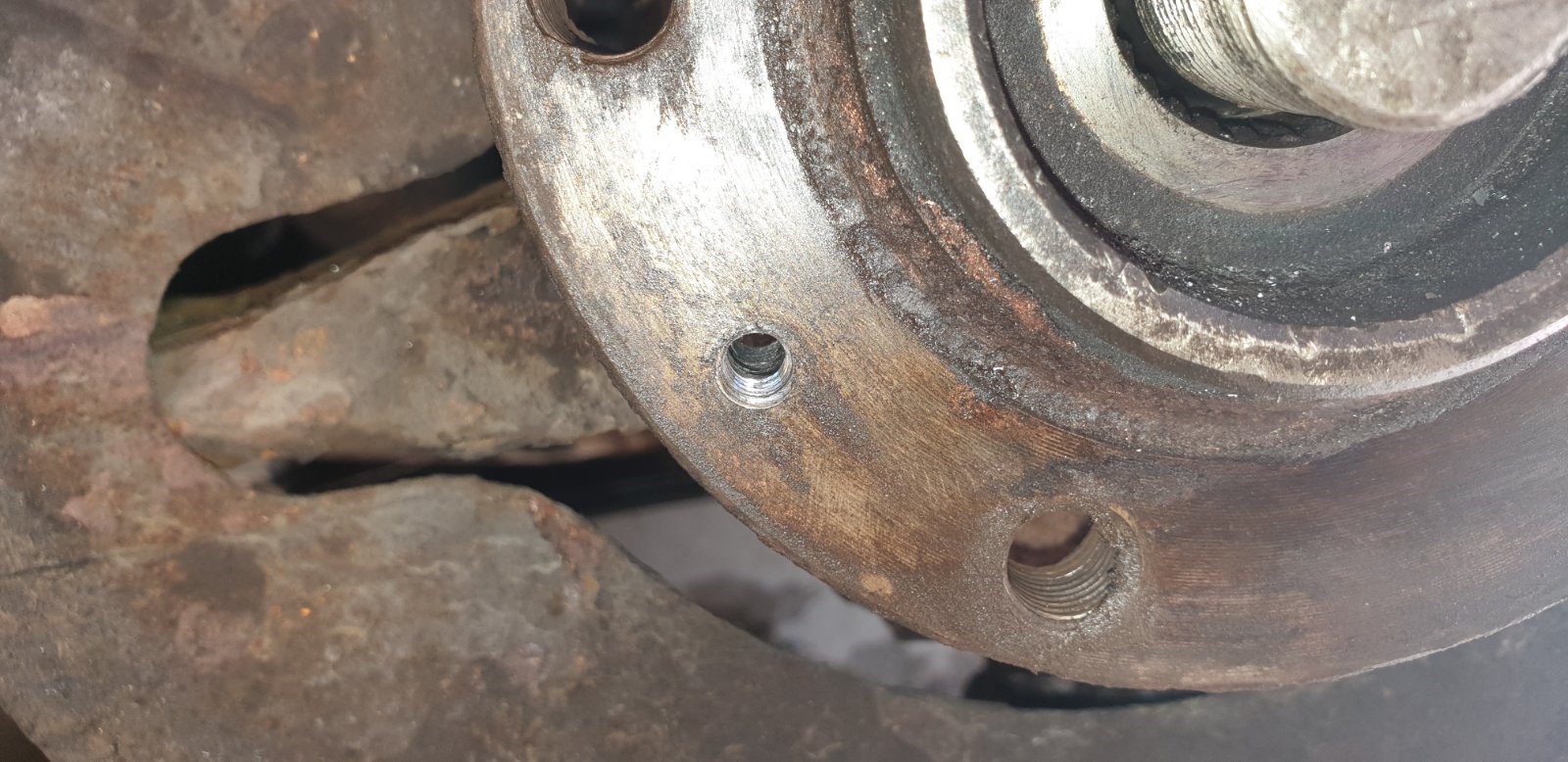

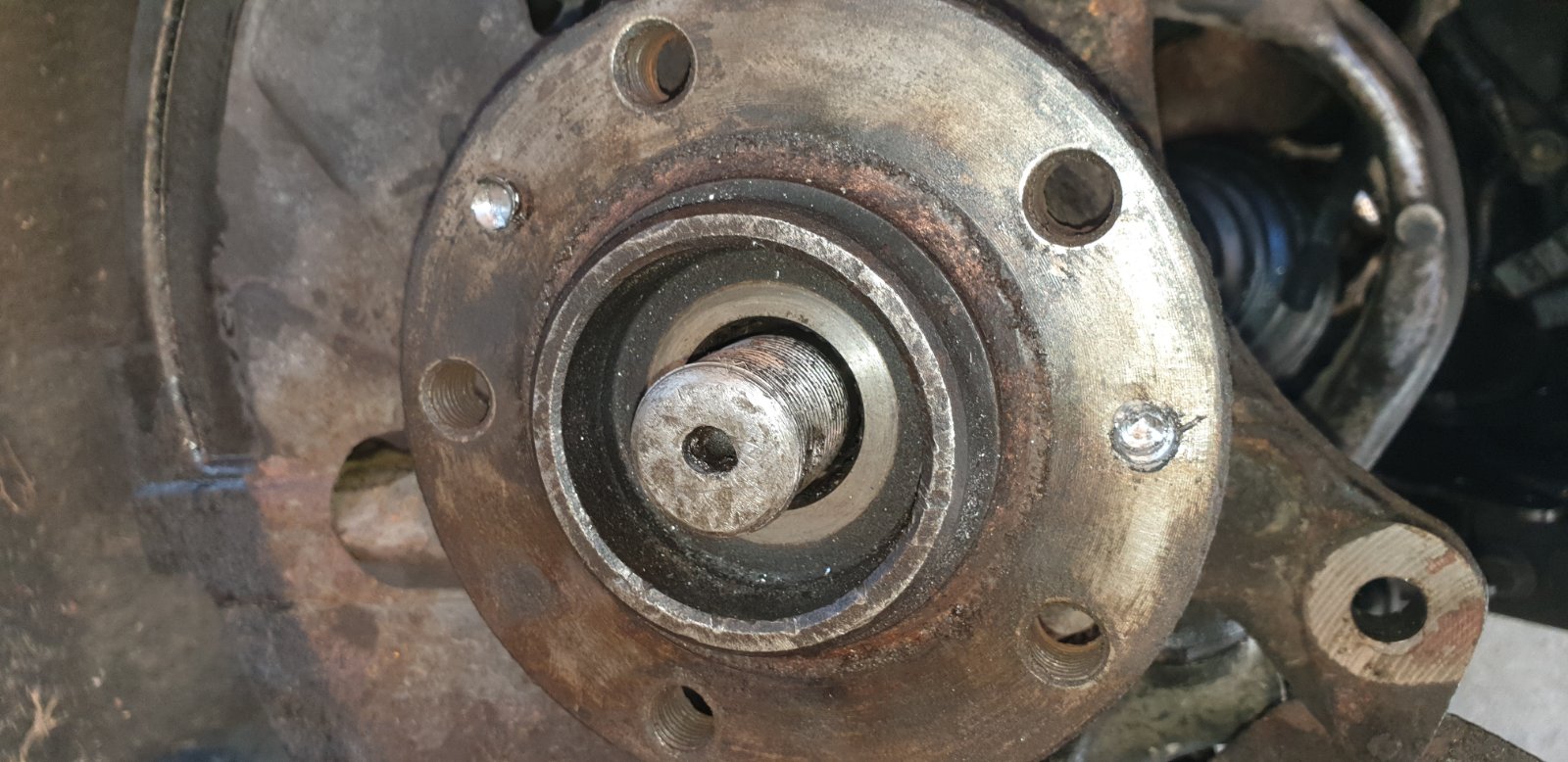

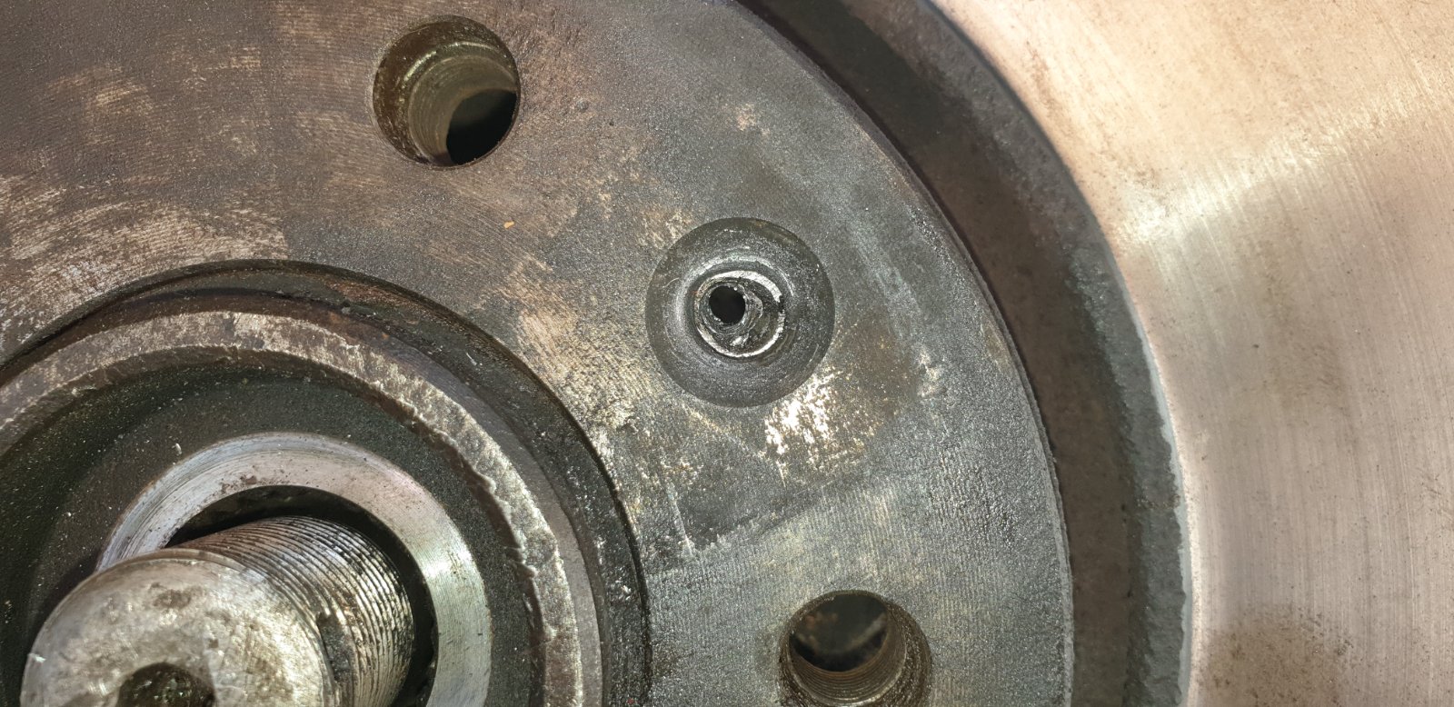

So my next issue was those troublesome brake disk bolts, which had rusted away, and had to be drilled out.
But they were going no-where, and I quickly realised I'd never get the original holes back in the correct places. Drilling out and trying to release did not go well.
So I hatched a different plan.... Drill new holes, and tap them! I got this mostly done, and then realised my taps were rather rubbish (Ebay no-name special bought years ago), so I have ordered some better quality ones.
I popped the CV boot back on.
SO now I am just waiting for the Tie rod ends, the new 6mm taps, and the stainless steel brake disk screws. Then I can get this all back together and drive the car!
Obviously I'll need to do the other tie rod pretty sharpish, then have the tracking done.

Just a note:
Those retaining screws are not essential, they keep the disk in place until the five wheel bolts are in place. Without them it can be annoying reinstating the wheel (if put wheel on the hub's spigot then turn to align with the bolt holes you can have the disk misaligned with the hub - rather puzzling till you figure out what is going on!!)
Just saying as drilling and tapping new holes could wait for another day, should not hold up getting the car on the road again :)

Hell Razor5543 wrote: 16 Oct 2023, 13:51 If you haven't already got some, a useful fluid to keep in a garage is Plus Gas. It is described as 'Dismantling Fluid', and that is a good description. If you have to take something apart that may have seized nuts/bolts spray some Plus Gas onto them every day for a week (to allow it to properly soak in), and then things should come apart easily. I had to bleed the brakes on a Xantia, and the bleed nipples did not look great, so I does them with the Plus Gas. When I came to undo them it was as though they had only just been fitted, they came undone that nicely.
Thanks - and yes I use a lot of plus gas... but I confess none of this had time to soak.
Next time I'll let everything soak for at least a few days; it will be worth it if it avoids me replacing nearly everything I touch :lol:
