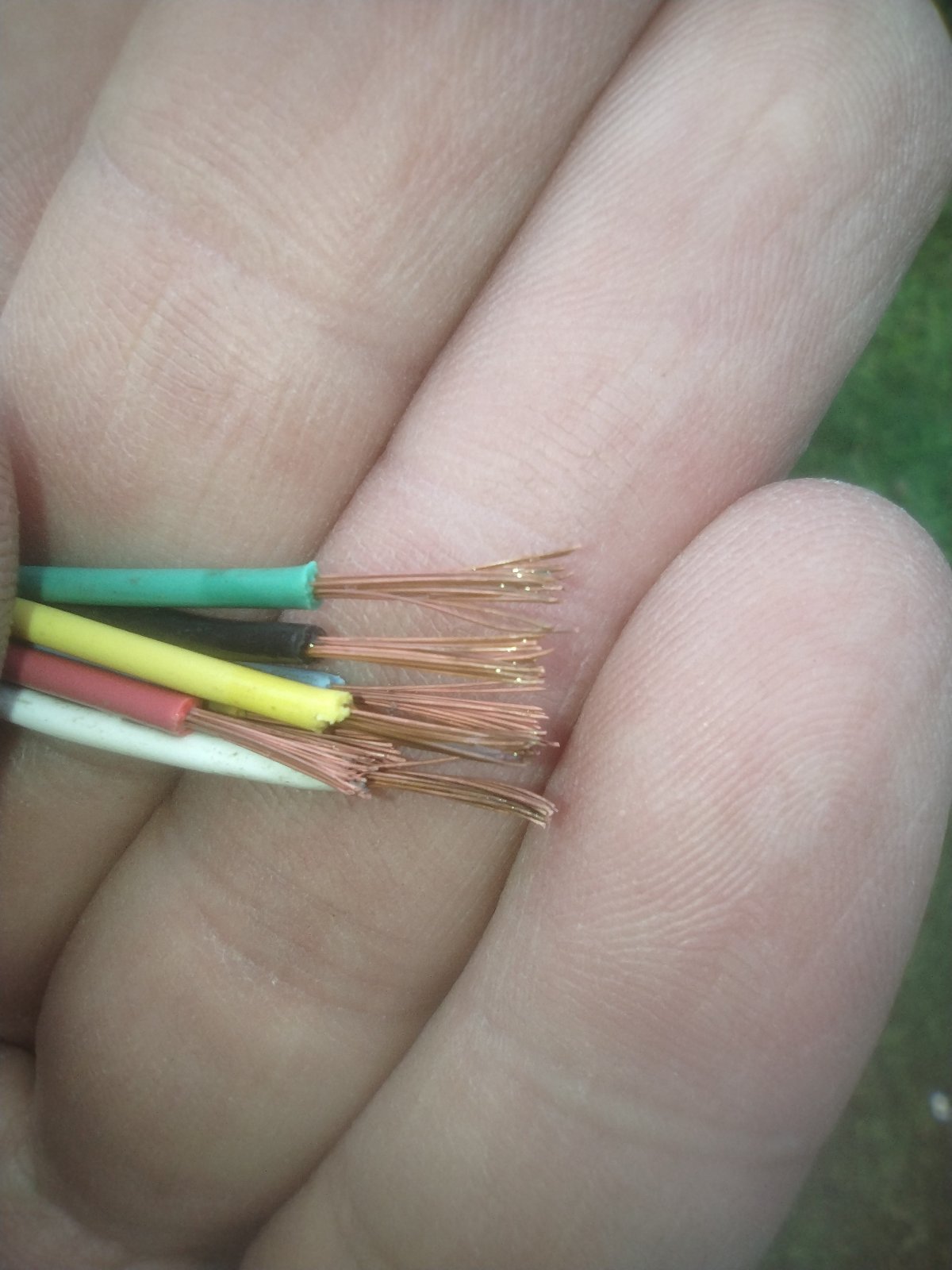

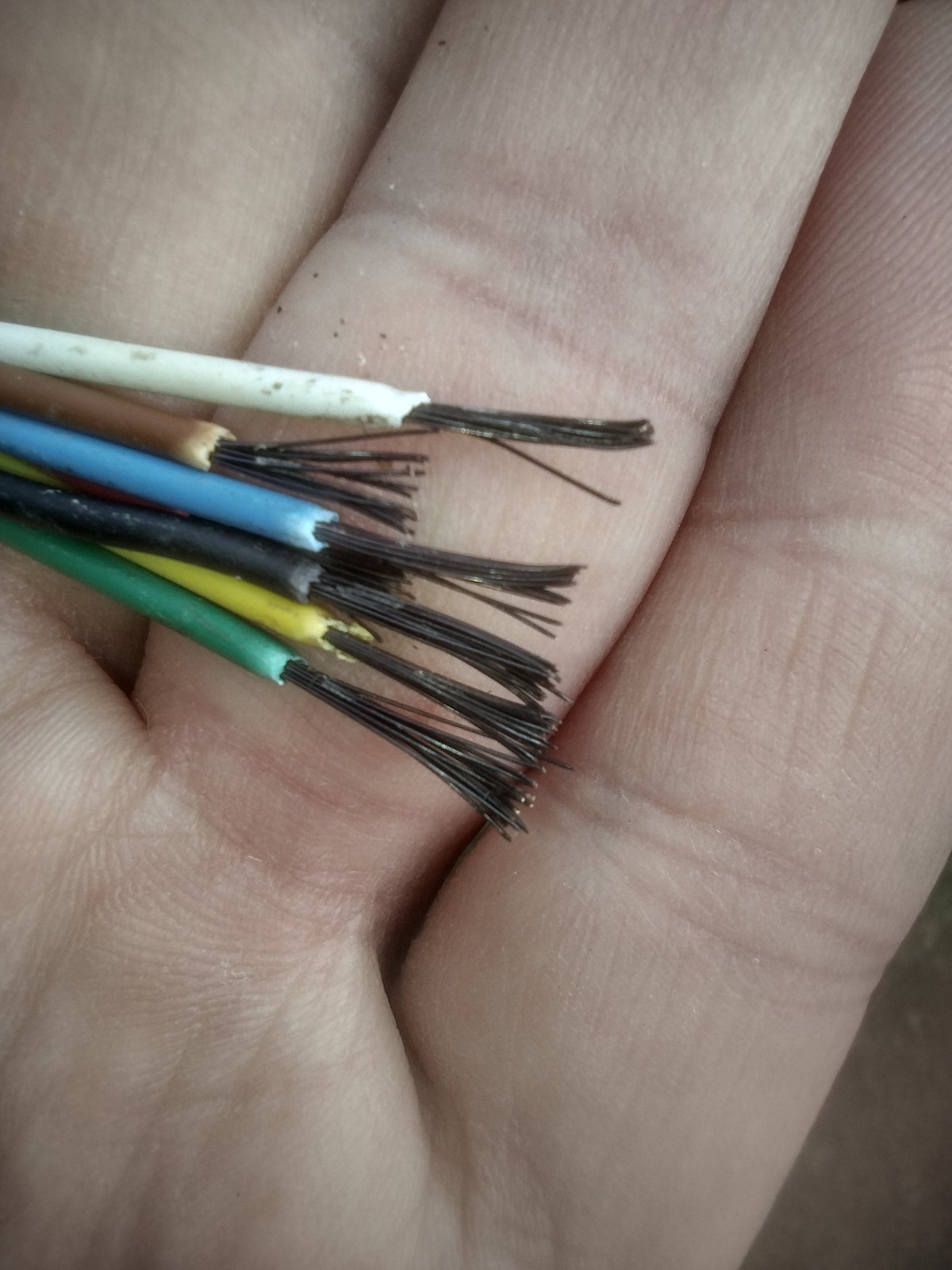

myglaren wrote: 03 Sep 2023, 19:05 Apologies about the Americanish,
Trying without the heat (or salt for first attempt)
Before
Before
Dipped
Dipped

Be good to see the result Matt, old Citroen wiring can be hard to solder when like that... Those could be quite brittle too...

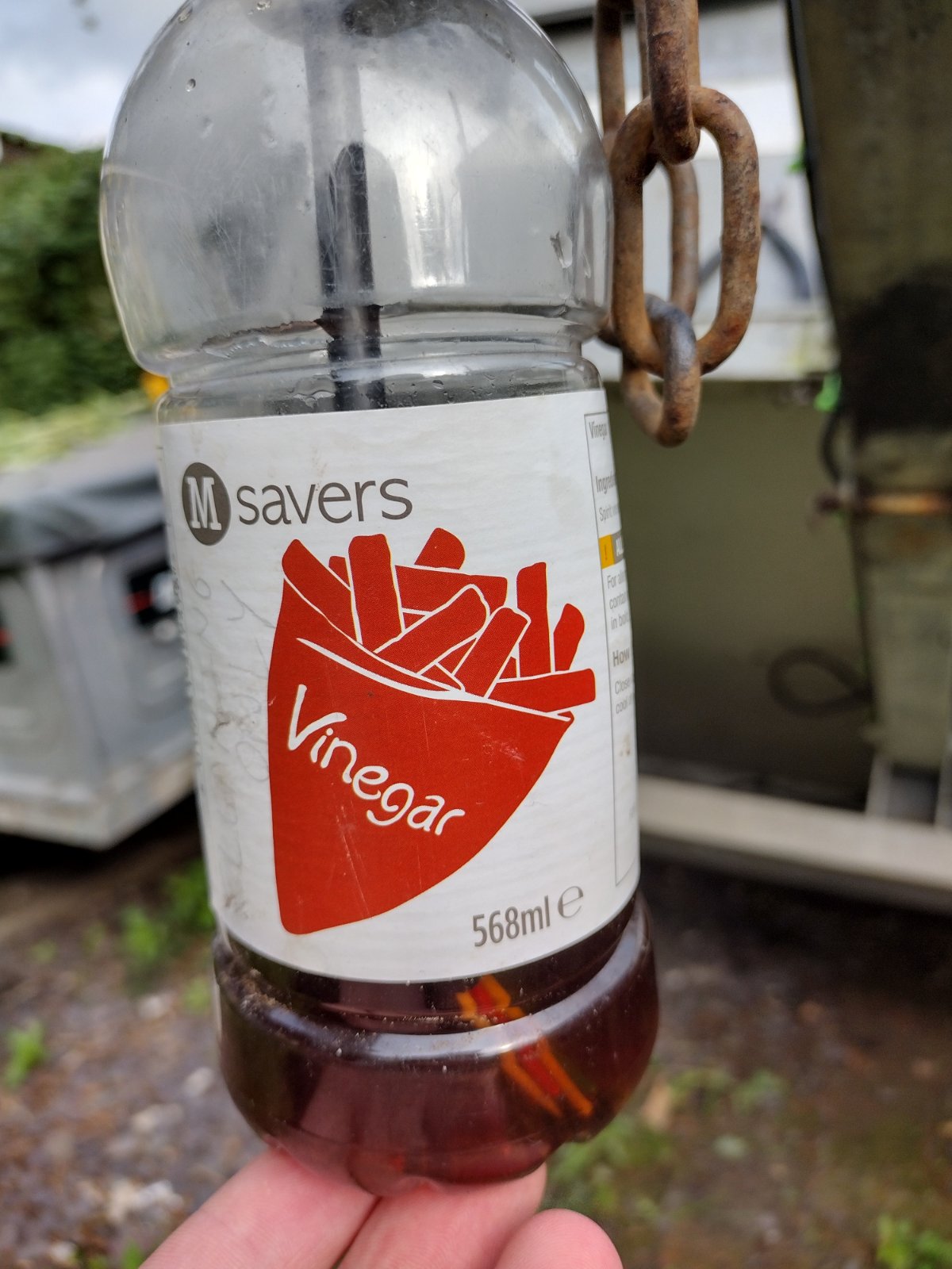

Experiment 1: a failure, as I foolishly left it hanging by the duct tape sticking the neck of the bottle to the cable further up and gravity had other ideas.
Now reinstated at ground level. Very slightly more copper coloured I think, but no idea how long it actually remained in the vinegar!
As obviously:
I've been off to the tip! :)
x 3565
Edd China shows a short similar copper wire cleaning process but without the heat involved. He says it should only take minutes. There should be a 'Part 2' to this where you neutralize the process with a solution of Bicarbonate of Soda and water in similar proportions to the vinegar / salt, but you only need to swill the wires around in the bicarb to neutralize it.

I'm calling that a success! Just vinegar no salt good few hours. Quick rinse in water and I'll call that right!
Ta da!
Ta da!
Pressure washer out (for that Sahara sand mess clean up) = rain drops before I've even coupled up the hose! :-D
Posts: 55172
x 8437
That looks excellent Matt :)
