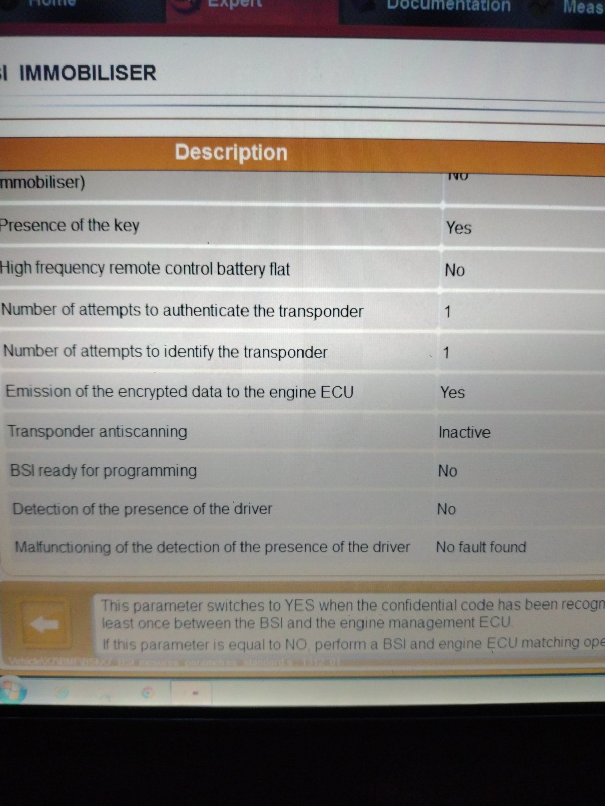

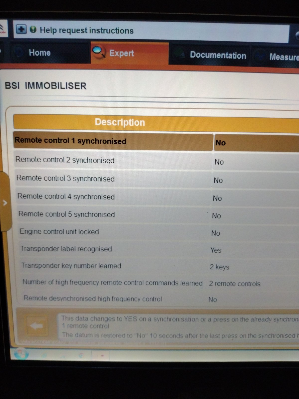

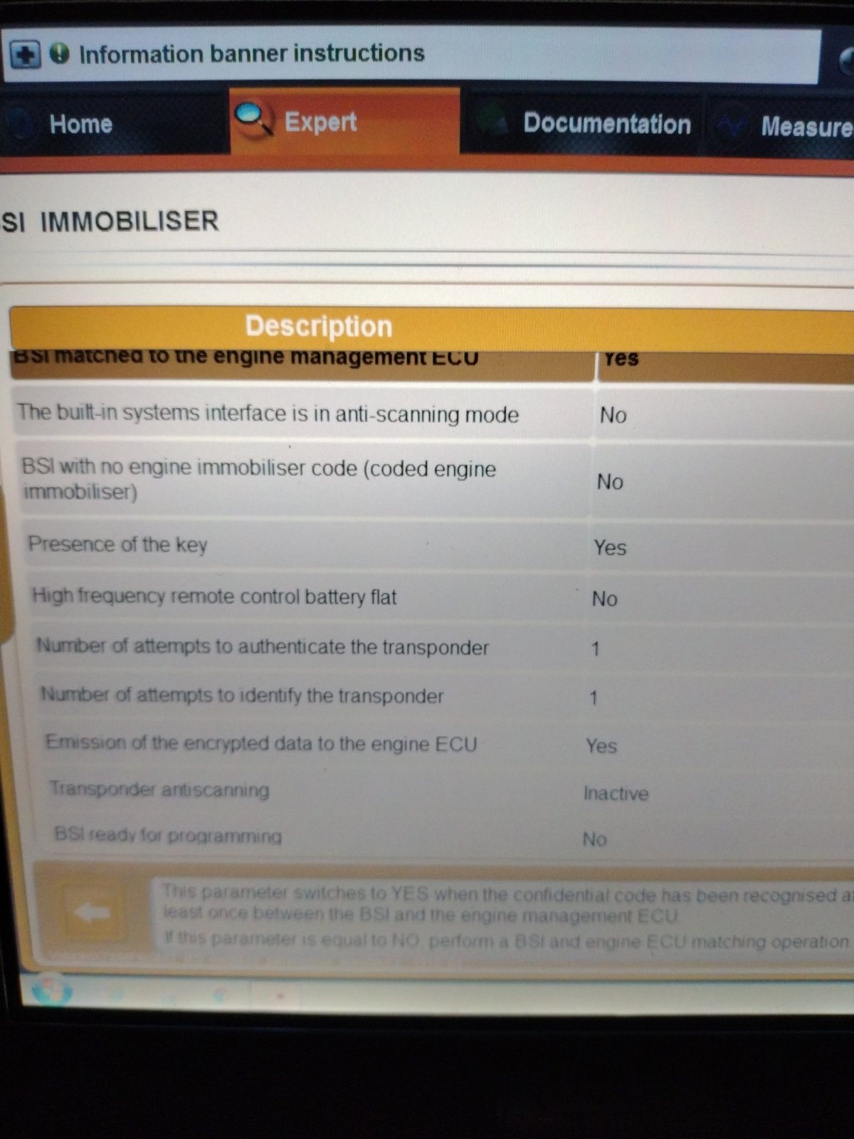

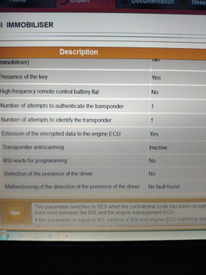

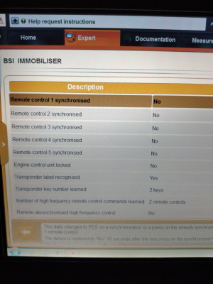

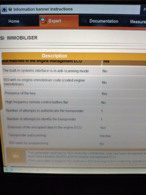

Reading of parameters.
BSI immobiliser This screen suggests that some of the values should change to "Yes" for ten seconds after a key button press I think. No change when pushing buttons on the key in the ignition. Will get the other key and try that soon.
Is happy two keys are programmed and two learned This seems ok.
