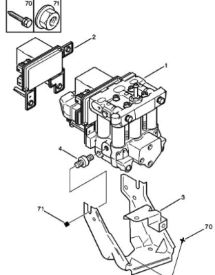

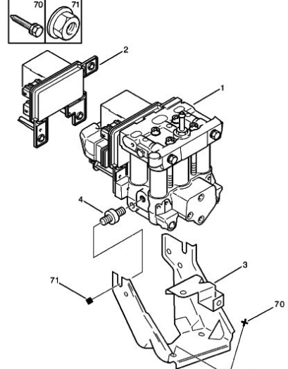

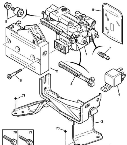

I was wondering if someone could please post the exploded diagram of the ABS ECU and the ABS block for a 1997 XM (Teves ABS) so I can see what fixings hold the ECU to the block

Re: Citroen and Peugeot Parts Requests
@ Wes:
There are 2 versions and you could have either:- Bendix or Teves. Both are different as you can see. This is for your VIN ending 804.
Hi Marc. Thanks. I have the Teves so should be the one on the right. Seems its just two bolts and the wire plug to get it off the ABS block, but I wonder if the bracket (bolts 70 and 71) have to come out before it can be removed from the block
Wes
Wes
- Posts: 10977
- Joined: 09 Nov 2005, 22:03
- x 1460
My recollection is that there are bosses on the block which protrude into the electronics module (not shown on that diagram) , and these could be a tight fit, but I think that it is just the two screws to remove. I may be thinking of the later Teves Mk20 system fitted to later XMs.

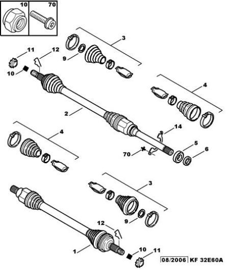

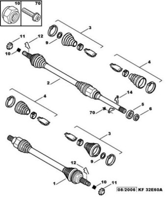

Driveshafts for a 206cc 1.6hdi , would 1.6 petrol be ok ? Part numbers for ns please , cheers marc.
Husky.
- x 6945
No - they are not the same as the petrol - the driveshafts vary engine to engine.
(1) OEM Left: MARKING 8MN34 was part 3272AH, now replaced with 3272EZ
Exchange 3272AJ
(2) OEM Right: MARKING 8LN18 8LN15 (8LN18), Part 32730Y
Exchange: 32730Z
Exchange 3272AJ
Exchange: 32730Z

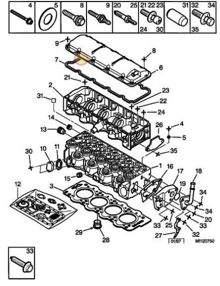

Hi
looking for part number for rocker cover gasket for 97 Citroen XM 2.1TD (XUD11BTE) please
plus if anyone knows if they are still available from PSA
Cheers
Cheers
- x 6945
Item (7), part: 024970, but no longer available from Citroen, but is available from Citroen Classic:
https://www.pieces-de-rechange-classic. ... lasse.html
For 12 Euros
For 12 Euros
