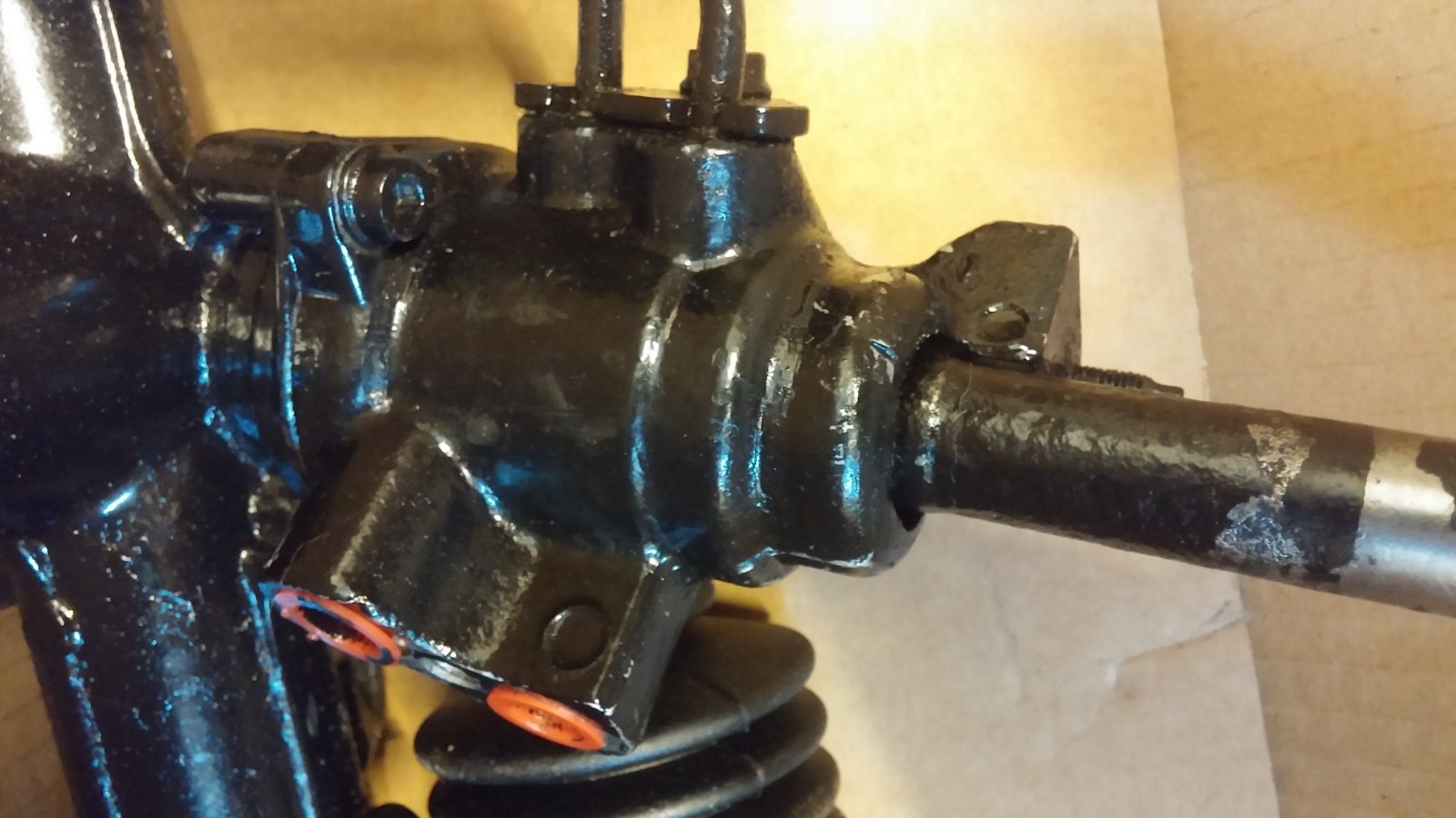

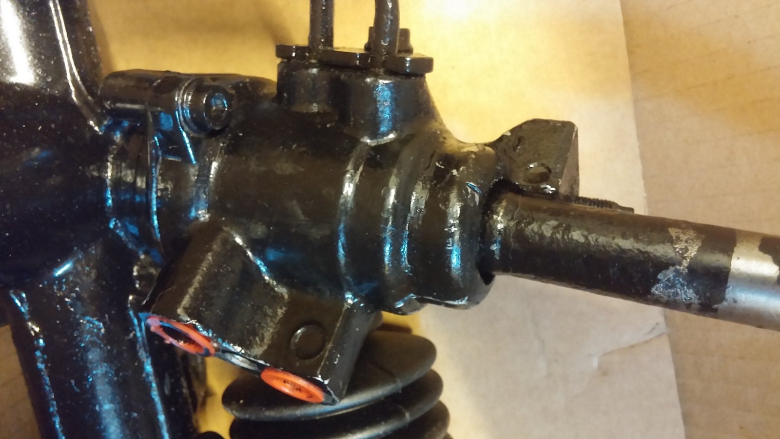

Alignment is critical, I have a rebuilt one, by autosteer, in my garage and when I fitted it the steering wheel is about 75°out,and could not be corrected by tracking, i ended up with it holding on by about 2 threads on one track rod end and the other with no threads showing.
Good. Luck,
Oh, the seal is definitely fitted from the inside, and removing the shaft from inside the car would be difficult, with the piping that needs disconnecting. See photo.
Good. Luck,

Sloppysod wrote: 10 Jun 2018, 11:55 Alignment is critical, I have a rebuilt one, by autosteer, in my garage and when I fitted it the steering wheel is about 75°out,and could not be corrected by tracking, i ended up with it holding on by about 2 threads on one track rod end and the other with no threads showing.
Good. Luck,
The mechanic didn't have any issues with the one I had Stu - I'm pleased to say - it fitted perfectly with no mucking about. They compared the original and the replacement side by side and it was identical, so maybe they sent the wrong one to you?
Anyway I'm really pleased with it so far and went for a long spin the other day and she is driving like a dream, and no belt squeaks or pulley rattles too.

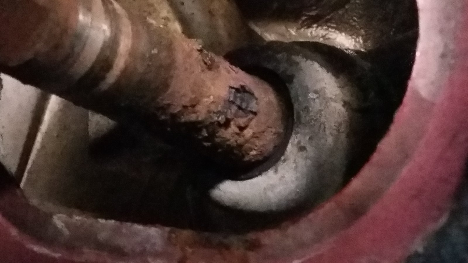

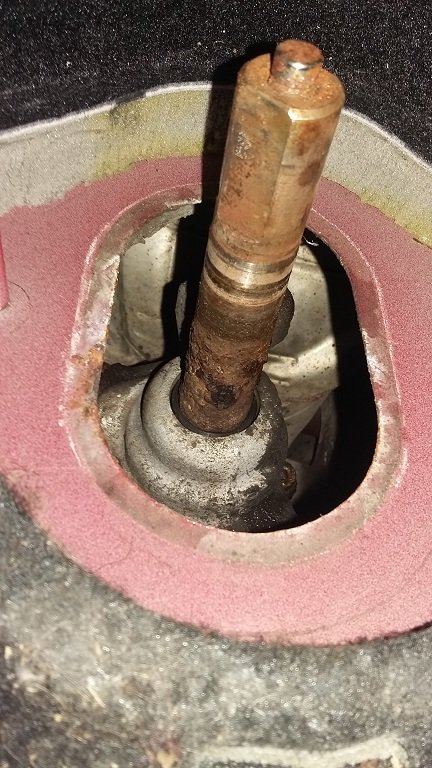

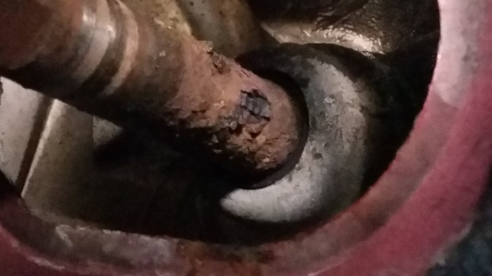

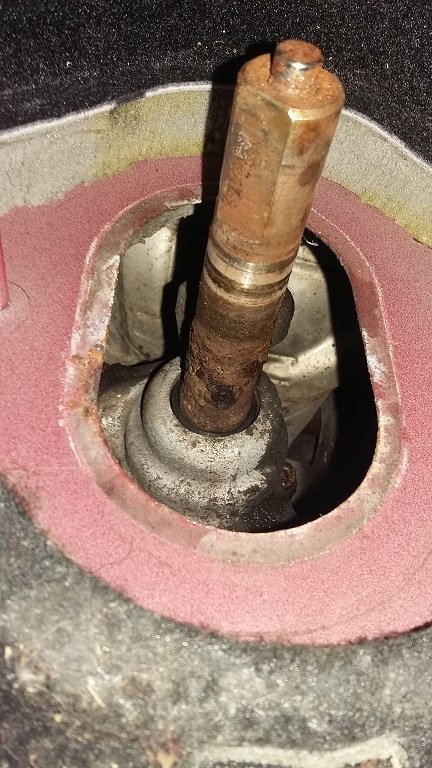

Confirmed, seal leaking due to corrosion.
You can see the main problem here, the use of cheap high carbon steel rather than a better quality high chrome one.
Note the Spall effect/Pancaking of the metal forming "flakes"
Also, take note, there is ZERO anti-corrosion coating applied to the shaft, a massive error and one that reflects the very very low standards of quality control applied to this part by Citroen. Or: could it be they like the money ?, they will of course, sell you a new one at a massive cost which has the SAME PROBLEM !
