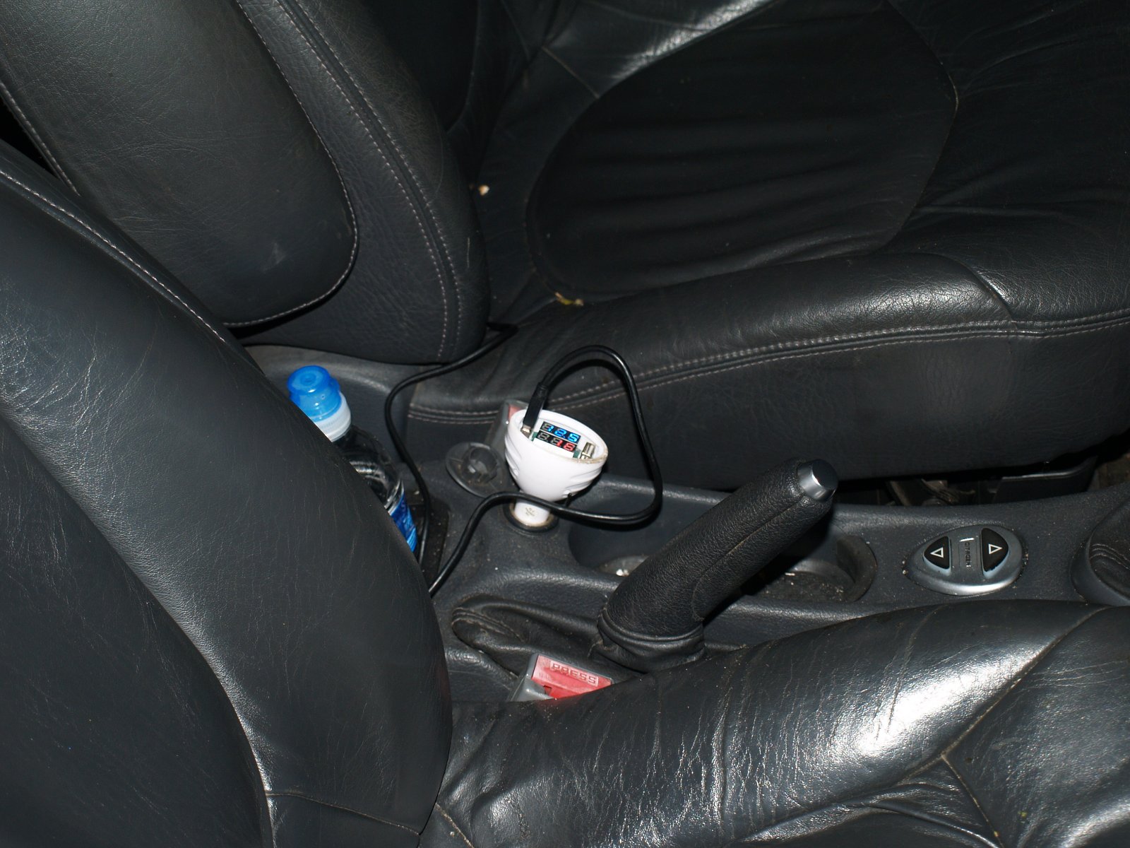

12.6V just now, before unlocking.
12.4V after unlocking and dumping some tools in, rising to 12.5V within ten seconds.

It's quite literally a right royal pain in the back for me to maintain the battery unless done in-situ which isn't feasible due to remoteness of our parking bays. Would be great if I could use the EV charging points in the high street.
Steve, is your car hydraulic? If so, your battery seems to absorb the pump drain far better than mine did.
How did you get the measurement before waking up the car, is the power socket constantly live?

It is plugged in to the socket behind the gear stick and is permanently lit. Will see if I can get a photo but it is very dark out now.
Easy to see through driver's window.

myglaren wrote: 31 Oct 2017, 17:55 It is plugged in to the socket behind the gear stick and is permanently lit. Will see if I can get a photo but it is very dark out now.
No need for photo Steve - just wasn't sure if the feed was permanent. I know it doesn't need ignition on, but wasn't sure it stayed live regardless. Might wire my radio power to it, if that's the case!
