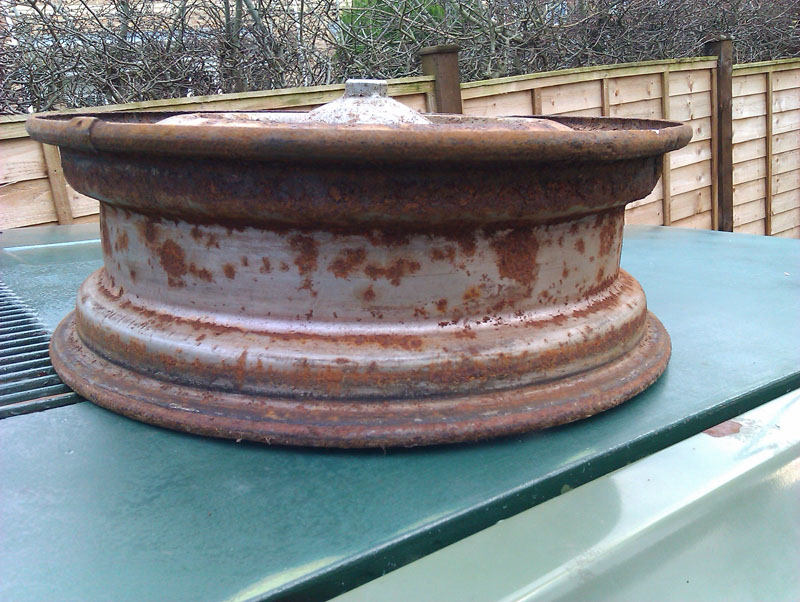

One of the rims needs attention. Going to give it a good going over with a power tool, paint the bit the tyre sits against and pass it back to them to get the fifth tyre fitted. Not mega important just yet.

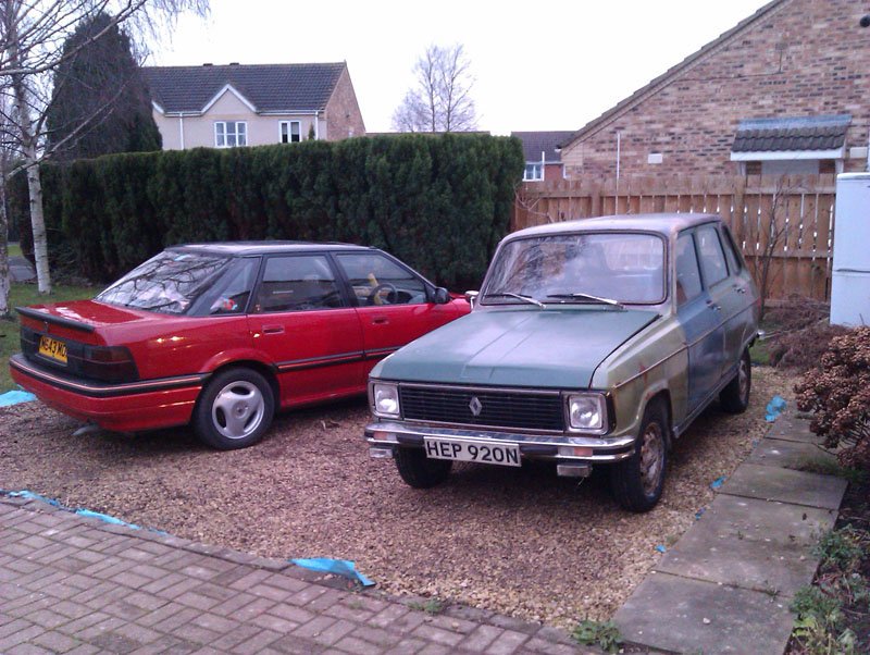

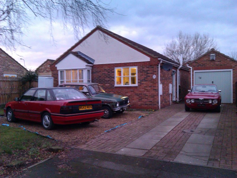

Managed to get the front brakes unstuck fairly easily, just removed the pads. Then the car tried to roll away because I hadn't put the handbrake on so that's the rear drum freed too. Had to move the Renault to make space for a new visitor.

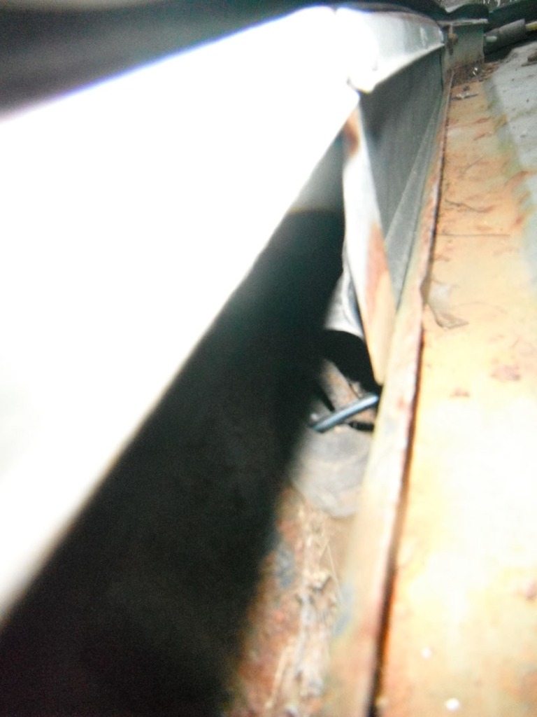

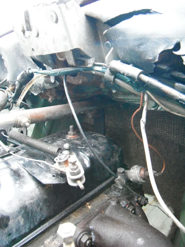

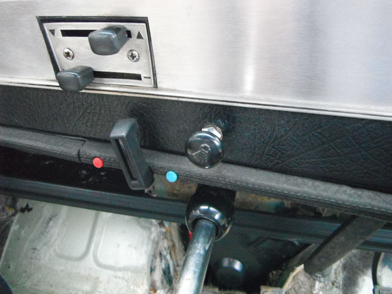

Today I got the choke cable fitted, finally. It's been a bit of a faff and I've had several attempts at this only to have the cable vanish once it was pushed into the guide in the dashboard. Today, with the help of a knitting needle, I bested it!
You have to sort of fish around through the flaps in the scuttle section until you hook the cable and then you can feed it through the grommet into the engine bay.

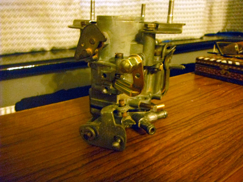

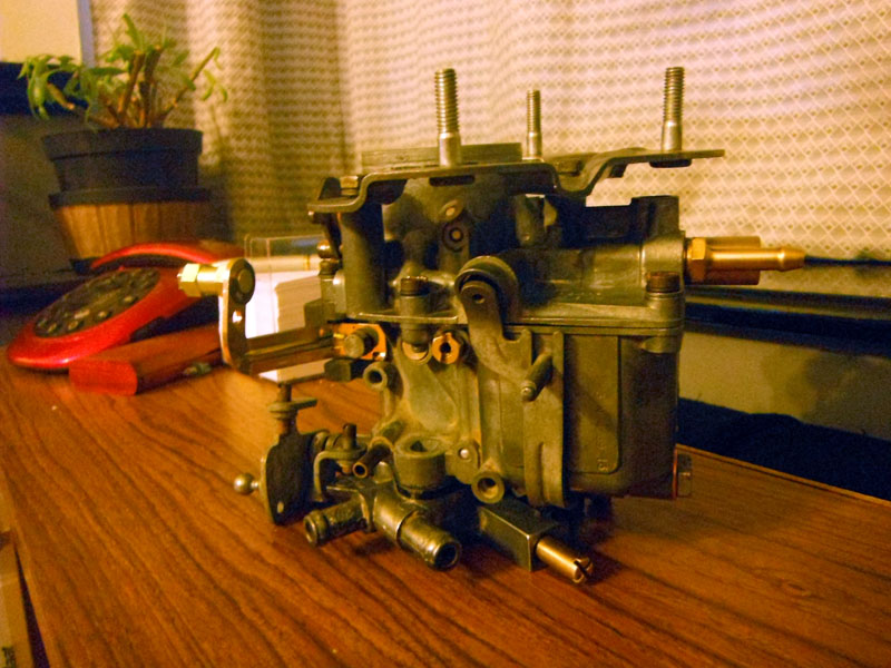

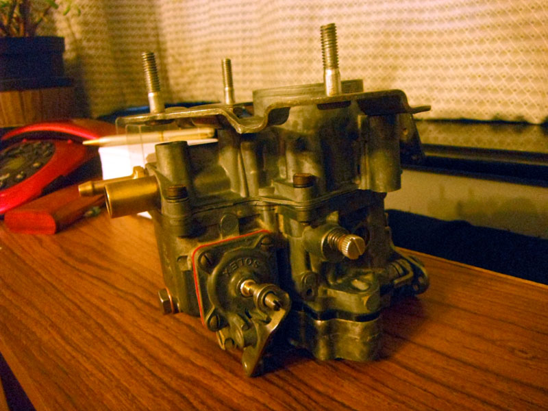

That's a job off the list. I also did a first-assembly of the carburettor that Mike cleaned up. Final assembly will be done now I know everything is there, this is just to show how nice and shiny it now is so not everything is present in these shots.

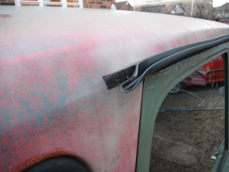

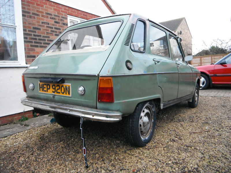

The guttering on one end has twisted and peeled a bit for some reason. I'll likely just glue this back down with some PU adhesive at some point, it can wait for now.
My thanks to Mr_Bollox (from other forums) for his contribution to the project in the form of this important period accessory.
