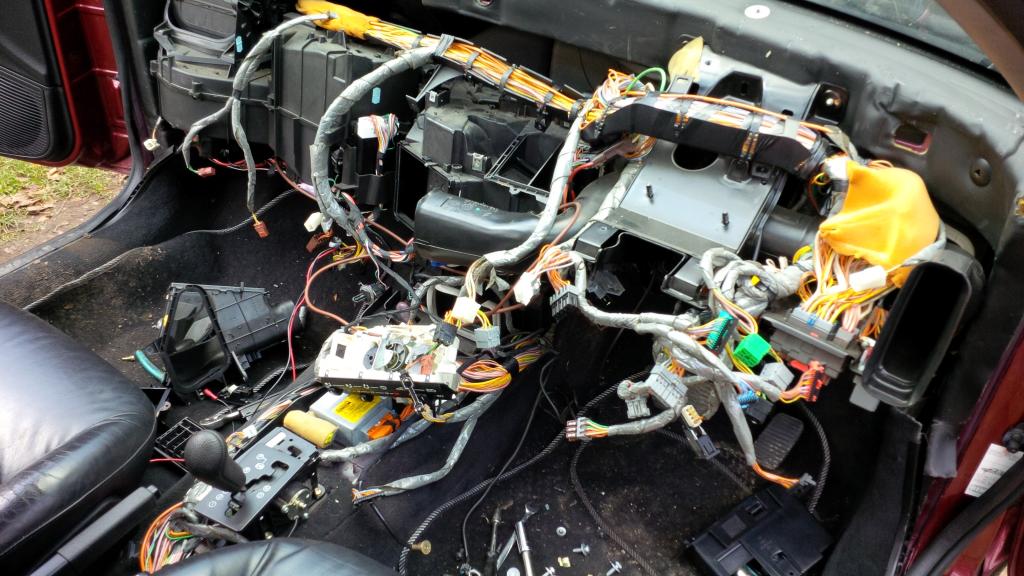

Well the heater matrix is done, pig of a job, although Paul did make it look easy :-D.
Just the water pump and timing belt to do tomorrow, and then there's a couple of odd jobs for Thursday
Steve
http://c6owners.org/index.php

Others who have been in here might spot the front section of heater box on the floor...
Oooerrrr that was me, I pulled a bit hard and it came away... :shock:
Luckilly the latchs on the small section on the floor broke, NOT on the main heater box.. so into the stock to find another heater box and swapped the front over from another.
Genereally went ok.. dont think I broke.... OH Yes I did break something else, the bloody heater pipe elbow plastics... in the engine bay.. luckilly, a small stock in the shed provided another which needed cutting down to connect to the LPG coolant pipe T junctions... so again, nothing drastic.. 8-[
A very sad...

citroenxm wrote:Others who have been in here might spot the front section of heater box on the floor...
I think today's school report should say "must try harder" not to break anything :rofl2:

Well, we've started again this morning doing the timing belt, and discovered the top engine mount is goosed and the spring tensioner..... I will have to get them sorted out another time, i'll post some pictures later.
