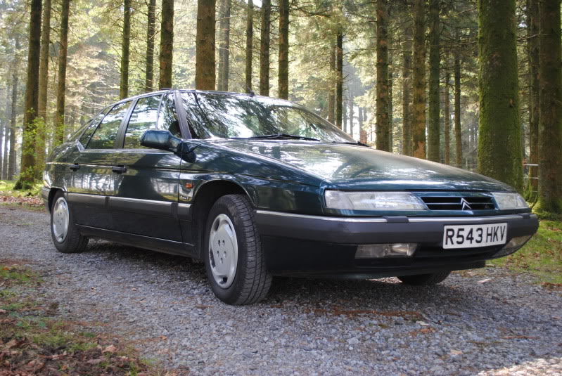

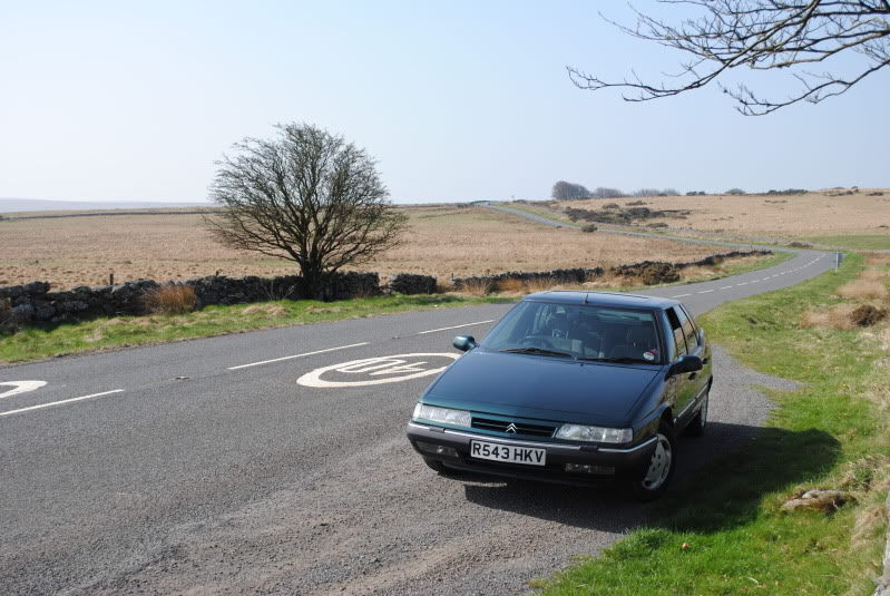

Just been reading back through and I seemed to have missed your post, sorry :oops:
That would be a good idea, here they are:

red_dwarfers wrote:Image
Looks like a scene from "Waking the Dead" - where are the bodies buried? :shock:
