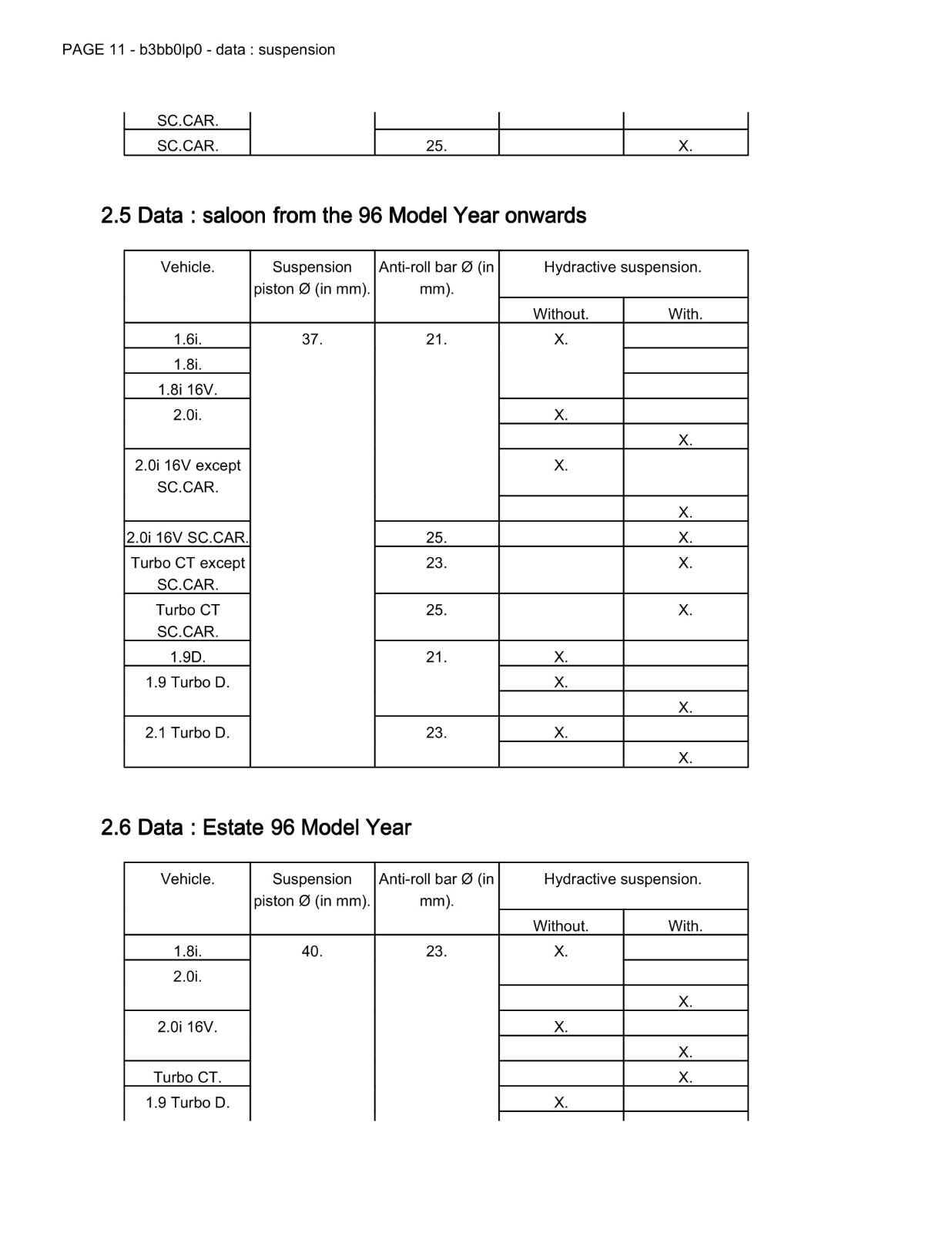

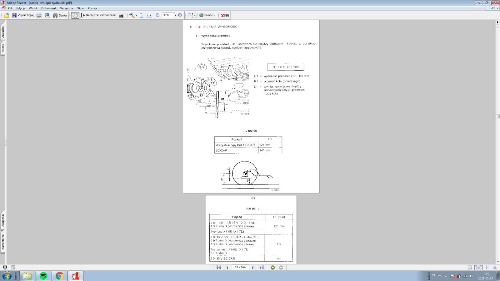

I know the thread jumped from bubbles into the suspension to height calibration, which is understandable,
but I was wondering if you have something similar for post 1997 X1 Xantia.

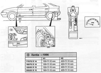

What I found so far is:

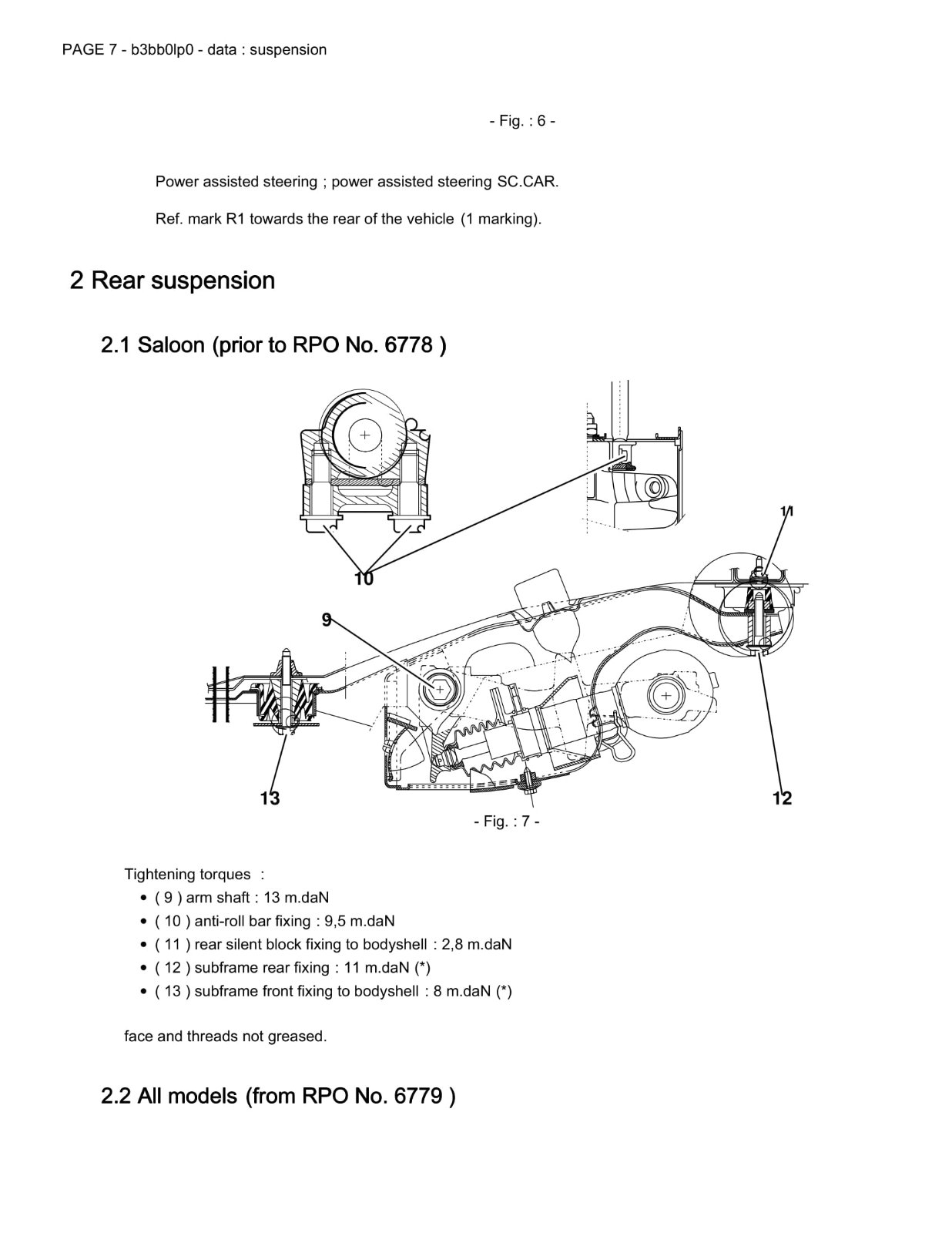

1. This pic for pre 1996 Xantia (found on the Net, don't know if the values are true
It could be something onto my comp only, just puzzled, that's all.

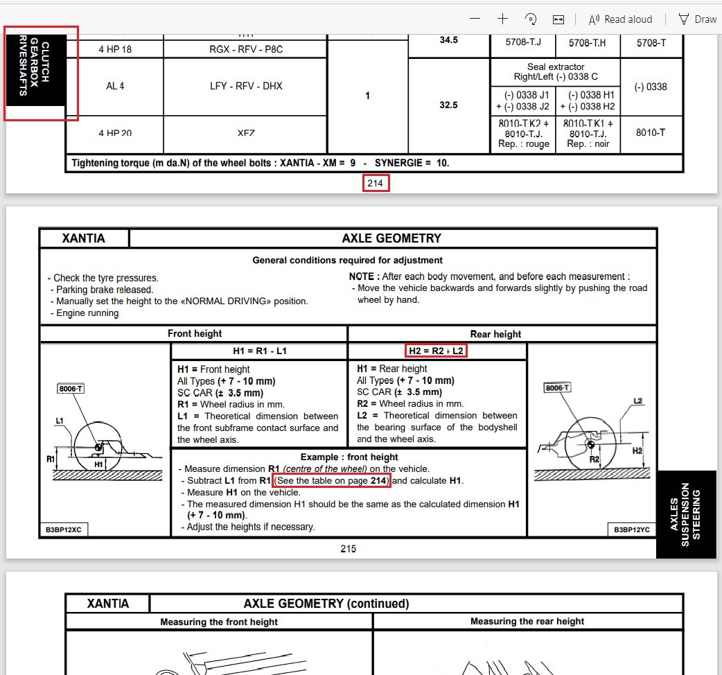

Re: Workaround for bubbles in LHM return flow

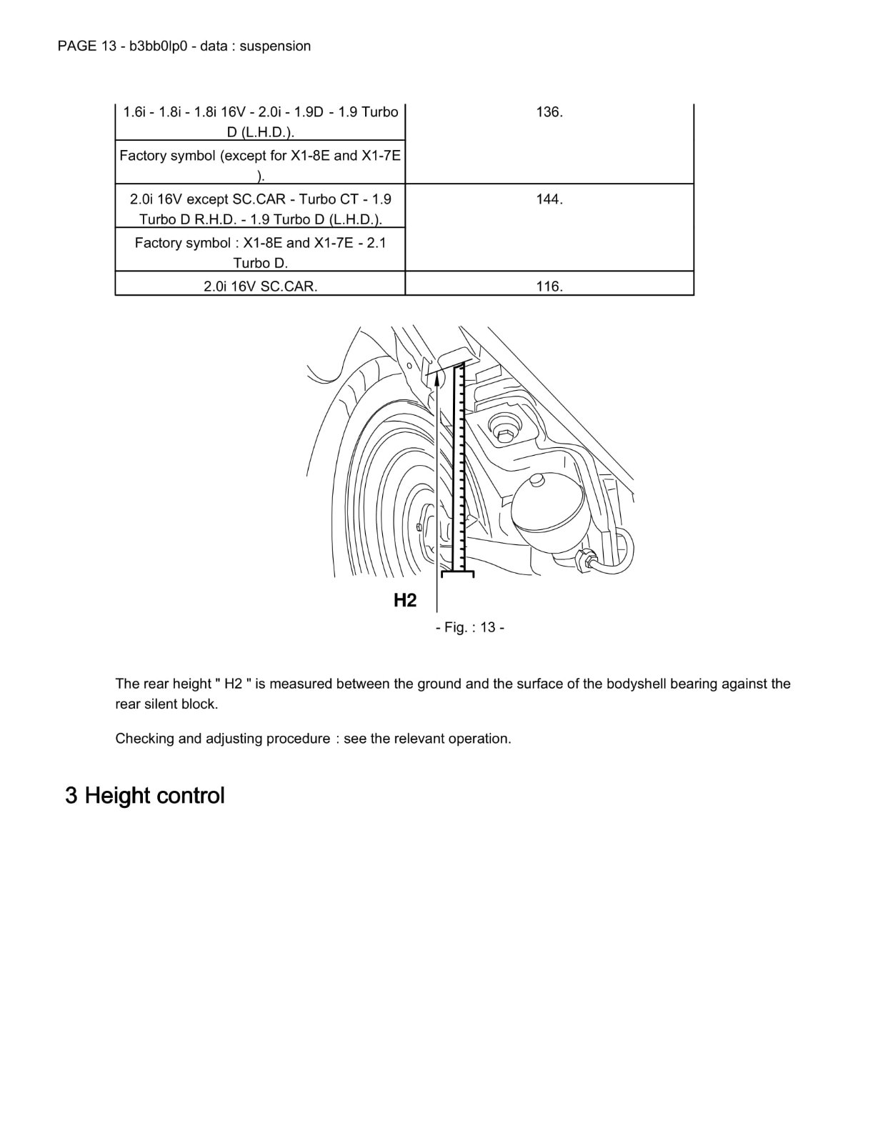

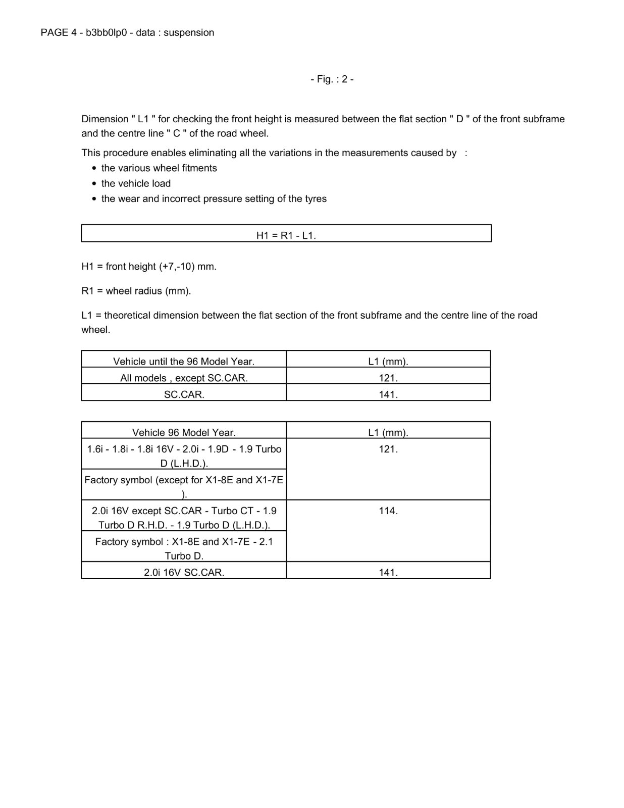

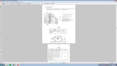

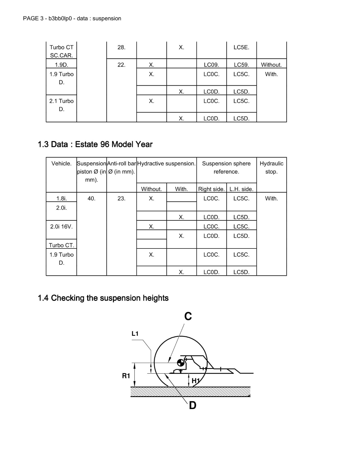

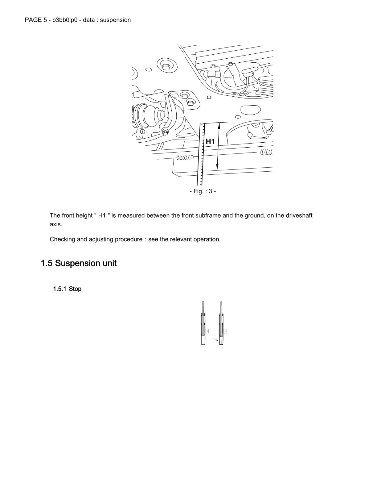

Hi Chris, thanks for taking time, but please, it's not urgent at all, and don't bother if it is going to be too much effort.
I'm just trying to reassure myself, that I can use the method provided by the "S2 Xantia.pdf" file. Ofcource mine is S1 Xantia, and maybe that method is not relevant.
There is written, for the front H1= R1 - L1, where L1=121 mm; and for the rear H2= R2 + L2, where L2= 136 mm. L1 and L2 are such at "Normal height" I guess.
I'm using 185/65/R15 tyres, so 15*25,4= 381 mm, and 2R1(R2) = 381 + 2x65 = 511 mm, so R1(R2)=~245 mm with the flattening of the tyres.
So, H1= 245 - 121 = 124 mm, and H2= 245 + 136 = 381 mm.
Pretty different from H1= 155 mm and H2= 420 mm, despite only tyres ~490 mm in diameter are cited into my first pic for pre 1996 Xantia. Calculating the above with 490 mm diameter will give even smaller H1= 114 mm and H2= 370 mm.
Now, while digging deeper into the matter, it seems to me, that that type of data and/or method for calculation are pretty specific for every different range produced, and maybe non of the two sources I'm citing are really relevant to my case. As you said, many changes were made during the production phase, and probably they've involved also the geometry of the ride height, which is pukka
The car is 1997, January I think, but this is only, what I can disclose for the moment being.
As I said, don't bother if it is going to be too much effort, I think I'm closing on it tbh

Can you share the whole .pdf

Little when it leaks from the 6 piston section. A common problem is with the 2 sections of the suspension and NBR seals. Alternatively, use NBR 90shA, it deforms less and lasts longer. I mainly use Viton / Fluor, unless the size is not appropriate then NBR90. I have a paper seal in the original. The simmering on the shaft had to be replaced as you had everything pulled out and put it a little closer than it was to let it work itself on the clean surface of the shaft. I used Viton brown as it was originally.
- x 1751
Unfortunately, not possible to post pdf's into forum posts, or PMs.
If not too many pages, you can convert the pdf pages to jpg's (eg with Foxit Phantom) and post those.
Alternatively, send the pdf as an email attachment to the member involved.
