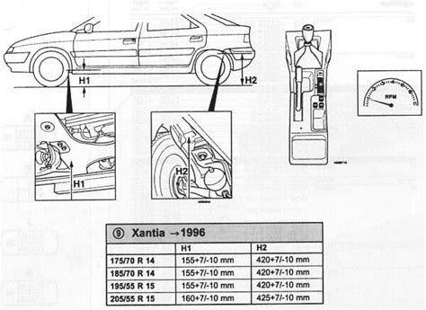

I know the thread jumped from bubbles into the suspension to height calibration, which is understandable,
but I was wondering if you have something similar for post 1997 X1 Xantia.
What I found so far is:
1. This pic for pre 1996 Xantia (found on the Net, don't know if the values are true :lol: ):
2. This page from the Forum's "S2 Xantia.pdf" link/file, where I found something strange:
Onto page 214 there is no table in regard to the height adjustment?
It could be something onto my comp only, just puzzled, that's all.

If you need the info for your Xantia, what year is the car?
VIN number if you can, too.

Hi Chris, thanks for taking time, but please, it's not urgent at all, and don't bother if it is going to be too much effort.
I'm just trying to reassure myself, that I can use the method provided by the "S2 Xantia.pdf" file. Ofcource mine is S1 Xantia, and maybe that method is not relevant.
There is written, for the front H1= R1 - L1, where L1=121 mm; and for the rear H2= R2 + L2, where L2= 136 mm. L1 and L2 are such at "Normal height" I guess.
I'm using 185/65/R15 tyres, so 15*25,4= 381 mm, and 2R1(R2) = 381 + 2x65 = 511 mm, so R1(R2)=~245 mm with the flattening of the tyres.
So, H1= 245 - 121 = 124 mm, and H2= 245 + 136 = 381 mm.
Pretty different from H1= 155 mm and H2= 420 mm, despite only tyres ~490 mm in diameter are cited into my first pic for pre 1996 Xantia. Calculating the above with 490 mm diameter will give even smaller H1= 114 mm and H2= 370 mm.
Now, while digging deeper into the matter, it seems to me, that that type of data and/or method for calculation are pretty specific for every different range produced, and maybe non of the two sources I'm citing are really relevant to my case. As you said, many changes were made during the production phase, and probably they've involved also the geometry of the ride height, which is pukka :-D
The car is 1997, January I think, but this is only, what I can disclose for the moment being.
As I said, don't bother if it is going to be too much effort, I think I'm closing on it tbh ;)

ksanturion10 wrote: 15 Jan 2021, 23:18 Hi Chris, thanks for taking time, but please, it's not urgent at all, and don't bother if it is going to be too much effort.

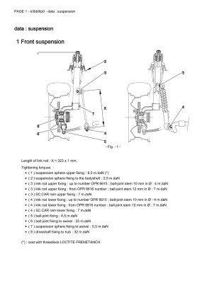

I have a description of the height of the Xantia but depending on the engine, not the size of the tires. Maybe it will be useful to you.

Yes, thanks ;).

My point was that the 2 piston section is leaking much more often than the 6 piston section :) Of course, it has to be dry. That Polish description has over 160 pages and there is a lot of interesting information about the work and functioning of the suspension. I found something else for you :)
