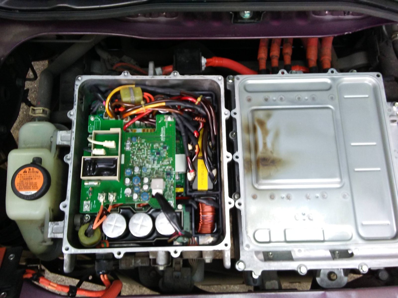

Here is a picture of on onboard charger (not mine) with the lid off:
One thing that has been pointed out to me is that the onboard charger lid doesn't use a gasket it has some kind of grey silicone sealant goop to seal the lid on and make it water proof - very important as it is under the body at the rear so the outside of the casing is subject to road salt and spray. So I'll need to buy a tube of sealant to seal it back up again.
The question is, what kind of sealant will it be so I know what to buy ? The box looks to be aluminium alloy, it is subject to road salt and spray so needs to be air tight as well as water tight. I don't know how hot the box gets - not as hot as an engine but it may still get up to say 50-60C during charging. (Not sure really) Any suggestions on what to use so I can get some ordered ?

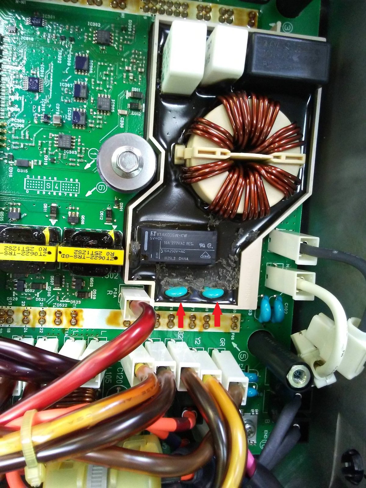

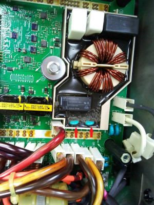

Here is a picture of the two capacitors that may have blown that need replacing: (not mine)
To replace them the potting around them has to be dug out, and while they are through hole caps getting to the underside of the board is an extremely big job, so most people doing this repair have carefully snipped the caps off the legs and soldered the new ones carefully to the old legs as this saves many hours of work and specialised tools trying to get the rest of the unit apart...
In at least one case someone had to replace one of the two white power resistors in the top of the potted section - hopefully I won't need to do that as that does require further difficulty disassembly.

They're 1000pF 6kV disc ceramic capacitors, about 10mm in diameter. One of the guys who has lead the charge on diagnosing and repairing on board charger failures has a theory that it's actually the fuse that blows first due to mechanical fatigue over many years, and that the fuse going open circuit during charging causes a huge inductive voltage spike that blows up the capacitors, which are used as snubbers. (I think the originals are not nearly as high a voltage rating as the replacements we're using)You'll be looking for the highest spec capacitors that will fit, I guess! What a miserable thing to fail.
Unfortunately it sometimes blows other components as well as the capacitors - in his own car it also blew a diode which is completely inaccessible and essentially impossible to replace. Luckily for him he's in the USA where Mitsubishi are now replacing these failed units out of warranty free of charge so he got his replaced. I'm not so lucky though!
