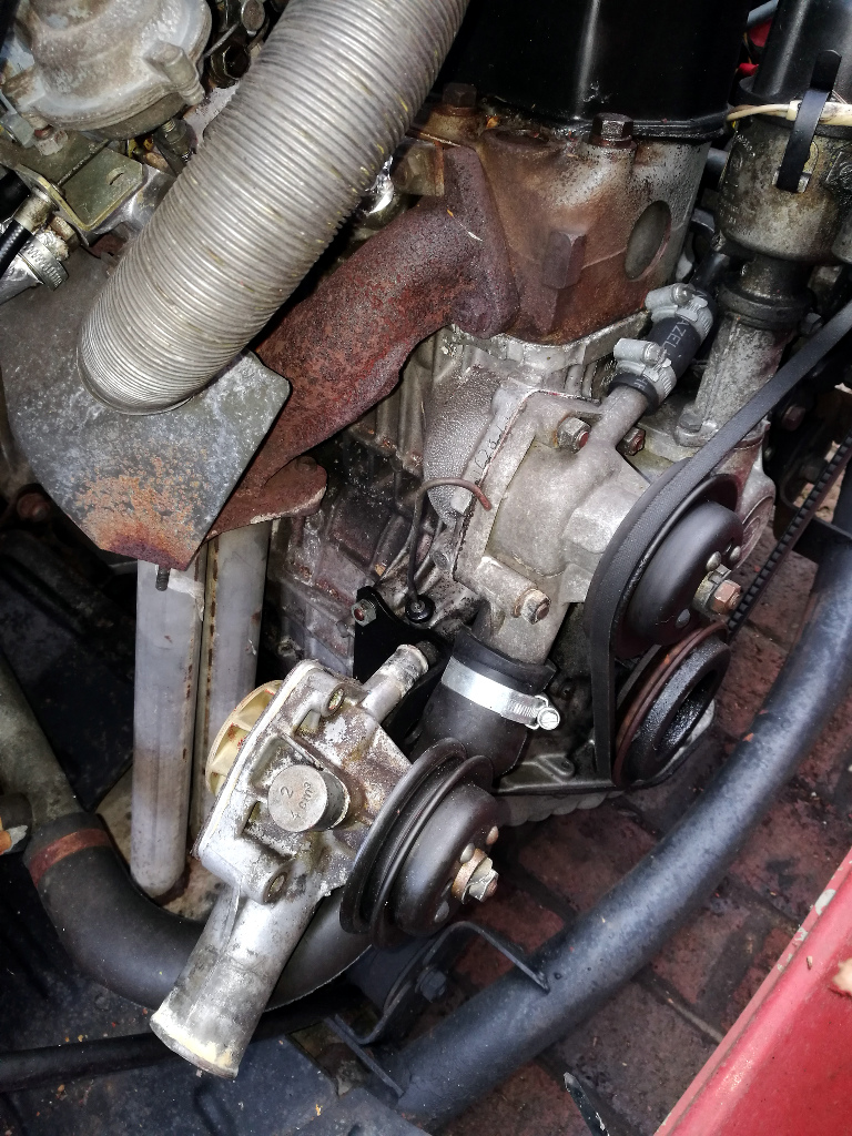

Finding the original water pump took all of 30 seconds as it was exactly where I thought it was. Here's the difference between the aftermarket one which came with my first Estelle (fitted in the photo) and the original.
The impeller on the original is about twice the depth of that on the one currently on the car, though the pitch is slightly different - and it never caused me any issues on the previous car - just having eliminated the original water pump as the cause of the problems, I would have preferred to have the original put back. It looks better.
First thing I did of course was to pull what on any normal front engined car would be the bottom radiator hose (the one to the left of the water pump). Glad to report that the coolant that emerged was crystal clear blue coolant without any sediment, contamination etc. Far cry from what I drained out of the Saab when I first got it (which looked like slightly watered down red oxide primer). Likewise when I flushed everything through there was no signs of any gunk to emerge from the system. I think the flow is decent enough given the head you're pushing against to flow through the radiator and heater matrix and the length of the pipework involved. Even when I reverse flushed it there was absolutely no signs of any crud emerging from the system - tending to suggest I'd done a decent job of it last time.

I've discovered however that after a couple of years a fine smear of blue gasket sealant apparently can form a ridiculously strong bond! The nuts came off perfectly, but the pump is well and truly stuck to the housing. After arguing with it for half an hour I decided to just leave that well alone for now and get on with what I set out to do.
...At which point the hose clip immediately to the right of the water pump decided it had had enough of life and decided to fall to bits. Cue expletives. If you hear Estelle owners talking about "that pipe" it is usually referring to that tiny little bridge between the water pump and the ridged line that disappears off around the head, by the tappet cover to the heater hoses. Simple reason? Because it's an absolute swine to remove or fit unless you want to totally disconnect all the heater hoses at the other end and detach the aforementioned hard coolant line. Even then it's a royal faff as the pipe will only fit between the cylinder head and the distributor if you've got the hose clip at *exactly* the right angle. I also remembered from last time I did this (when I replaced that bit of hose and the bypass pipe) that everything seemed very well stuck to the solid coolant lines, and between that and the heater hoses being in good condition, I'd decided to leave that well alone.
The upshot of this was that I spent about 20 minutes getting a new hose clip onto that tiny bit of pipe and reattaching it. I *still* dislike that two inch long bit of pipe as much as I did when I encountered it on my first Estelle.

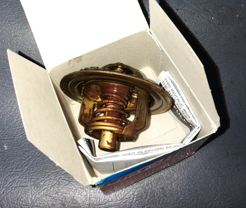

Anyhow, having sorted that nonsense out, back onto doing what I actually set out to in the first place. Thankfully I knew that the last person to have the stat housing apart was me, and sure enough it came apart without any protest. The stat which came out isn't the worst looking one I've seen by a long shot, though being Mahle branded has obviously been changed at some point.
It did however reveal one glitch with my new one - that it hadn't come with a paper gasket. I did my best to salvage this from the one on the car and got *most* of it off intact...but for now just had to be a bit more generous with the sealant than I normally would like. I'll get a new gasket ordered in due course (they're all of £1.69) so that can be tidied up to my satisfaction.
