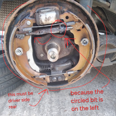

These ones are confusing me as ive done these before and as you say get the screwdriver in the do the adjustments, but this holes position is more or less in line with the shock absorber and screwdriver length would then come into play . It was hard getting the drum off , and the first one ive ever had to fight with, I think who ever fitted the shoes knew the handbrake cable has wear due to age , so though it won't be a problem i will tighten the adjuster on the shoes ......,big mistake .

Huskyxantia wrote: 01 Feb 2026, 20:10 These ones are confusing me as ive done these before and as you say get the screwdriver in the do the adjustments, but this holes position is more or less in line with the shock absorber and screwdriver length would then come into play .
Ah sorry I had missed this bit!
So the hole is in the backplate? On the 406 (and from Jim's description the AX wheel bolt hole) you are reaching through from the outside at least!

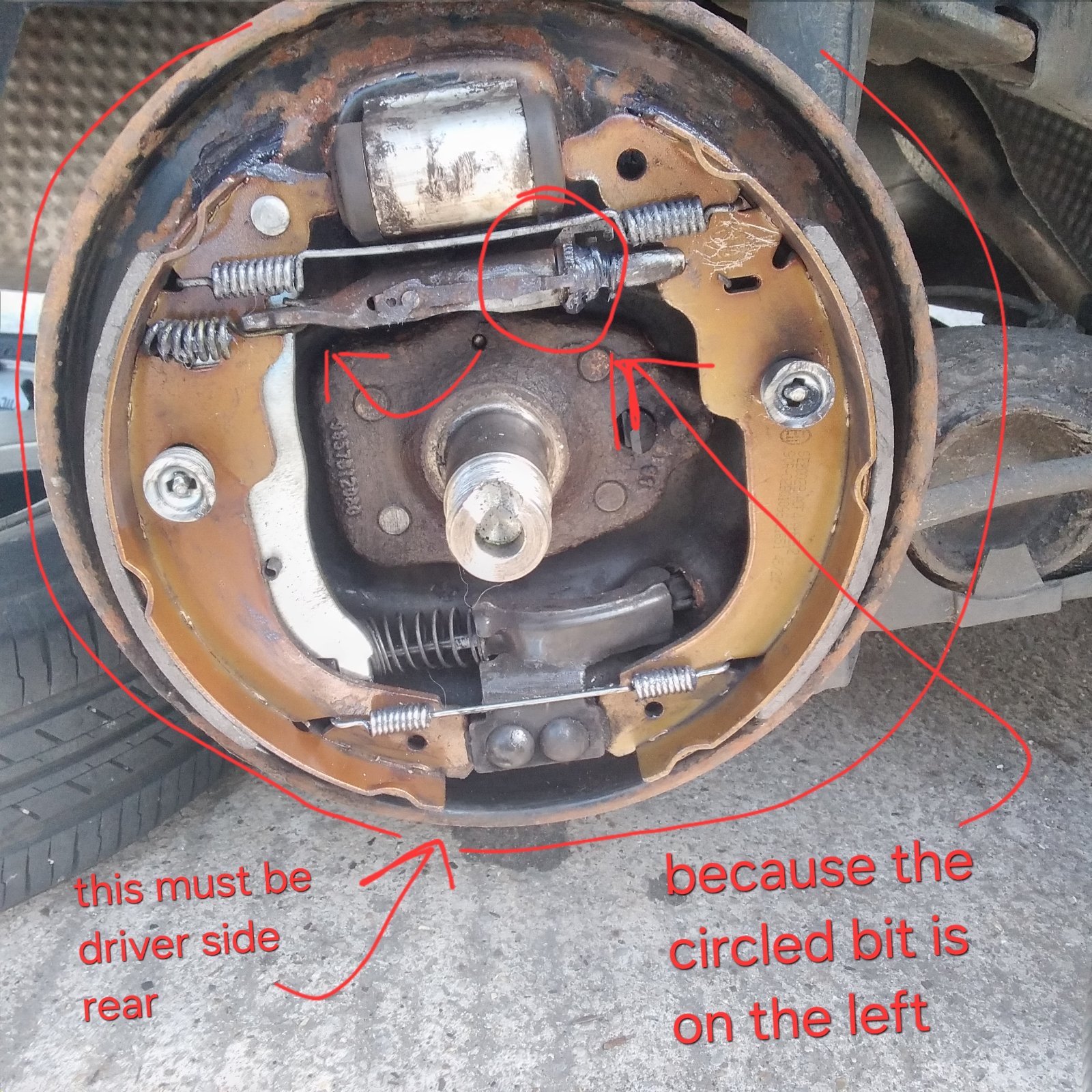

Yes thats correct hole is in back plate sorry if I didn't mention it , ive heard of doing the adjustments via the bolt hole , think i had a mk2 fiesta not sure that got adjusted that way , if I'm wrong it might of been another old car I have many yr back.
The photo attached is a 3 year ago when I had my grey 207, the adjuster is on my left as your looking at it , this photo must be the driver side rear , or im hoping this setup hasn't been done the wrong way by previous ownership care ?. Or is this how they go
Driver side rear adjuster on right
Passenger side rear , on left?
Is this why the hole isn't near the adjuster ? Oh heck 😳

Definitely the driver's side, the handbrake cable gives it away and it all looks identical to the photo I took of the C3 so everything looks right.
Both sides are a mirror image of the other. The auto adjuster has a cogged wheel that has a bit that drops into the cog teeth to stop it turning back so even if you can find a hole in the back plate it may be impossible to turn the cog back if you cannot lift the bit. In some ways it is like a handbrake ratchet.
On the Cactus the adjusters had D on one and G on the other which I took to be right and left (droit and gauche). However, they were on the opposite sides of the car when looking to the front and had been put on this way when built so I did not swap them over.
