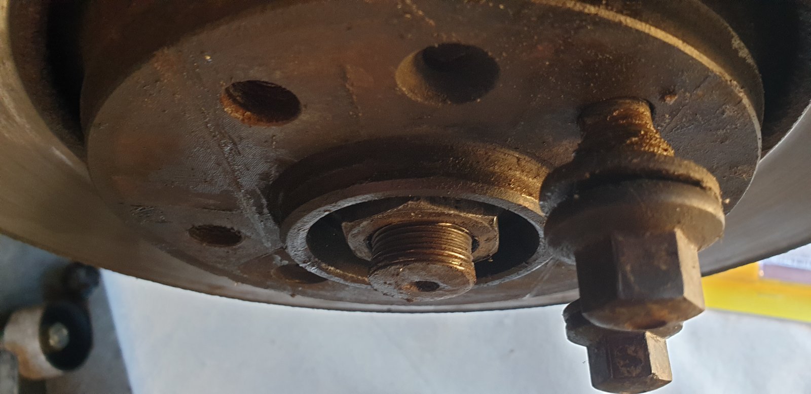

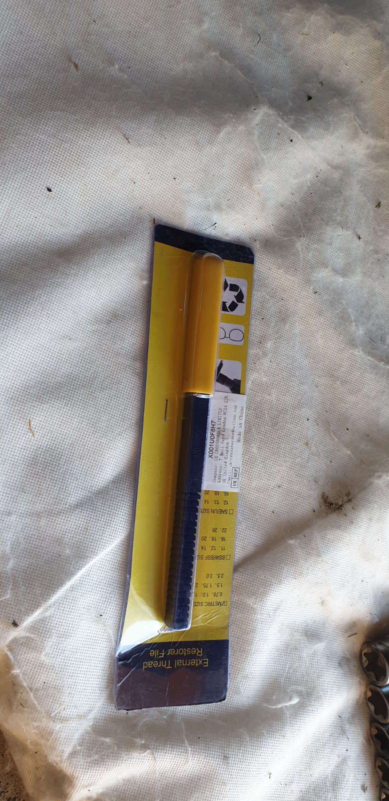

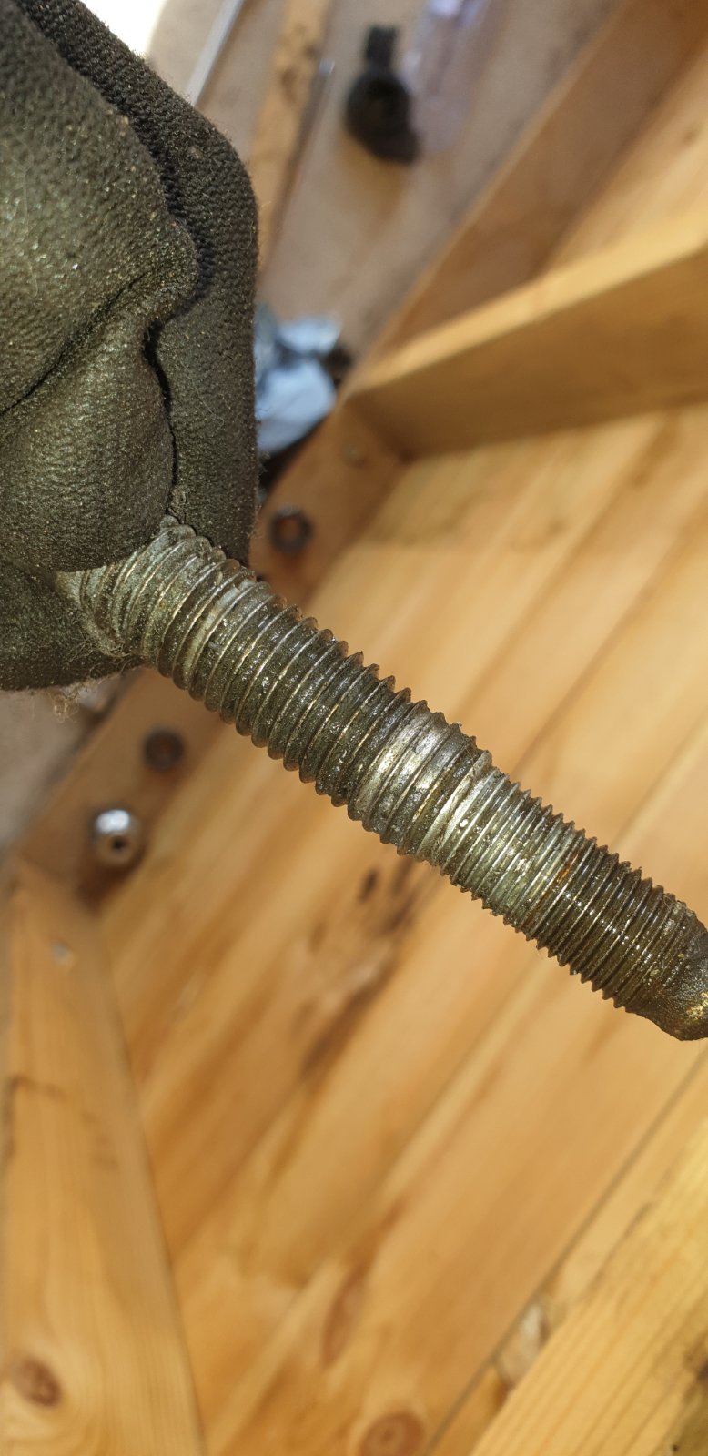

My thread repair file had arrived in the week.
The thread did not really look that bad, but it was binding on the nut badly. So I repaired it bit by bit, using this and a needle file.
The hub nut finally came off, and I was very relieved!

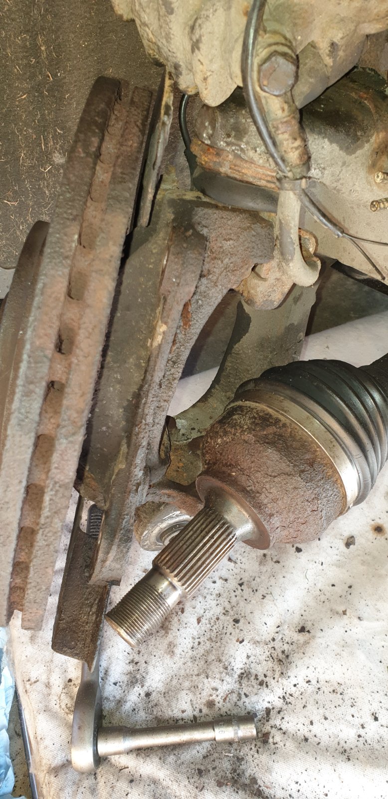

The drive thingy was released in no time...
But the spider still would not go back into it's tulip!
I realised the bearings are indeed slightly wider than the tulip, and using a bit of timber and my hammer, I gently persuaded them back in.
Well don't I feel stupid... I didn't even need to remove the hub nut!

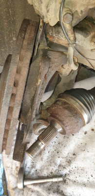

So then to the task of getting the driveshaft end back in. But the sodding thing would not play ball! The shaft refused to straighten up.

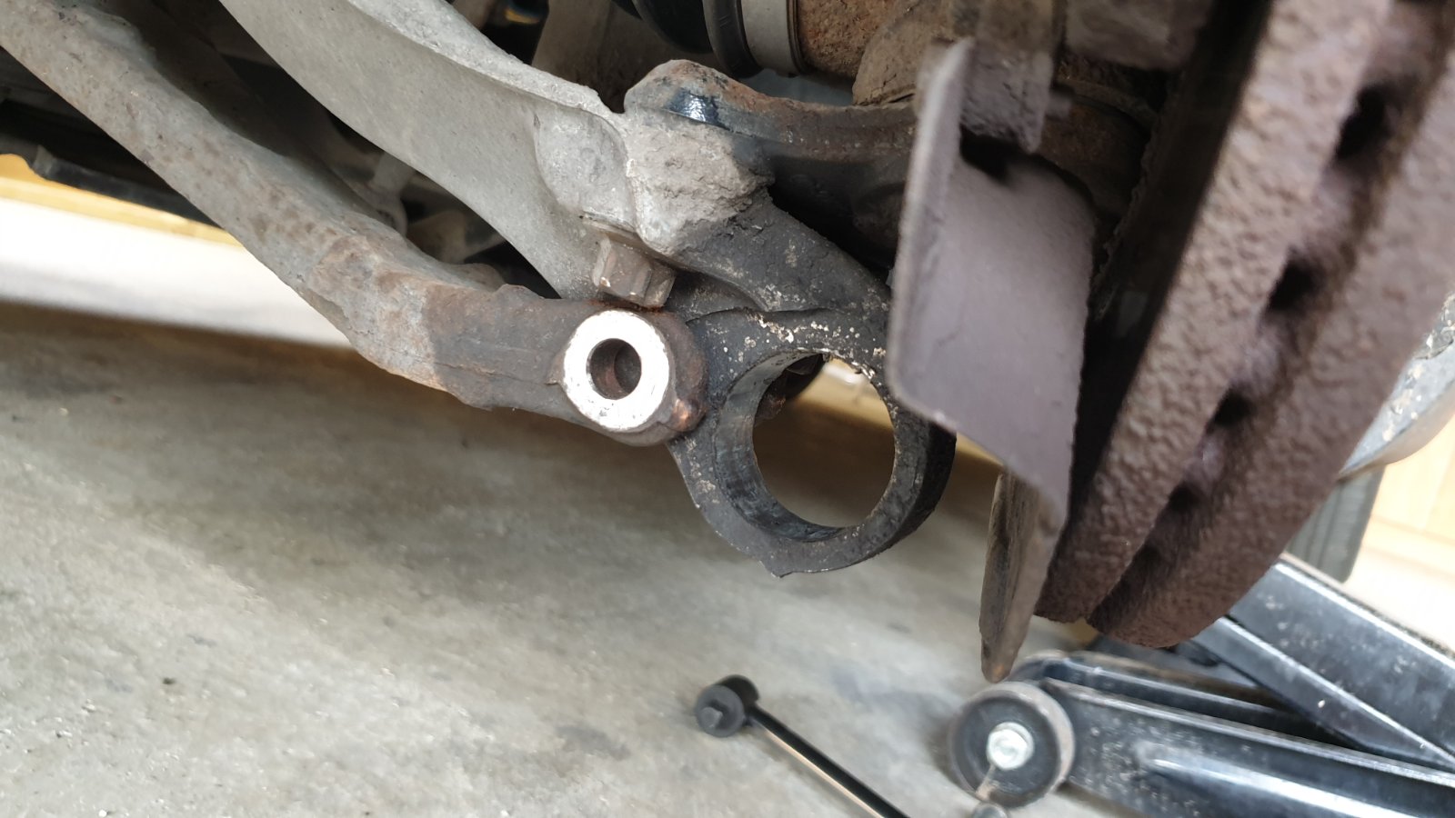

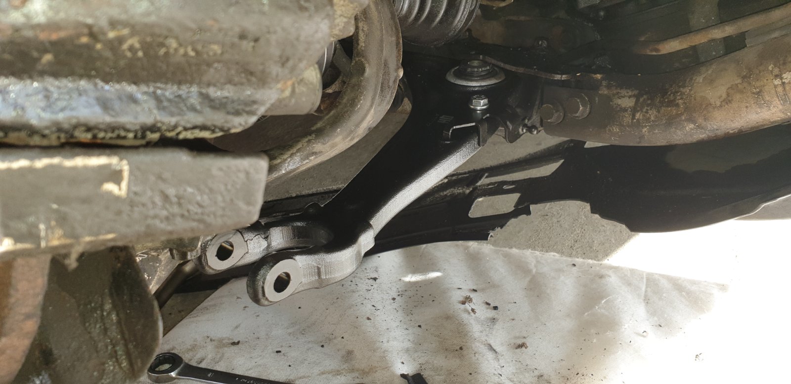

I decided to try getting the new arm fitted.
First I needed to remove the old bush/support shown at the back here.
The bolt on the underside of it took an hour to remove, every 1/4 turn needed the breaker bar it was so sodding stiff!
Turns out the bolt had swarf engrained throughout the thread! Things were slowed by Lindsey turning up and popping to the neighbours over the road for a chat... then calling me over when Spencer was sick on their driveway.
I perhaps let him eat too many raspberries at lunchtime... Well he asked for them :roll:
I cleaned it up with the thread file, and needle file.
But putting the arm in did not help at all, as the hub refused to pull back in line with the end of the arm!

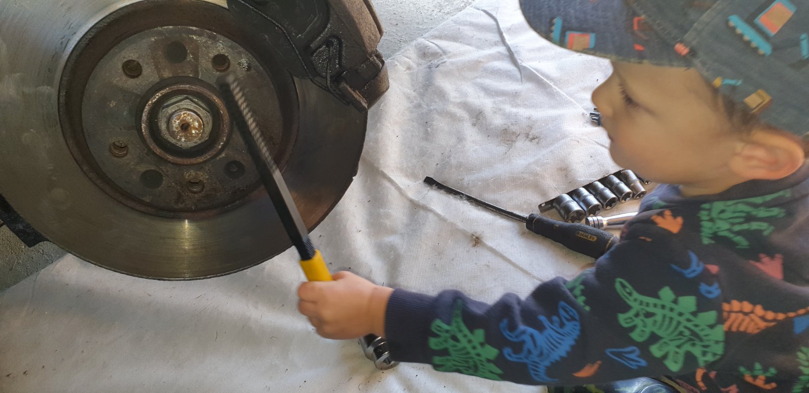

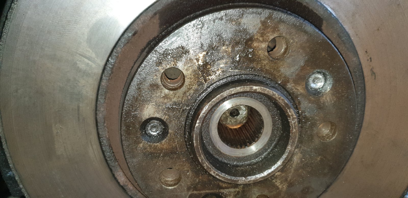

So I decided maybe taking the disc off would give better access... big mistake!
The nuts holding the disk on were completely made of rust! The nut heads rounded off in seconds... :shock:
So I had to drill them out... New Stainless steel replacements have been ordered.
But that didn't help manoeuvre the hub either. I quickly realised removing the disc does not help at all... #-o

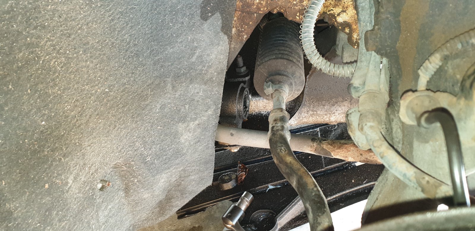

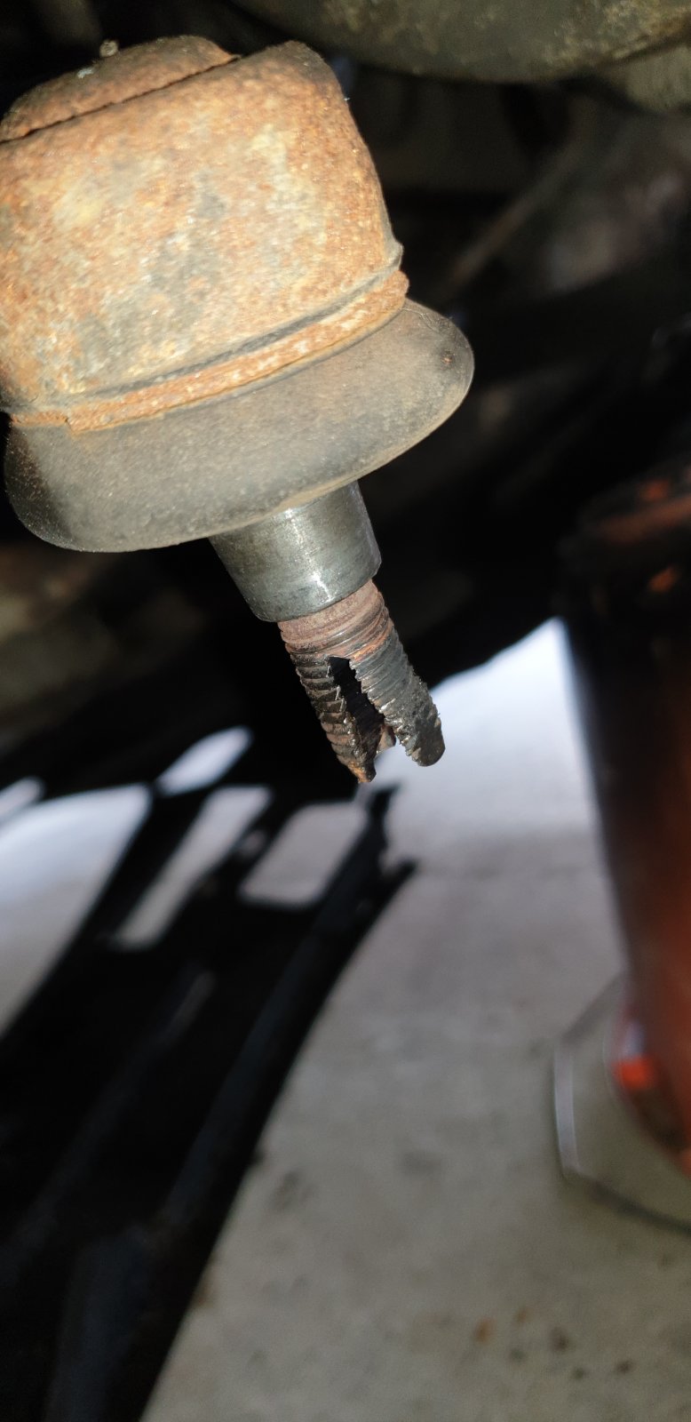

I stopped to watch a video on YouTube of someone changing the lower arm. I saw the chap removed the Tie rod end, so I went to unscrew mine.
But while in the video, the nut unscrewed neatly, mine just spun and spun... :?
So I used a grinder to remove the nut...
...and yes you've guessed it...
...new Tie rod end is on order...
I'll have replaced the whole car by the time this is over :o

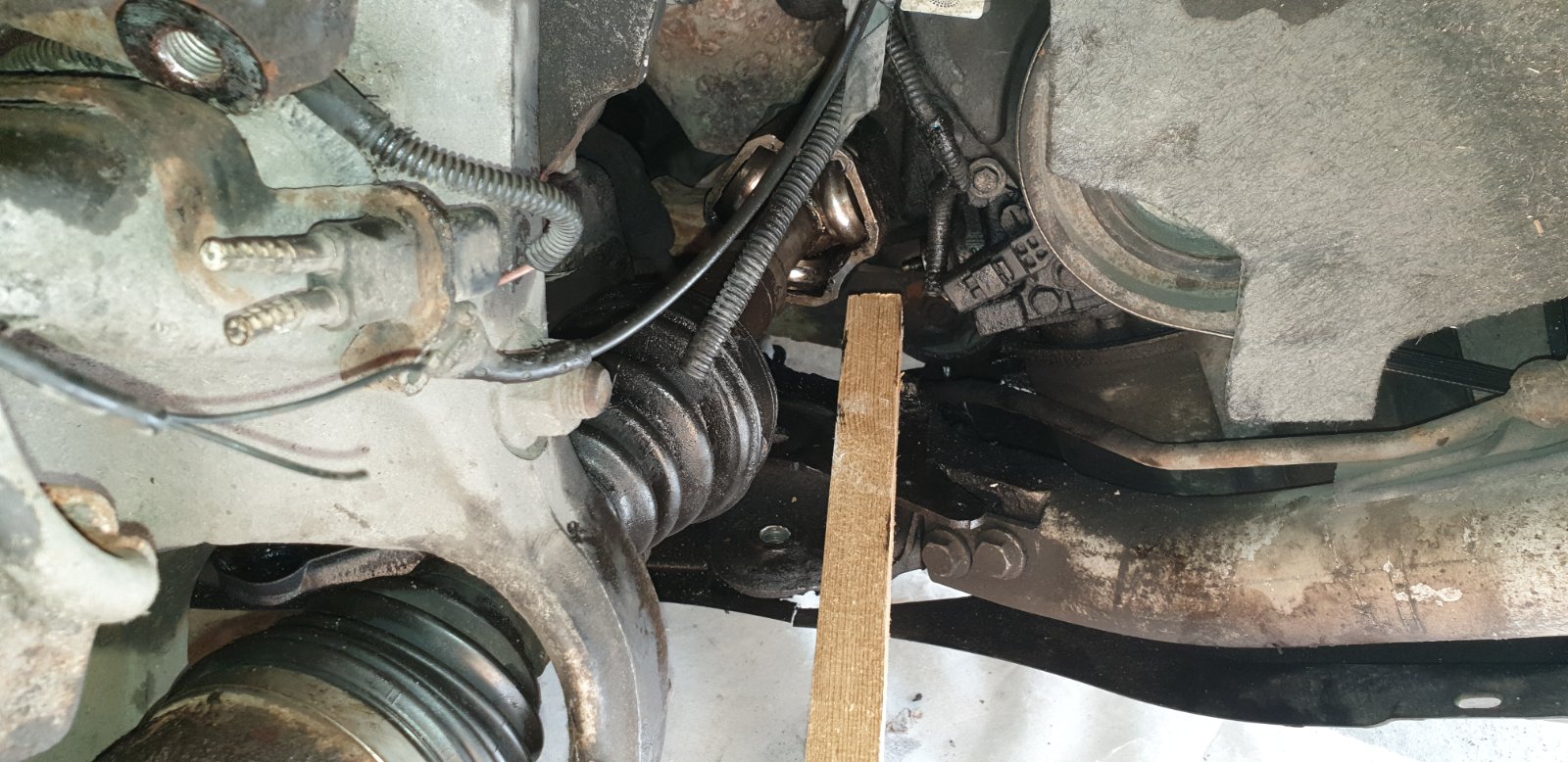

That did help. But I still couldn't move the hub enough. It seemed the strut was holding everything too tight.
So with even more research, I realised the strut could be depressurised by releasing the bleed valve on that corner.
I did this and it went loose :)

Did you take a look under the ball joint before attacking the shaft with the angle grinder?
I would expect that the tip would have been hollow (can actually see remnants in the photo :) ), and shaped to take an Allen or Torx key. This of course is so you can hold the shaft still while you unscrew the (Nyloc?) nut.

I've yet to come across a track rod end nut that needed the Allen / torx fitting to be used on removal, (reinstalling a very different story! )
Normally it's the next stage (persuade the taper to let go!) That gives me trouble.
But end if the day, track rod ends are cheap, they do fail and putting a new one is no bad thing. Think C5 ones are sided (406 ones definitely are, getting mixed up between the two cars of mine!) As the tracking would need a check, I'd buy a pair of rod ends and change them both. Then at least potential that it would need doing again (if one of the existing ones were to later fail) is minimised.

Forgot to ask, did the track rod end refuse to undo/ rounded off? Or just a bit trigger happy with the grinder? :-D

Sorry chaps - you are right there was a torque bit on the underside; I simplified the story to reduce my typing... :roll:
The torque bit did help me get a few turns off, but then it rounded off beyond usability... everything under there is soooo rusty!
I did order a pair of tie rod ends, and yes they are handed. Seemed sensible while I was at it as they were only £25 each.
