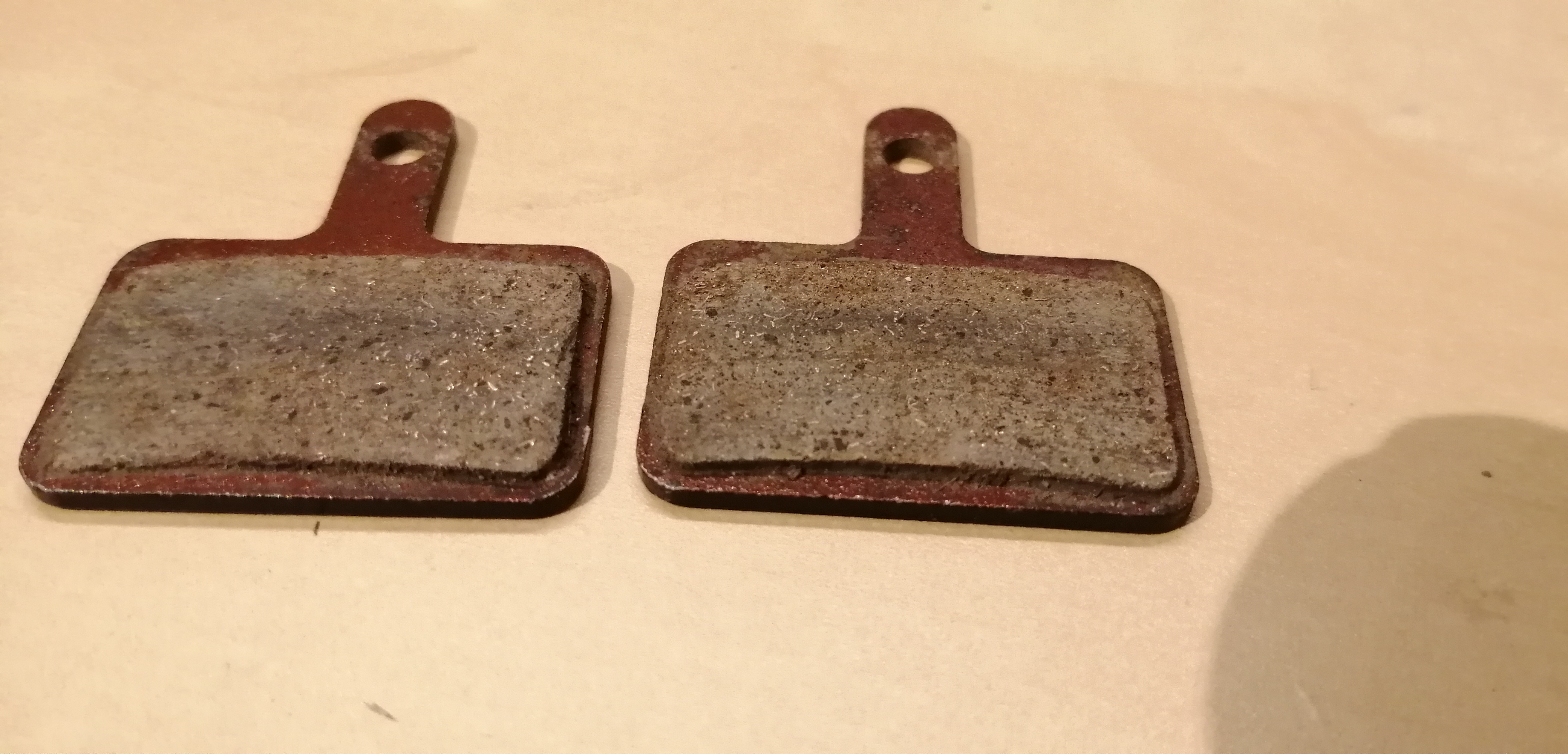

usually pics like this are of car pads.....
they look OK in the pic, well passable short term but they are wafer thin to the extent the spring is nearly thicker!
Winter mud and rain are brutal on MTB's, i'll be lucky if the chain/cassette survive much longer
new pads on the way....

in winter it is worth running the 'Sintered' pads , they withstand a lot better against the grit and coarseness of winter riding, however, they do have a habit of glazing over if not generated enough heat, i keep a box of the std shimano fit pads and sram ones as they are a regular concern, also well worth making sure the caliper is aligned as best as you can.

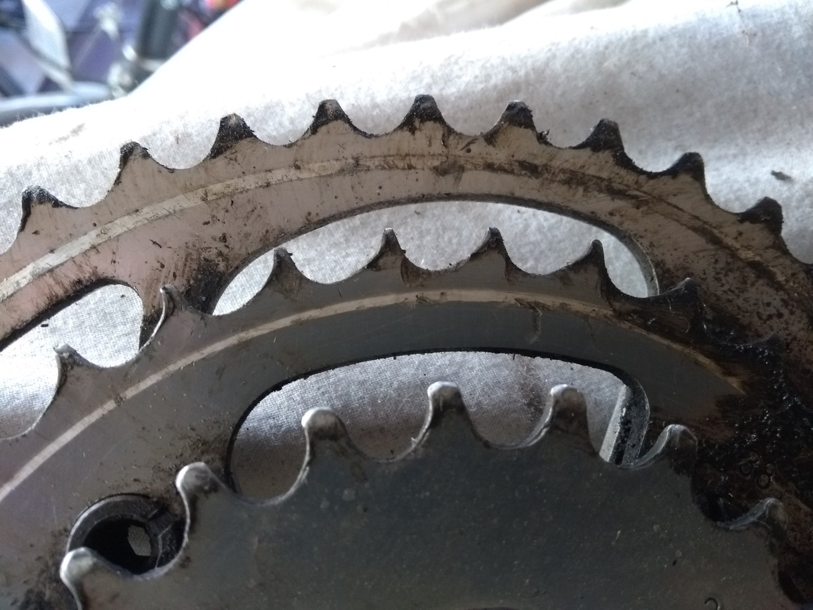

I've overhauled the drive chain on my bike. Chucked a new chain and block on, but the chain wouldn't run on the middle ring on the front. On inspection this was the state of the teeth, so it's not surprising really!!
:lol:
Of course nothing is straightforward... These are the original (mid 80s) Stronglight oval rings, which you can't get anymore, and the BCD looked odd so I couldn't easily buy new rings. Bought a new chain set, but that meant removing the pedals from the old cranks - which have been in there for 20 years. Ha ha!!! I got one out with a bit of heat, and just a minor melting of the plastic nut that holds it together (these are Shimano SPD pedals), but the other was not for coming. Eventually I took the pedal apart which allowed some proper heat and a decent spanner, but that wrecked the aforementioned plastic nut, so cue new pedals. Then went to fit it all up only to find that the position of the rings / cranks was totally different and I needed a shorter bottom bracket... So after procuring the correct bit, it's now all back together with new block, chain, chainset, bottom bracket and pedals :-D And whilst I was there thought I might as well re-grease the rear wheel bearing, and found a ball missing, but I found a spare for that in my stash. Goes, and changes gear, very nicely now!! Does need a new rear tyre as well though....

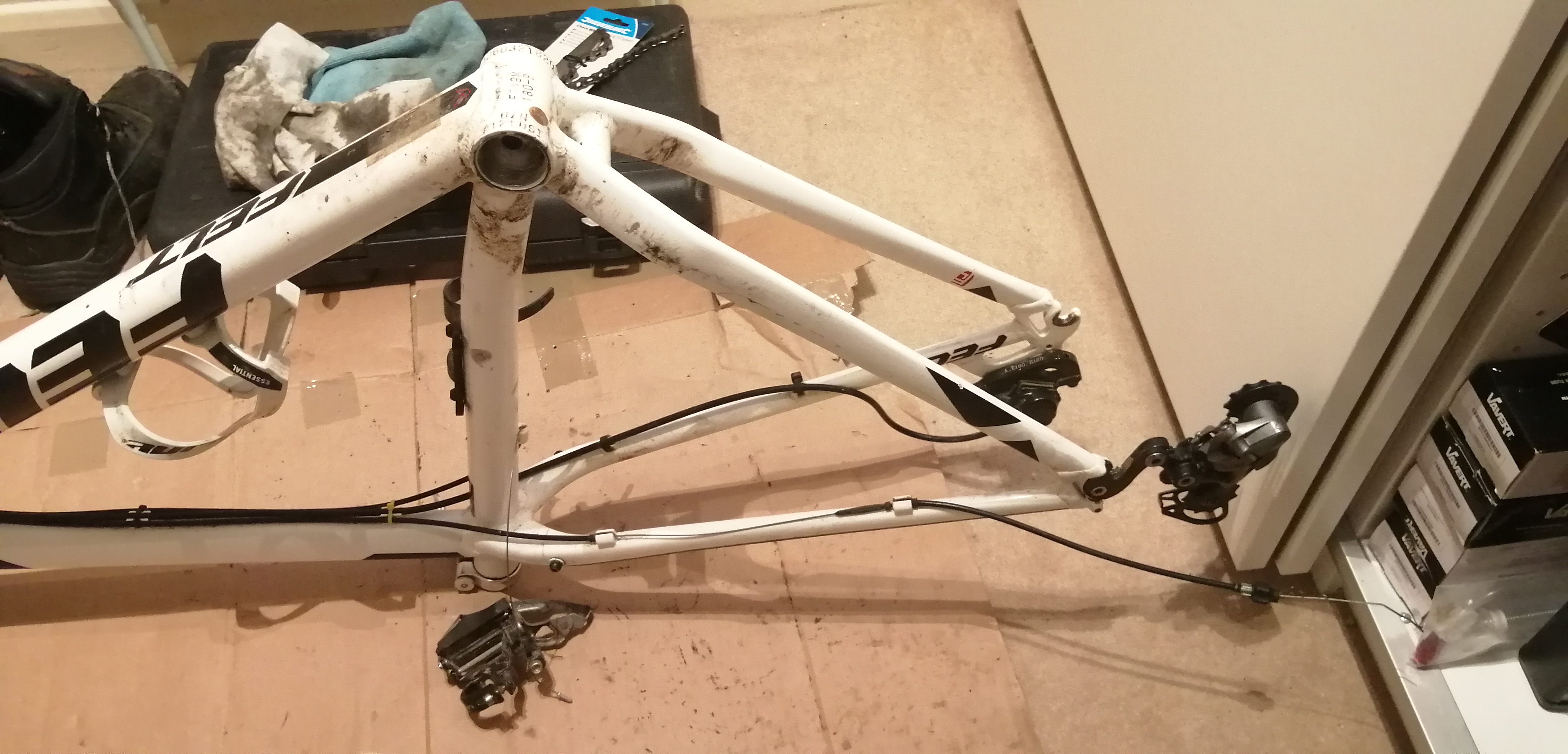

so the Felt came home from France for a 'service'.... axles cleaned and greased, rear cassette and derailleurs scrubbed and cleaned.
needs new BB, chain and a rear derailleur cable, not ordered yet 'just in case' i need more items....oh yes of course i do :roll:
last couple of outings at home on the Whyte have been torture, i'm sure someone put treacle in the BB - really hard going HR a good 15 above the average
made a few horrible squeaking sounds which i thought was the pads binding, turns out the BB bearings have seized and the cranks were spinning on the plastic bushes :shock:
off to scour the 'net for bits....
