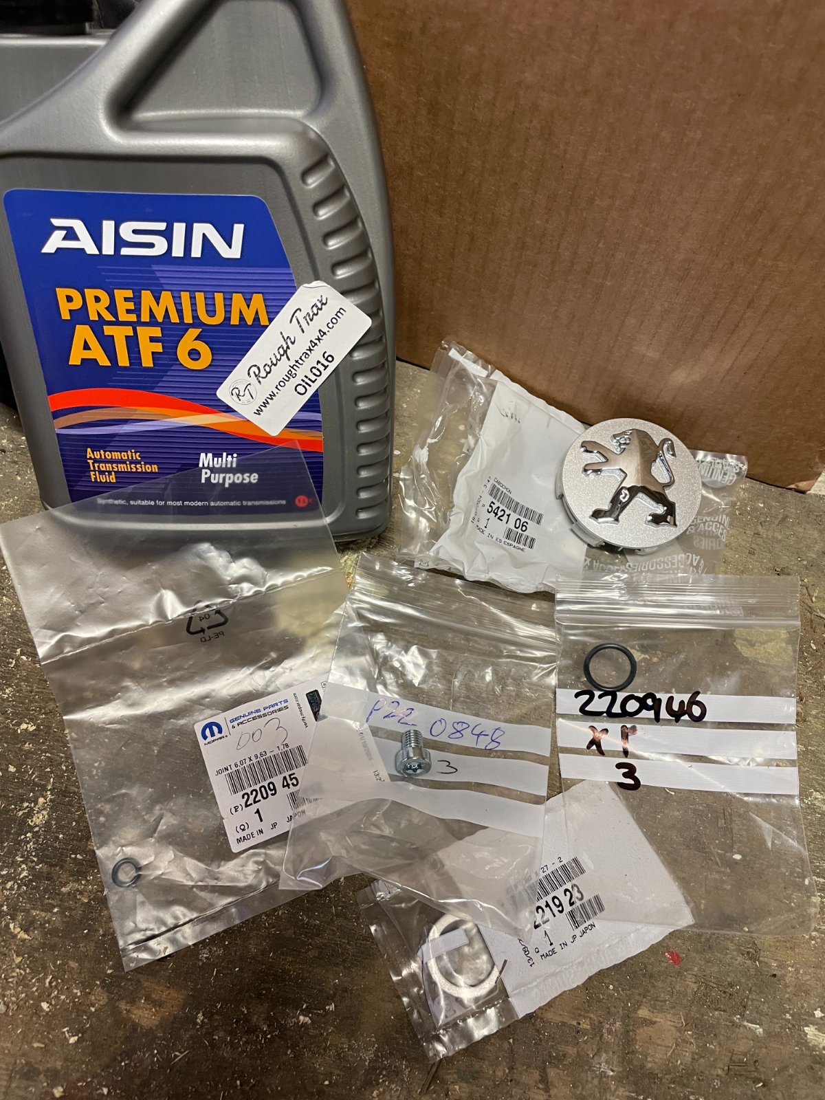

I think i have all the required parts.
Filler plug washer
drain plug seal
level plug
level plug seal
10 lt oil
Diagbox
I plan on doing 3 flushes in a row so i only bought 1 of each seal/washer.
After reading of the horror stories of prices and availabilities of the parts, people having to use Saab/Volvo/GM/Ebay i did try my local Peugeot dealer, and they are surprisingly cheap. 2 seals 1 washer and 1 plug all for about £10.50.
The most expensive of that, was for the filler washer, £5.70 So the rest is only about a fiver.
Oil was 10 litres for £99 delivered. genuine Aisin stuff as well.
