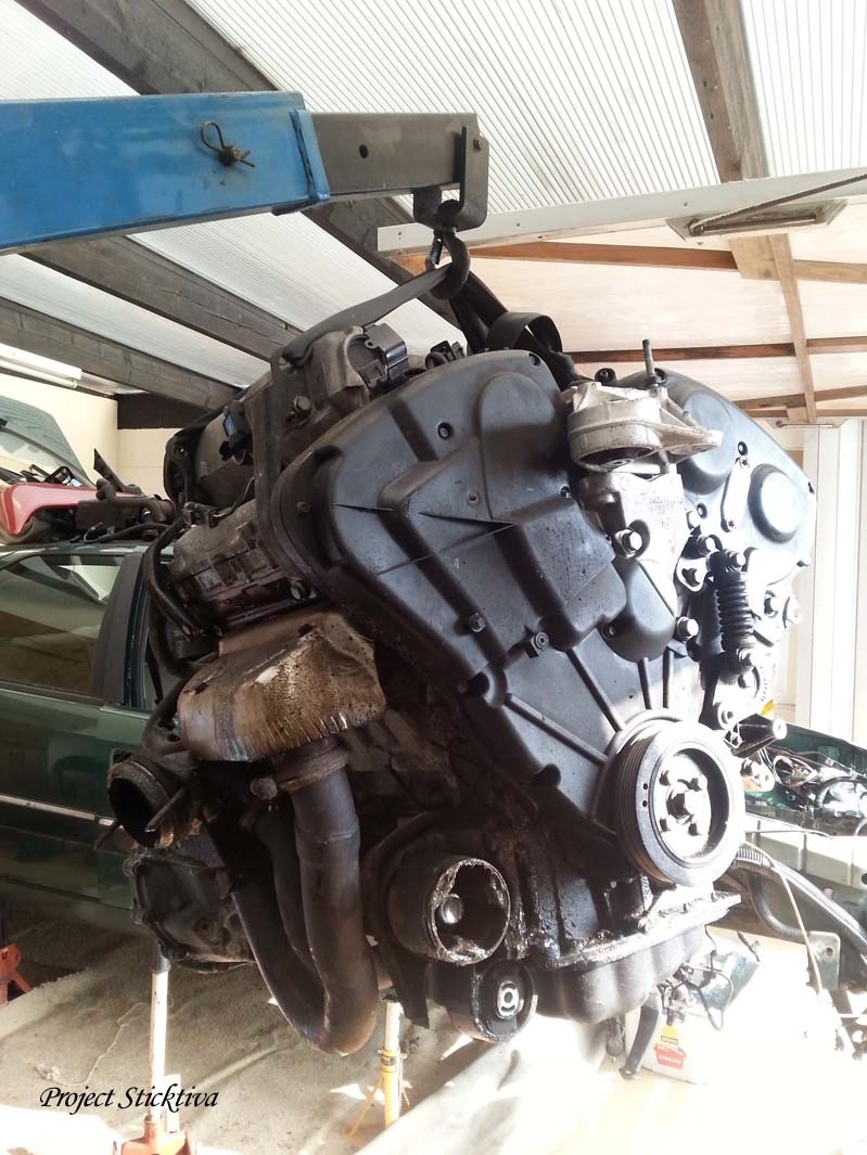

Stop press
The Green Goblin is DEAD...Heart ripped out SHOCK !...LONG LIVE Le Stickiva.............MUHAHAHA
And yes....the drive shaft boot had gone and it was YUK in there....
Stop press

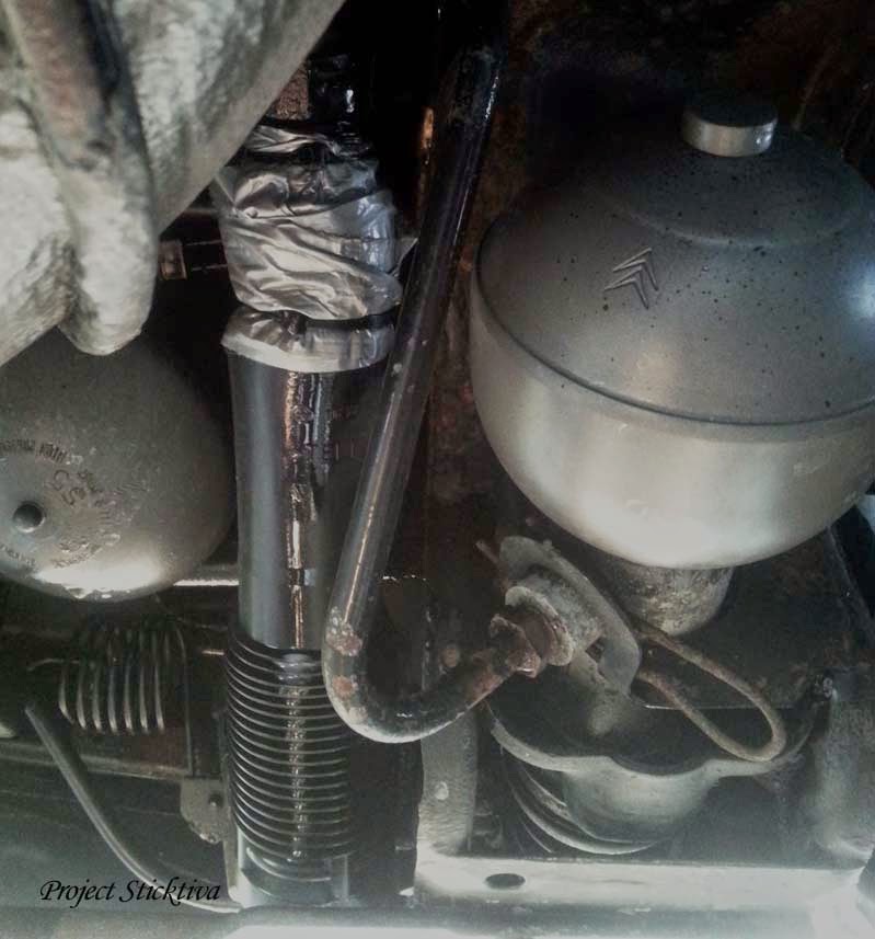

, I finally got to doing some investigation work on the V6Activa rear leak.
The whole underside rear was covered with sticky old LHM and lots of new stuff as well...
I just hit it with gunk, scrubbed with a soft brush and washed, applied again, left it then washed it down again then left to air dry.
This is the situation....as we can see the French do not seem to know about Jim and his conversions/re-seals..
Note, you can see the only area of corrosion on the car...THAT will be treated...it is however just surface stuff and a few lakes of old paint ...good wire brush and some converter will deal with that.
?? LHM removes under-seal ??

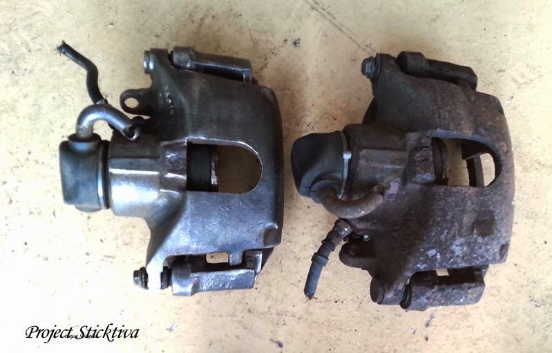

As part of my "stores shelf"...I attacked the large Bendex calipers from the Green Goblin V6 hulk.
New Discs/Pads will be fitted to the Activa (there is a vibration when braking hard) as the nearside disc is not running true so I will be replacing it all round front and back...rebuilt calipers and new 288mm pancakes fitted with Mintex pads, new armoured caliper supply pipes, pads.
YUK....15 years of crap and a wire bush spitting sharp pins at me for a couple of hours!

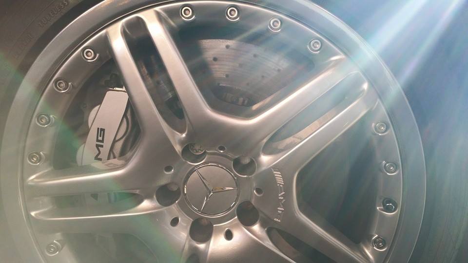

I took a picture of DickieG's Mercedes SLS F1 rims and brakes the other week. They really are the dogs danglies in terms of looks, and I expect performance. I'll post a link to it when I get home. All brakes should look like that.
Sent from my SM-N9005 using Tapatalk

Stickyfinger wrote:Some cars really do "take a good wheel" ....those Mercs always look really good with outrageous wheels and calipers
It's a work of art. I think they are 20" rims. The discs are bigger than my wheels.

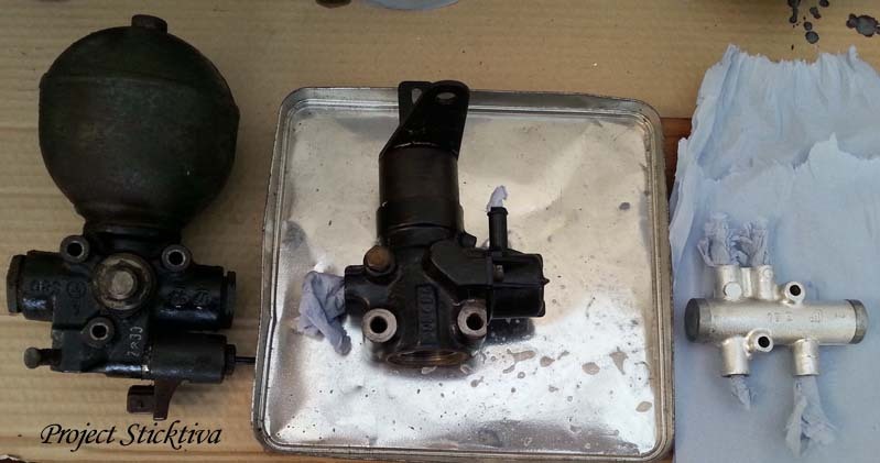

My self mixed cleaning solution seems to work well, this one (right) was dug out of the bowels of the Goblin
Three stage process...no abrasive or wire brushes used.
No 1, Gunks wash and brake cleaner
No 2 Stickys Special Mix
No 3, wash with window cleaner with touch ammonia in it, wash with water and dry....
