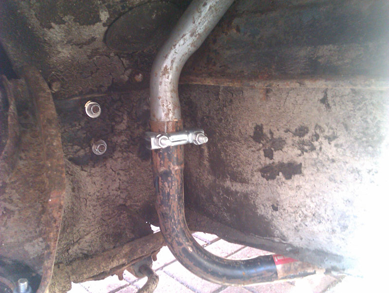

Bit wet out today so the exhaust is going to have to wait, I'm not rolling around on the floor in this weather. I found the left-over trim clips from putting the sill trims on and found that they're the right size for the side trims which means I could've put those back on ages ago. I had exactly the right amount to refit the lower grille trim too, whose trim clips had rotted away.
It's not a big update but it is nice to see all the trim back on. Just the exhaust and mudflaps (which need the fixings freeing off or replacing) to sort and then the only things to go back on are the parts I'm waiting for. Der Franzose got back about the fuel sender I ordered incorrectly and the correct one has now been ordered.

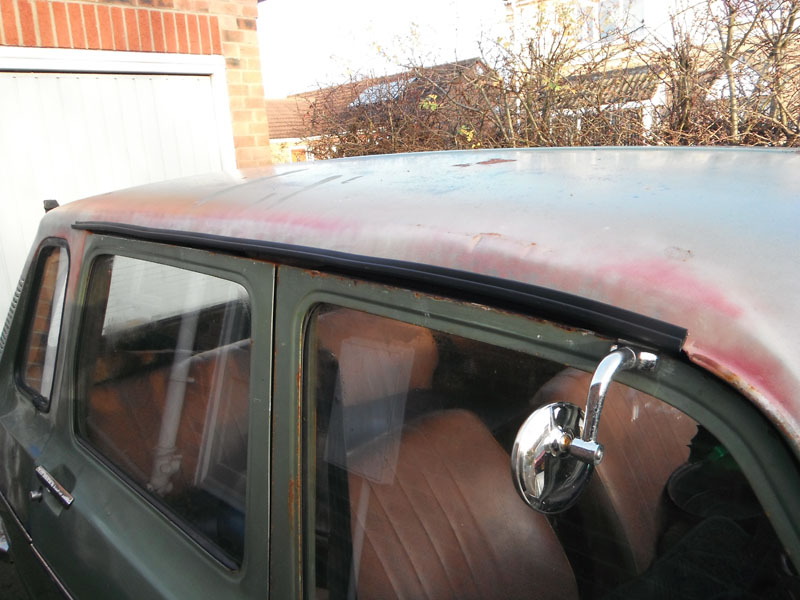

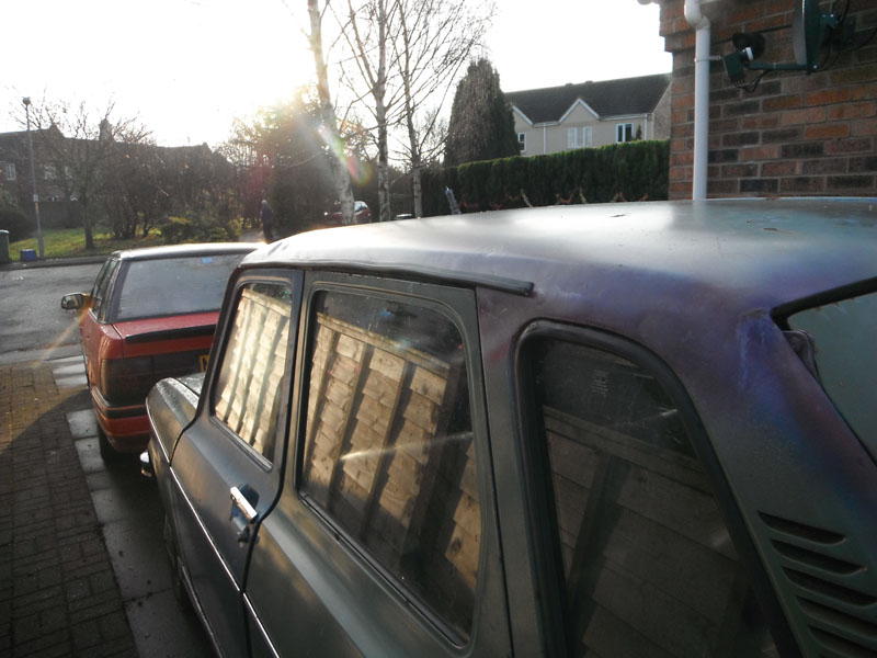

The universal guttering I ordered arrived and today is the first dry day we've had so that I can fit it. This is not a pretty job (what is on this car?) but it's very much a case of function over form right now. They have the stickiest sticky stuff ever on them, I just hope it helps redirect the rainwater away from the door seals so the cabin stays that bit drier. Getting this car watertight is going to be an ongoing battle I think. Whether or not I replace them with more proper metal gutters remains to be seen.

In a previous life between jobs I got a temporary job working for a company that used to make auto rain gutters for all the big car firms. Metsec or something similar?

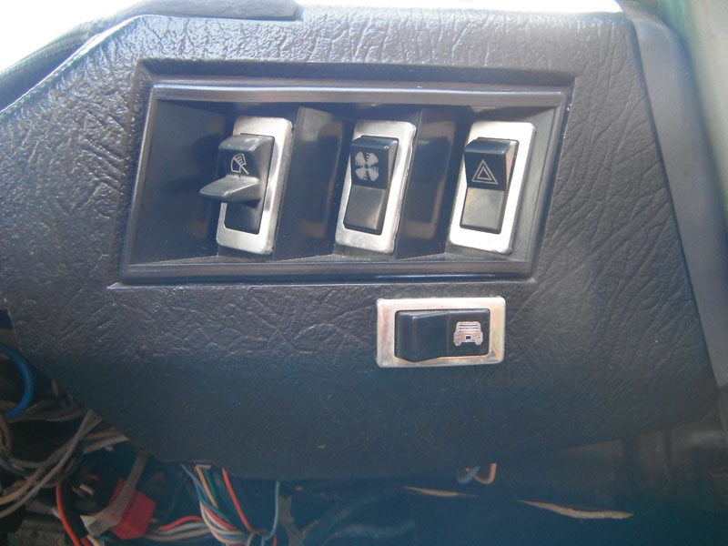

That wiper switch is a bit special.. I wonder why it has the 'toggle' fitted to it?

I think it's to make it easier to flick on and off than if it were like the others. Either that or "because French".

I go for the latter!vulgalour wrote:I think it's to make it easier to flick on and off than if it were like the others. Either that or "because French".

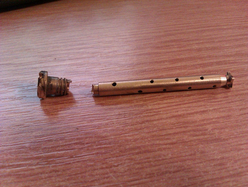

The other problem is the carburetor, a Solex EISA-32. It has the screw-in rather than push-fit emulsion tube which Mike removed when he dismantled and cleaned the carburettor. It had been broken previously and the screw thread in the carburetor body was damaged and needs re-tapping (that bit isn't a problem). However, I cannot find any emulsion tube that matches this one, Solex or otherwise, and neither can Mike. Without it, I expect the carburetor will not work. It looks like this:

I think that with a bit of skill and silver solder that emulsion tube could be reassembled.

Right, another little update on the emulsion tube. Having seen the cleaned carb in person today it's clear that the thread for the tube hasn't stripped, it just wasn't ever there. That means this is the earlier type with a push fit emulsion tube that shouldn't be removed, but has before I got the car. It looks like the old air jet has been removed previously - the head of it is quite mangled - and a newer, potentially incorrect one fitted.
The bit I need is the air jet, a size 170 apparently, and that is supposedly a generic component shared with Weber and Solex so it should be easier to resolve now. It should be, as far as I can tell, a push-fit type rather than a screw fit type and I have been able to find both of these components in various locations. Should be okay.

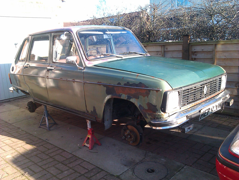

Until the wheels come back the car is on stands as I haven't a spare set of wheels I can bolt on in the meantime. The Renault has got gradually more difficult to push and with the wheels off I've found out why; front brakes are now stuck almost completely on. Going to have to get the calipers off and find out what's going on there, I suspect the pistons have just got stuck and need working a bit to free them off.
