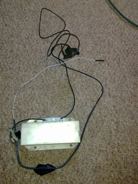

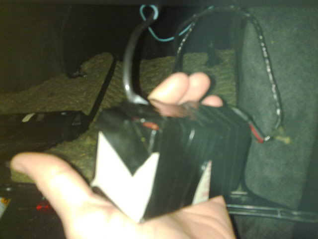

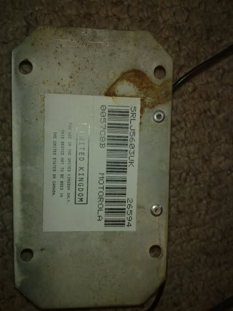

The 12V battery thing i found looks like this...
and was connected to this...
I think it must be some kind of ancient radar jammer as it is just a box and an aerial, it has now been removed.

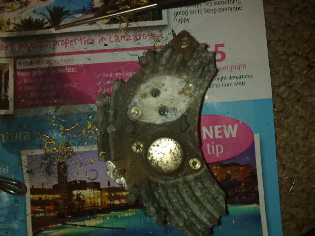

Having replaced my blower motor with an older one i have replaced the transistors in mine for when the older one goes!
As you can see the controller was seriously corroded!

That 12v battery setup with the Motorola box is probably a tracker unit, had something similar fitted to my Xant although mine was a modified mobile phone encased in a vacuum formed box nicking the bootlight bulb 12v supply. All this including the areal was fitted behind the carpet on the side of the boot! There was a telephone number written on the side of this phone so out of curiosity I rang it and the number now belongs to a driving instructor from the north
