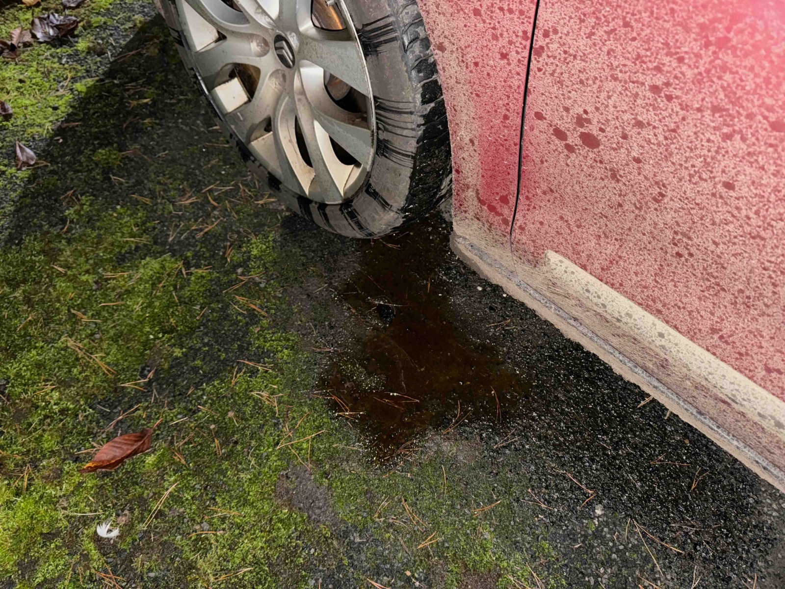

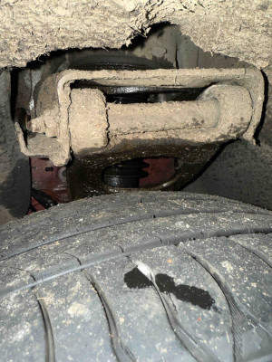

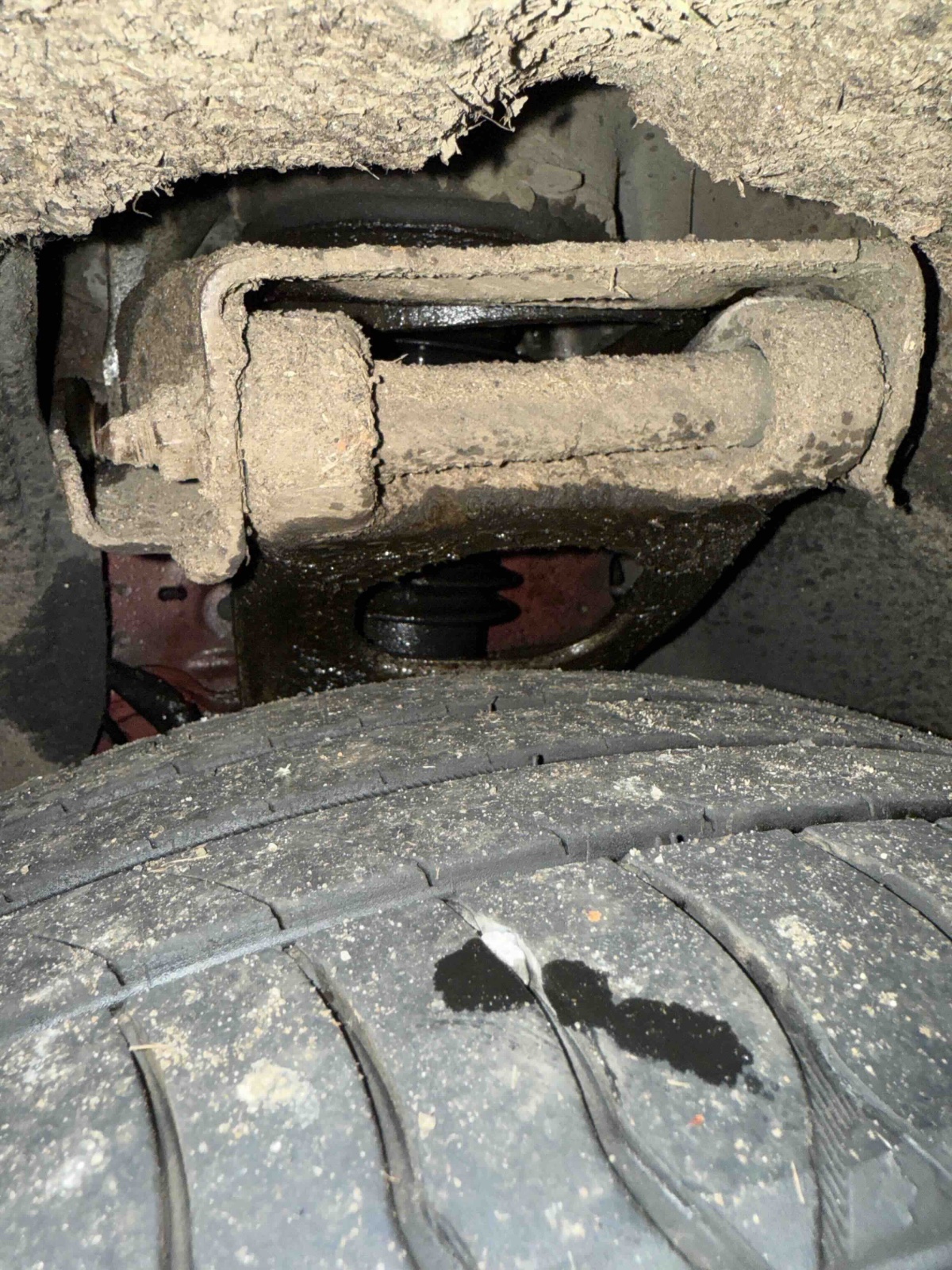

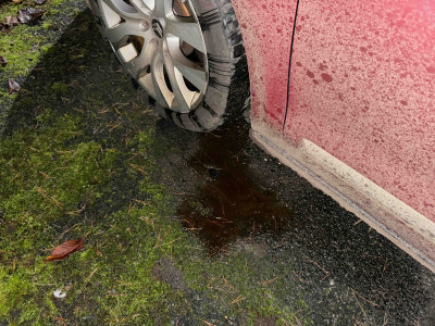

Well, the C5 has been performing well for the 20 or so months I've had it and it's covered 15,000 miles.
When I put a couple of bushes on the front of it a few weeks ago I noticed the drivers side strut was damp so I had planned on changing it before the MOT was due mid December.
I noticed on Monday evening on my way home that the steering was notchy and I could hear the pump cavitating. A quick look told a sinister story...
After being parked for 5 minutes, this was visible behind the front left wheel.
Turns out that the passengers side strut which had been bone dry all along had literally burst.
I called Citroen for a price on Tuesday and they quoted me £853 for a pair of struts after a decent discount on them!
After a bit of looking I found a seller on eBay selling a pair of brand new Genuine Citroen struts for half that price! He's got great feedback and he's sold over 500 sets of them so I've no concerns of ordering from him. However, thanks to Brexit, he won't post to the UK so I started looking at flying into Germany to collect them as I wasn't prepared to spend £853. I could fly from Stansted to Frankfurt and back again for £28. Glasgow to Stansted was 3 times that price but I then couldn't get back from Stansted on the same day which started to become a pain in the backside.
After a bit of thinking, I remembered we had an office in Dublin, after checking, he would post to Dublin for €18. I then checked flights and I realised I can fly to Dublin and back for £33 to collect them once they've been delivered.
So, they're currently with UPS and once they're in Dublin I'll make plans to go and get them. What's crazy is that despite flying to Dublin to collect them, I'll still be just shy of £420 better off. I like fitting genuine parts, however, I don't like being ripped off when buying them!
This C5 will live to see another mile!

Shame about the strut burst David but otherwise an excellent result! Enjoy the trip to Dublin!

A good find on the struts. A bit complicated to get them but worth it.

Well, the struts made it to Dublin without any issues and they then made it to Glasgow too! They're now fitted to the car and the C5 is once again free of any LDS leaks.
If I ever catch the stupid sod that decided to put steel bolts through the aluminium castings I'll kick him in the nuts. I had to drill out the 6 bolts that secure the struts as they had corroded solid.
Anyway, job done and the car is now 1 bulb away from being MOT ready
David.
