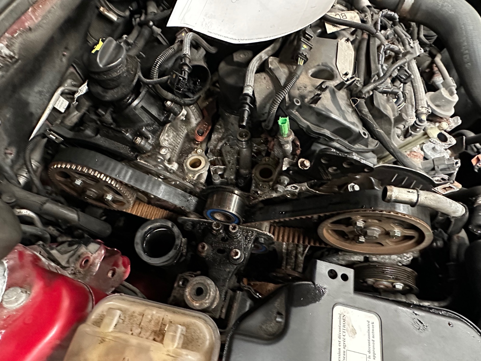

Yesterday evening I then started work on the red 3.0 HDI Exclusive C5 I've kept. I stripped it down to do the timing belt. It all came apart very nicely and I'm hoping to get it mostly back together this evening. I've got the timing belt kit, the water pump is arriving today, and I'm just waiting for a thermostat housing to arrive. That's due on Saturday morning at present though unfortunately
The timing belt on these isn't difficult but there's a fair amount of stripping down to do to get to the belt.
The sump on this one is leaking and unfortunately it's not the gasket so I'm waiting on a sump arriving too.
