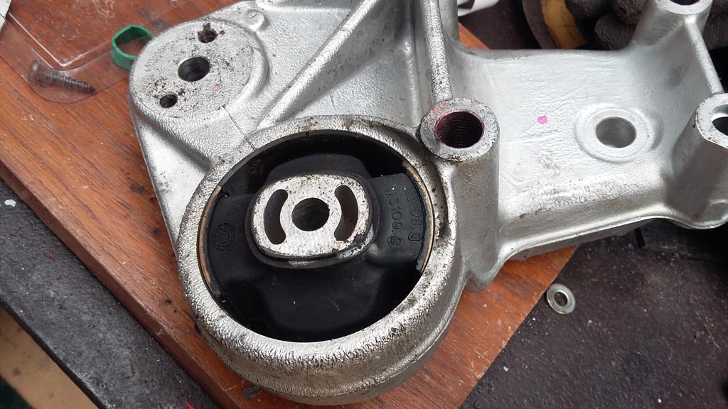

I did see a lower engine mount that I am not "happy" with however, the MoT tester laughed at me and said "that is fine np".
I would like to change it however
What is the job like on a V.6 ?

It seems that the Green Goblin had a new lower engine mount just before I scrapped her....result

One thing worth knowing if this is the same one as used in a 1.9TD and other XU engine Xantias, especially the TCT Activa...

Nice to have an OEM one in a new bracket, save faffing about pressing in cheap ones

I am pretty sure that the lower mount is the same as the other PSA engines.
I think that it will be a LOT easier to change if you take it out of the bracket and just change the bush.

xantia_v6 wrote:I am pretty sure that the lower mount is the same as the other PSA engines.
That's good to know Mike
I quite agree, already expressed this view to Alasdair outside the forum!xantia_v6 wrote:I think that it will be a LOT easier to change if you take it out of the bracket and just change the bush.
I'd certainly not faff about trying to do it in-situ - I know how tight these are in the housing... Removing the driveshaft is a price to pay to do the job easily, safely and being able to use a bench press...
Generally, so often and in many cases, a little more dismantling and doing the job on the bench can be so much easier - and quicker! - than struggling in-situ...

Is Mike not saying it is easier to do ON the car Jim ?
