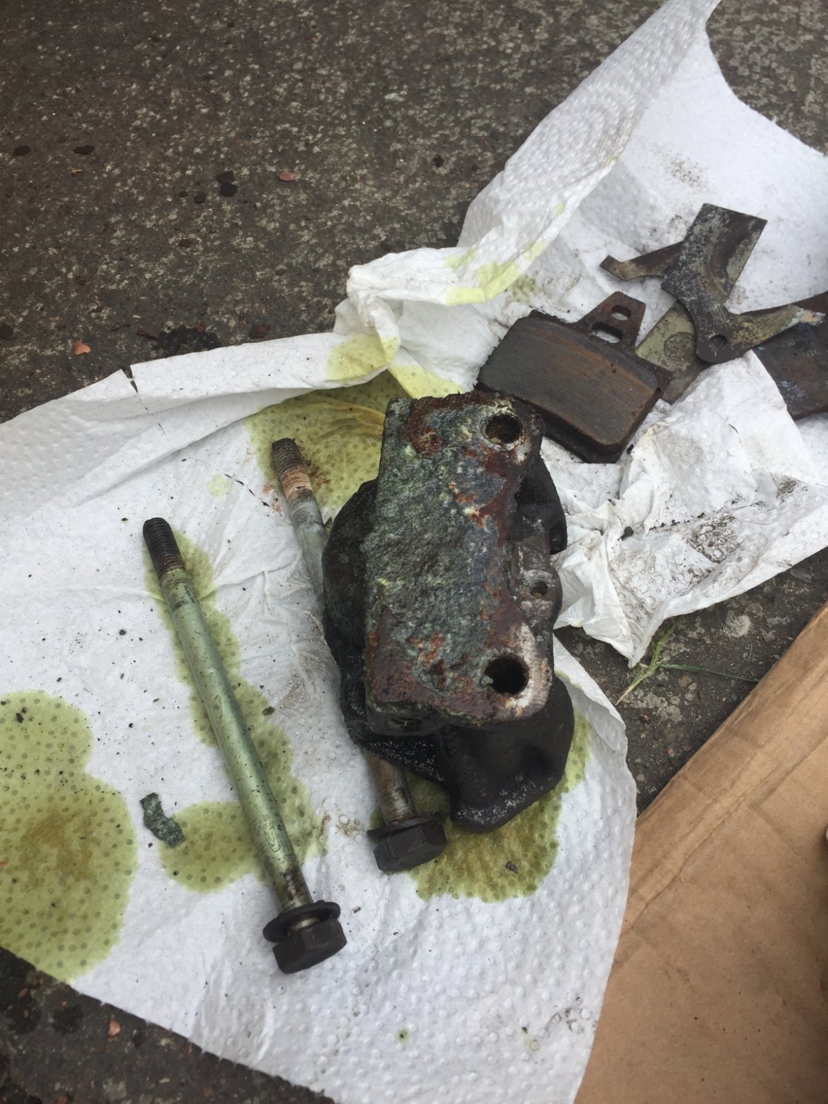

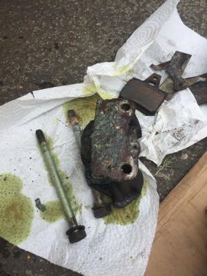

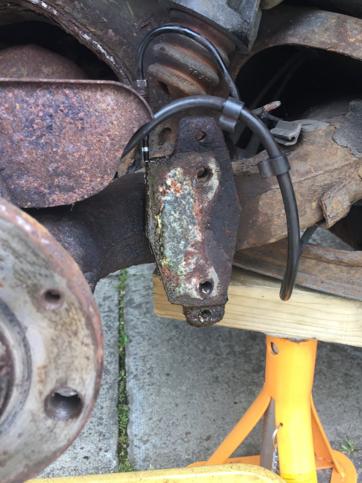

The left caliper was in fairly good order but I hit a snag with the right one:
Interestingly the calipers were not out of alignment as is common on old Xantia's - they were still nice and parallel. And contrary to just building up corrosion that pushes them apart what had happened here is that a big chunk of the alloy from the caliper has ripped off the caliper and remained on the steel backing plate on the arm.
I realised if I scrapped all the alloy off the steel backing plate there was no chance the caliper would fit back on square, so I thought I'd try and put it back as-is - but no go - it wouldn't sit flush and with the thickness of the new disc the calipers were touching the disc. Damn.
The alloy of the caliper was so badly eaten away I thought my only option was to swap the calipers between the left and right side of the car to put the good uncorroded faces up against the backing plates. This is something that people on here say they have done before, but I also remembered that when Richard and I tried to do this on the Silver problem child we discovered that the hole used for the bleed screw has a taper seat in it while the one for the pipe does not! Hmm...
I was desperate though without a lot of other options so I cleaned and prepared the calipers and tried the bleed screw in its new hole and that's when I made a discovery - it does work! In fact all you have to do is fit the bleed screw in the new hole that previously had a pipe and nip it up moderately tightly with a small spanner and it makes it's own taper seat in the hole! In fact after doing this the tapered seat is visually identical to the original one.
So my conclusion is that the left and right parts are the same from the factory and that tightening up the steel bleed screw the first time is what creates the tapered seat in the alloy housing, not some extra machining step. So I scraped the backing plates clean, greased them with copper slip and fitted the calipers swapped over with the good sides to the backing plate.
To jump to the end of the story the bleed screws work perfectly and don't leak, and the pipes despite now having a slight taper in their holes that they didn't have before also work properly and seal perfectly. Not surprising when some union holes elsewhere in the car do have tapers already. So if you ever find yourself with a mess of corrosion to deal with you CAN swap the calipers from the left and right side of the car! As soon as you use the bleed screw it will make it's own taper.

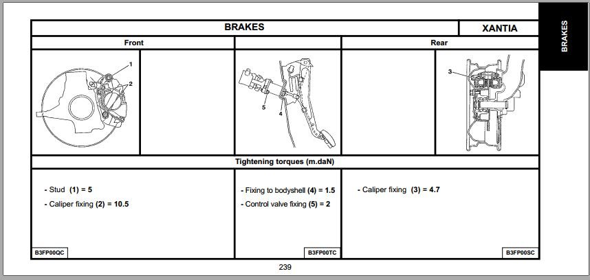

I didn't know what torque to use on the caliper bolts - I ended up doing it by feel and according to my torque wrench I used about 80 Nm. Does anyone have any idea what the correct torque is ? I can always re-torque them if it's too high or low.

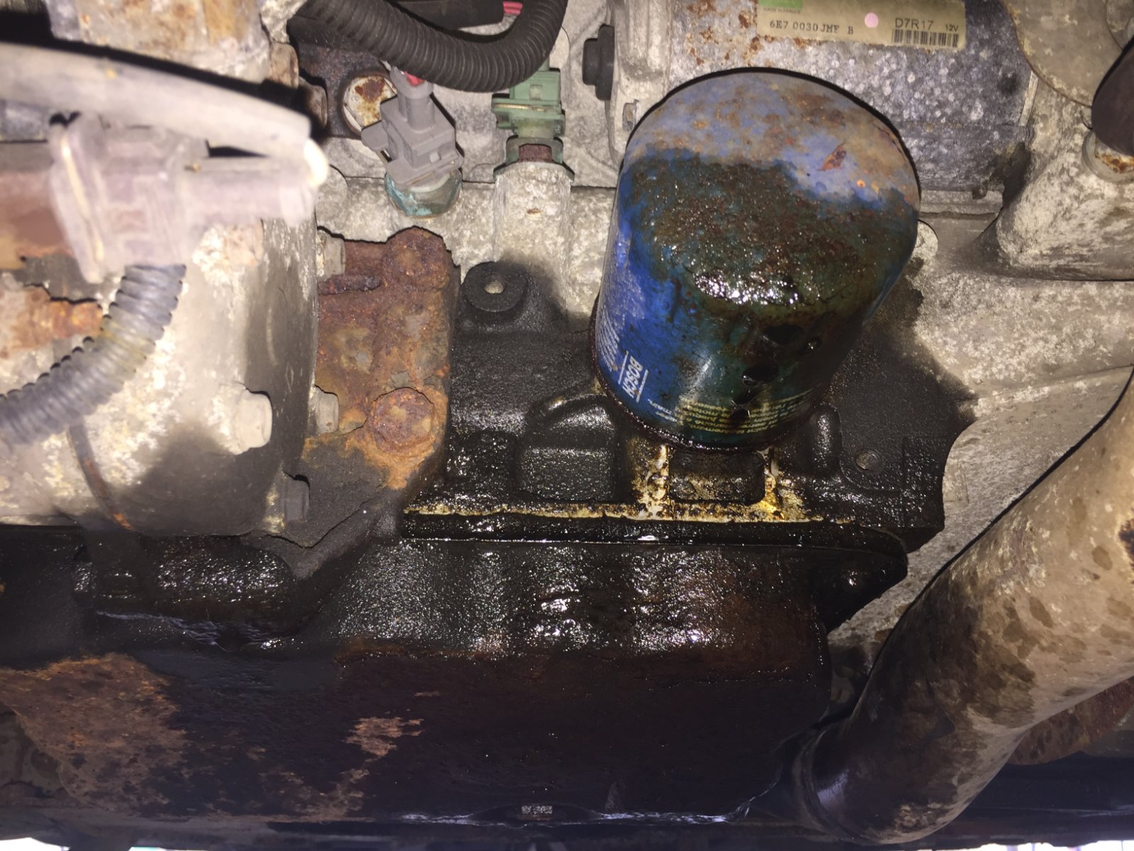

So everything went back together and off for a test drive to bed the brakes in. It took quite a while even though I'd thrown some heavy load in the back to bias the braking more towards the rear but it did eventually start biting nicely. At about that time I started to notice a smell of burning oil! Oh crap. So I crept back home and discovered this:
The whole sump tray of the engine was completely covered in oil and it had splashed onto the exhaust as well, hence the smell. It actually looked like the oil was leaking from the front of the oil filter.... no that can't be. Granted there were some bubbles in the paint but surely it wasn't that ? So I cleaned it up and scratched some of the bubbling paint loose and started the car to have a look underneath. Nothing at idle but rev the motor up a bit:
Blimmin heck!! It was leaking through the front of the filter, and a lot. I have NEVER seen this in coming up on 28 years of driving and working on old cars...
The worrying thing is that we were planning to drive to the beach in Ayr tomorrow, if I had not done the brakes today and then gone for a test drive and smelt oil we would have driven it all that way with an oil leak and quite possibly done in the engine because I don't know if the Xantia has a low oil light on the dashboard...
The irony is that I was going to order oil/filter and coolant at the same time as the discs and pads but as I was juggling money with other needs and time was short I decided that I'd just do what was needed for the MOT and wait until after I got the MOT and didn't need to spend any more for the MOT and then do the maintenance items like oil/filter change. But now it will be off the road for a week while I order the parts and then find time next weekend to do the job. That's some degreasing job too, the underneath or the motor is completely soaked and it has got onto the exhaust pipe and lower engine mount as well...
Haynes says rear caliper securing bolts 47Nm or 35 Ibf ft no mention of thread lock

That oil filter is a weird one alright I can't remember ever seeing that and is almost unbelievable
The last time I stabbed one with a screwdriver to remove it they take quite a bit of battering before they leak. It's almost worth keeping a good old one for emergencies like that

Filter rusting out just could have been a bead of water in the oil (from lack of regular use) which caused local rusting. Water in oil will occupy a low point. Bit unlikely, but just remotely possible. Never seen anything like that before.
Caliper torques...
from the 2001 Mechanics' Handbook
Worth printing out that little booklet; full of really useful data.

Re: Simon's new Xantia V6 and Peugeot Ion blog
Much more likely to have rusted from the outside, a tiny stone chip in the paint would be enough to let the rot set in.
We've had a couple do that. One on a Fiat Panda (filter is right at the front edge of the engine bay) and one on my first Metro - though that looked like it had been there for 25 years!
So it's not hugely common but it does happen.

The filter has been on the car for 3 years (a bit longer than ideal I know) and over that time the car has probably only done about 10k miles. I like Gibbo's theory that road debris or stones chipped the paint enough to let water in and allowed rust to start that way. When I scrape the bubbling paint back half the front of the filter is not just surface rust it's completely exploded rust...
Looks like very low grade steel to me combined with a pretty poor paint job. Made to a price.

3 years, low miles, low mount, .....OK I can see that happening.

Diesels get a protective undertray, many petrols don't.
You would have thought that a Bosch item would have been reasonable quality, but how to tell?
At least you spotted it before it blew out. Maybe a blessing that the car wasn't taking you to the beach.

Stickyfinger wrote: 24 Jun 2019, 08:32 3 years, low miles, low mount, .....OK I can see that happening.
Yeah, this car has definitely rusted a lot more (mostly surface rust) since it's mileage was drastically reduced. Even the alloy intake manifolds have a lot of aluminium corrosion on them now that they never used to. Cars don't like being left to sit around!
