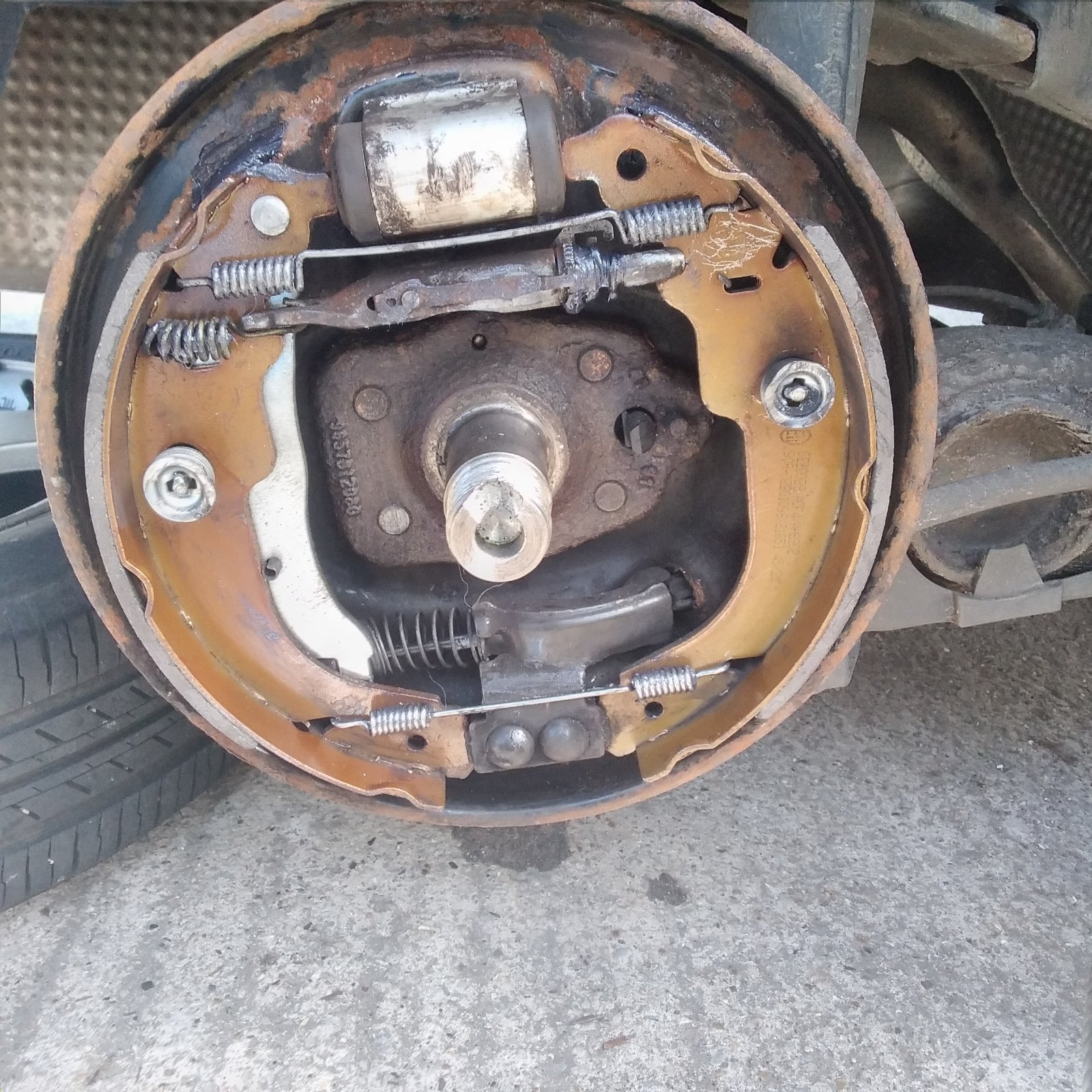

Update, service done oil & filters, had a nice bit of sunshine and it was warm , so I thought have a go at the near side rear brake drum, new puller works a treat, took on advice from Paul on here , I slacken off the handbrake, jacked up the car after loosening the wheel bolts , up with car off with wheel, out with new hub puller ,my word a well balanced and made cheep piece of kit . Here's the best bit , the shoes were over adjusted so it was a horrible job but I got the lot off I had to pulled the pins through the holding clips to get any movement but I muscled through and off it came
How on earth did the wheel ever turn , I slacken the adjuster right off and found new fixing pins and springs and that silly locking washer and got it all back on , the brake shoes are worn but not enough to cause any concern . Everything looked clean , the drum has a lip less than 1mm. I adjusted the shoes up just to cause little drum dragged , the wheel bearing is the problem and judging by this blue color on the bearing , heat damage, the new drums I purchased are to small so they have been accepted for return , I purchased a new wheel bearing 29.99 but got it half price with a discount code, comes with retaining clip , hub nut and dust cap , when I put the drum back on I twisted it like turning a steering wheel and hello ! The same noise could be heard what im hearing in the car, when I did it slower you can feel the bearing is the problem, so .... all I need to do is a wheel bearing ...for now, sorry for spelling , ive had a hard few days wifes in hospital and im running here there and everywhere on me todd... im just relived I found the cause , once the new bearing gets here then that can be done , im looking forwards to using my big bearing press , just like what Jim's got

PaulC5
- Posts: 2672
- Joined: 06 Jun 2023, 15:26
- x 697
Re: Peugeot 207 1.6hdi (New edition to the fleet)
The lip on the drum I file down each time so between servicing it never gets large enough to make getting the drum off difficult. Also helps when setting the auto adjusters since the drum has to be put on and removed quite a few times.
The type of auto adjuster in your photo is identical to the ones on our C3 and Cactus things I found from doing the job might help.
The adjusters work when the ends are pressed together so with the drums on the handbrake has to be off and the pedal pushed down and released up many times so the cylinder moves the shoes out and back in to press the adjuster. It also needs the handbrake lever on the shoe to have its stop peg against the shoe but at most less than 1mm which means if the handbrake adjuster nut is set to give more of a clearance than 1 mm the adjuster will not auto work. If more than 1 mm I also found the drum difficult to remove. I have found it best to set the adjuster with the drum off by turning its cogged wheel so the shoes just slightly rub when the drum is put on and then the final adjustment done by lots of pedal pushing.
The handbrake with the auto adjuster set should start to rub the shoes on the first click. Before adjusting the handbrake adjuster nut press the pedal 3x, pull the handbrake on 5x, remove the drum to check its lever stop peg is against the shoe (or less than 1 mm) and if not adjust the handbrake nut.
The C3 had 9 inch drums and the hub nut a washer on it, this nut had to be tightened to 300 Nm before it was peened over. The Cactus has 8 inch drums and the hub nut has no washer and tightened to 245 Nm before being peened over. Due to peening the nuts have to be replaced each time.

Once the new wheel bearing arrives I will swap that old one out for the new once I made the discovery early today I though well this should be ok just doing a wheel bearing , the new drums can go back , I did say to the supplier they won't fit but they insisted they did , no wonder they didn't argue about the return . Least I know what's on the car and with out full history of it it looks like these were done id say just about 3 yr ago so im ok for a few more miles yet . Im going to check another set with the measurements I took of the ones on the car , so the correct one will be sent also thinking handbrake cables are cheap enough so it might be worth getting a pair of them , the brake cylinder was in very good condition too so no worrys about them either .
