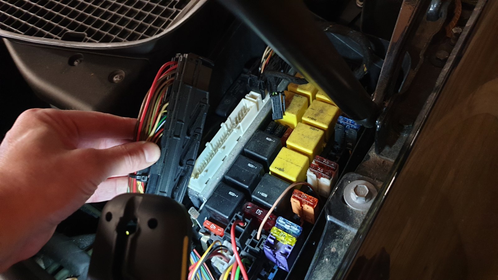

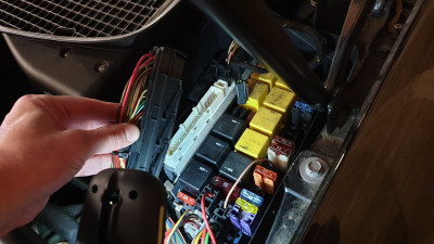

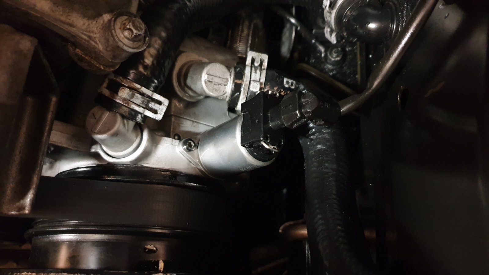

That Mercedes CL500 is infuriating me with it's refusal to lift up off it's struts, so I decided to swap out that ABC valve I spoke about previously.
It made absolutely no difference.... :roll:

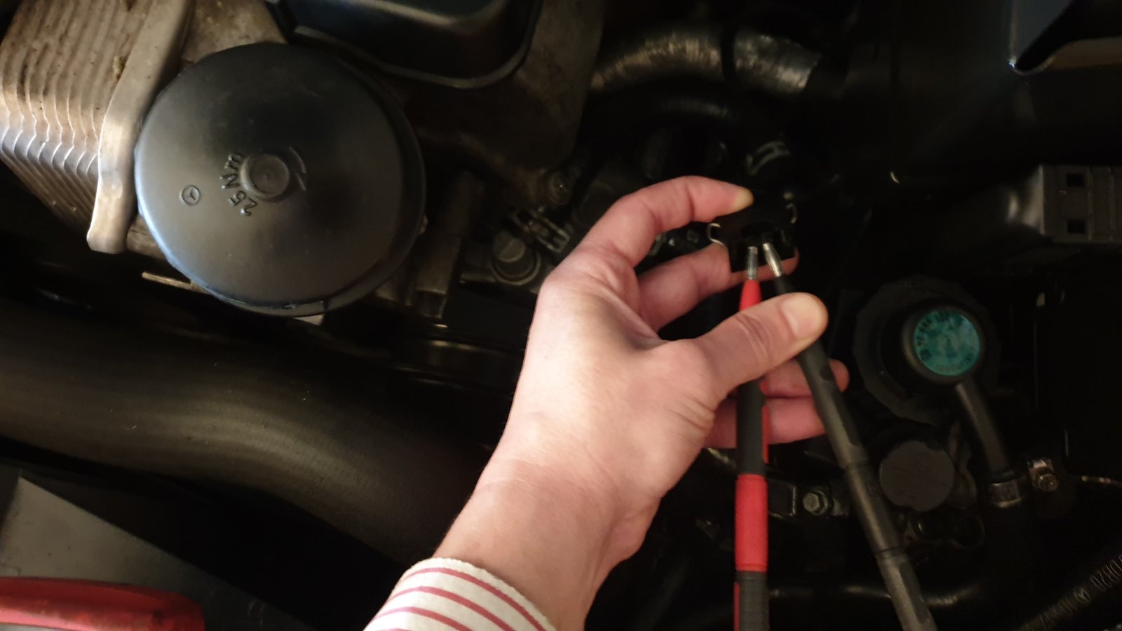

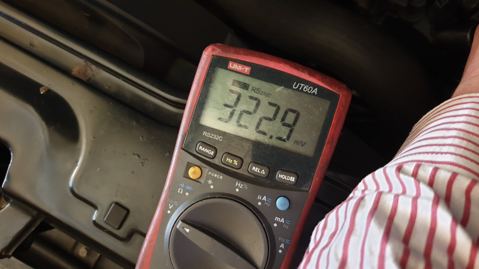

So I decided to measure the voltage, as reading online it should have 5Vdc on it to open it up, and allow the pump to pressurise the system. This is what I got...
Sweet nothing... so why is the car keeping this important valve closed?? :evil:
I studied the diagrams, and found the ABC suspension controller, but because of the design you can't exactly take a measurement here, and I don't even know which pin to measure... Mercedes cars are so difficult to fault find.
I think it's reached the time where I need to just buy the Mercedes Diagnostic tool. This will be either an Ebay special version of STAR, or the YOUCANIC tool.... we'll see.

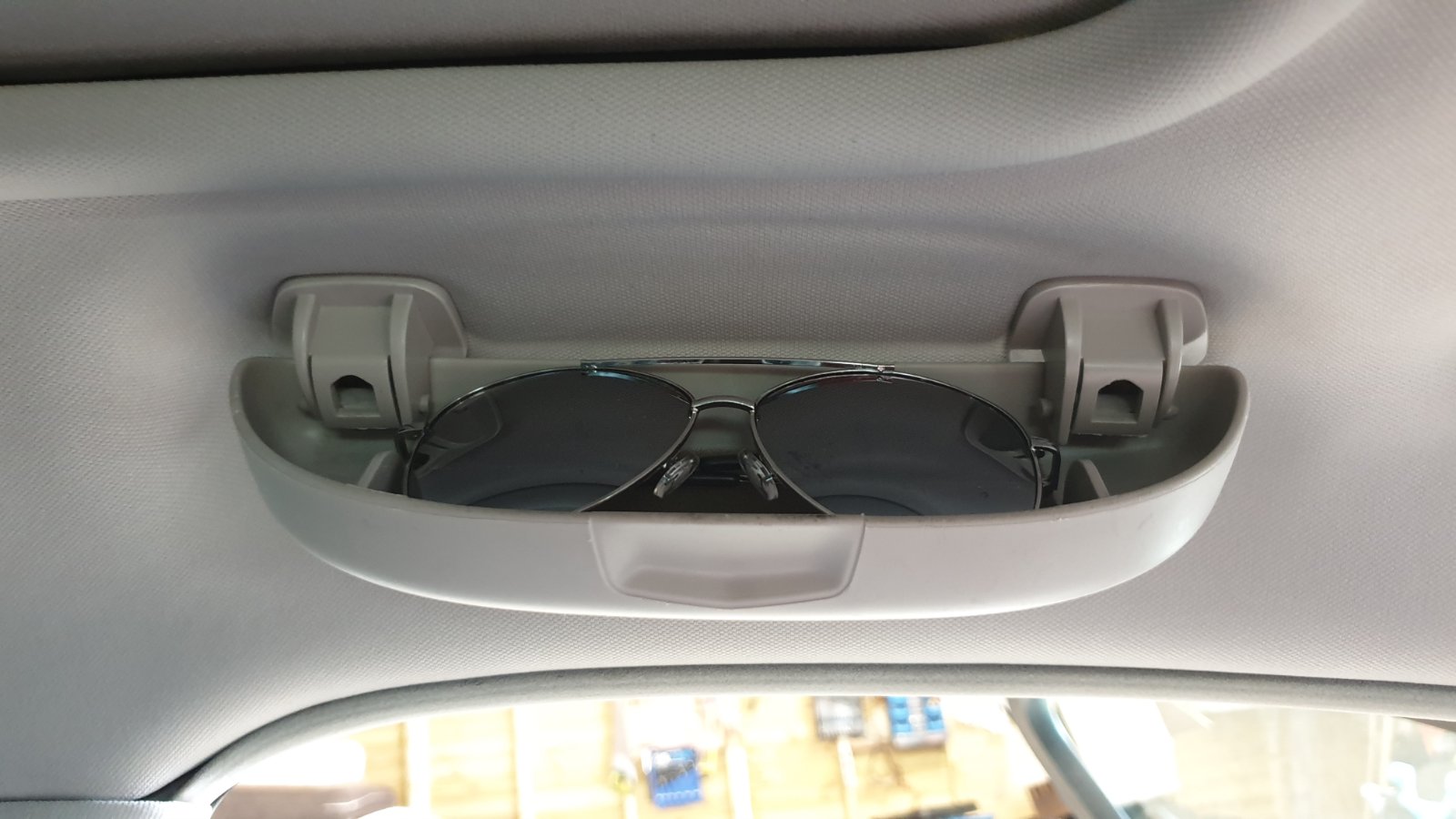

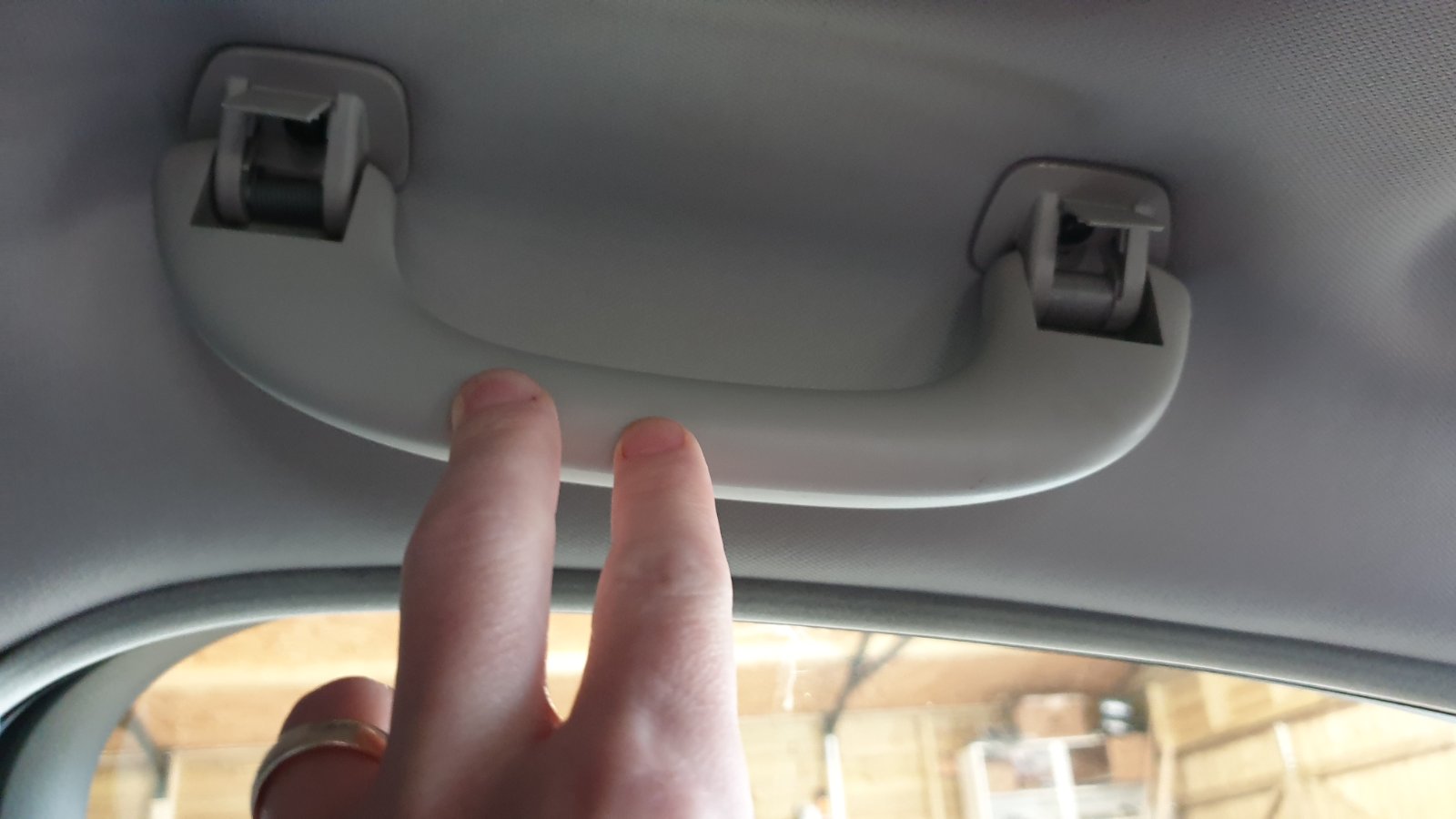

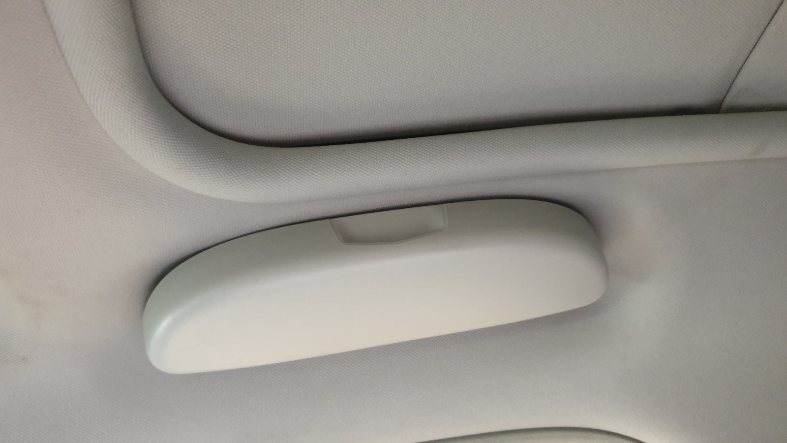

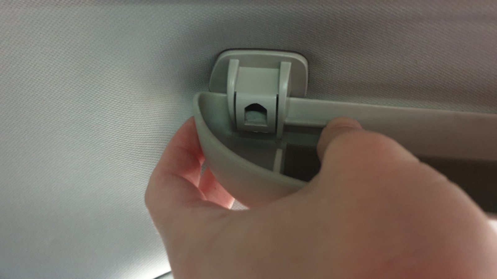

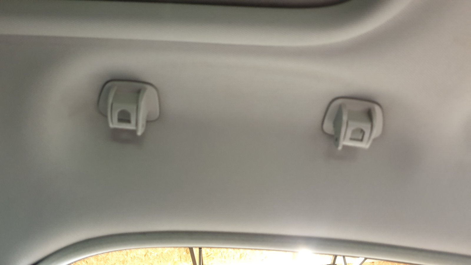

So wanting a quick win, I changed over the grab handles in the Citroen C5 for the new sunglasses holders!
Very easy, and to my surprise you can use the same screws as the grab handle. I was expecting to need to source longer screws, as I read that the sunglasses holders come with them when new (my second hand versions were missing the screws). But you get a good number of turns in before it goes tight, and the brackets go nice and firm.
Then feed in the hinge pins...
Done in less than 10 minutes!
...so now I have them both passenger side...
....and drivers side!
Not bad for £30ish for the pair off Ebay.

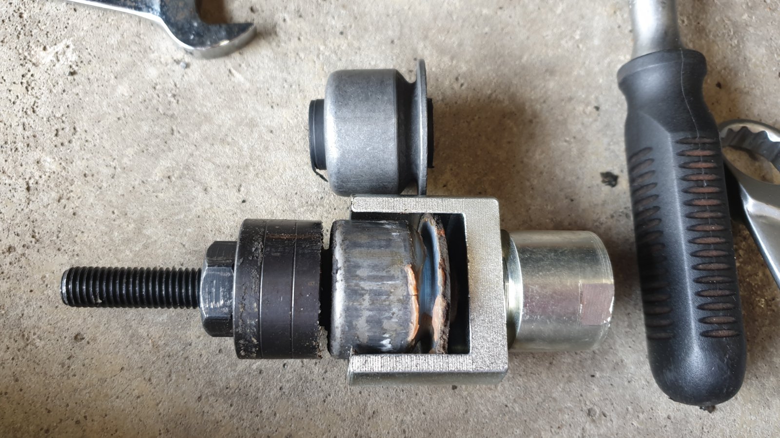

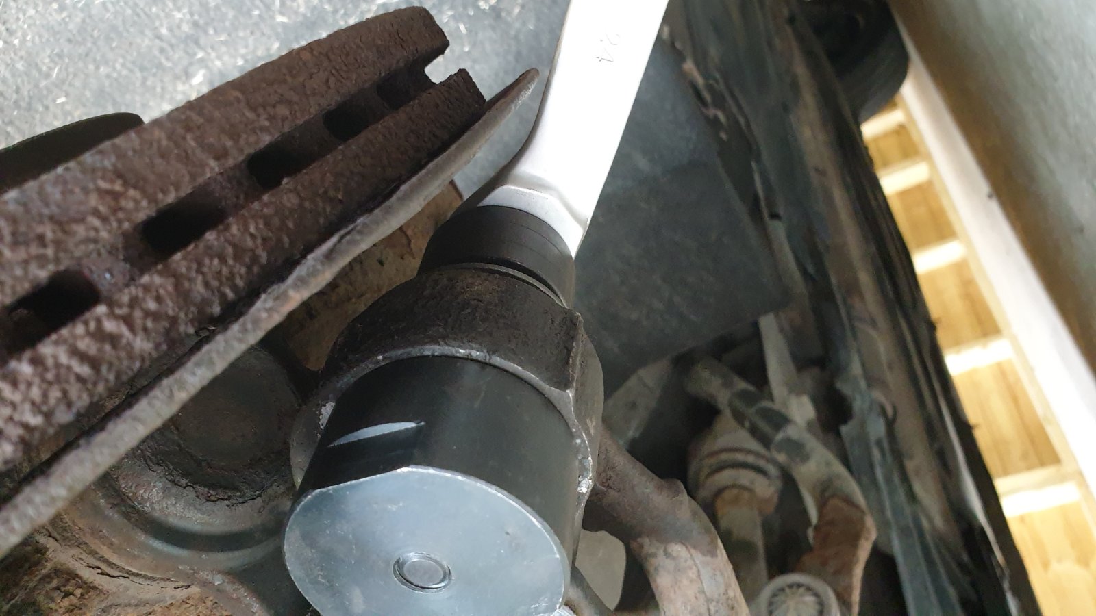

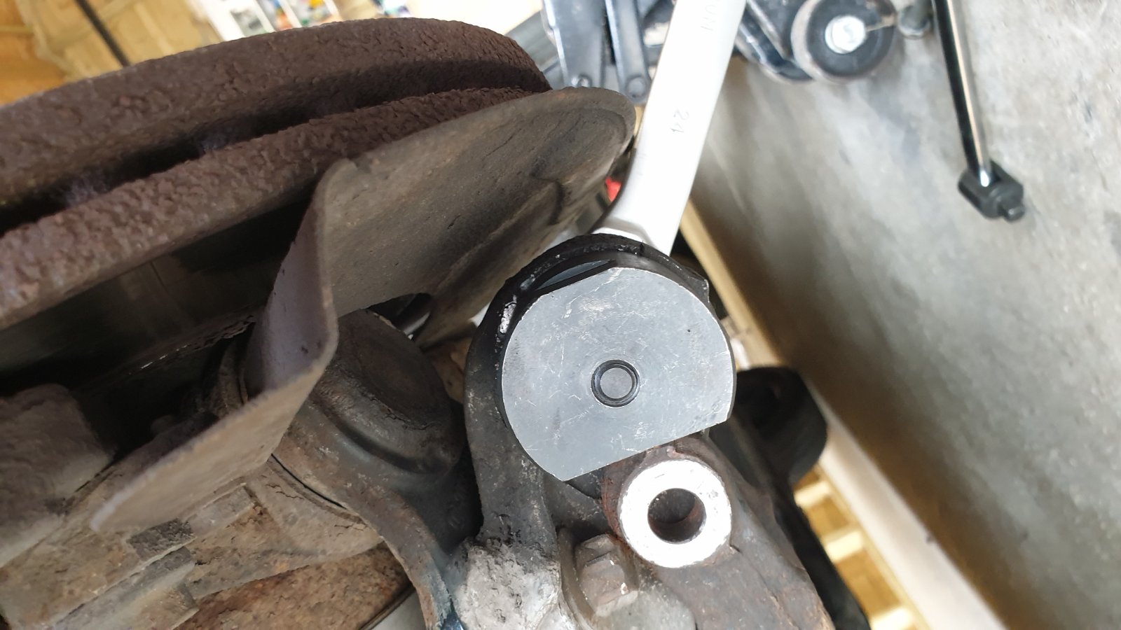

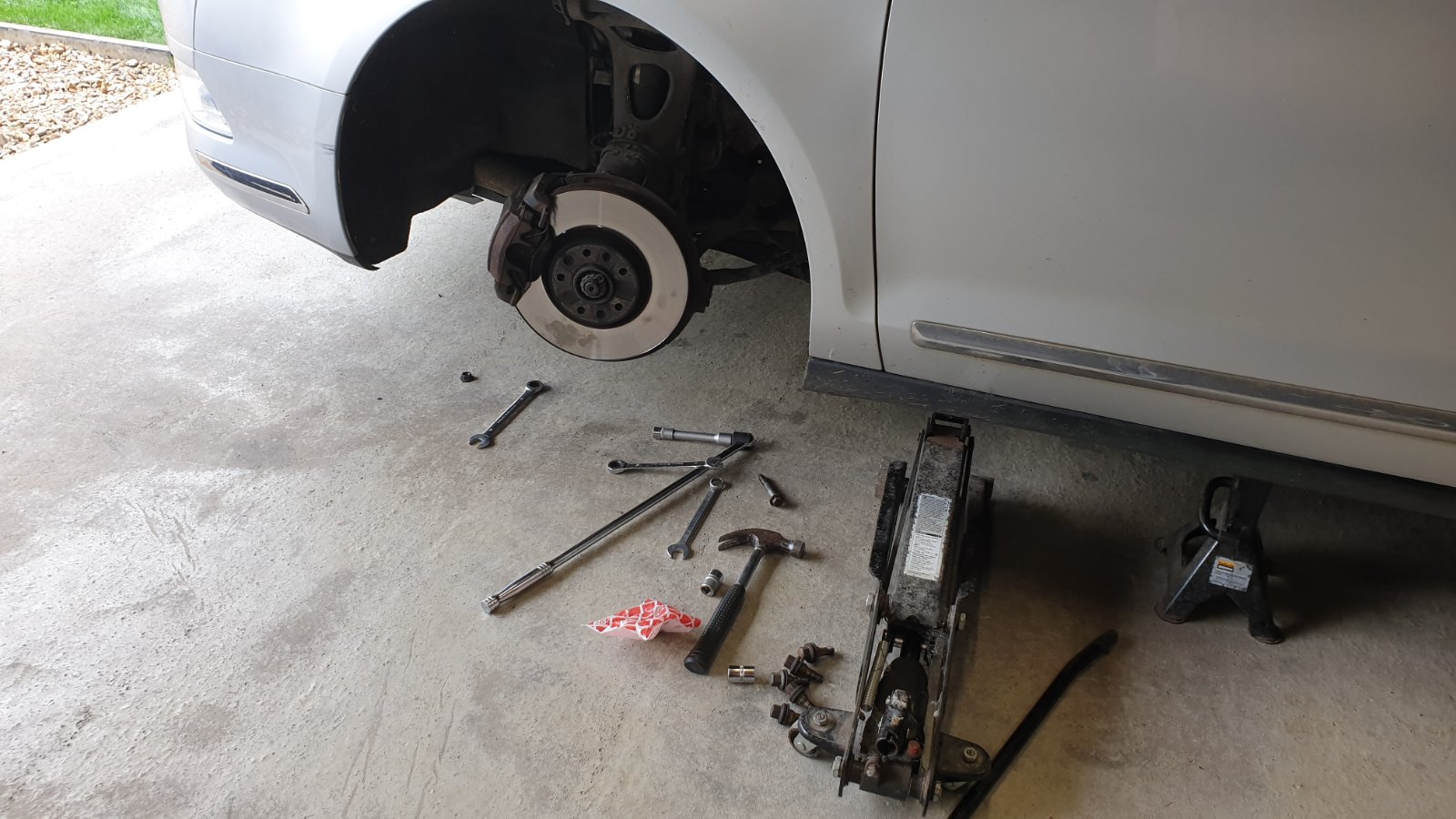

Feeling cocky from the glasses case win, I decided to have a go at the lower "knuckle" suspension bushes. This is the kit that arrived earlier in the week I needed:
Lindsey and Aston got home, so I had more pesky spectators, and wannabe helpers...

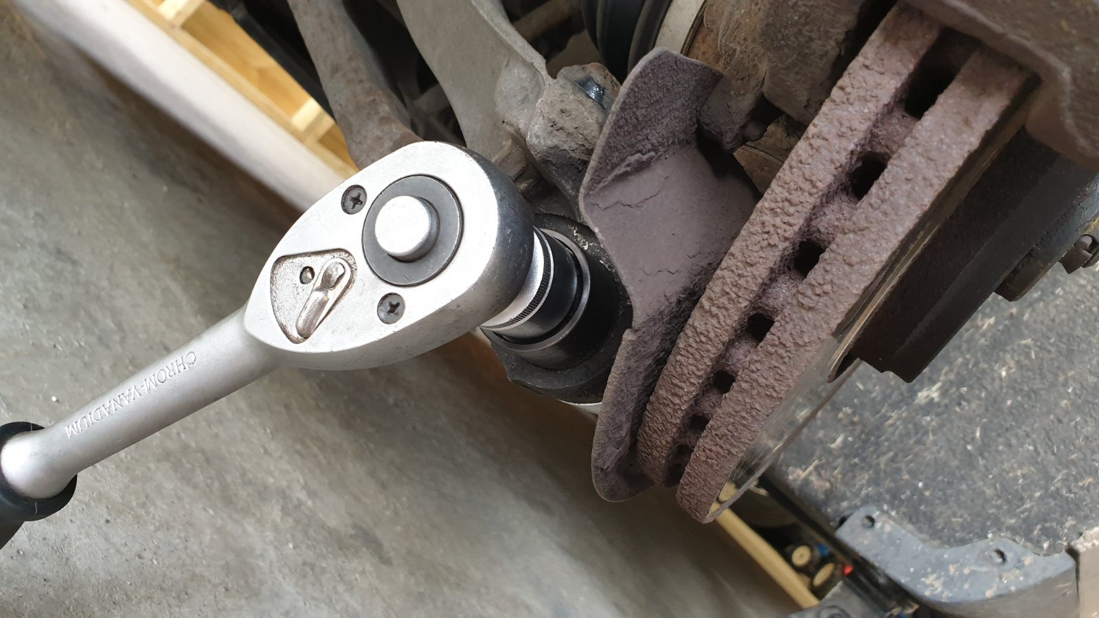

It's dead easy to do this, you release the old bush using a spanner and socket, then two spanners when the socket is not deep enough. The you use the Sealy kit to push out the old bush.
It just pops loose when the bush is out, it shocked me how easy it was.

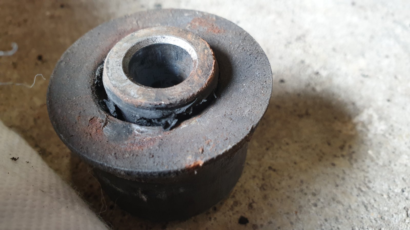

The old bush looked a little tired, but not as bad as I was expecting. I checked my notes, and the bill from the Citroen specialist definitely said "passenger side knuckle bush" so I had the right one.
Then you use the same kit to push in the new bush.
It all went back together and I have to say I was feeling rather good about myself 8-)

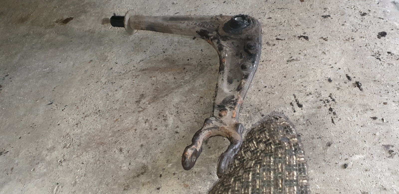

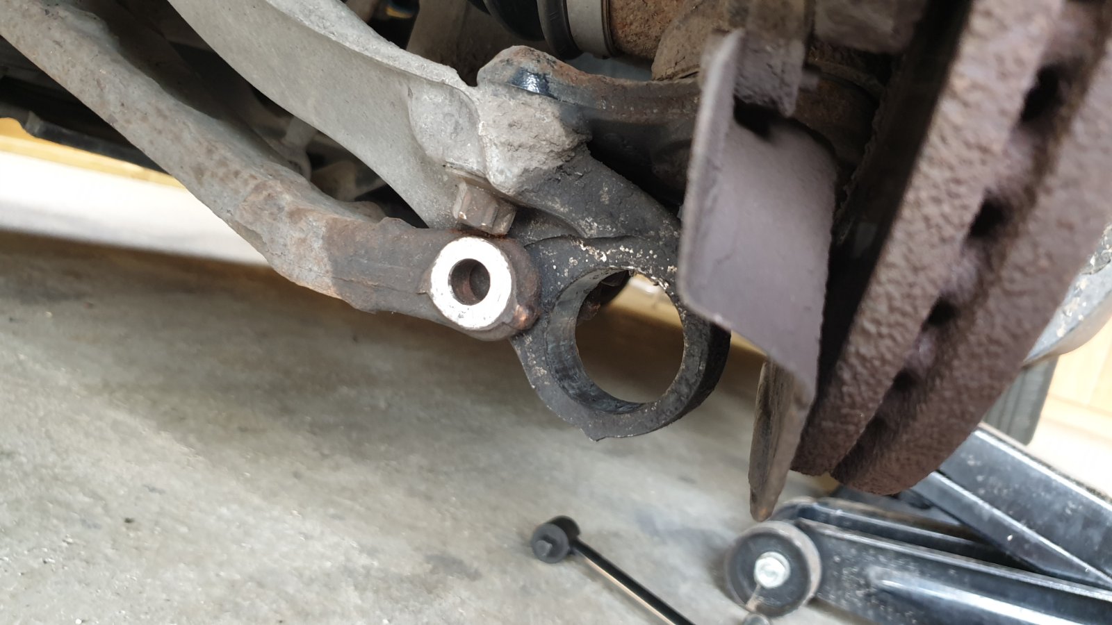

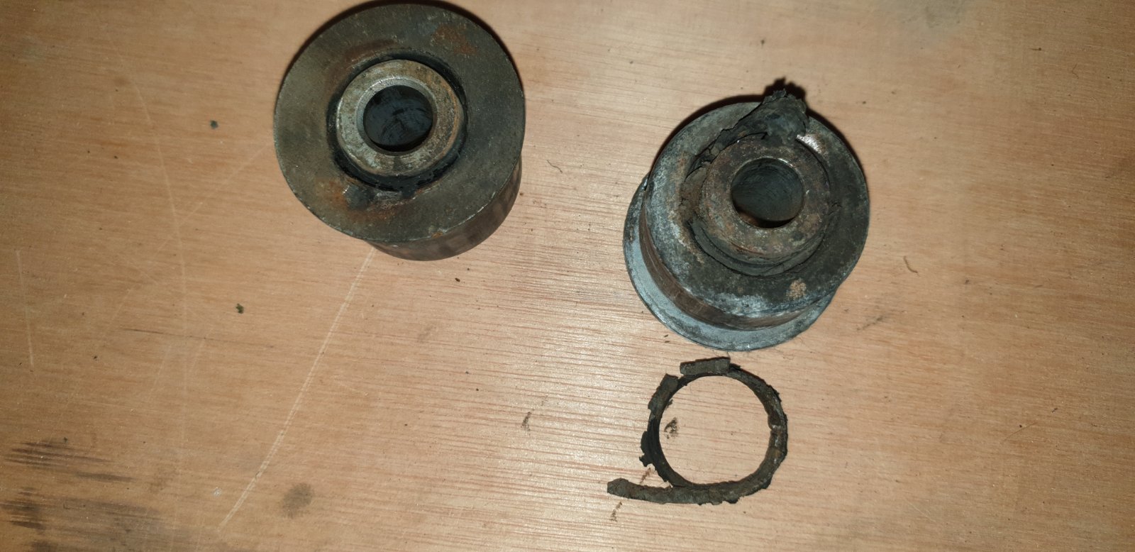

So anyway... then I thought... why not do the driver side too? - it was not stated as needing it, but I may as well do it given it only took 30 minutes. :lol:
Things did not go so well this time. #-o
Getting the bush out went pretty well, and I was surprised to see the drivers side bush was in a much worst state than the passenger one - it's core was freely wiggling about and the rubber was perished and loose it's the right hand side one below).
I think the garage got mixed up when they typed the notes on my Bill... :roll:
But then things took a turn for the worse, as you can read about in my plea for help here:
viewtopic.php?&t=76294&p=772270#p772270
During the process I also realised that the bushes on the lower arm were not the best, so a new arm has been ordered too.
