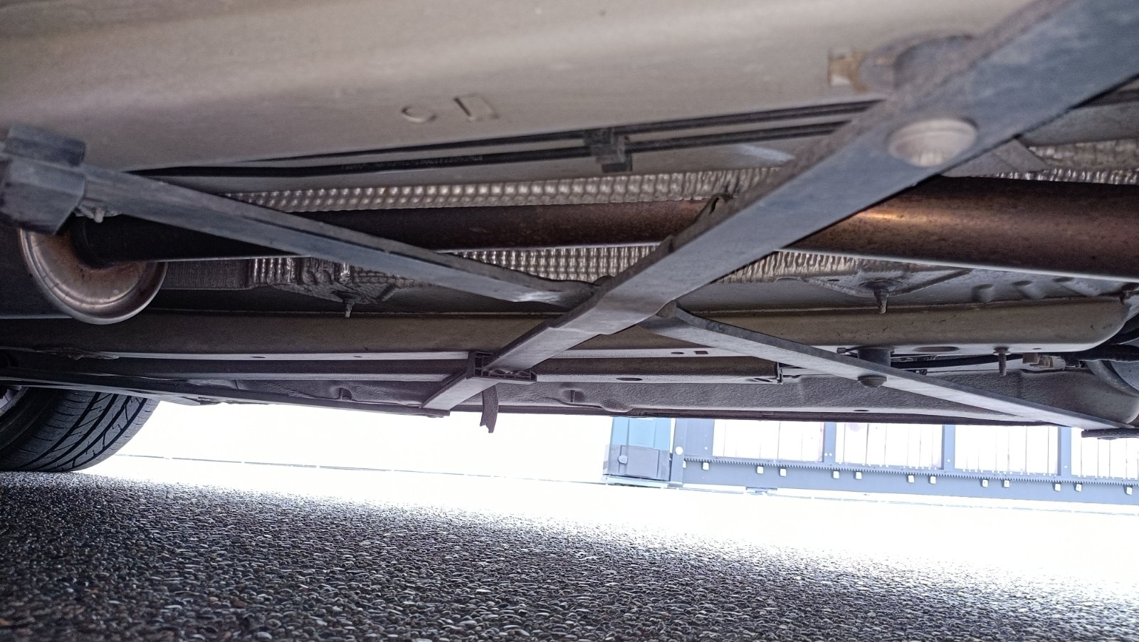

Another one for bump stop. When I was messing around with our old Xsara estate car I recollect there being two types: a larger spongy orange one and a smaller, harder black one. These were fitted across a wide range of PSA cars and, IIRC, I got one off Xsara Picasso.

Yes, it looks like it may be the rubber bush inside #3
. Or maybe part of the bump stop.

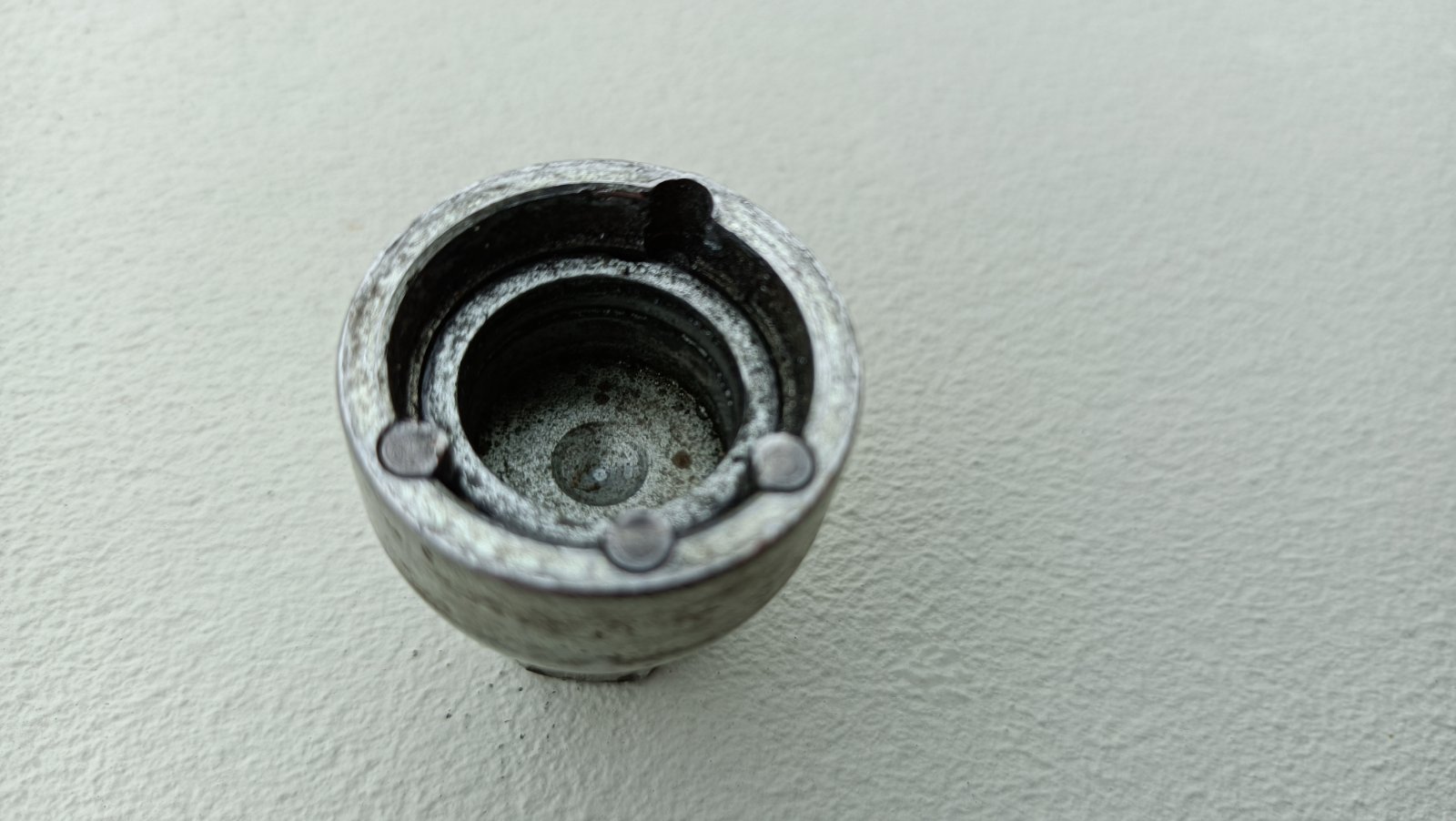

I went to remove a rear wheel and the locking bolt key kept slipping off the bolt. Inspection shows that one of the hardened pins in the key has been broken off. I had 2 new front tyres fitted last week and the fitter Didi not mention anything... But it could equally be the (different company) fitter who replaced 2 rear tyres last year.

I then looked for anything else loose under the car, and noticed that if I slapped one of the under-floor diagonal braces with my hand, I could produce a metallic rattle that sounded a bit familiar.
Where the 2 main (of 6) bracing bars cross under the centre of the car, they are not fastened together, but are separated by a piece of soft rubber, and that rubber seems to have compressed, allowing the bars to rattle together when going over sharp bumps.
A new thicker rubber pad was fitted and the clunk going over bumps is almost gone. There is still a (more subtle) metallic noise, more of a squeak than a clunk when the left rear wheel hits a sharp ridge, but that must be something else.
I managed to pick up some non- locking wheel bolts from a breaker. I got one of the locking bolts out using the broken key, but the next one is rounded and I am in the process of drilling it out.

The cluck when going over bumps turned out to be the fuel vapour cannister which is (permanently) attached to the side of the fuel tank, but hanging off it with no other support. The joint with the fuel tank was flexing causing the vapour cannister to bounce and hit the floor of the car when going over a bump. A piece of foam rubber fixed the clunk.
