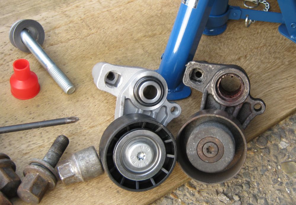

well over the course of the week I did the pads, the aux belt tensioer last night - what a horrible 3 hour job that was :evil: need to drop the engine to get tensioner and bolt out.. the inner sleeve of the tensioner bearing stuck onto the engine... trying to undo the allen bolt that holds the lower spring to the tensioer is impossible.. the 3/8 square slot isnt 3/8 or 1/2 ,, I have nothing that will fit and turn the tensioner.. as others have found the whole thing doesnt seem to want to move when done up tight grrr
anyway, all done, the old roller was really noisy constantly squeeking, and the thrumming was caused by an undertensioned belt.. both noises are gone, engine sounds almost like a dream :twisted:

well over the course of the week I did the pads, the aux belt tensioner last night - what a horrible 3 hour job that was :evil: need to drop the engine to get tensioner and bolt out.. the inner sleeve of the tensioner bearing stuck onto the engine... trying to undo the allen bolt that holds the lower spring to the tensioner is impossible.. the 3/8 square slot isnt 3/8 or 1/2 ,, I have nothing that will fit and turn the tensioner.. as others have found the whole thing doesnt seem to want to move when done up tight grrr
