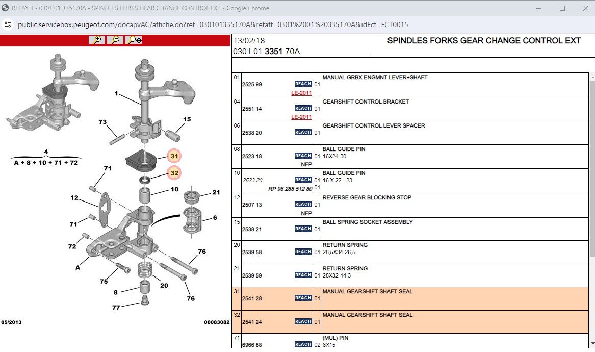

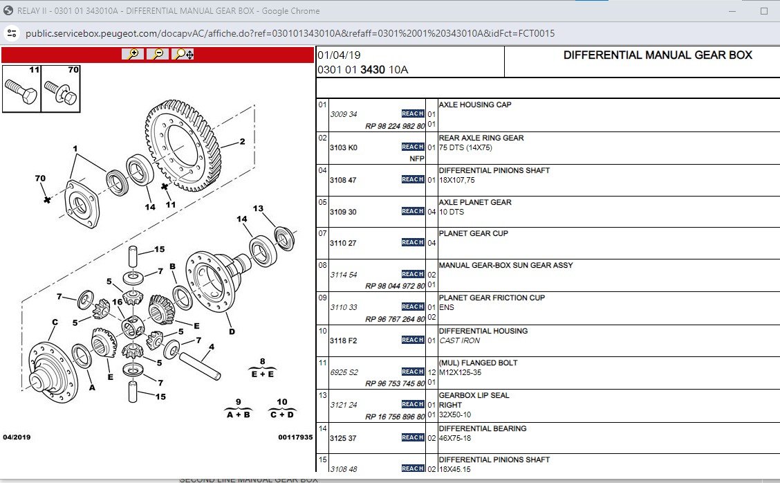

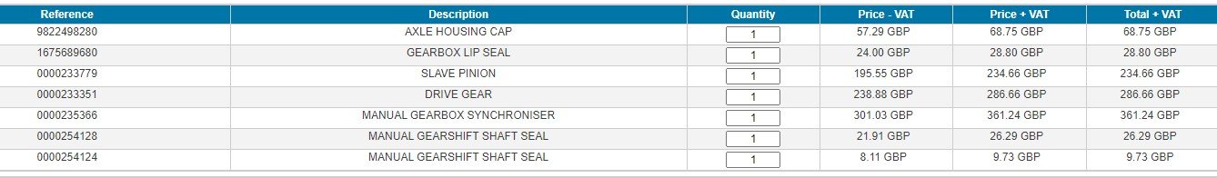

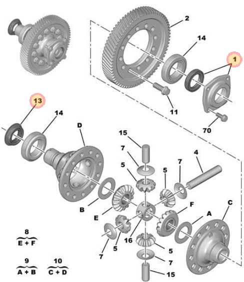

Hi, can I request for the below gearbox (MLUC?) part numbers please?
- Diff oil seal left
- Diff oil seal right
- 5TH Gear 49x33
- 3rd Synchro Ring
- Gearbox Selector Shaft Seal
Thanks!
- 5TH Gear 49x33
- 3rd Synchro Ring
Thanks!

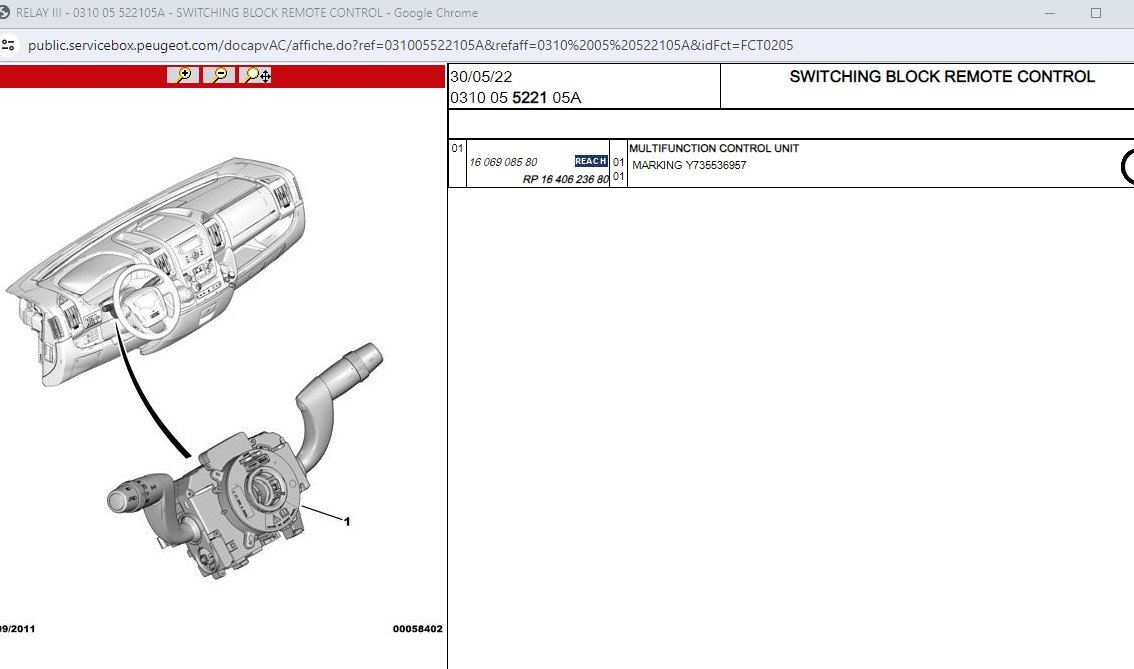

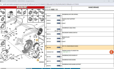

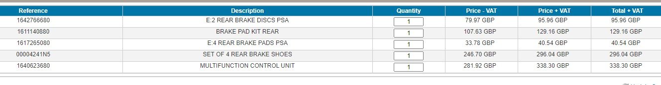

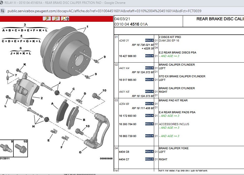

Morning all
Could I please ask for part number for the following parts for VF7**************[VIN obfuscated, can be read by forum staff]:
Rear brake discs
Rear Brake pads
Handbrake shoes
Cruise control with indicator stalks
Many thanks
Darren
Rear brake discs
Rear Brake pads
Handbrake shoes
Many thanks
Darren

Diff diagram, 1 and 13 are the seals: Gearbox internals - 3rd Syncho only available as part of a kitOliver53 wrote: 30 Jan 2024, 21:07 Hi, can I request for the below gearbox (MLUC?) part numbers please?
- 5TH Gear 49x33
- 3rd Synchro Ring
Thanks!
Selector diagram
And the prices
- Posts: 12615
- x 1498
Brake partsdwjlivermore wrote: 31 Jan 2024, 11:57 Morning all
Rear brake discs
Rear Brake pads
Handbrake shoes
Many thanks
Darren
Stalks - these are the ones fitted to yours, the cruise stalk is not shown separately even on the ones that are fitted with cruise - and there are loads of different variants but the one fitted to yours is not listed with the cruise option!
Prices - wouldn't give me a price for the OE discs.

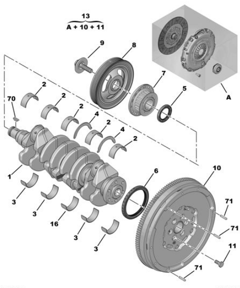

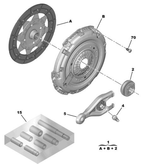

Hi,
Could you please tell me if there is a pilot bearing on the crankshaft on the clutch side ( not the trowout bearing for the pressure plate ) where the clutch spline shaft rests in ?
Not sure and if there is what is the part number as i want to replace as well together with replacing clutch and flywheel.
VIN VF3**************[VIN obfuscated, can be read by forum staff]
Thanks,
Bart
Thanks,
Bart

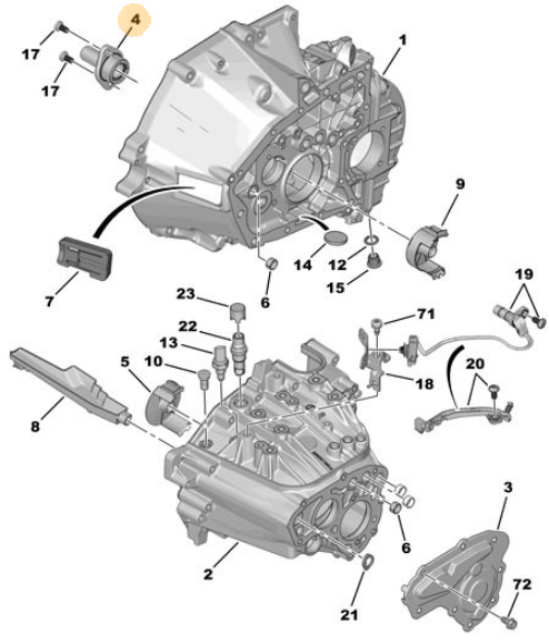

- x 6950
Here are the other related diagrams, in case you want to look at the other components. Anything else, let me know the Diagram A, B or C and the item number:
A Clutch B Clutch Master Cylinder C Clutch Housing Gearbox

Hi Marc,
The shaft from the gearbox where the friction disk from the clutch slides on.
is the end of that shaft supported in a pilot bearing ?
if so the bearing is in the end of the crankshaft where the flywheel is mounted on.
Thanks,
Bart
Thanks,
Bart

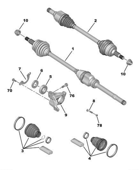

- x 6950
I don't know what it is you want - Flywheel and Driveshaft assemblies:
- Posts: 12615
- x 1498
Citroen don't use pilot / spigot bearings.
BVL
- Posts: 26
- Joined: 22 Jan 2024, 02:28
- x 2
BVL
- Posts: 26
- x 2
So peugeot also doesn't then ?
Thanks
- x 6950
Thanks Richard
PSA use the same tech, engines and gearboxes etc. on all their models, so most likely not as Richard says.
- Posts: 12615
- x 1498
I kind of meant all PSA cars, but only wrote Cit as that was on my mind!
