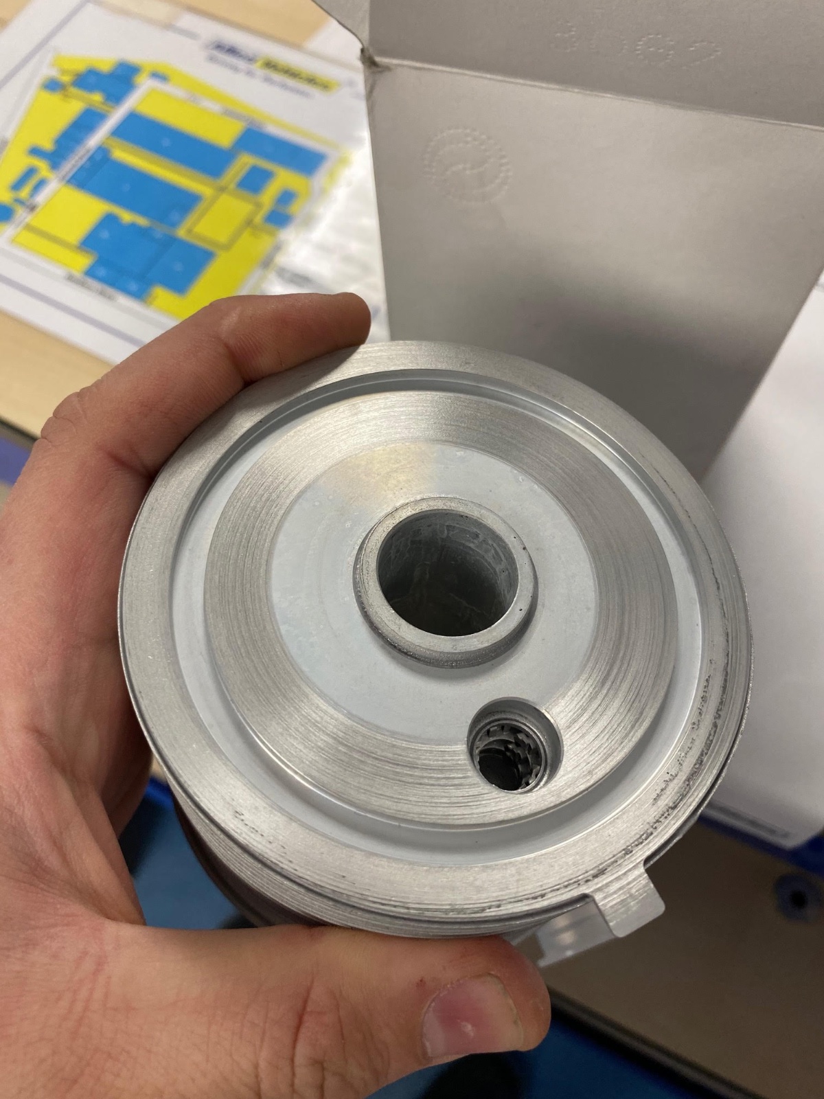

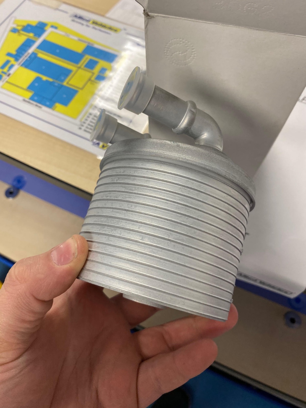

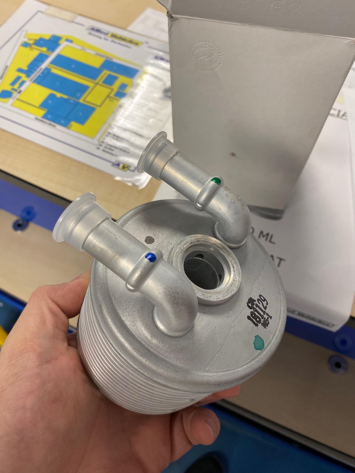

Well, I've bitten the bullet. The car isn't here so I can't spend any time looking for a solution and I can't ask other people to do it so I've ordered an oil cooler.
Citroen Glasgow had it in stock on the shelf. Apparently they've sold 4 of them this year.
I managed to get it for £320 + VAT. Still a horrendous amount of money but needs must.

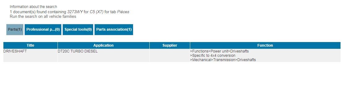

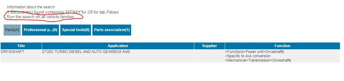

Does anyone know if there's a way to use service box to find out which models of car a part was fitted to? I'm looking for a driveshaft. Part number is 3273WY but am unsure if it's unique to the 3.0 HDi or not.

Yes, select a car (any will do) then there is a Search box top right above where the list of parts is - stick the part number in here, then hit search. Under C6 it comes up with:DHallworth wrote: 12 Nov 2019, 20:29 Does anyone know if there's a way to use service box to find out which models of car a part was fitted to? I'm looking for a driveshaft. Part number is 3273WY but am unsure if it's unique to the 3.0 HDi or not.
David.
You can then click on the bit ringed, and it will show you a list of other vehicles, in this case
And then click on C5 which shows
- x 6945
Re: All Things V6...
David, that part is only for the DT20 (3.0 HDi) engines on the C5 X7 and the C6.DHallworth wrote: 12 Nov 2019, 20:29 Well, I've bitten the bullet. The car isn't here so I can't spend any time looking for a solution and I can't ask other people to do it so I've ordered an oil cooler.

Well, today has been a day with a little bit of progress...
I managed to source a driveshaft from a breaker in The Netherlands which should hopefully be here whilst the gearbox is being changed so it can be put back in instead of the original one which would be handy.

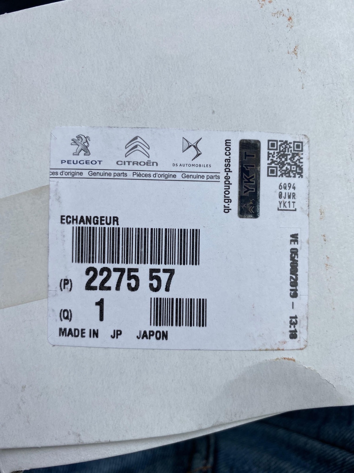

I've also out that nobody replaces the oil cooler on these gearboxes when they are rebuilt and knowing what carnage takes place when they have failed, there's no way I'm spending £2.5k on a gearbox rebuild and taking a chance on a 2nd hand cooler.
The only place I can find the oil cooler for these cars is from Citroen. What's even more surprising is that the local dealer in Glasgow had one in stock and on the shelf. What's worrying is that one dealer have sold 4 of them this year.
Annoyingly though, they don't stock the o-ring that goes behind it so I've had to order that and will need to go back for it.
