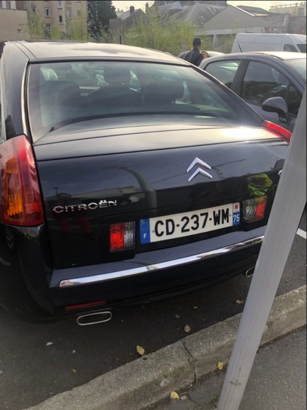

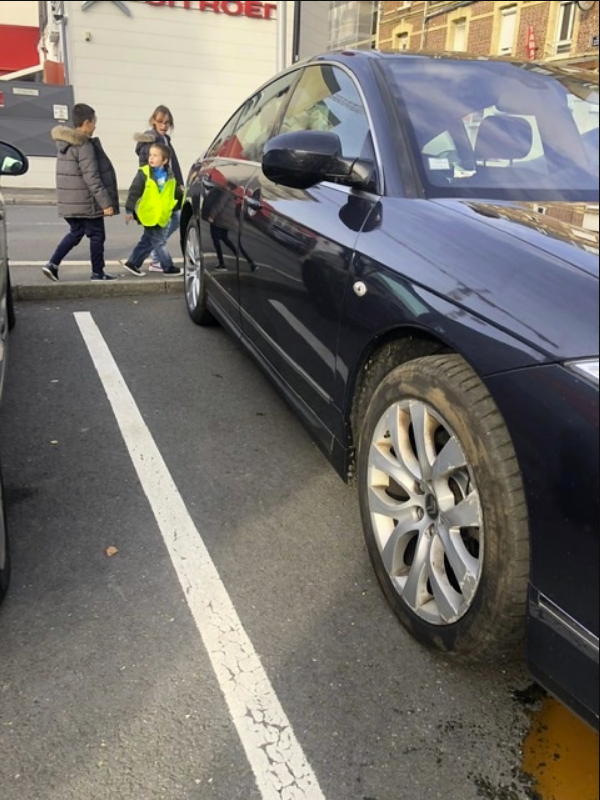

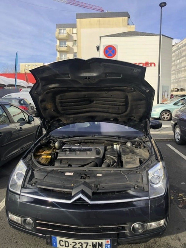

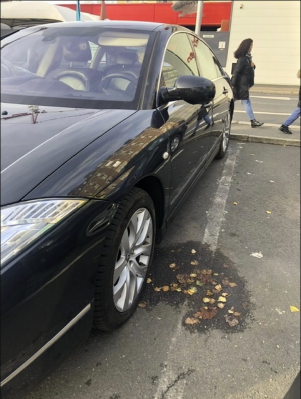

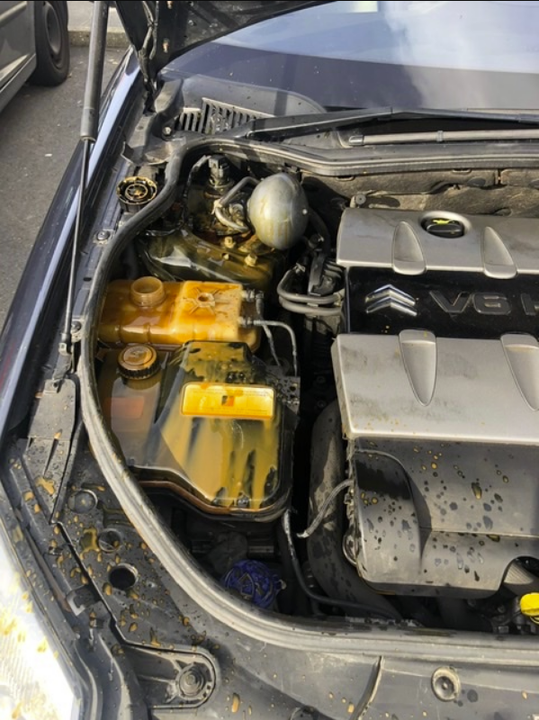

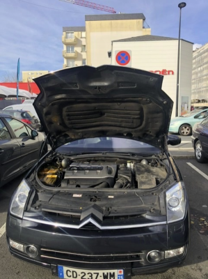

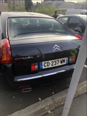

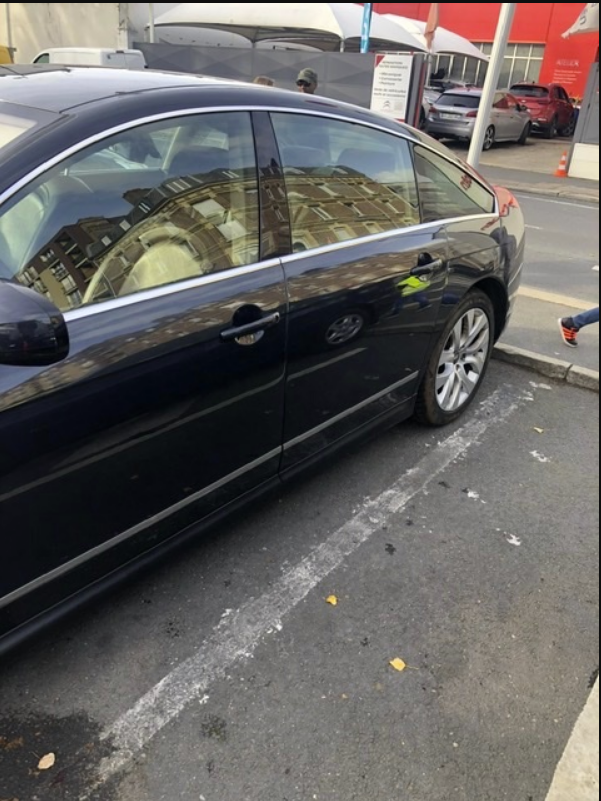

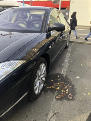

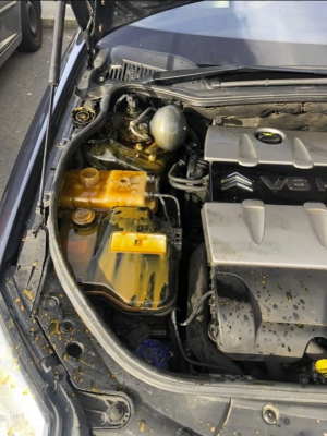

Well, as I've detailed in my previous thread, the oil cooler on my 407 gearbox let go and destroyed the gearbox...
Before I found the cause I'd been thinking about changing it and had spent a long time looking at a lot of cars. I firmly blame Shaun and Steve for taking me out in a C6 and reminding me how nice they are so I went to see a C6 that I didn't get a good feeling about so I ended up walking away...
However, I've rejoined the fold and write this as I'm on my way to collect a C6 that I've bought blind...
Not only have I bought it blind, I've bought it broken, and I've bought it from France... according to my wife, 3 stupid things don't make it sensible...
Anyway, onto the car...
It's a 2011 built, 2012 registered 3.0 HDi in Storm Grey with Black Leather. From what I can make out from the seller it's had a lot of money spent on it recently including a full respray, new Michelin tyres all round, new brakes all round, and a new dashboard. All of this was done by Citroen in Le Havre.
Onto the fault... the car overheats after about 12km of driving. I'm assuming the worst in that the engine is toast. If the car is as tidy as I'm lead to believe it is and I'm correct in my assumption that the engine is knackered I'm going to take the 3.0 HDi engine from the 407 and have it put into the C6, if the C6 is a wreck I'm going to take the gearbox from it and have it put into the 407 so either way one car is going to save the other
I'm writing my own version of planes, trains and automobiles with a couple of ferries thrown in for good measure this weekend as a friend and I recover it from France with a trailer and take it to BL Auto's for it's condemnation.
So, long story short, it looks like I've become a paid up member of the 3.0 HDi C6 Owners Club
Here's the few pictures of it that I do have.
David.

Ugh. All the pictures are 90 degrees out and I can’t sort it on my phone. Sorry guys!
